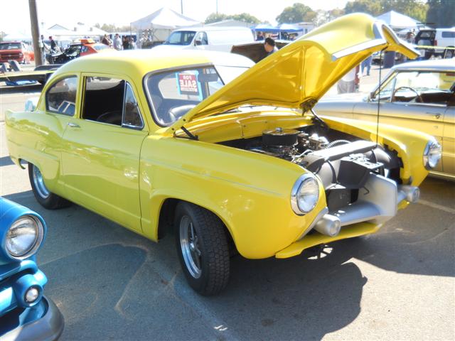

    saw this one at the Turlock, CA Swap Meet yesterday

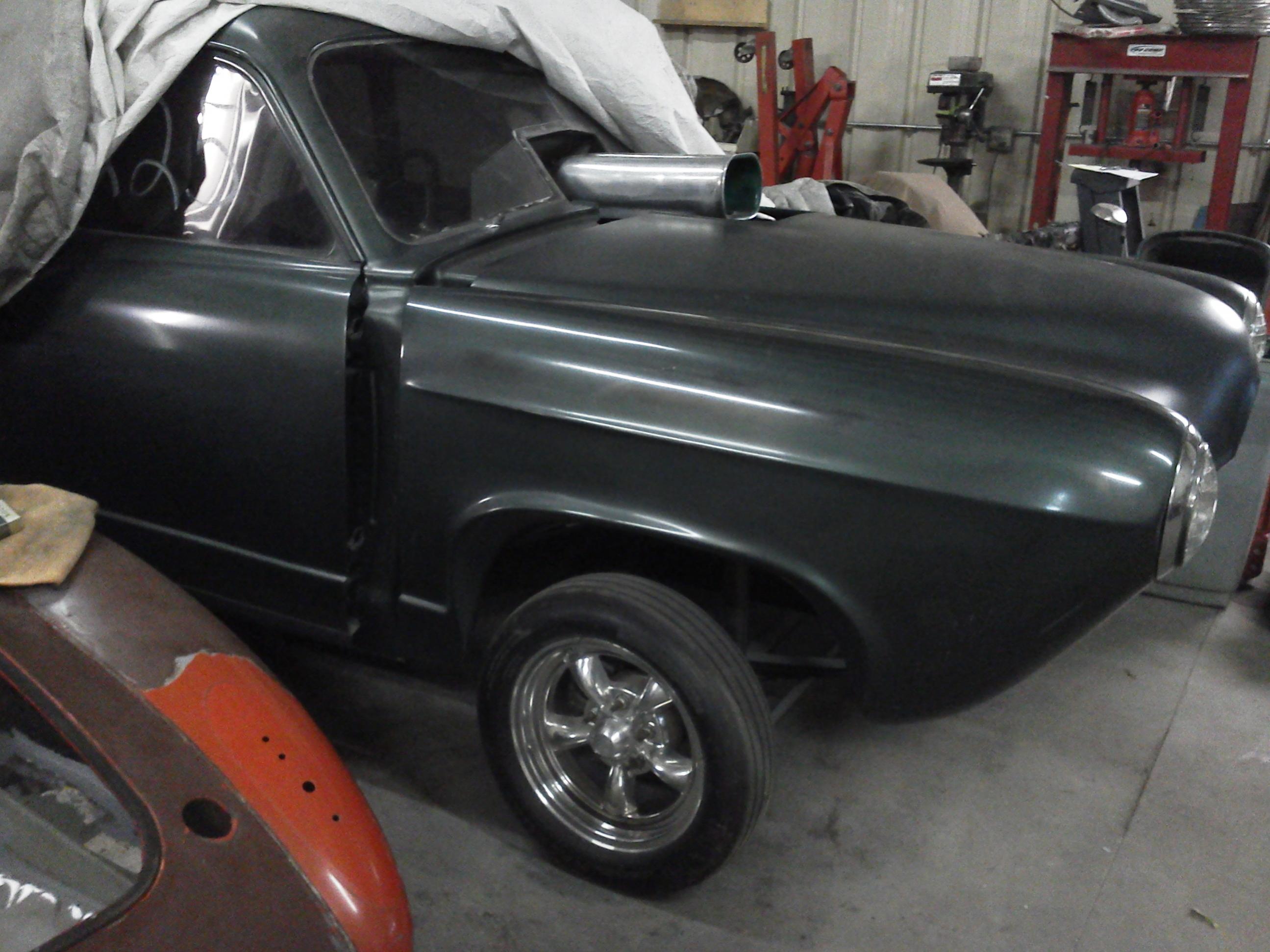

    I kept trying to tilt this thing forward but couldn't see what the heck was going on to stop it from tilting. My back was starting to bother me from leaning forward trying to look so I just made a video of it.
    I thought for sure that 4 1/2 inches of forward movement would be enough to clear, but hell no it won't go ! I'm not a mechanical engineer and I didn't sleep at Holiday Inn either, although I should have. The concept seems sound so we'll give it another shot with longer slots, if that doesn't work back to the drawing board.
    I also shot some primer on the radius to see where I'm at on that too.
