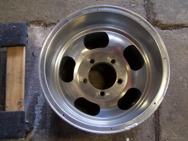

    I had the t-bucket out Sunday and Monday so enjoying a little piece of the warm weather we got. I used it to drop off the new 15x10 slots to get some curb rash tig'd up. Those should be done tomorrow, not putting them on right away though. I figure I'll make a p*** or two with the old wheels and slicks and see what the rpms with the new gears will be. If I need to move to a taller slick then I'll put those on the wider rims.

    Mocked up the front clip, trying to get that all lined up so I can start the hinge building. Sometimes taking these pictures lets you get a further away perspective to see if the body line line up. I think I may stick with this and my fancy plates came in today.....hoooray !
    picked the wheel up Friday, so I need to get the weld filed down on that
