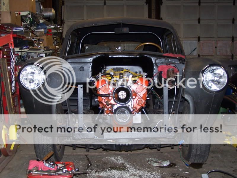

    This car has no glove box, radio, trunk and the vent windows are stationary, a real stripper. I spent the day cutting off the old motor mounts and fabbing new ones. I must have measured and checked the angle finder a hundred times before taching them in.
    Of course I ran out of gas in the mig half way around the second mount. I hope the welding place is open tomorrow, I'd like to at least finish up those. Might not get to the trans crossmember till Monday, my back is a wreck anyhow from todays work.

    from Buffalo,NY
    I got those mounts welded in and put some rustolium on them today, she's going to setup like morning wood.
    the engine is almost finished too

    Looks like it's going to be sitting pretty high in the front. Might need a drip pan or a piece of cardboard shoved under her at night as the rear main seal seeps. But I like the look. I always thought the old altereds with the engine sitting way up high was cool.

    from Buffalo,NY
    The carb pad is level so it should be good, my garage floor has a 4 degree down hill pitch to it. I have to ad that into all the measurements, but it does give the illusion that the front is higher than it is.

    Clik
    That's going to make for a steep drive-line angle isn't it?. I went the other way to get a better drive-line angle. I set my engine back and down between the rails.

    from Buffalo,NY
    Both will be set at - + 3 degrees, I'm looking for a 60's vibe so the motor is high. If it doesn't work out I'll change it, but plenty of cars ran 24 inch crank centerlines back then. Probably about a 4 inch difference in front to rear heights spread out over a 4 ft (?) driveshaft.

    Clik
    Yeah, apparently they were getting away with some radical angles that aren't supposed to be. I originally set my engine in almost exactly the way VonHartman on (this site) did his HJ engine, which is lower than yours and sets the mounts right on top of the cradle cross member. But with 3+- on the engine and the same on the pinion I had 18" between the parallel lines of a four foot driveshaft. Most angle the rear up and use a CV joint at the ****** end, but from an engineering standpoint it doesn't seem to change the physics. I ended up setting my engine back and down between the frame. It sits low enough that I'm not too concerned with loss of leg room and I'm not using a backseat anyway.

    from Buffalo,NY
    I put the old motor and trans back in today so I can take a look at the radiator and headers. The difference in height between the center of the rearend yoke and trans output shaft is 3 3/4 inches. Now to order a header kit and see what kind of new cuss words I can come up with figuring that out...lol
    most of the day with this view, looking at the ceiling

    Clik
    I guess my ch***is is sitting a lot higher than I thought because I had 18" between paralell lines of drive with the engine mounts low on the cradle. Now I've got the engine sitting down between the rails and about a foot back. When I get this picture thing figured out I'll send some.

    from Buffalo,NY
    I'll measure the height from ground to fenderlip on the front fender when I go out there today. This car doesn't sit really high in the front but just enough for me.

    Thanks for checking out the project pictures, nothing fancy going on just a good garage build....lol
    I measured the front fender lip height and it measures 28 inches from the ground in line with the spindle. The front tires are 14's and measure right at 24 inches tall so that puts 4 inches of sight over the top of the tires.
    Now of course these measurements may change, but plan on going with an aluminum radiator and the new engine has aluminum heads but adding a tunnel ram w/2 4's.
    Today I stripped the interior out to get the carpet out, it was a pain unbolting the roll bar to get it out from under there. I also unbolted the fuel cell, just trying to get it ready for the ladder bar install. I'll have the roll bar checked for tech while it's over there too. I'm sure it will need new side bars since these look to be the pro street varity and below shoulder height. The foot plates are 4 inch square so those may need to be bigger too.
