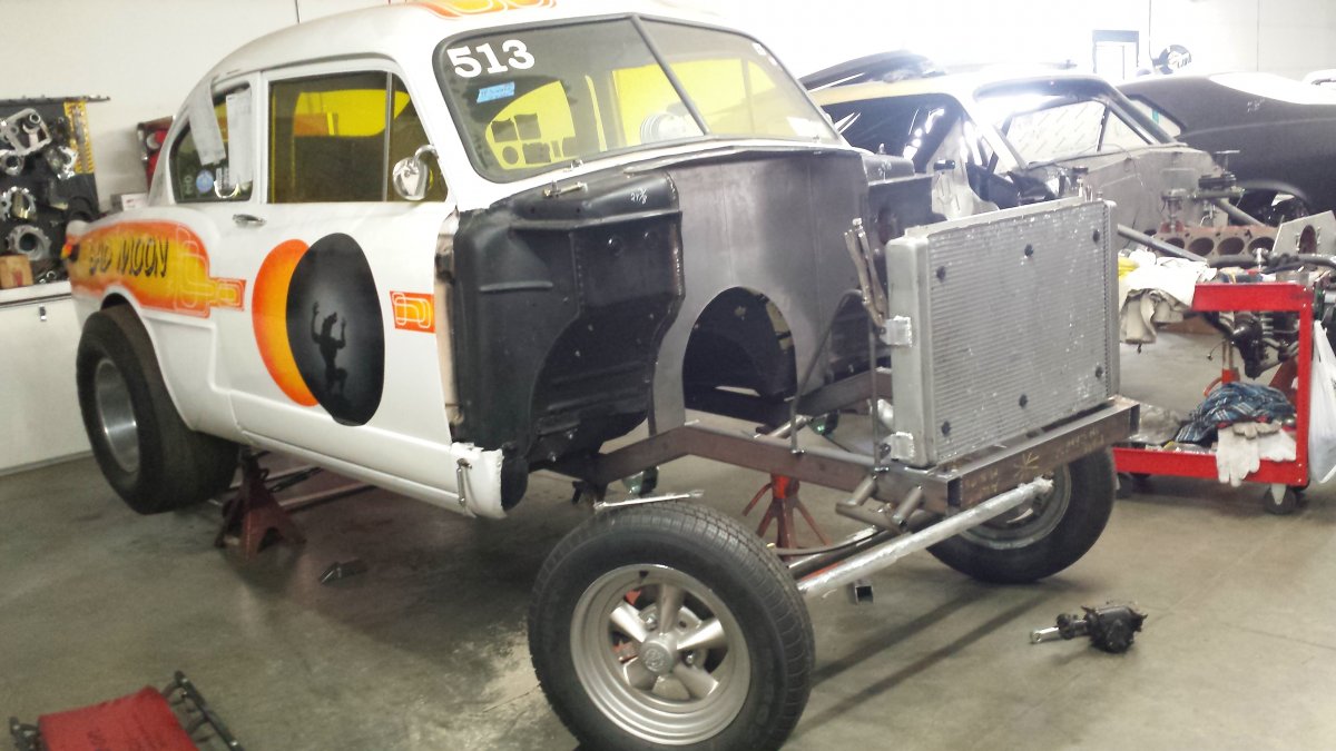

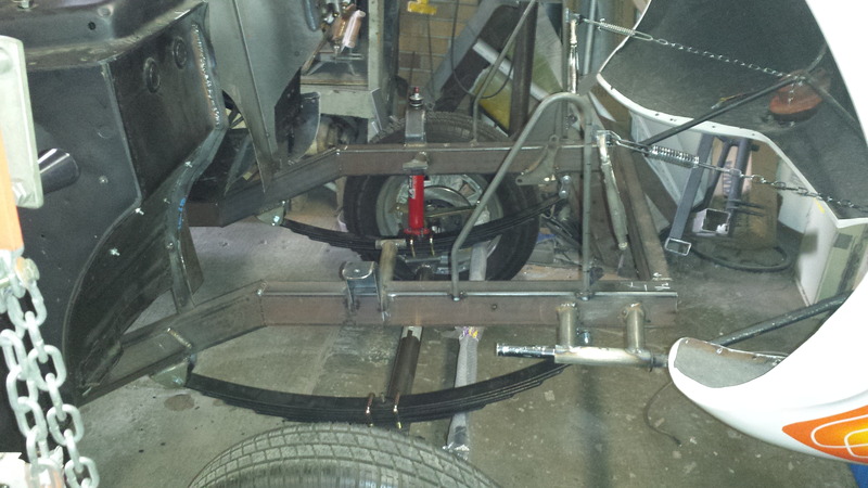

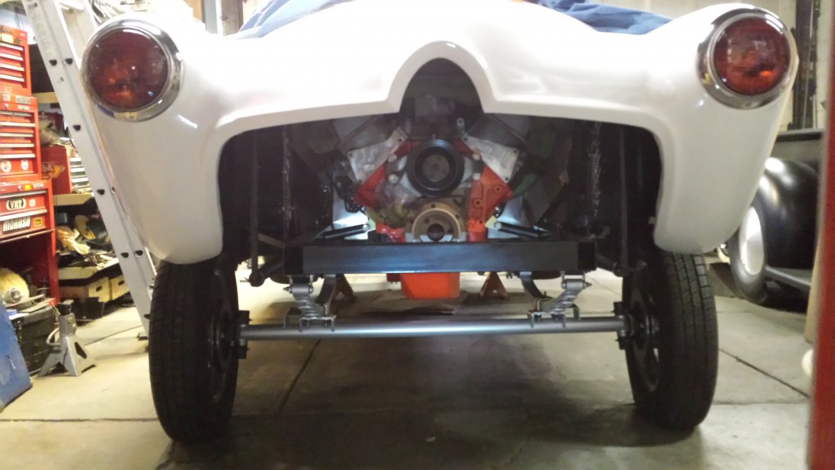

    Motor, trans, radiator mounts all in and steering box mocked up. Body is mounted, outriggers to roll bars mocked up too. 20160719_133121.jpg 20160719_133211.jpg 20160719_133231.jpg 20160802_123618.jpg

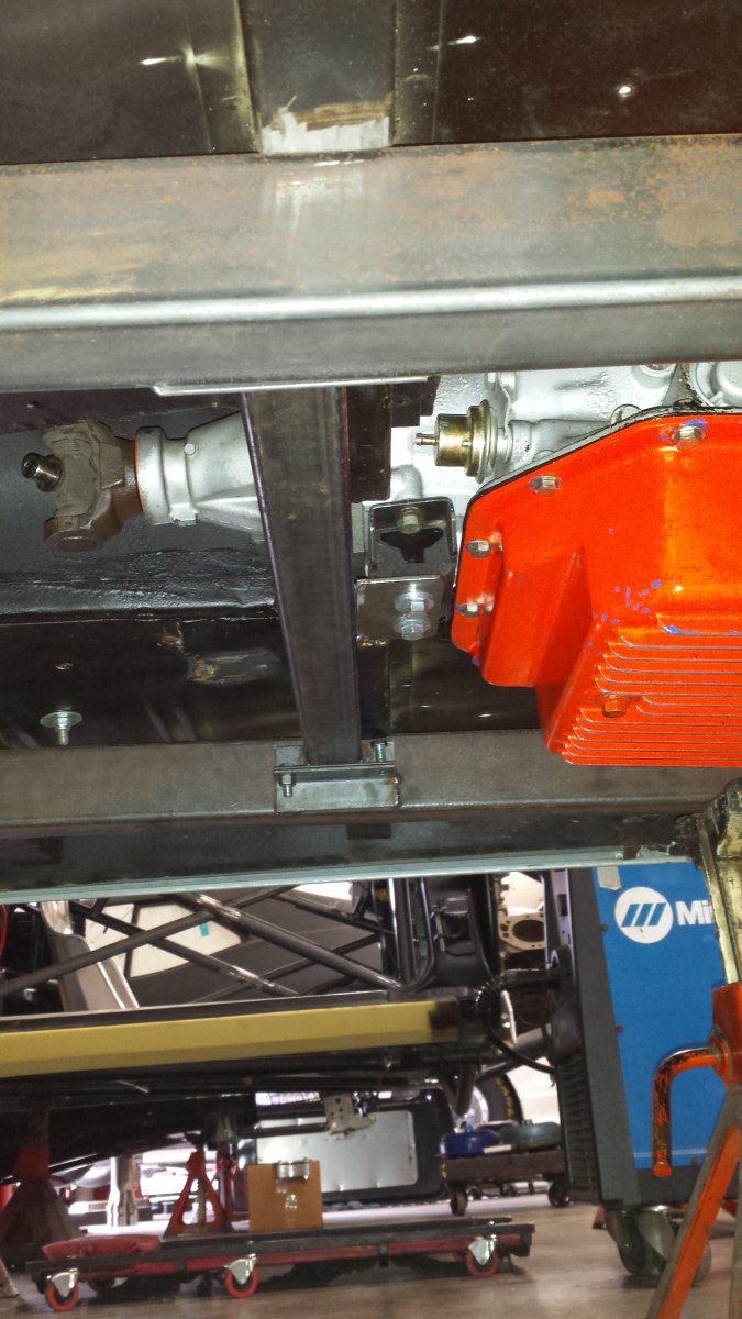

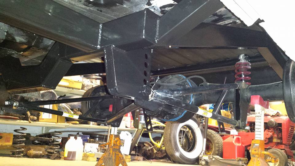

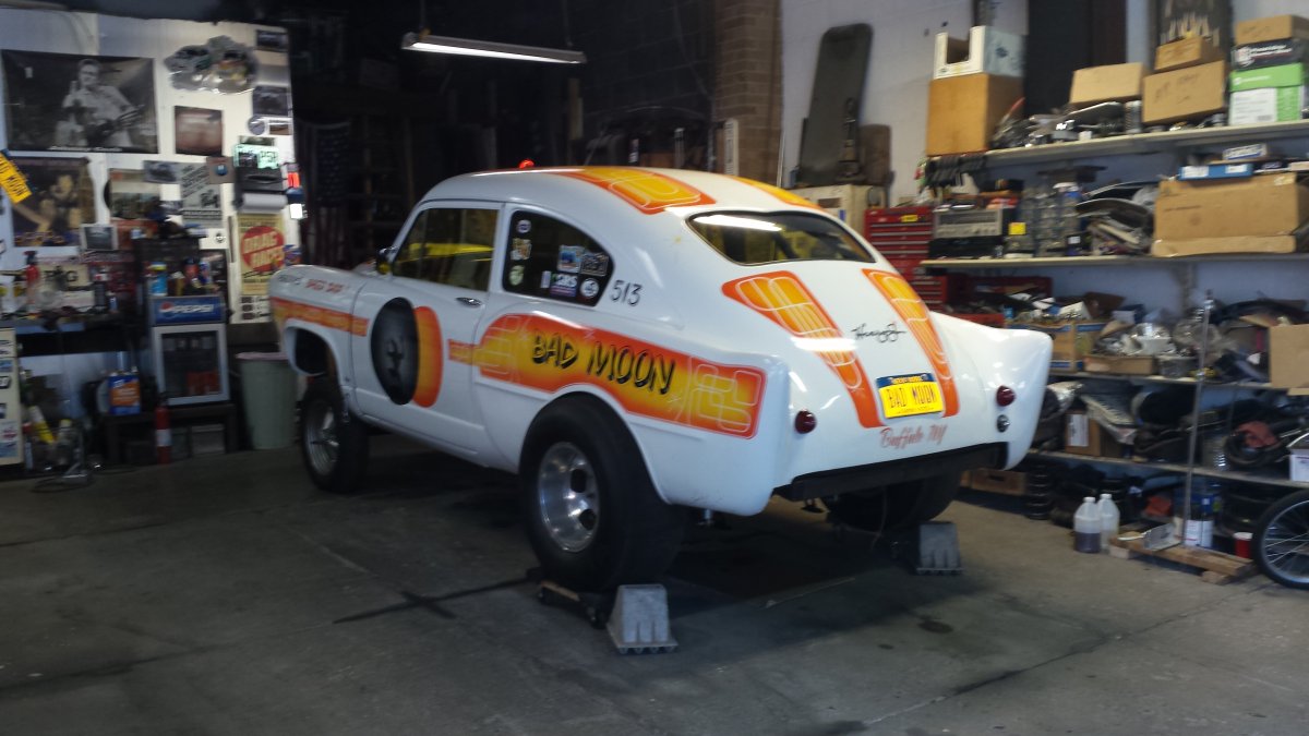

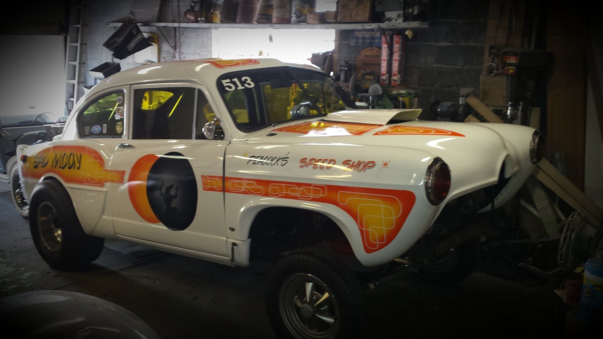

    All welding finished up
    Loaded up and heading for home
    Checking out the new shock mounts and eyeing up the engine and trans install

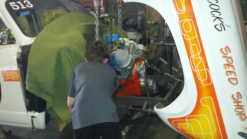

    Had my son helping me with dropping the 489 in there
    All in, only got a one inch suspension drop out of that
    After it settles I'll address the height, more than likely I will pull a leaf to get the height down a little and also soften the pack so it can actually work.
    I also tried out the new scoop, which I will definitely mount. Next step will be steering column and linkage mockup.

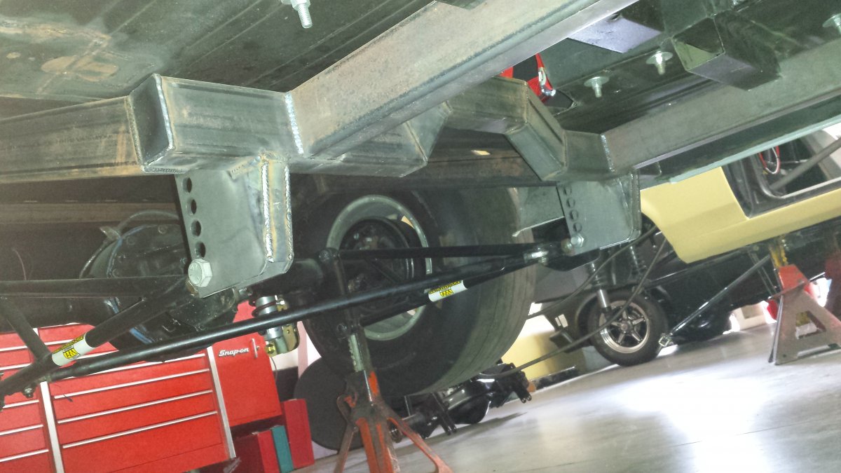

    I POR 15'd the ch***is yesterday, no worries about surface rust now for the upcoming winter. hjf.jpg hjfr.jpg hjfra.jpg hjfram.jpg

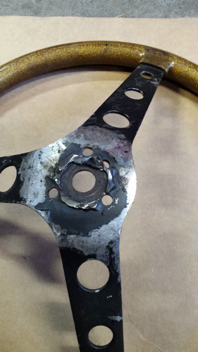

    Up to this point I was running the stock Henry J column and box. I kinda like the stock column drop so I decided to keep it and the stock outer column and make up the rest.
    First step was to cut off the welded on gold metal flake wheel and dismantle the column/box combo. 20170219_131011(0).jpg 20170219_130904.jpg 20170219_144022.jpg
