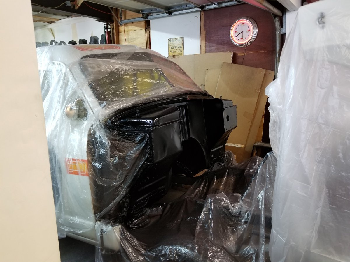

    I actually ended my agonizing over trying to blend my new firewall work with the older "history" work on the rest of the firewall, something that has held me back on moving forward for a long while now.
    I finally just said screw it after trying several different attempts that left me unsatisfied with the results, not saying that I'm totally happy with this result either but I need to get moving on this one before the cold weather sits in. Plus you know the other thing, which is supposed to happen in a couple weeks, but I think I've got that beat...hopefully (knock on wood).
    I tried flat black last night, mostly because I had it on hand, the filler work really soaked it up and once seeing it this morning I thought about how oil mist from the breathers would show on it, so I switched to satin and put on 4 coats of Rustoleum's finest today. Hopefully this covers well over the filler, if not I'll just have to add a few stickers then..ha ha ha

    Looks fine Phil. You may want to run over it with some 320 or 400 and then give it a couple more coats, and that should cover well. Once the BB is in along with the headers, not going to see much of the firewall anyway. :)

    That's what I'm hoping for, the distraction of the engine taking away from the mismatch of the new and old firewall. Today I was thinking of satin clear for easy clean up but I think I'm getting a little carried away on what this old car is about, a 20 footer that money is spent on going fast rather than trying to look good.

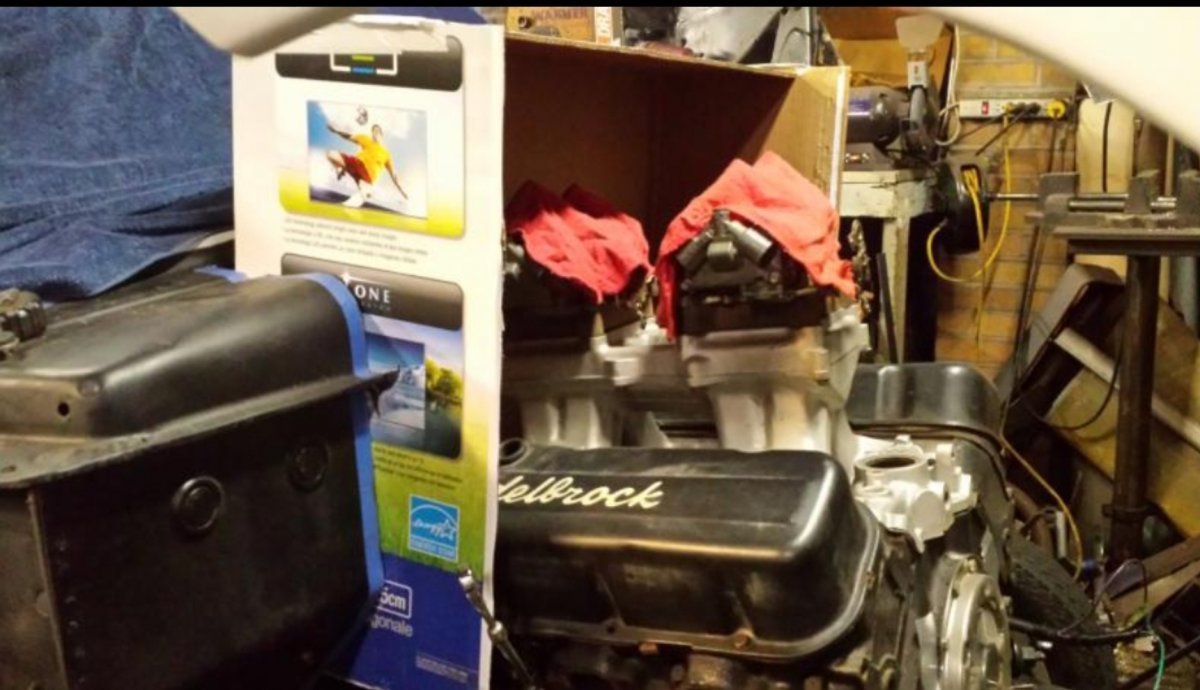

    Then I spent an hour and a half moving things to get the car moved forward under the chain fall on trolley and moving the engine/trans from the back section forward to the same spot. I blanketed up to protect my new shiny firewall and realized I was missing the motor mount bolts, where the heck did I put those damn things.
    What normally works for me working by myself is to thread the engine/trans nose first in between the radiator support loops and new shiny firewall until it's over the ch***is. Then I roll the car back until there's enough room to rotate the combo the correct direction in between the fibergl*** tilt front end and shiny new firewall, then lower chain, roll car forward, lower chain, roll car forward, lower chain, roll car forward, lower chain until it slides home and onto the motor mounts like a glove.

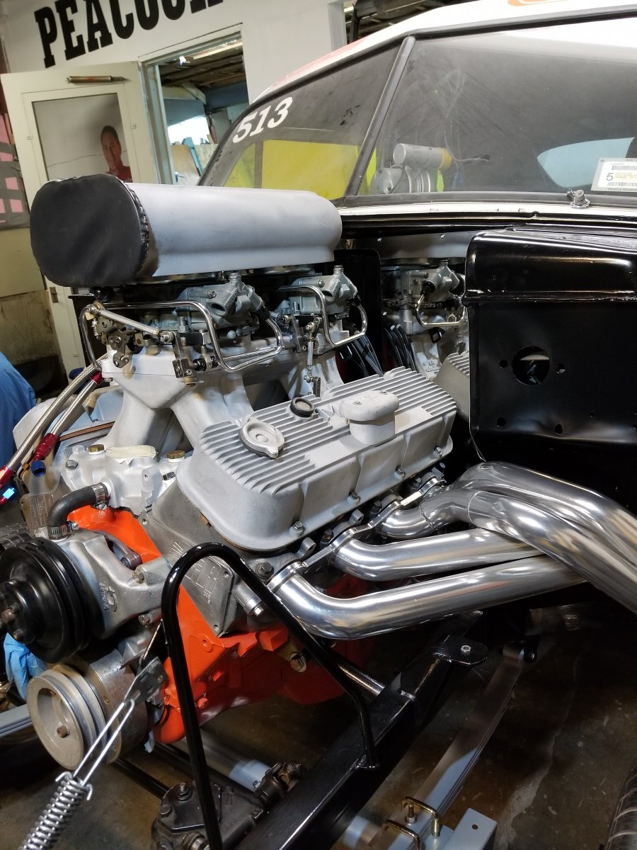

    The new and improved "Badder" Bad Moon
    20190922_153334.jpg 20190921_192409.jpg 20190921_192500.jpg 20190921_192657.jpg

    That’s gonna haul ***

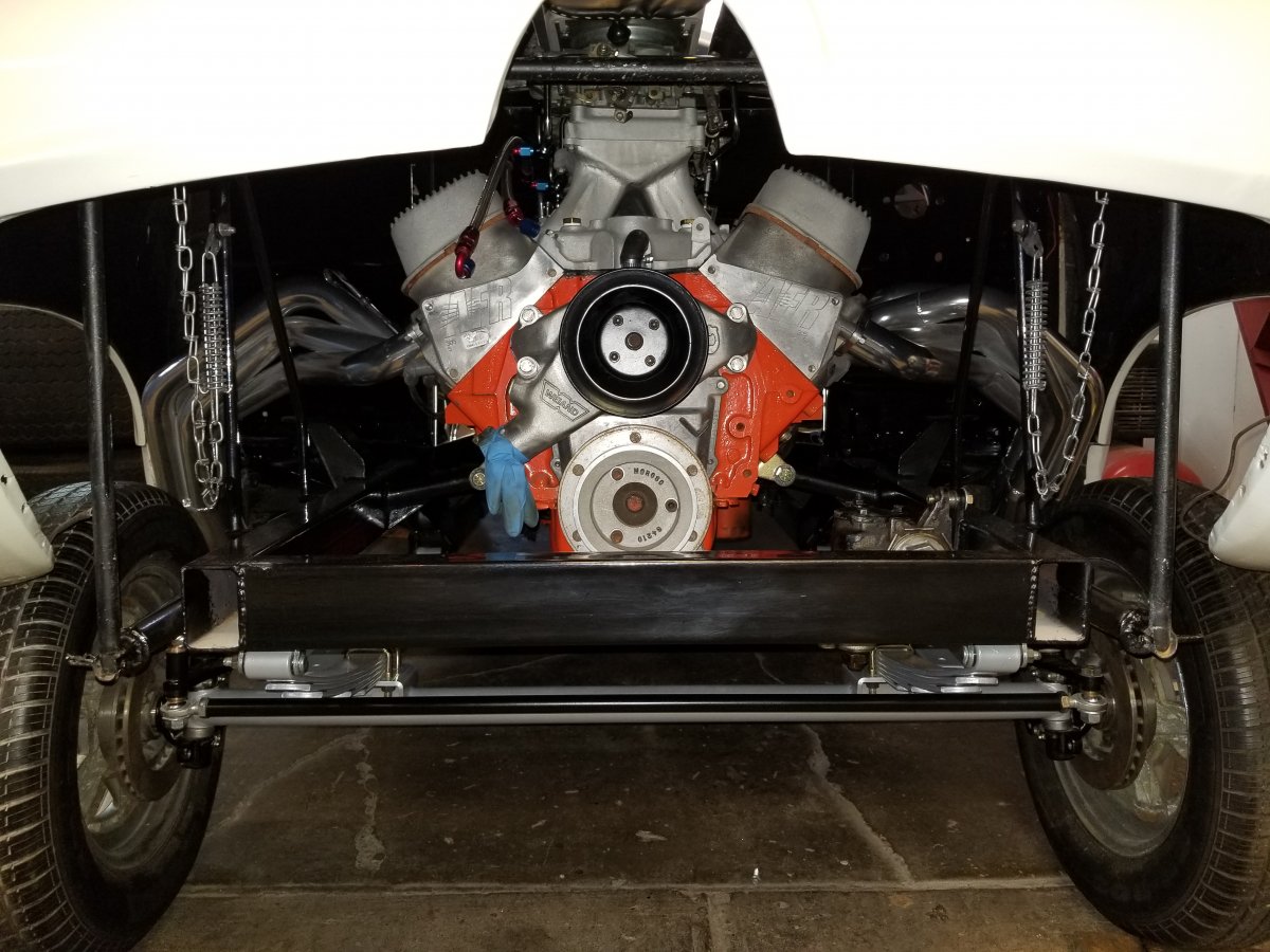

  10. loudbang
    Posts: 40,351
    Like the rubber glove blocking off the water pump. :)

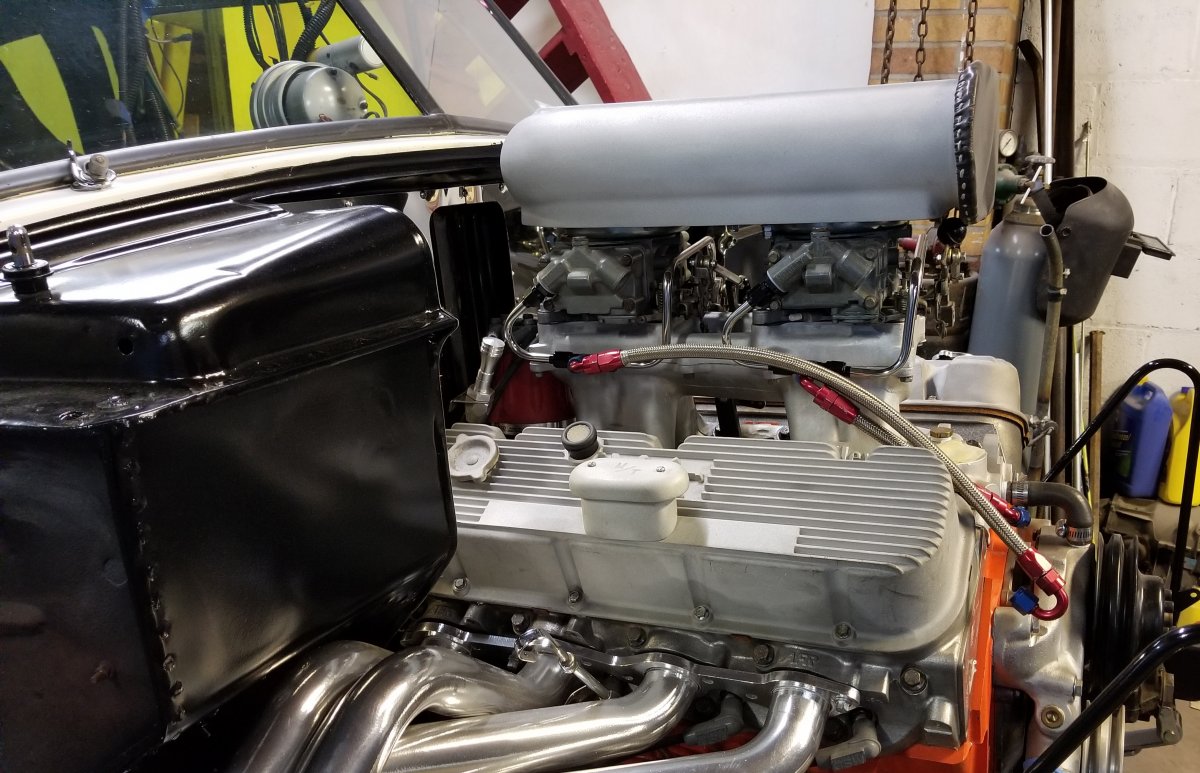

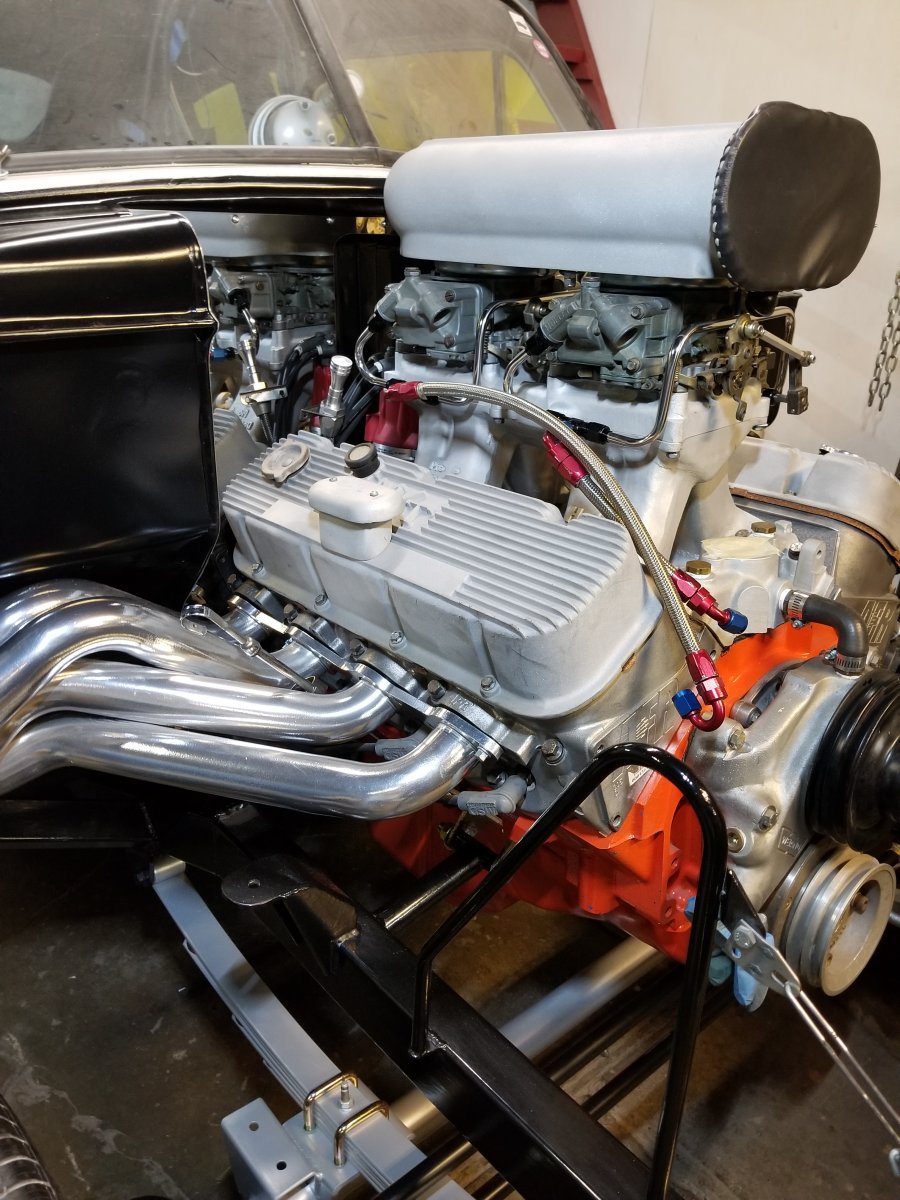

    I put spacers on top of the carbs to raise the scoop up, I like that better but still an option to run the Shelby 350 scoop depending on the height of filters I could fit under it. Thinking of it I guess that doesn't matter because only those small filters can fit inside of the Hilborn style scoop.

    from Buffalo NY
    That cast scoop looks pretty nasty
    loudbang and swade41 like this.
  17. chopped

    If I use it I'll polish it again, should've never had it sandblasted..lol..but I was going to powdercoat it to look magnesium.

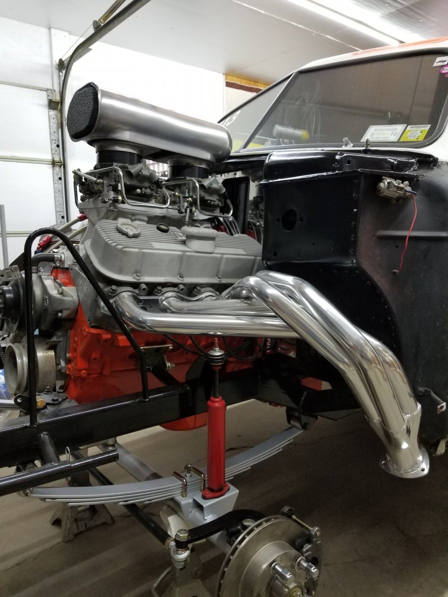

    Put my new heavy duty alternator mount on, 1/2 inch thick aluminum with a one inch thick solid spacer between the two arms, this baby is solid.
    Realized I forgot to m***age my toe boards for header clearance before painting that firewall, I had to breakout the BFH to make the needed room. So it looks like a little bodywork and paint will be in order, plus I have to find a new spot for the ignition box.
    Then I moved over to completing the front disc brake install, so off came the hubs and repacked the bearings, loaded the calipers, got all that on plus installed the 90/10 Lakewood shocks.

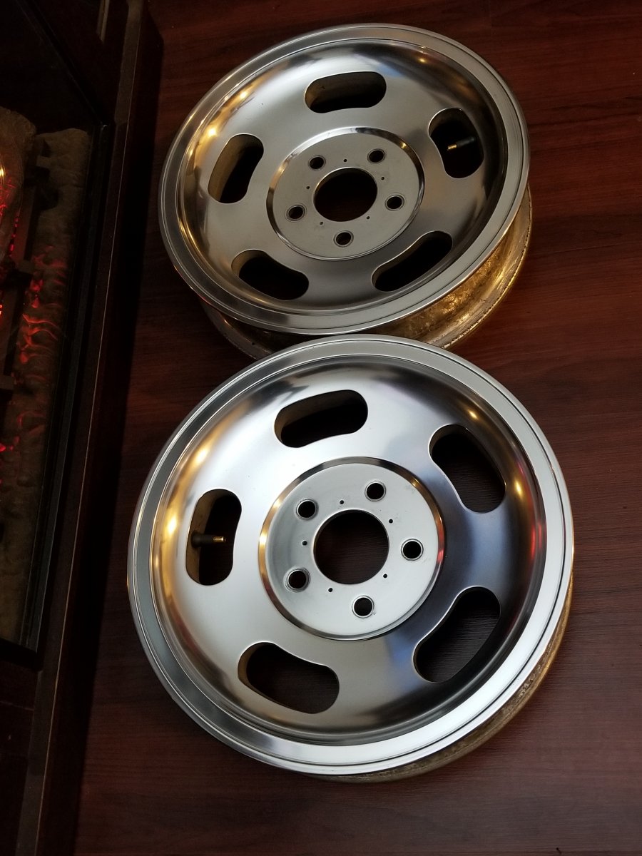

    Last night and tonight I sanded and polished by hand the old front runners, freaking back is killing me now from that, I need to find some kind of power tool to make this **** easier.
    And tonight I did the other one

    More blingy after using the Flitz polish and their buffing whell/ball thing in a drill, easier than the old spit shine method for sure.

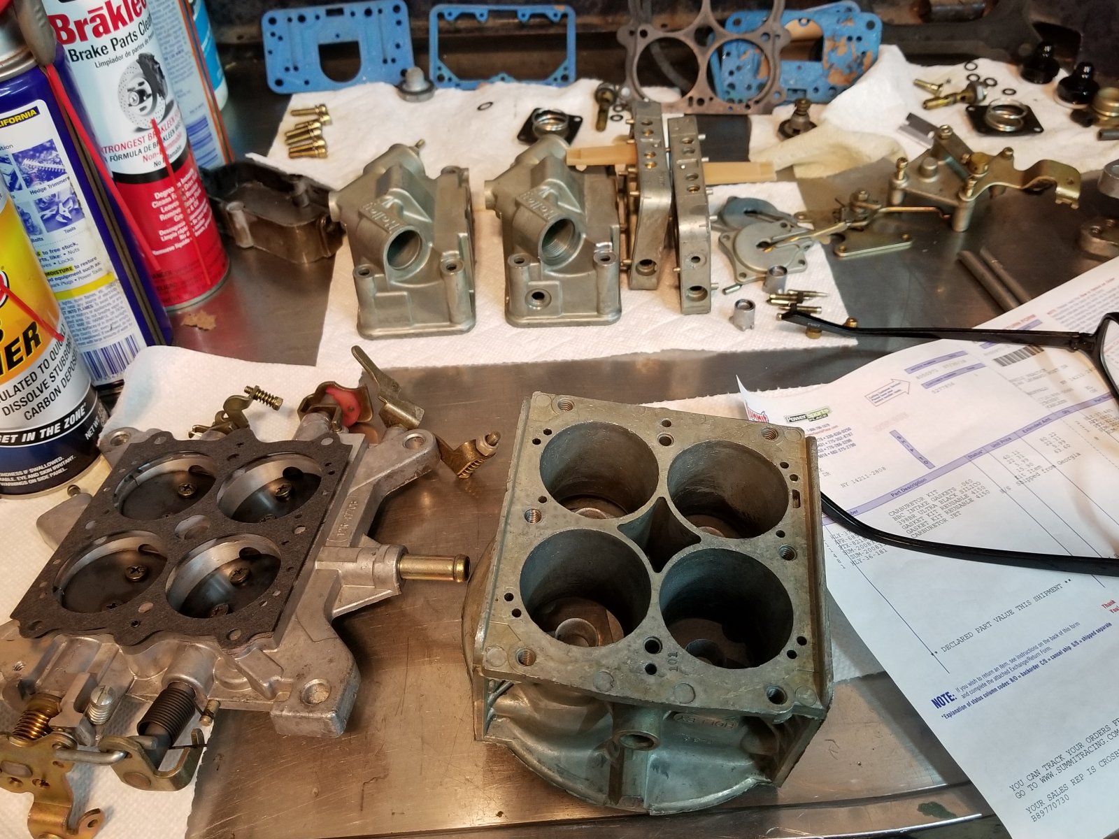

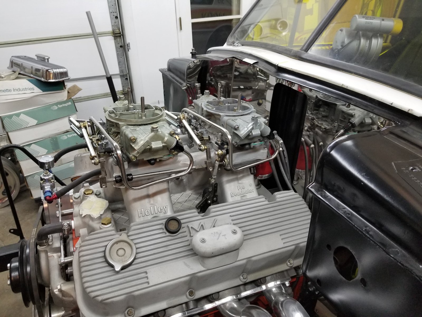

    When I went to rebuild the carbs it turned out one carb had heli-coils holding the bowls on, so I found a pretty close match with the original carb having front/rear power valves and new only having one.
    So I cut the air horn off the new carb, went through it to match the other carb and have an equal pair other than being different colors.
    20201011_161730.jpg 20201011_153548.jpg 20201013_130100.jpg 20201017_192120.jpg

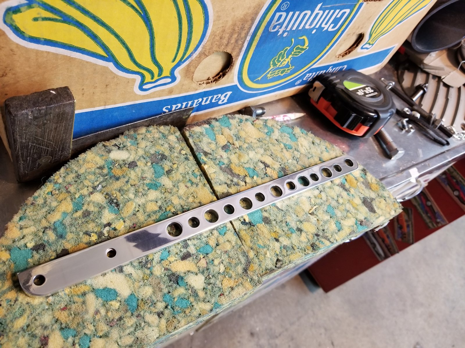

    Took some aluminum flat bar drilled some speed holes in it to mount my fuel regulator to.

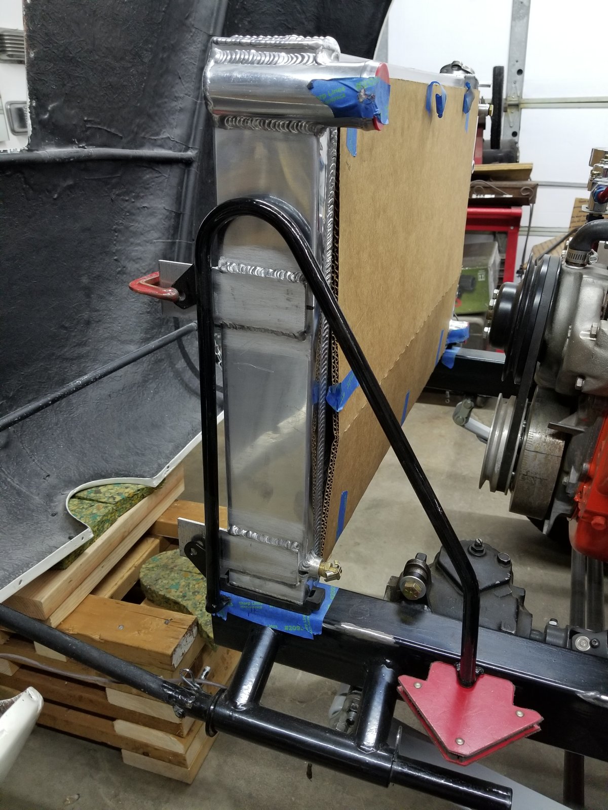

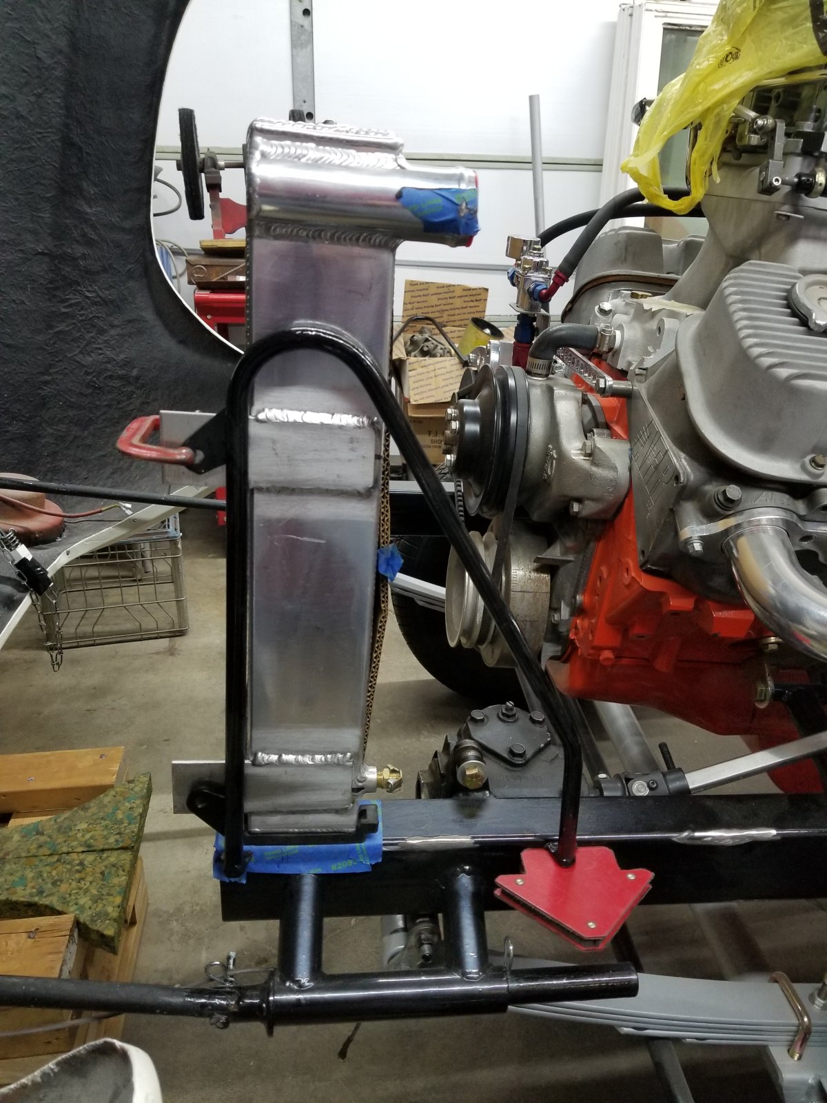

    Next up was a new 4 core radiator, so I had to cut the radiator mounts off the frame and move them to work with the new radiator.
