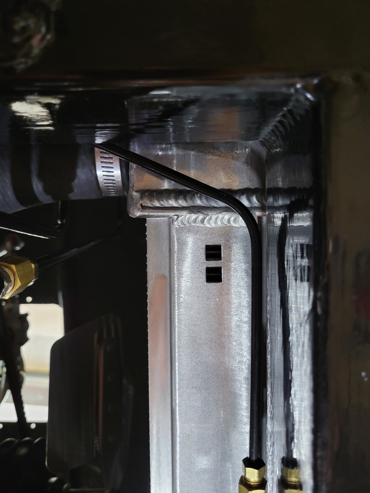

    Finished up the brake lines, I almost got them symmetrical even !
    Next step will be putting the pushrod back in, which might require removing the seat, really should've put the rod in earlier and I may redo the p***enger rear line since it got bent up removing the rear end.
    20230915_161435.jpg 20230915_161518.jpg 20230915_161628.jpg 20230915_171435.jpg 20230915_173708.jpg

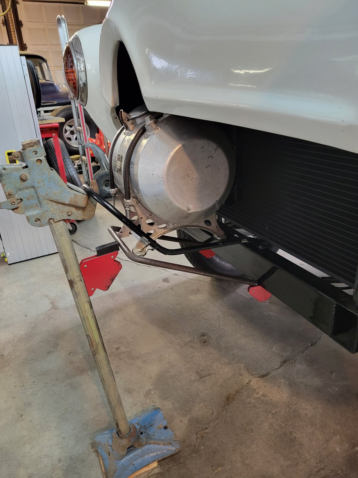

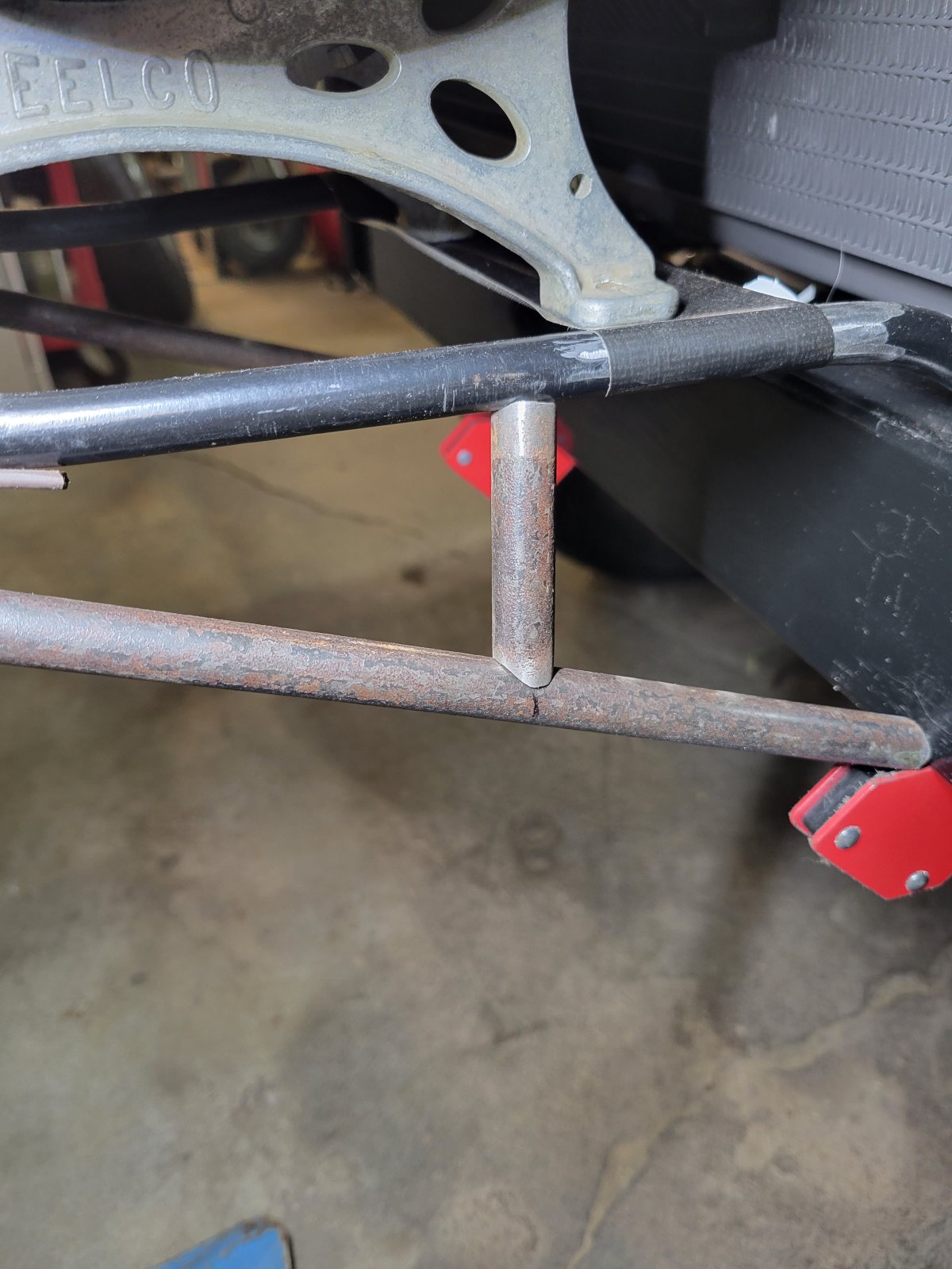

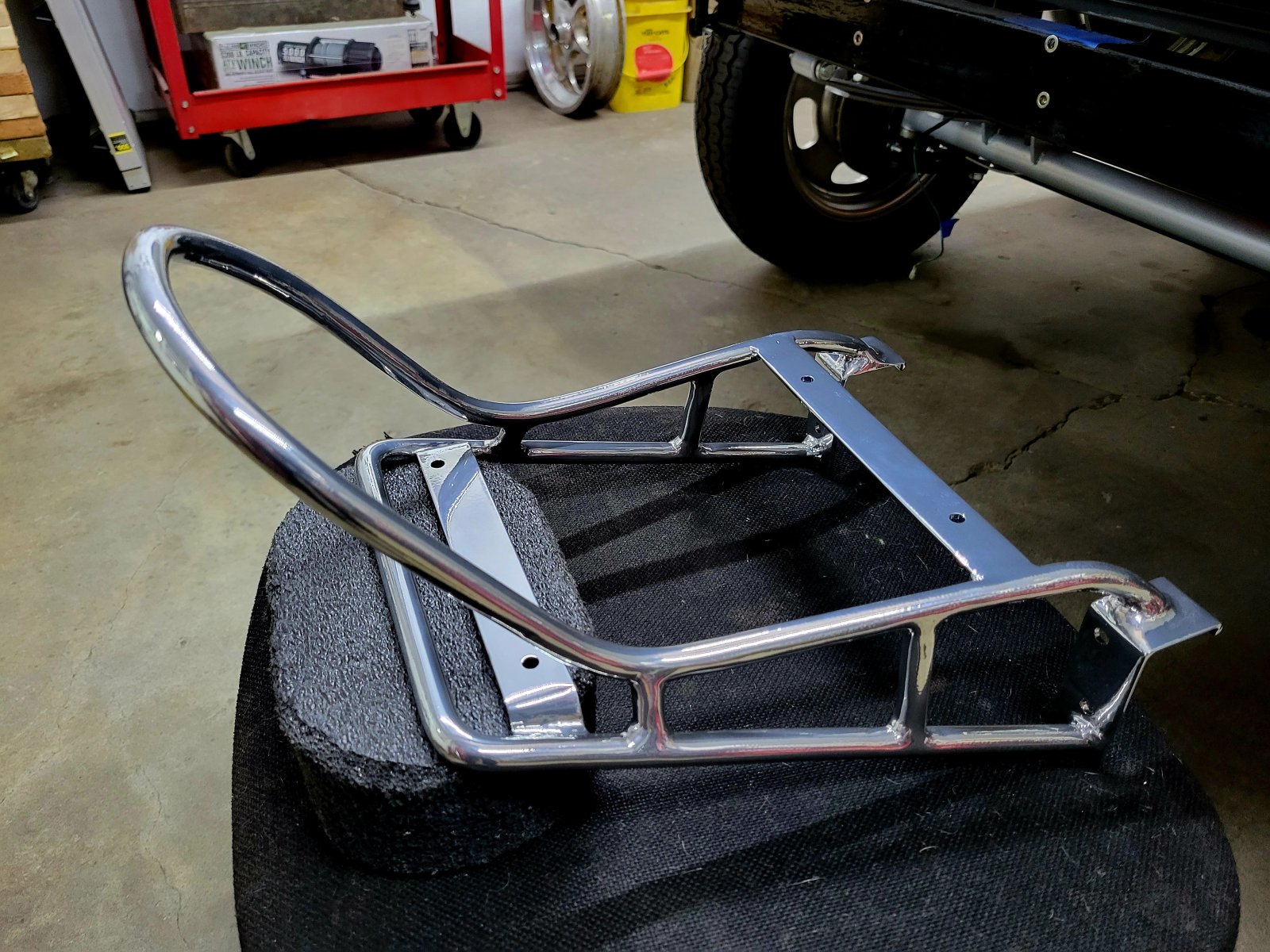

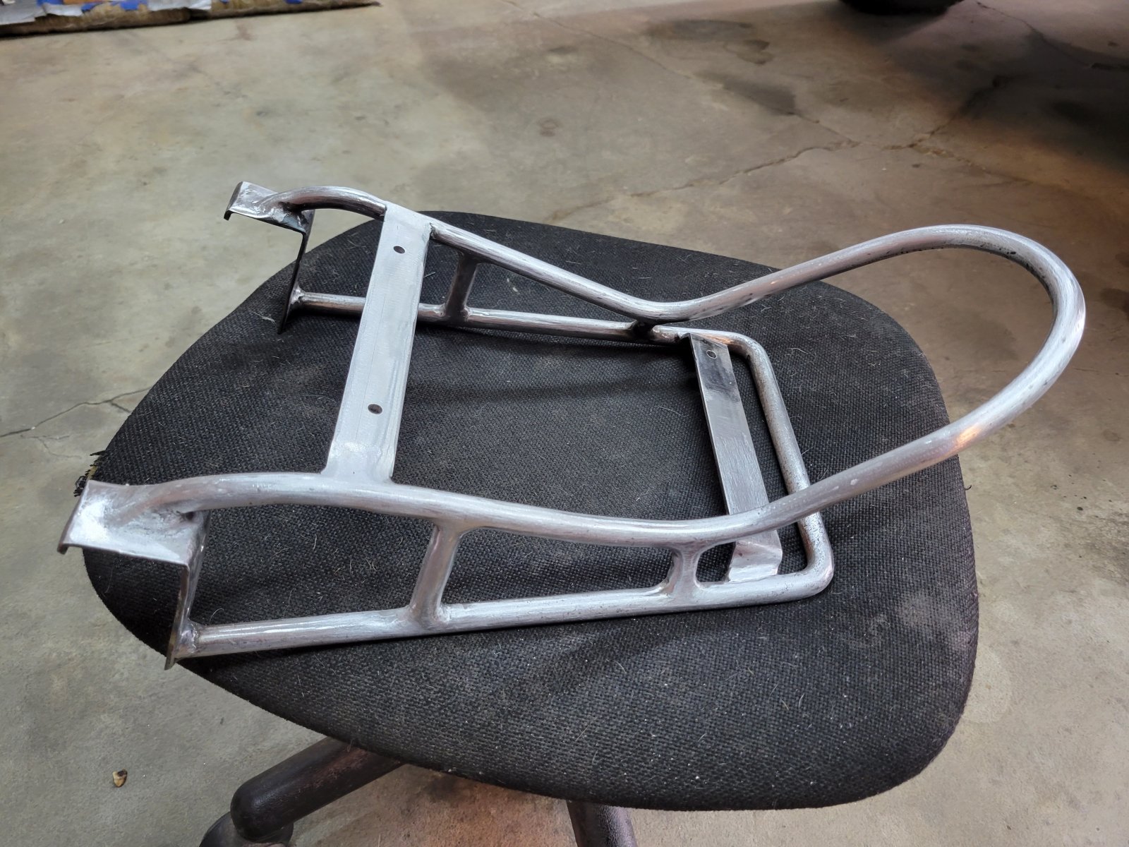

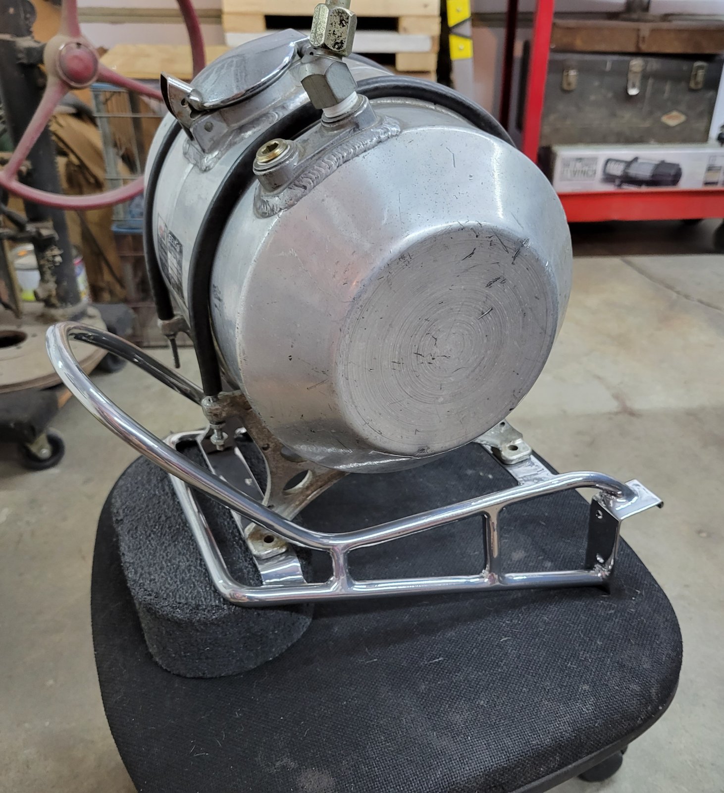

    I've been working on the Eelco tank mount, building off of the previous mount I made out of the 18 ft piece of 1/2 inch bar stock the former owner of my humble abode left here.
    20231008_200449.jpg 20231008_200520.jpg 102_6696.jpg 102_6702.jpg 20220608_141054.jpg
    Decided on a little more right angles on the lower to accentuate the curves of the upper
    enloe, 59Apachegail, loudbang and 2 others like this.

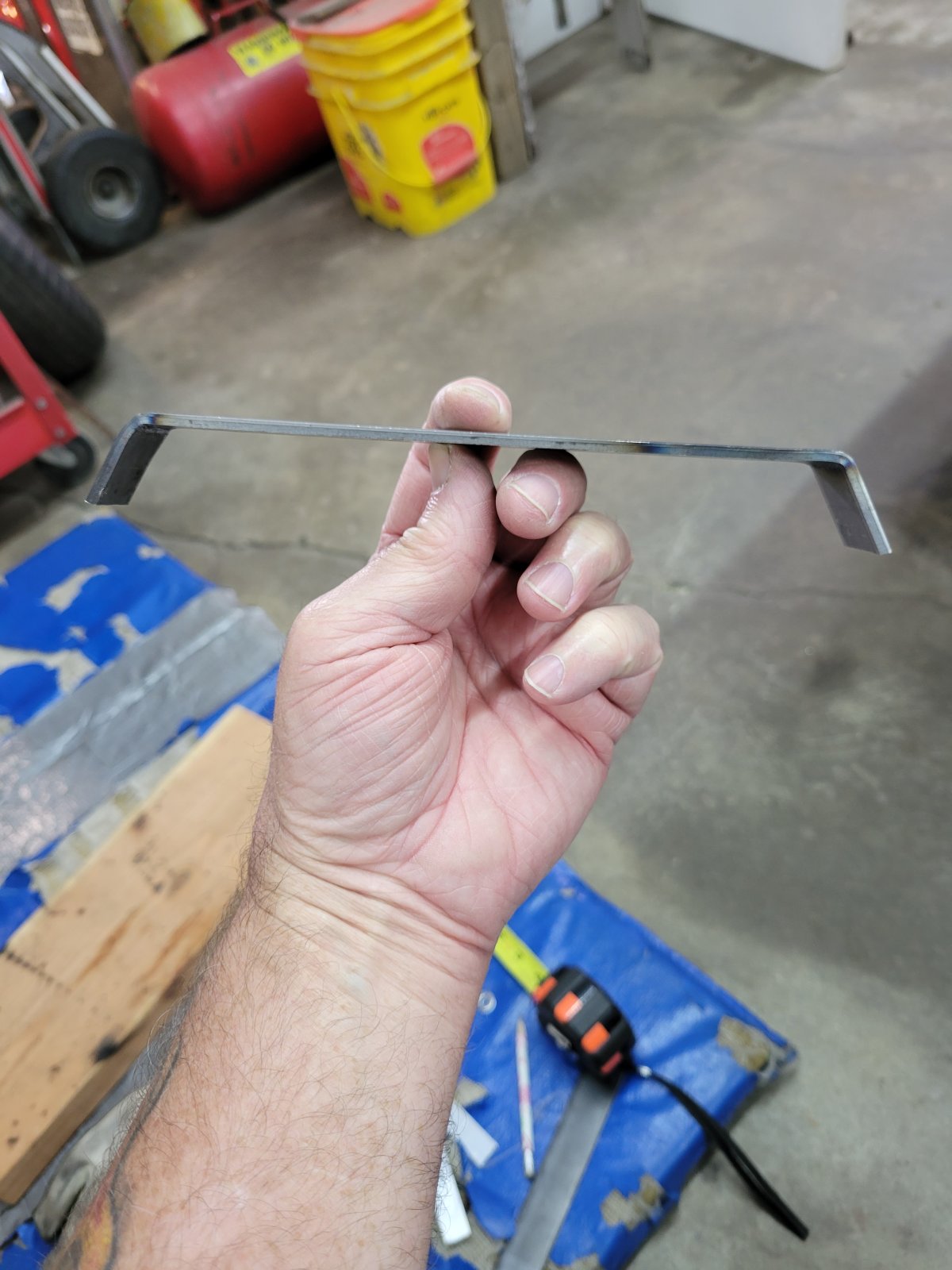

    Made a couple uprights, fishmouthed them in and made brackets to slip over the top of the frame for extra support
    Welded it together and smoothed out the welds
    Then onto the tank mount braces, put a little arch in the front to visually tie the bottom and top pieces together, again smoothing the welds

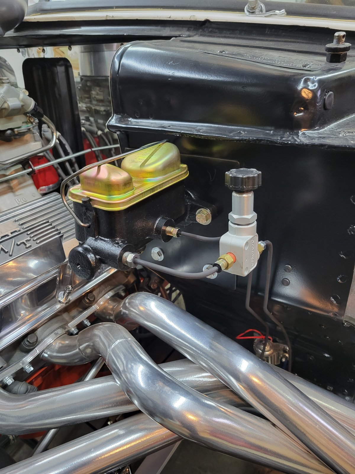

    It turns out I had to replace my master cylinder, the rear seal must of dried up or something from sitting for the 9 yrs, it started weeping down the firewall.
    I really didn't remember what I used before other than something ford, so I ordered a replacement ford part that looked the same, but it wasn't, maybe old was truck and new was definitely car.
    Anyhow the fittings were different as well as spacing, so I got to make a couple new lines also, man, thought I was done with that.

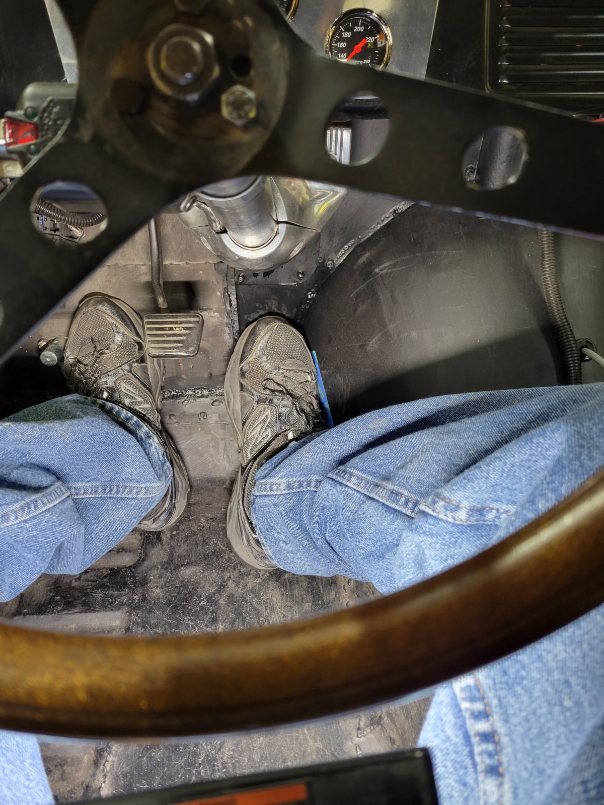

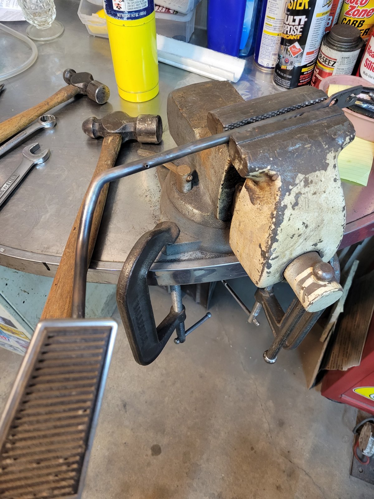

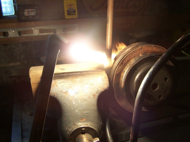

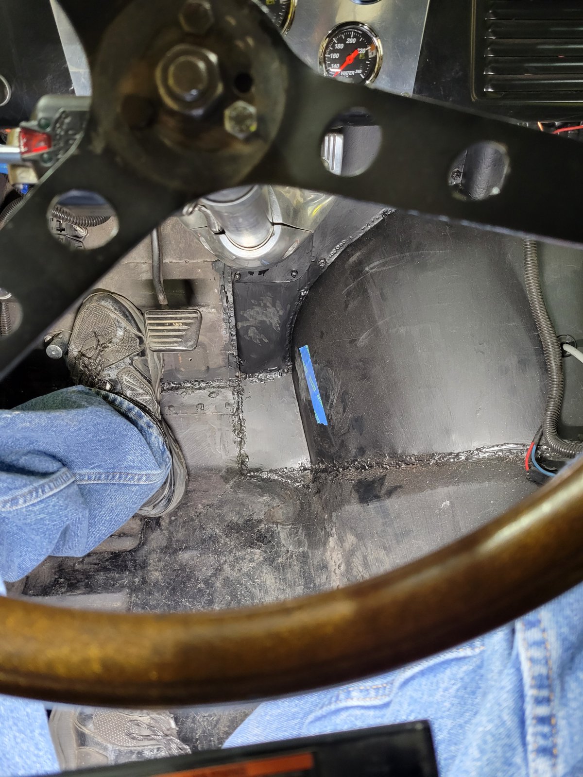

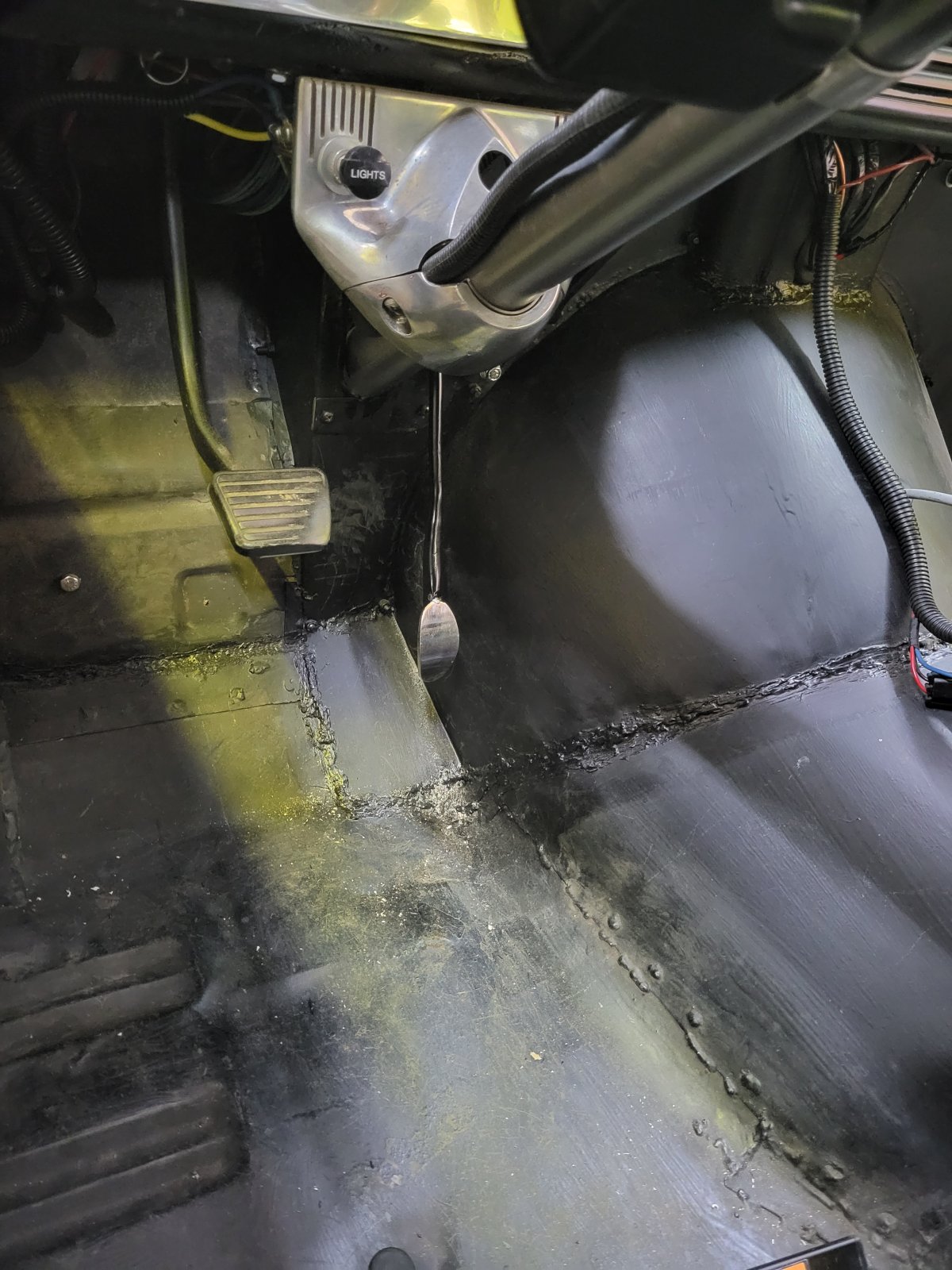

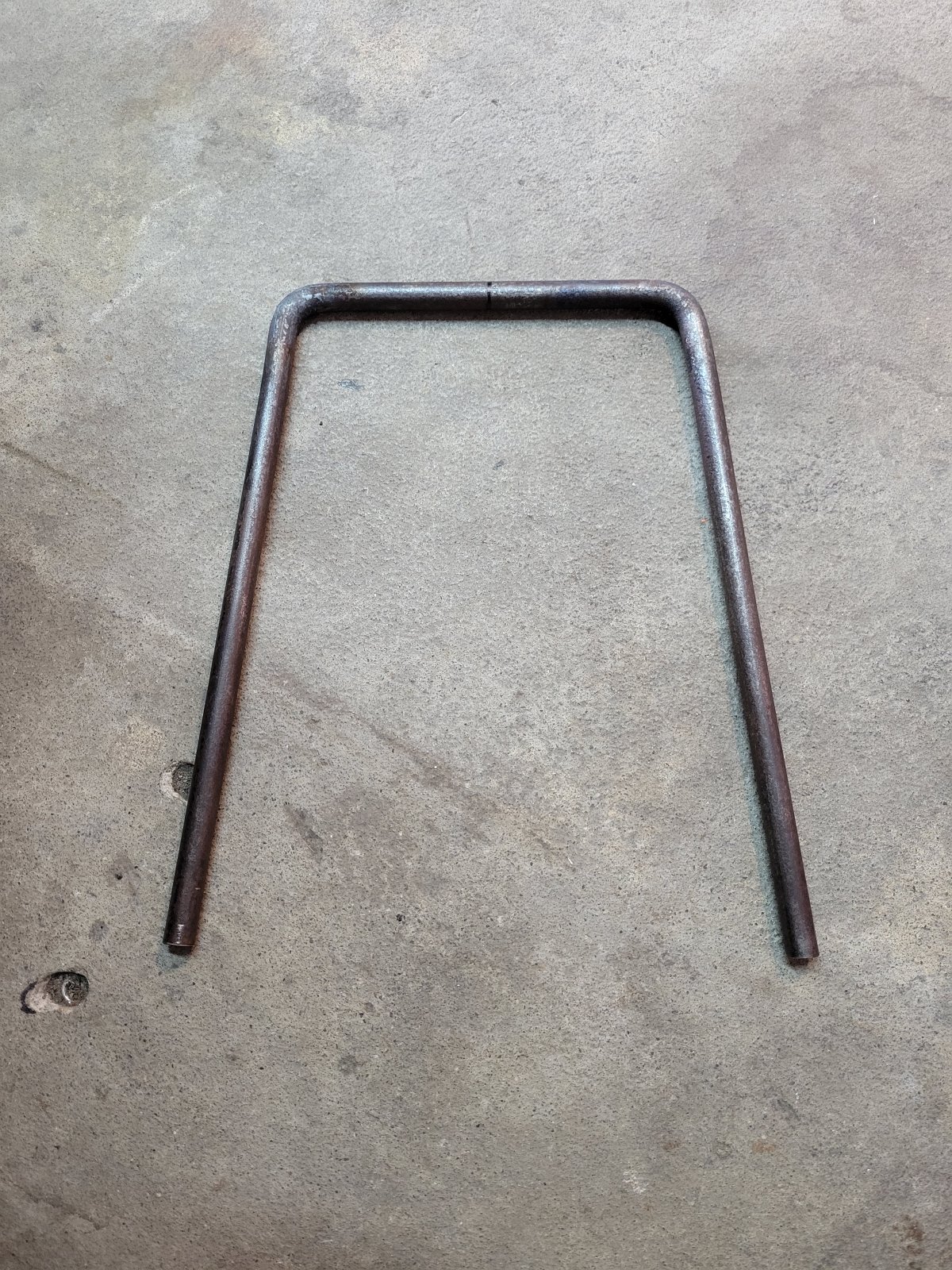

    Now it's time to figure out a gas pedal, my hip is way to the right of the foot well area so it's a little tricky coming up with something that'll be somewhat comfortable.
    Dug out all my gas pedals to get some ideas, spent the afternoon heating and bending a stock pedal to see if I can figure out pivots and what not.
    20231013_173028.jpg 20231013_173020.jpg 20231013_173111.jpg 20231013_173537.jpg 20231016_171824.jpg

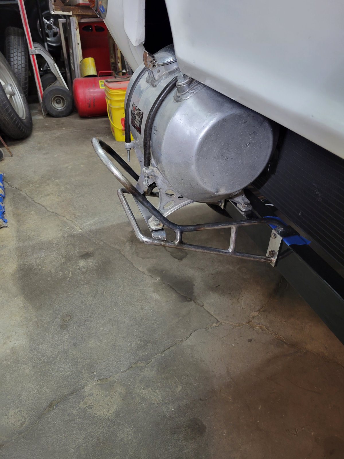

    I got the tank bracket back from the powdercoater, turned out nice
    Got it permanently mounted this afternoon, good to see the tank back up front

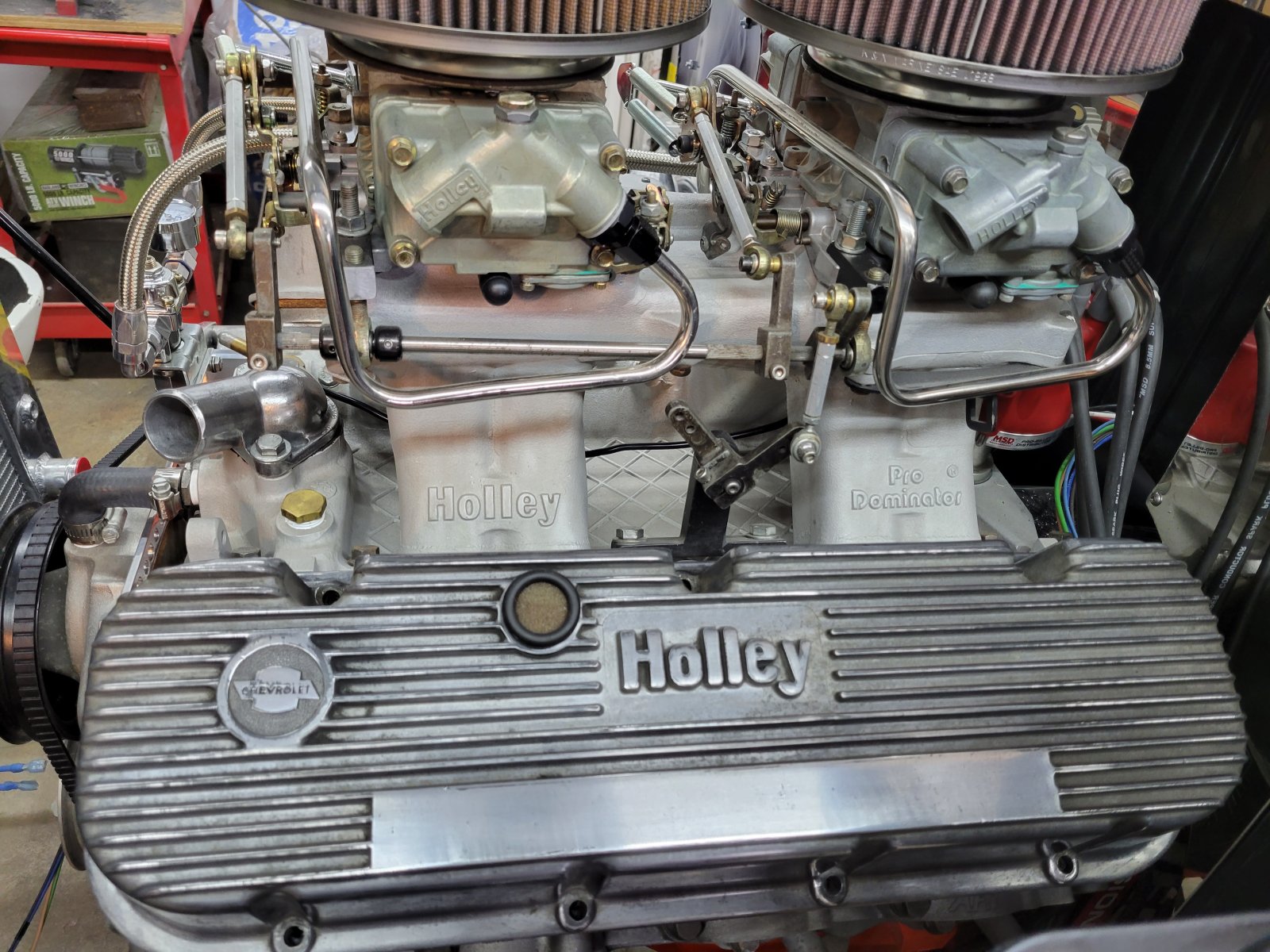

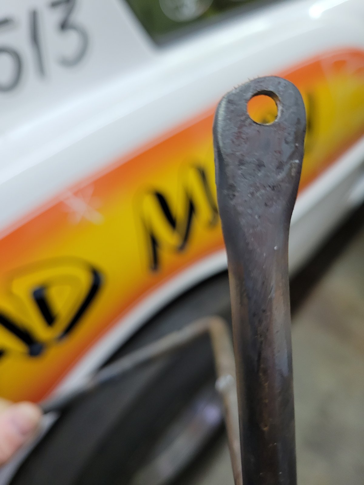

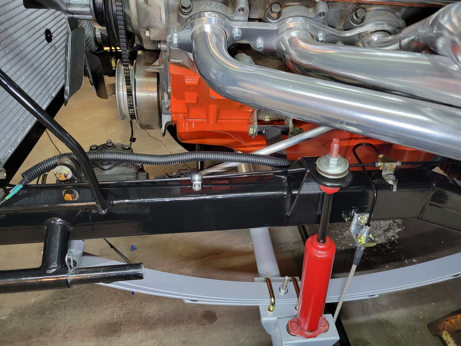

    Time to figure out the linkage from carb to gas pedal, Enderle linkage at carbs.

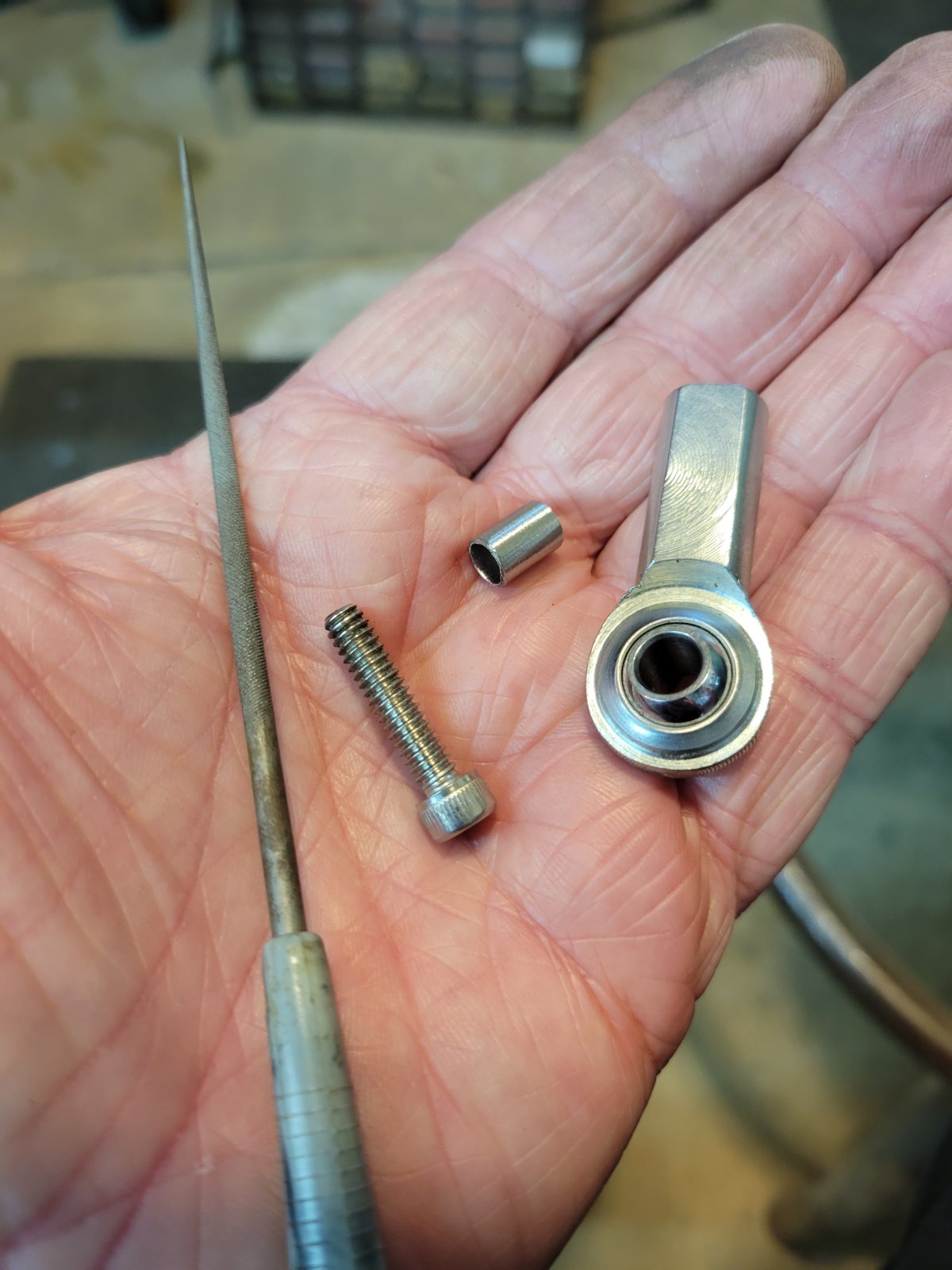

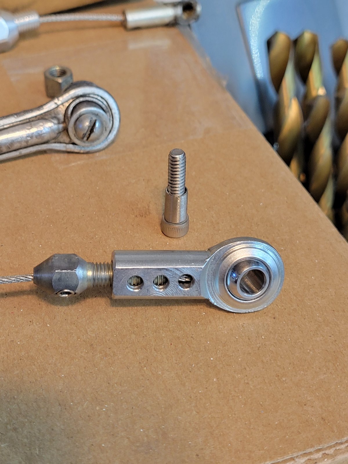

    I had a couple of the Lokar type cable linkage setups but they were ball end connection, they don't make a 10-24 thread ball end to screw into the Enderle arm. I thought about trying to turn a socket head cap screw or a pan head into a ball type thing to make it work.
    I was digging through my stash of linkage parts and found pieces that would actually screw together to make the ball end parts work with a rod end that was for some fake injector scoop contraption thing.
    I just needed to sleeve the hole in the bearing so the 10-24 bolt wasn't so sloppy.
    I grabbed some stainless tube, turned the o.d. down on the belt sander, then drilled out the i.d., cut it to length then used a jewelers file to fine tune the i.d. from the cut.
    Put some speed holes in the rod end to lighten it up a bit, this all should work once I cut the cable and housing to length.

    Engine side is done but not without an "extra" hole in the firewall.
    Drilled my initial hole straight in line with the linkage, drilled from the engine side, went to the inside of the car to drill the hole larger, but where's the hole ???
    The hole was behind the dash, not really an issue because I could just keep drilling from the engine side. The real issue was the recessed firewall is so close to the dash it would only allow about a 1/4 of needed throttle pull before the gas pedal arm would hit the dash !
    I studied it for about an hour trying to come up with a work around so I wouldn't have to drill a new hole, finally I gave up and drilled a new hole an inch lower ..... ugh

    I took a couple junkyard gas pedals, straightened them out and used both to make one, then flattened the one end with the BFH
    Then I bought a block of machining nylon off of Amazon to make a couple "bearings" if you will, then made a sort of cage to hold it together and be able to bolt to firewall
    Everything worked except the ratio was way off, to much pedal travel to pull the 2.5 inches of cable I need for full throttle

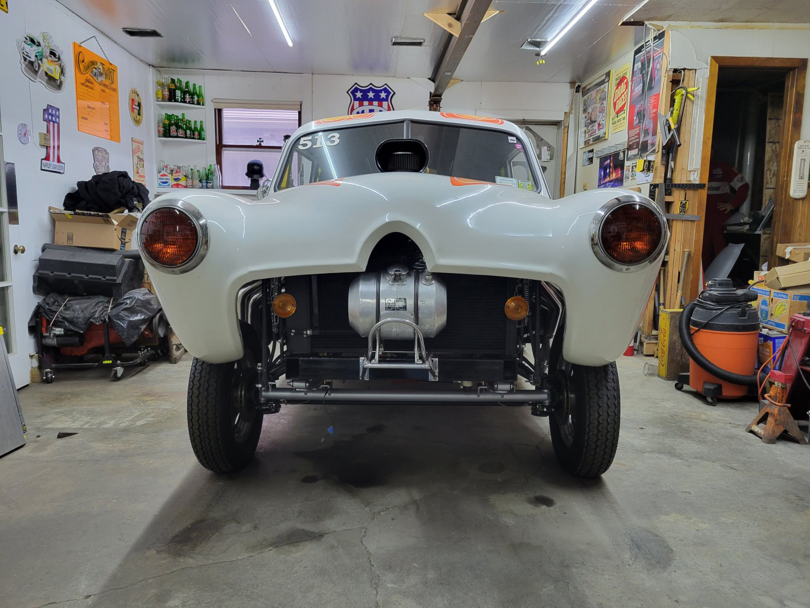

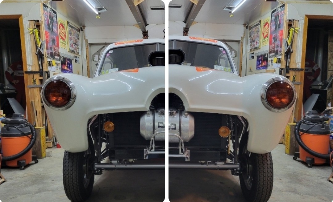

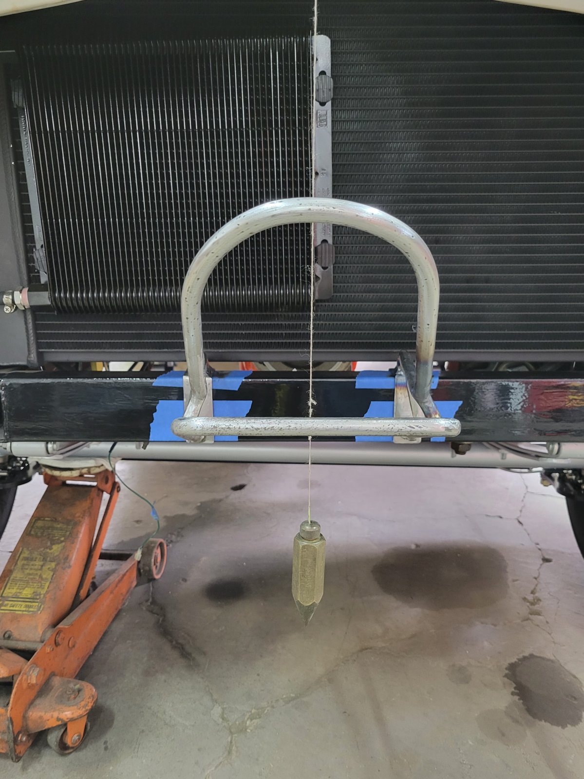

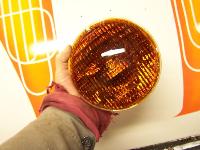

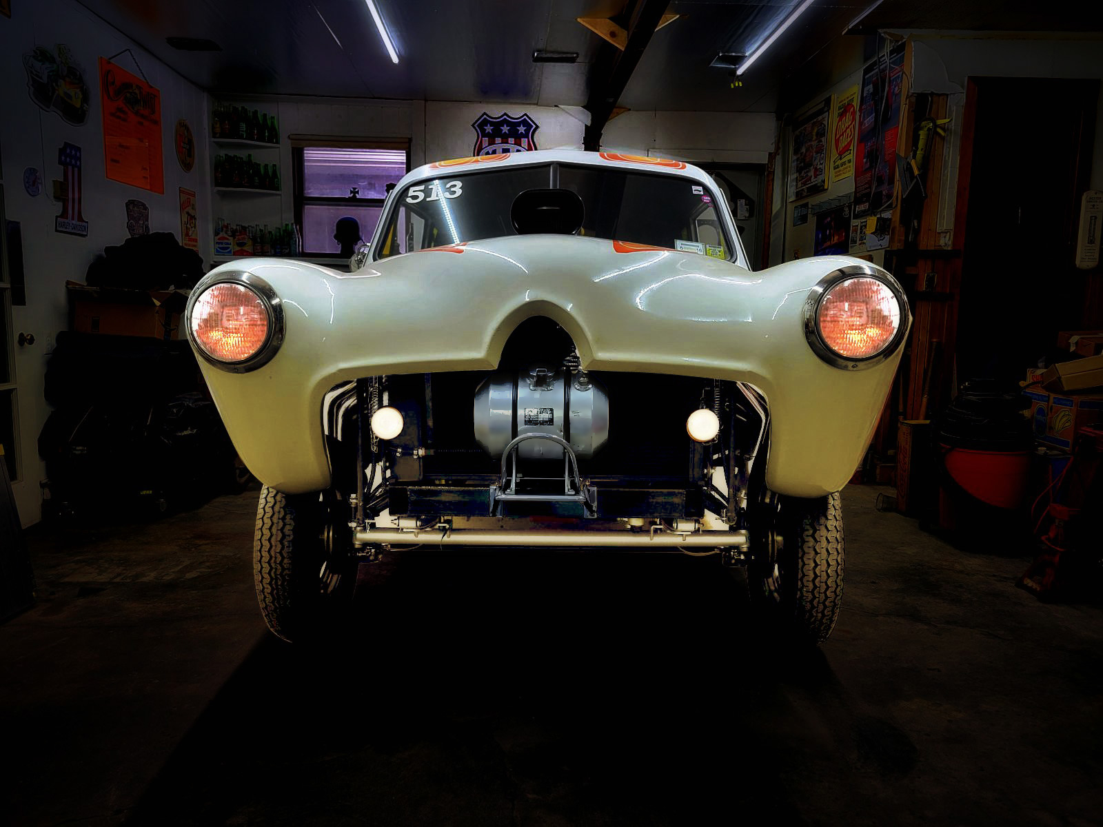

    I moved on to front turn signals, previously I had the little rectangles which I never was to excited about but they got the job done.
    This time I wanted round to match the roundness of the front end, I traded for some motorcycle units, removed the stalks and started the mockup phase.
    Centerline of tank
    Down low on frame horn
    And center of grill opening, which is what I'm leaning towards, will also swap to clear lens so there's not two different colors of orange with the headlights
  13. Stogy
    Joined: Feb 10, 2007
    Posts: 27,523
    Stogy
    I like them High up but probably better lower to keep them away from being lost in Headlight beams...This type of stuff really needs to be seen...the bottom one is after to much gas fumes...or its playing Cars with you...:D
  14. VI Lonewolf
    Joined: Sep 2, 2017
    Posts: 95
    VI Lonewolf
    What about putting them in the tilt front, low under the headlights?
    Stogy likes this.
  15. swade41
    Joined: Apr 6, 2004
    Posts: 14,999
    swade41
    from Buffalo,NY
    I'm not cutting on the body, don't need to open that can of worms
    59Apachegail, mad mikey and Stogy like this.

    These headlights are naturally kind of dim with their color, they don't overpower anything, especially the road. I live in the city where there's a million street lights and I rarely drove it at night anyway.
    Sweet as Tupelo honey
  17. Do you know the name of the chrome powder used on the tank mount? It looks really good in the pictures. I had some parts powder coated a couple years ago in a chrome powder, but it looks more like dull aluminum. Thanks.

  20. Stogy
    Posts: 27,523
    Stogy
    In that case the tucked up in look fricken awesome...you might want light them up to further give you the feel you want out of them....
    swade41 likes this.
  21. swade41
    Joined: Apr 6, 2004
    Posts: 14,999
    swade41
    from Buffalo,NY
    I marked them out for the middle of the grill, I liked that the best when I compared them side by side (right side) in my fake photoshop lol
    Made the tabs that I'll weld to the radiator support and have it all marked off, tomorrow I'll knock the paint off, weld the tabs on, then repaint.
    mad mikey, loudbang and Stogy like this.

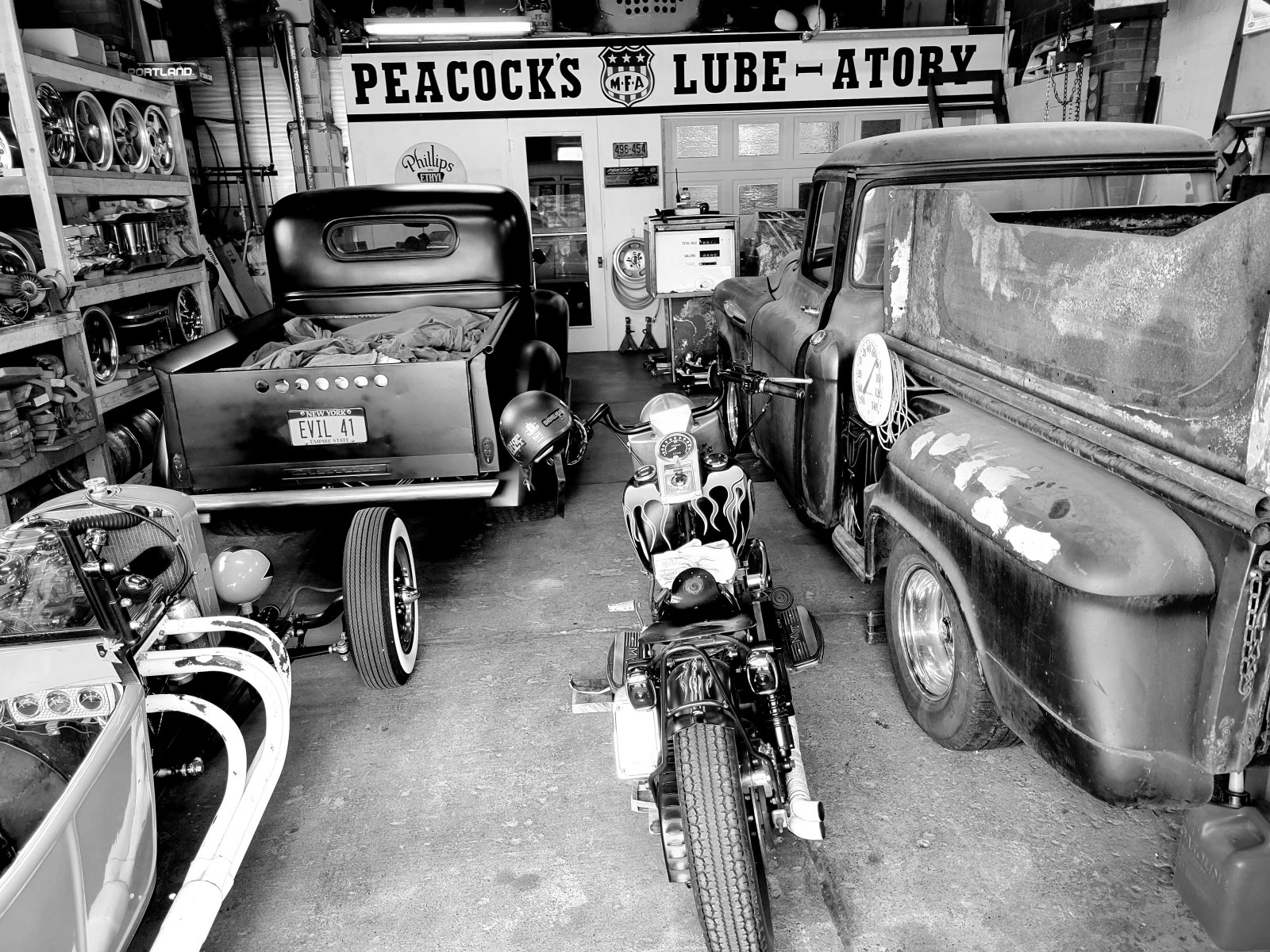

    I'll figure out the horn location while the paint is drying, then all that's really left is to build exhaust and chase all the new car blues.
    The next milestone will be it leaving the garage under it's own power, which will be a chore and a half moving stuff to get it out.
    My plan is to slide the non running 57 pickup over to line up with the garage door and out the door on the driveway apron, after I move all the **** I put behind the truck.
    Then move all the **** that's in front of the interior garage door where the J is
    Throw the J on dollies and slide it around the corner to come out that door, move the t-bucket out, then I should be able to cut behind the 41 with the J and out the door the t-bucket came out of.
    Then put the 41 pickup on the dollies give it a 180 degree spin and move it into the spot where the J used to be in the interior garage. Then bring the 57 back in to where it was, then the J in where the 41 was and the bucket back in last so it's by the exterior garage door.
    It's going to be a long freaking day of moving the same stuff 2-3 times over, the pitch on the floor is horrible to get anything not running back in.

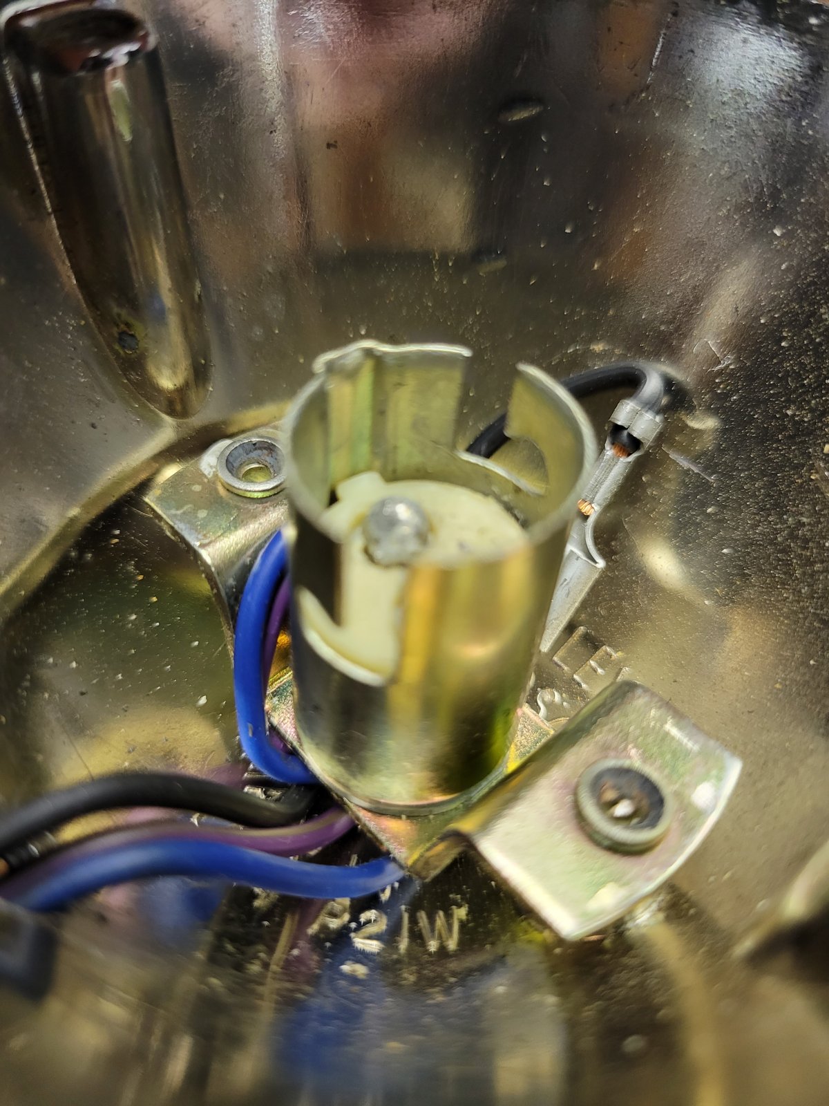

    Today I bolted the turn signals up for a look see, I like it but I'm having a heck of a time find lenses to fit these housings, I've been Googling my *** off to no avail.

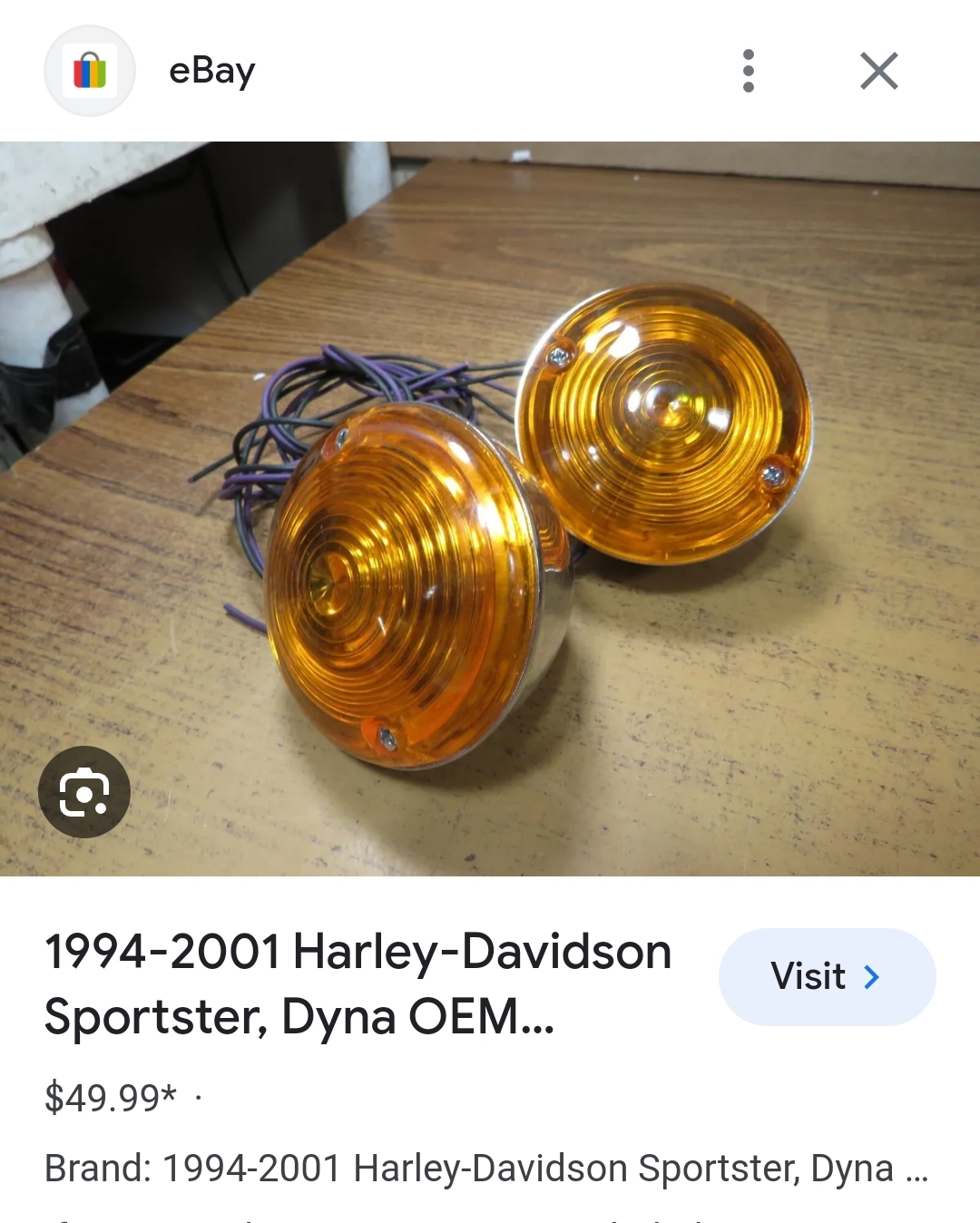

  30. swade41
    Joined: Apr 6, 2004
    Posts: 14,999
    swade41
    from Buffalo,NY

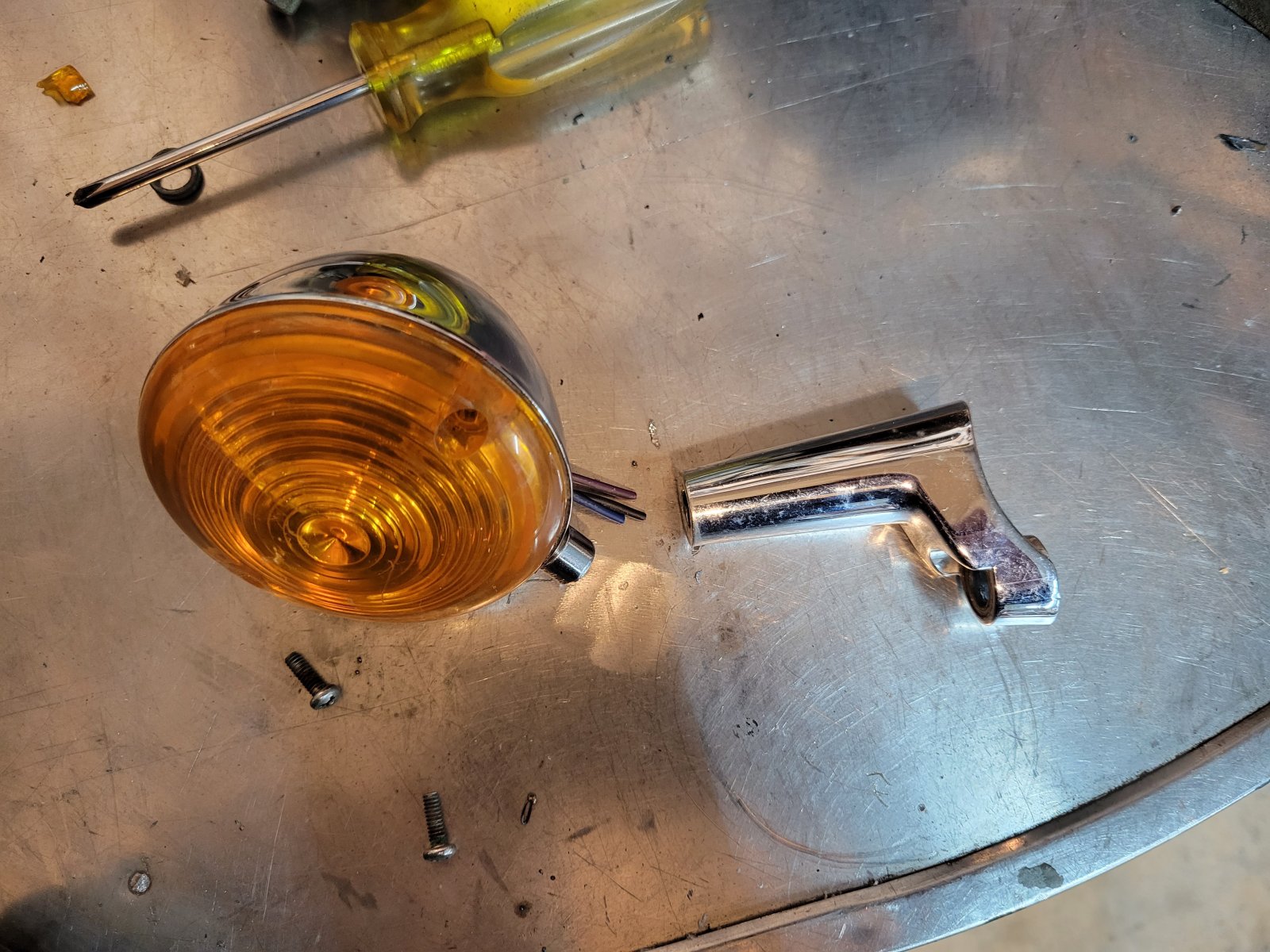

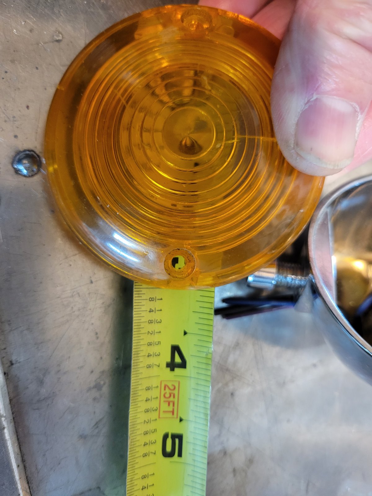

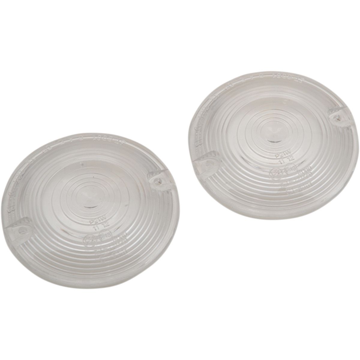

    They are 3 inch (77mm) and bolt hole spacing is 2 7/16 (62.5mm)
    I've kinda narrowed it down to being a 1994-2001 sporster/dyna housing but can't find the flat lense, plenty that look like a cup though. Plenty of 3 1/4 flat lense that fit FL and oddly the part number comes back front rear FL but this housing is smaller and different base than a FL
    20231112_174547.jpg 20231112_173923.jpg 20231112_173933.jpg 20231112_174444.jpg 20231112_174501.jpg
    I found these on ebay and they look identical, but when I Googled every year listed they were all the cup style lense. Mine have 3 wires and these have 2, but other than that they look the same.
