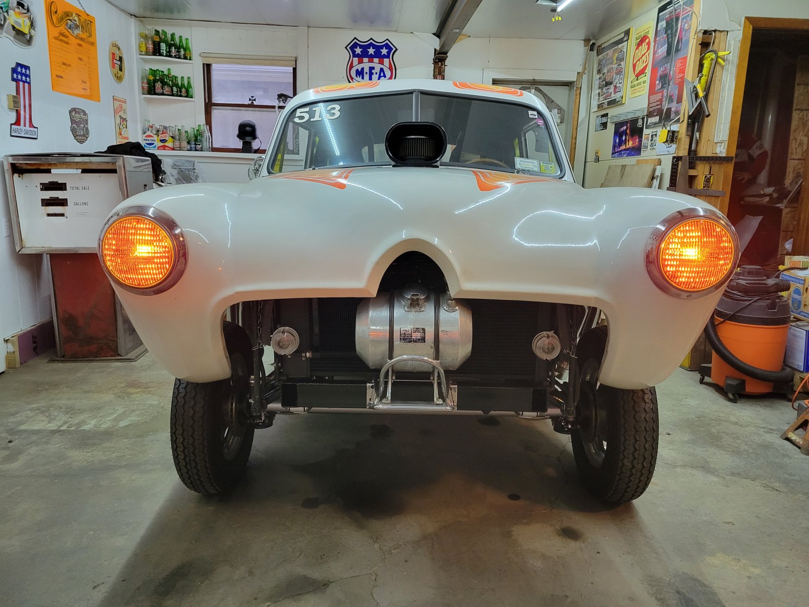

    I just ordered some smoke flat lenses for a sportster, should be here next week, hopefully they fit.
    Now in the mean time I'll put the driveshaft loop in, nice powdercoated piece
    Chucky, mad mikey, Stogy and 6 others like this.

    Of course the package arrived today with a single clear lens, going back and forth with the seller trying to either sending it back or getting the missing lens sent.
    I stuck it in there for a look see, clear doesn't look to bad but I think the smoke would look a little more subtle.

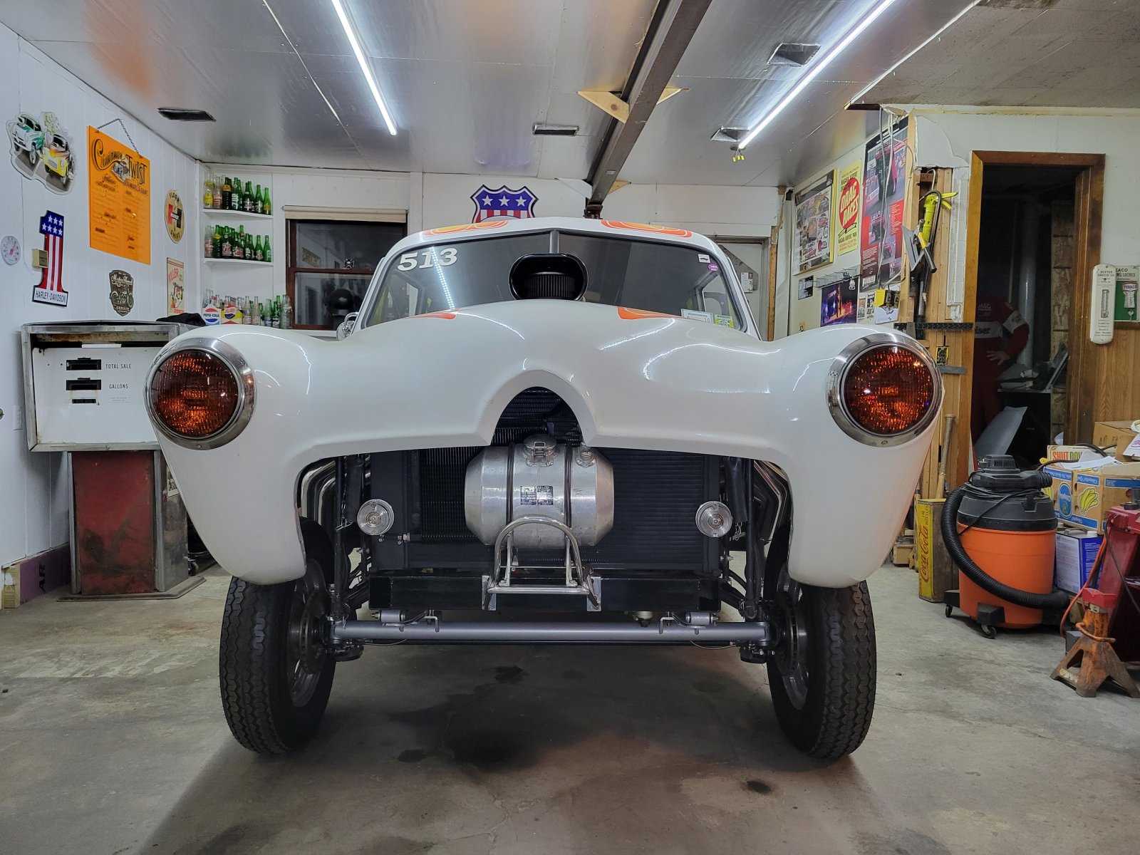

    Batting a thousand today, lenses showed up, although they were said to be domed
    Only photo listed
    Damn things are the cup style ... ugh
    Not bad from head on
    Then I dropped one and broke the damn thing !

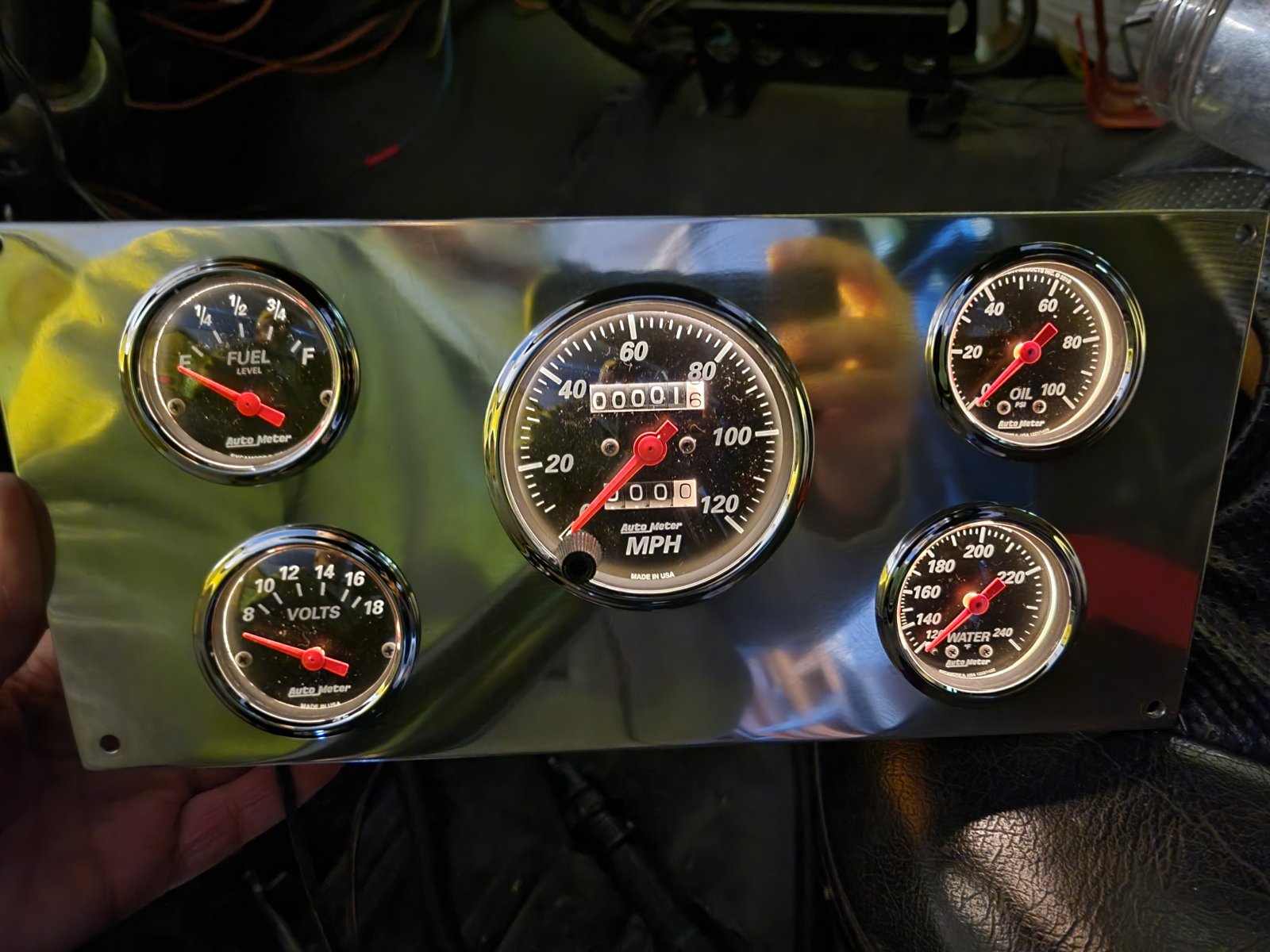

    To continue, remember when I posted my dash lights and license plate lights working
    Yeah, they don't f'ing work anymore, no lights at all work and the horn doesn't work !

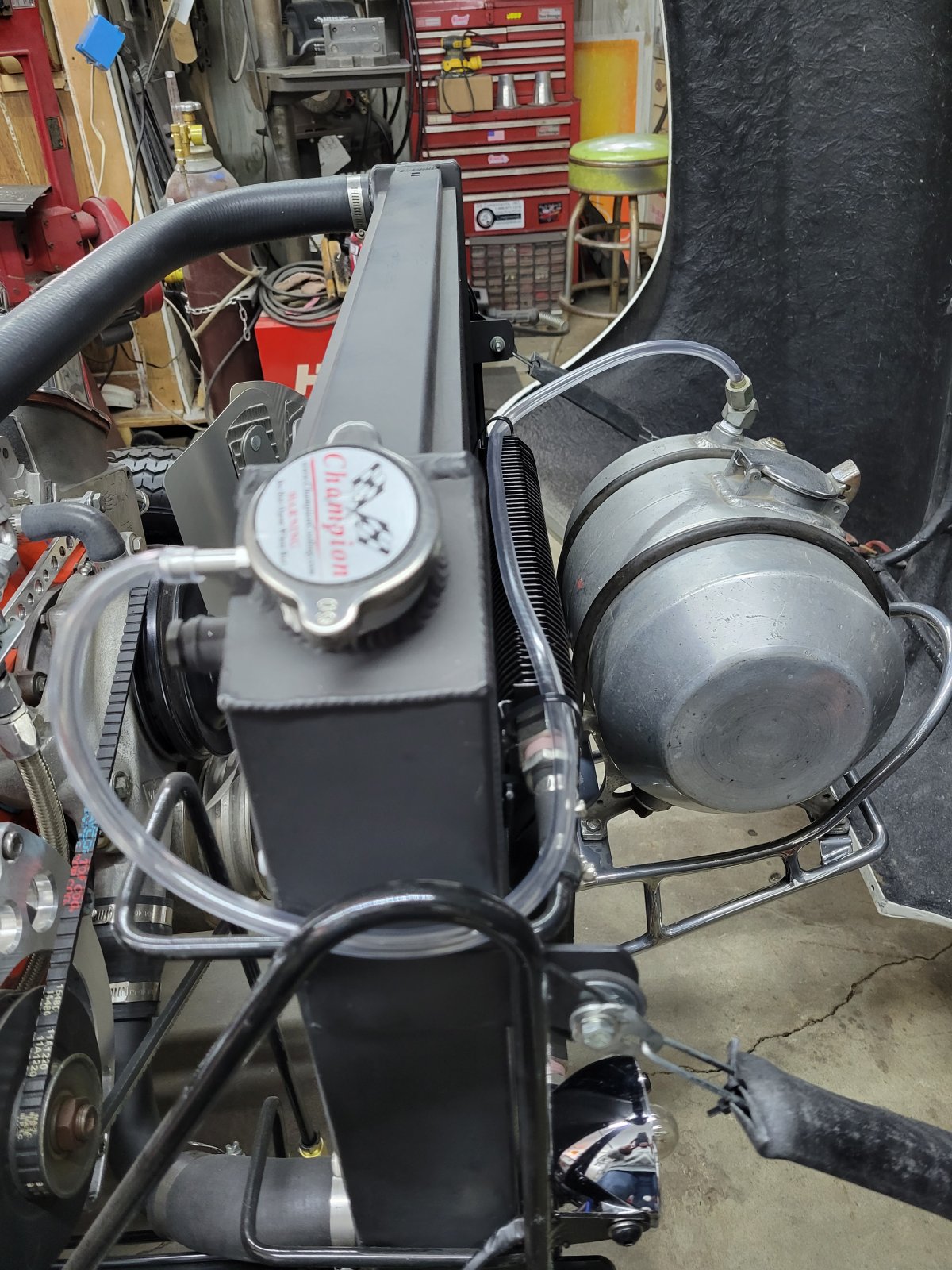

    And also used some clear tube for the radiator overflow to Eelco tank

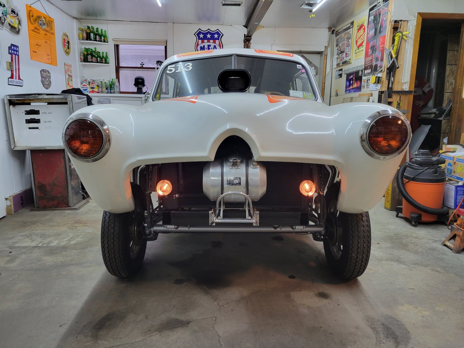

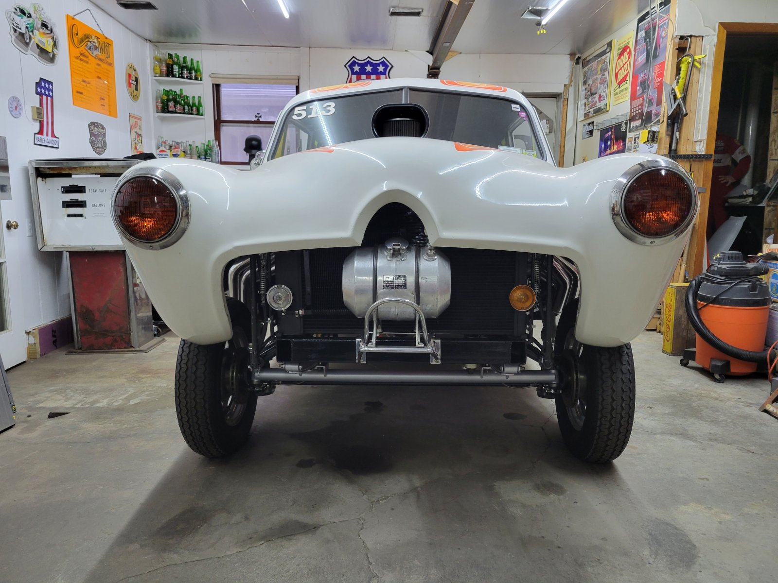

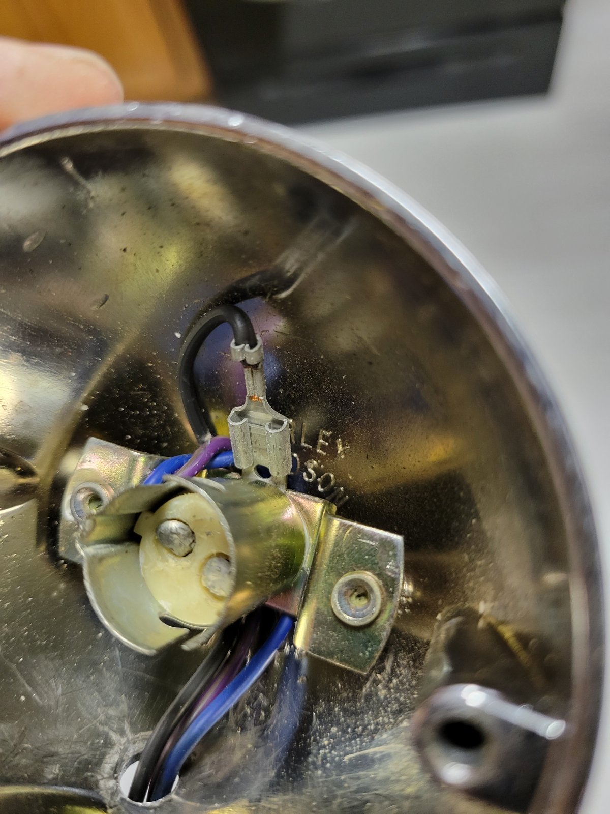

    When I wired these lights I ran blue to blue in my harness and the purple to the harness brown, there's only 2 wires so I figured that was correct.
    Yesterday when I was checking the turn signals I noticed the tallest filament was lighting, honestly I never paid attention to which was what and what was which on other wiring jobs.
    After some research last night it said the short thicker filament was for turn signal, so I knew those were backwards, could that somehow be my culprit.
    My plan of attack was to correct that first and see, of course I flip flopped the bullet ends so they would lay nicer in the harness so I knew I would need to replace 2 ends and of course I cut the wires for no slack. I managed to stab myself only once opening up the crimps to get the wire back out, took forever.
    Well, that didn't help the no lights situation, so next I unplugged the headlights, still nothing, plugged those back in. I was trying to remember what all I changed after checking the dash lights and taillights a few months back, one thing was I had the two spades on the alternator backwards. I reversed those but still no lights, so I put them back the correct way, what next, let's check the gl*** fuse in the headlight switch for continuity, even though it didn't look blown last night.
    I pull the headlight switch out of the column drop to make getting the fuse out easier than last night, electrical tape is still in between the tight fitting wires and all wires are tight. Test the fuse with ohm meter and it's good, sanded the ends of the fuse just to make sure the connection was good, let's sand the switch too, just to make sure.
    I put the fuse in, double check it isn't hanging out the back to far touching that terminal in the back, all was good, next step was to check for power going into the switch, hang on, let me just check the lights before moving to the next step, one modification at a time please.
    Pull the knob and the dash lights come on, hot damn !, check parking lights and they're on too ! Now I'm wondering if the switch wires was somehow grounding on something but not blowing the fuse ?
    I put the switch back in the column drop, but instead of the wires pointing up towards the dash I put it in so wires are on the side, not as neat looking but no chance of making contact now.
    427 sleeper and Stogy like this.

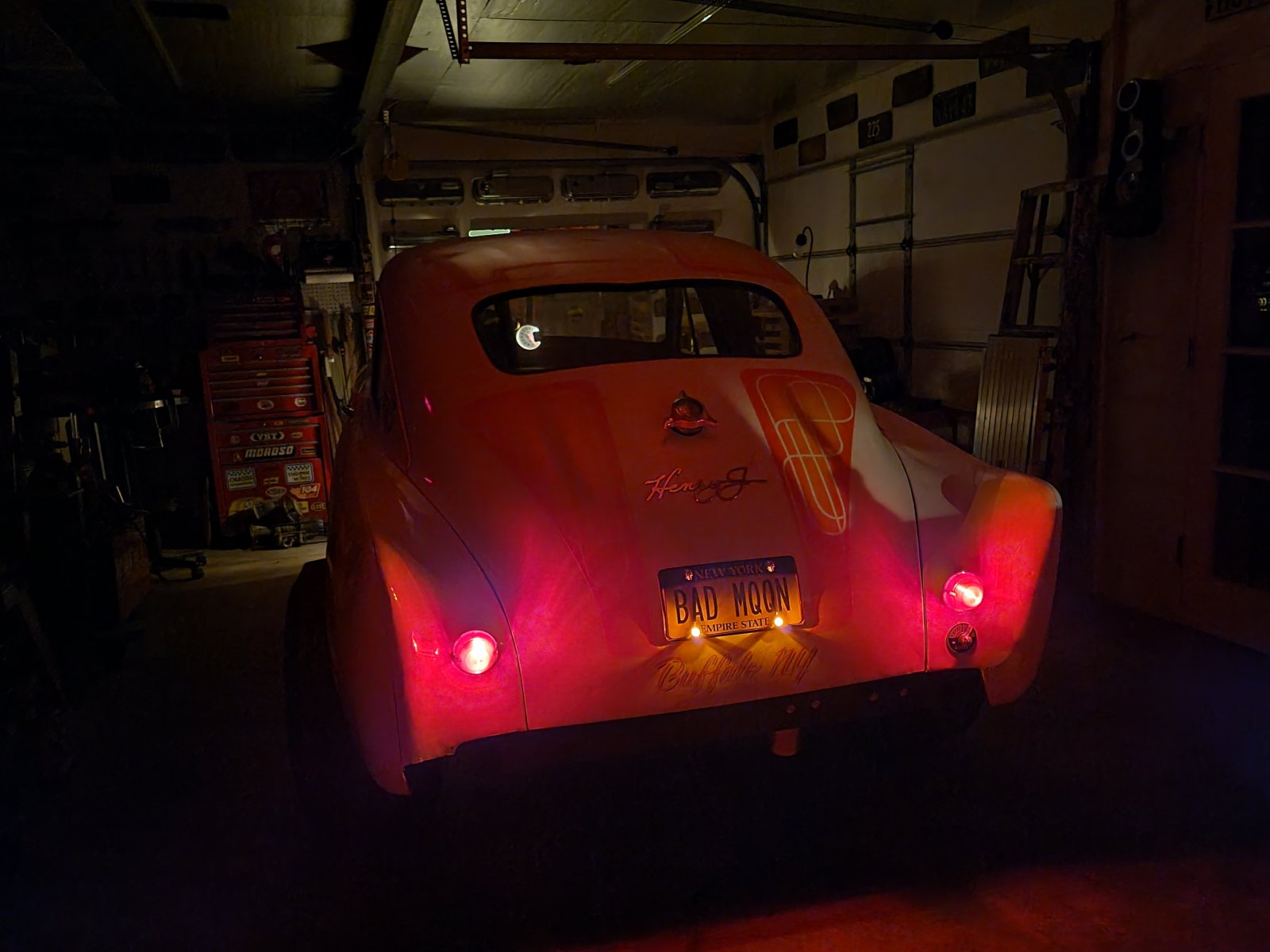

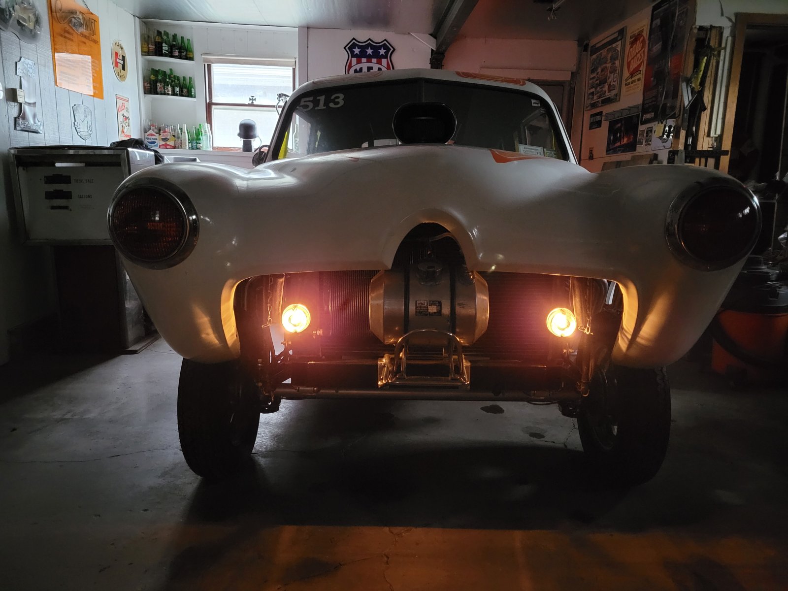

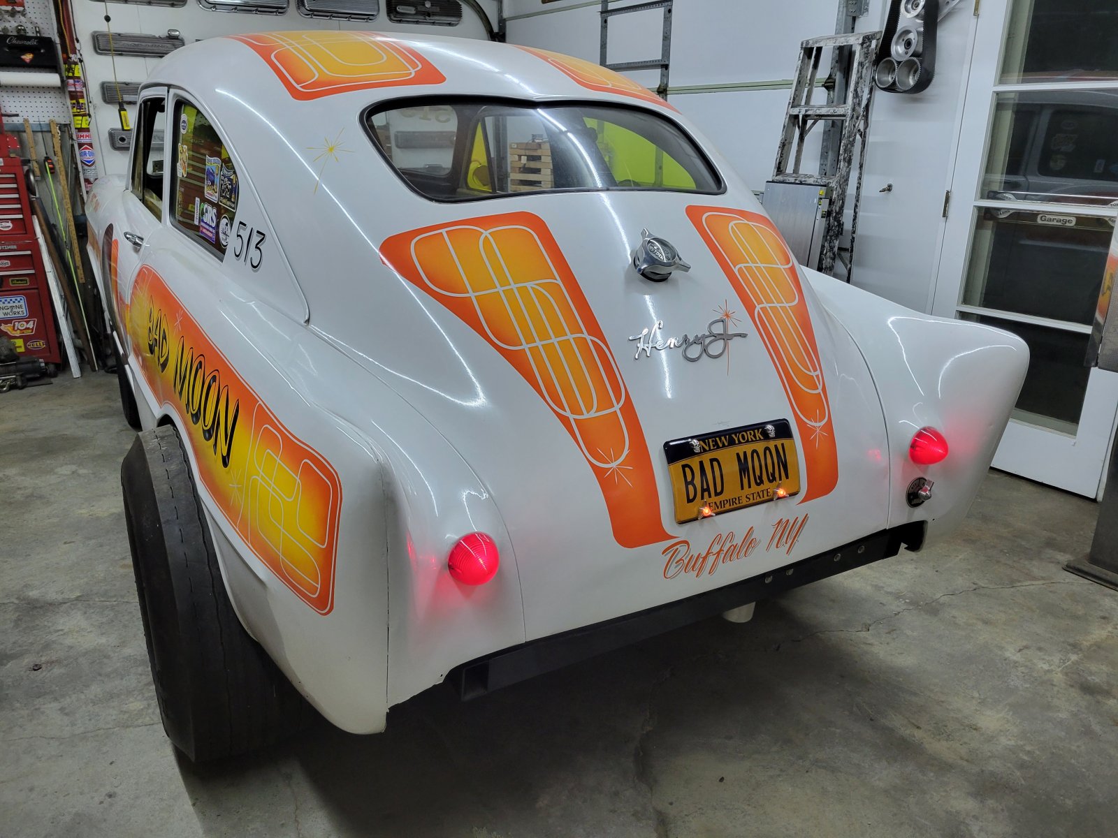

    Now I can't wait to see the whole enchilada with headlights and parking lights lit up, will the parking lights give the Eelco tank the ufo glow ???
    Pull the switch all the way out, damn, 9 yrs is a long time to remember that the parking lights don't stay on when the headlights come on.
    It would've looked epic though
    Let's check the rear
    And in the dark
    Those parking lights put out some light up front

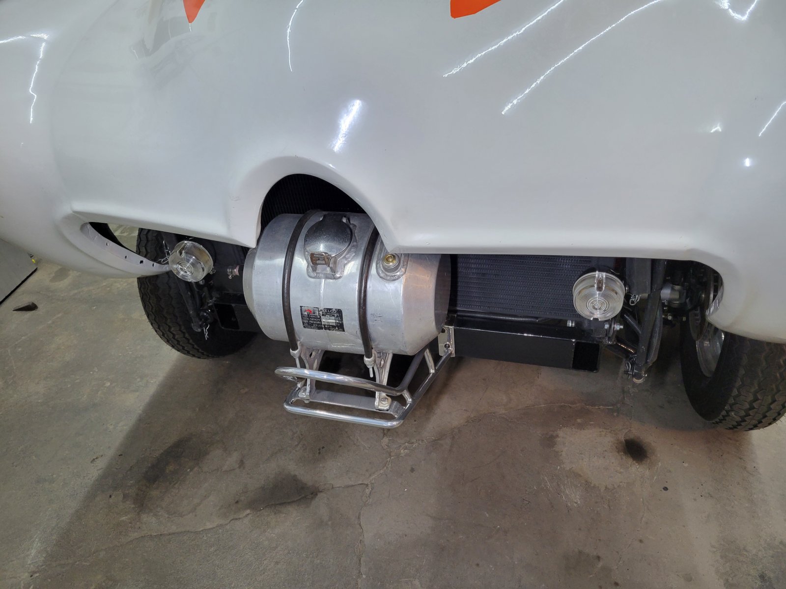

    Let me trouble shoot the horn since the lights worked out.
    Hmmm, how can I test if the horn is getting power with the multimeter by myself ??? Let's pull the horn off and test it first since I swapped mounting straps on it, which also doubles as the ground.
    Hook it up to the battery charger, HONK !, that's working ! Let me clean up the motor mount since I'm using one of the bolts for the mount/ground, still no honky.
    Now how can I check for that power, let me go inside and double check the switch for ground, looks good. Get the multimeter hit the ****on and nothing, what the hell I need three hands to hold these and push the ****on, let's try it again, nothing. Looking at ****on I push it again, nothing, let me rapid fire this ********er, hit hit hit hit HONK !, whoa, scared the **** out of me lol
    Turns out it was dusty and crusty from sitting, since I'm on a roll here I'll make up the ground strap from motor to frame and there you have it, a successful day !
    Can't hardly see I mounted the other end to the shock bracket for ease of getting to it.
