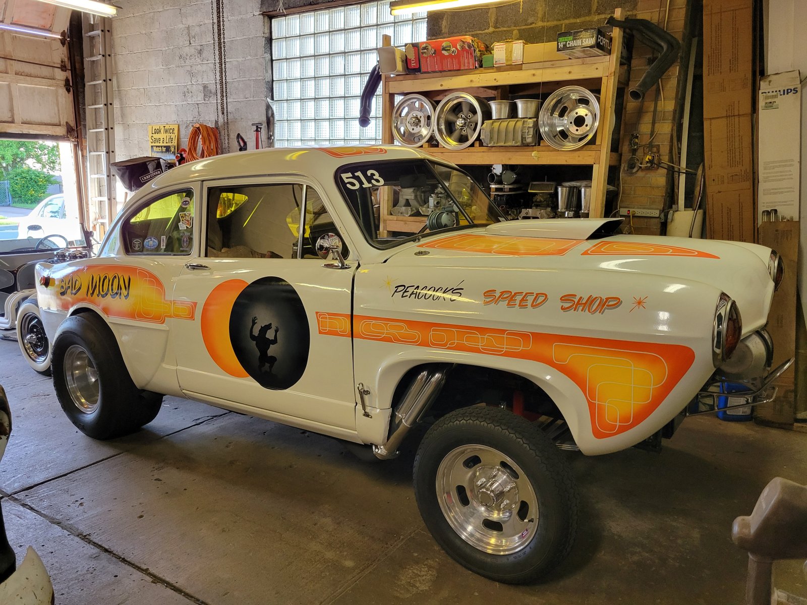

  3. swade41
    Joined: Apr 6, 2004
    Posts: 14,999
    swade41
    from Buffalo,NY
    I seen a Viking ship and Odin
    20240408_151017.jpg 20240408_150216.jpg 20240408_152010.jpg 20240408_152155.jpg

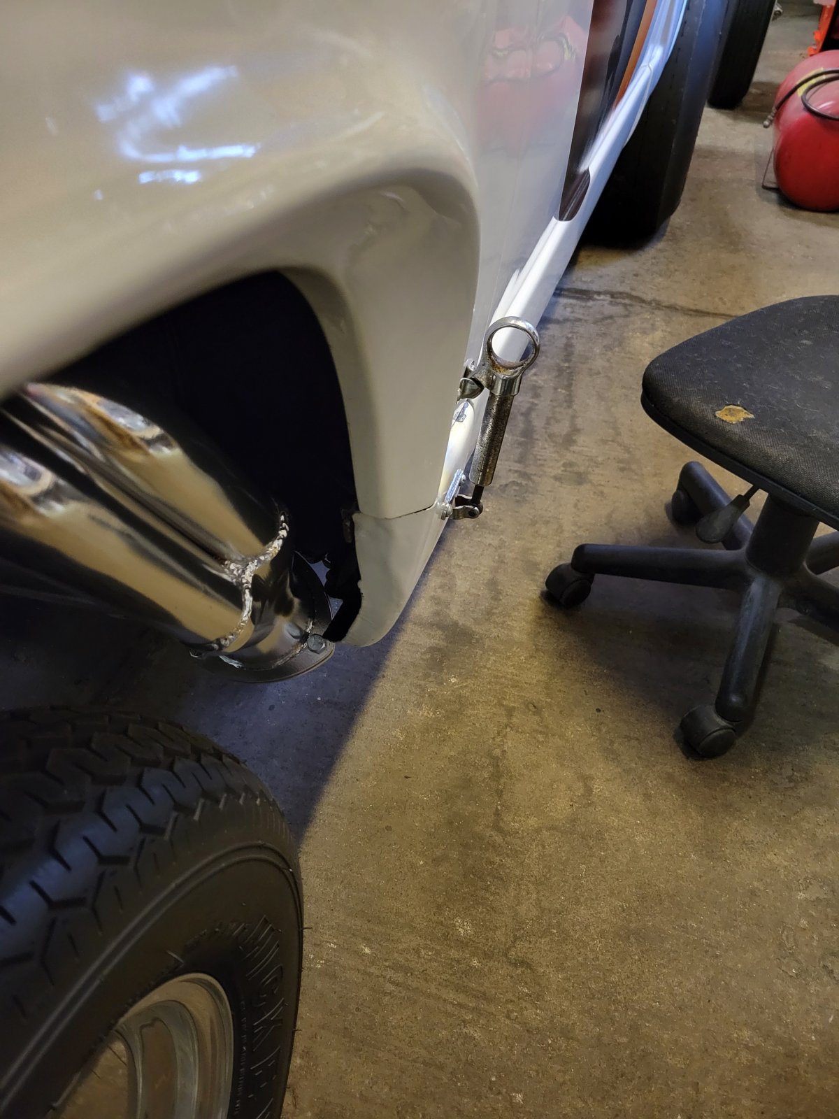

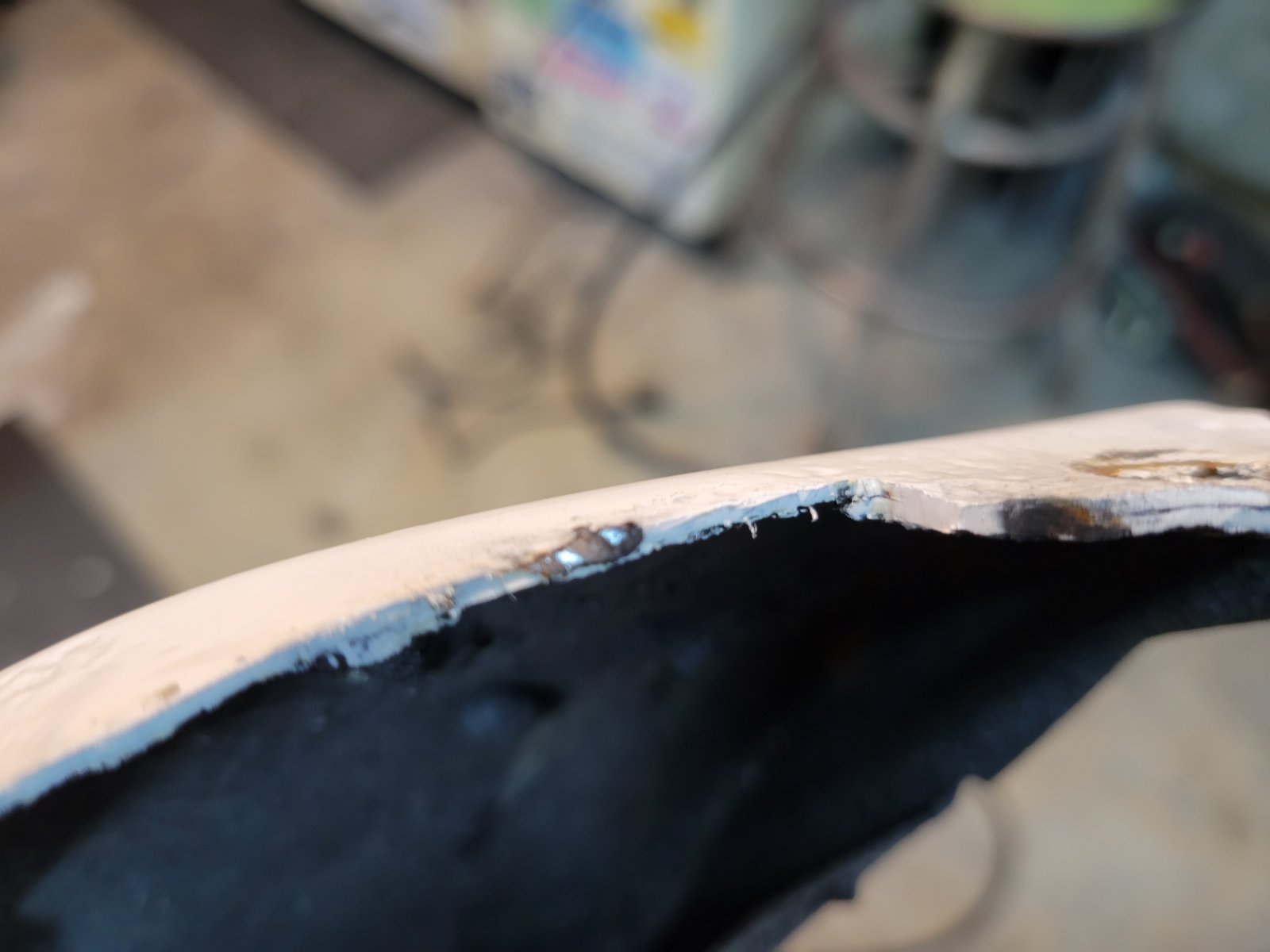

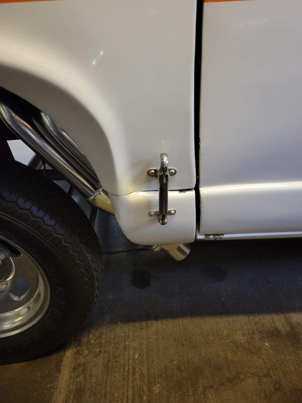

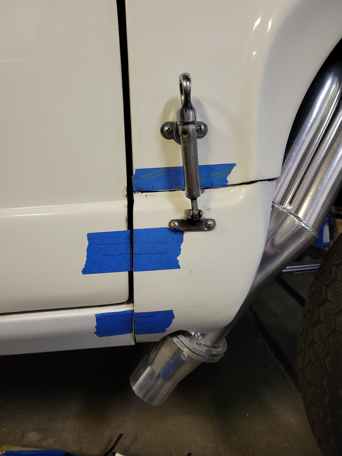

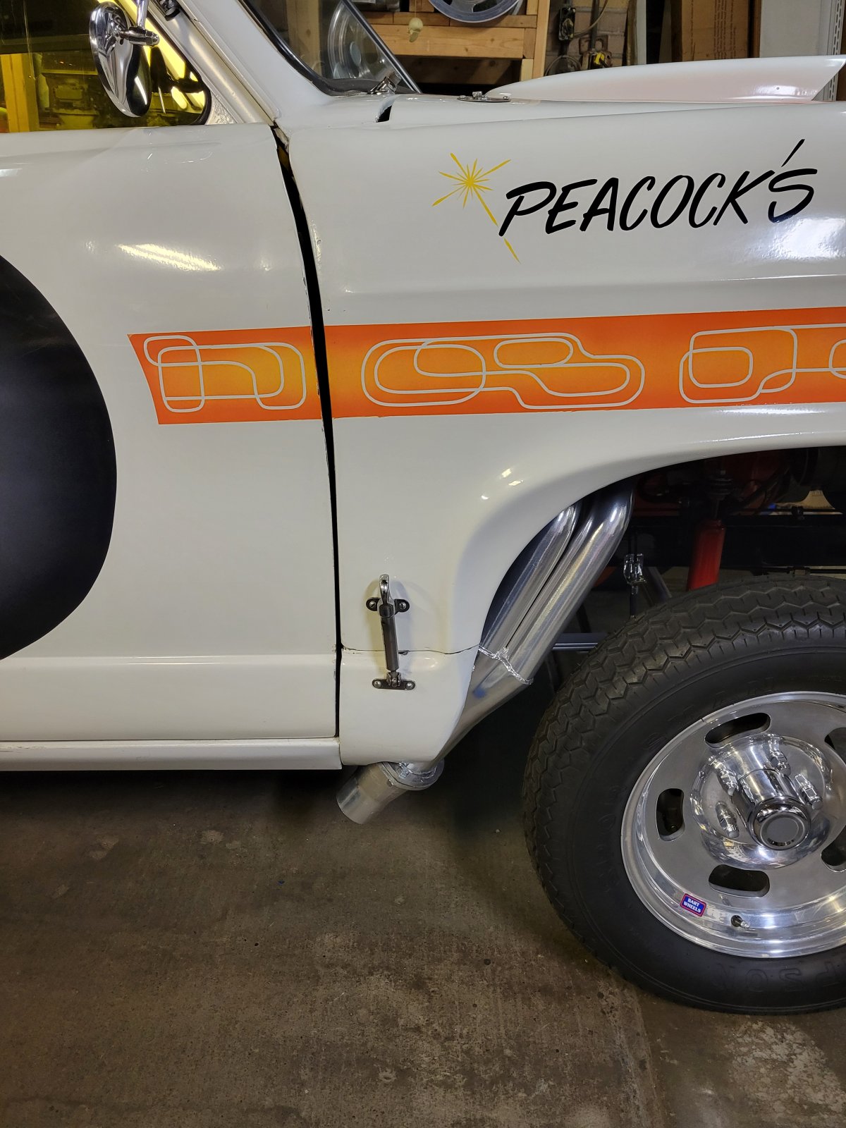

    I've been working on the lower front fenders, the collector takes up the space where they want to be, a problem I didn't have with the old sbc.
    Screenshot_20240430_001011_Gallery.jpg 20240409_164211.jpg 20240409_164243.jpg
    Cut up the fender to work around the collector
    Lined it up and made a new lower mount because I cut the original off
    Put a tab on the fibergl*** side and cut a slot in the lower so it could slip in like they were on their honeymoon.
    They're so happy together
    Driver's side was easier since come to find out the p***enger header sticks out 1 5/8's inch further away from the block than the Driver's side, damn quality control issues. Also that side is a little further forward because of the head placement on the engine.
    I'll pull it all back apart and touch up that fabulous Rustoleum white and bolt the lowers on for good.

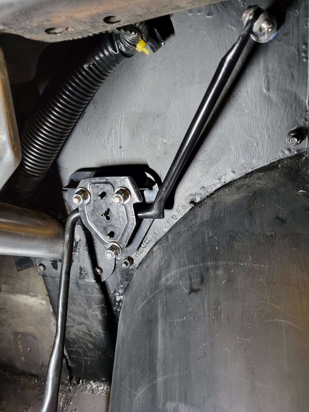

    When I had taken my test drives before winter the throttle linkage wouldn't fully return to idle, it hung around 1400 rpm, a slight lift of the pedal would return it to idle.
    When I made the throttle pedal I put it a little over center when at rest so it would pull the cable straight out of the hole at half throttle, the spot it'd be in more than at rest. That was what was causing it to not fully return to idle, so I cut the short side of the pedal arm in the middle a 1/4 of an inch, welded it back together and gave it a new coat of paint.
    I also drilled it for the little roll pin to keep it from sliding left/right and possibly going over center of the hole again.
    It fully closes now and should be fine but won't know until I get another test drive in.

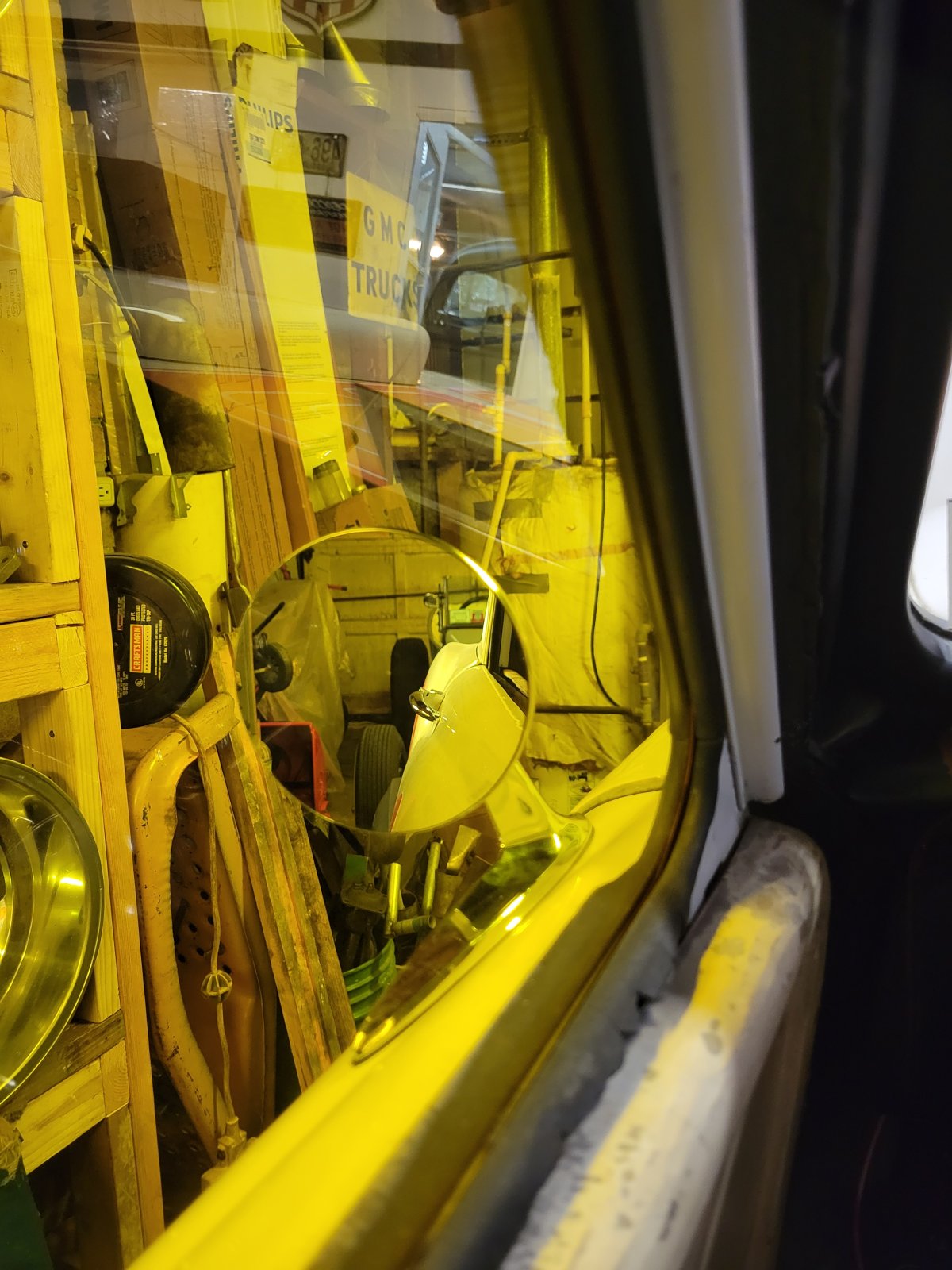

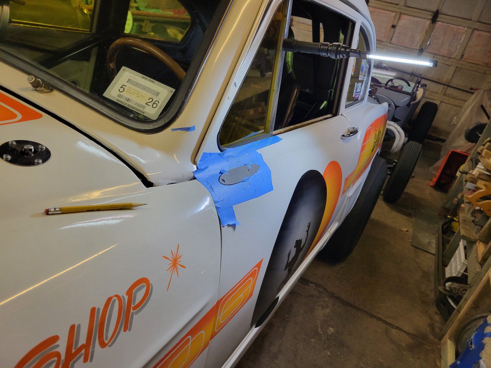

    Spent an agonizing afternoon figuring out where to drill holes in my doors.
    Previously I had clamp on peep mirrors but wanted something different since they had a whole lot of shaking goin on. I looked and looked at different types of mirrors and finally settled on 56 chevy, I liked the round mirror head, the pointy thing on the stalk and the teardrop shape base.
    Now I can see the coppers sneaking up behind me

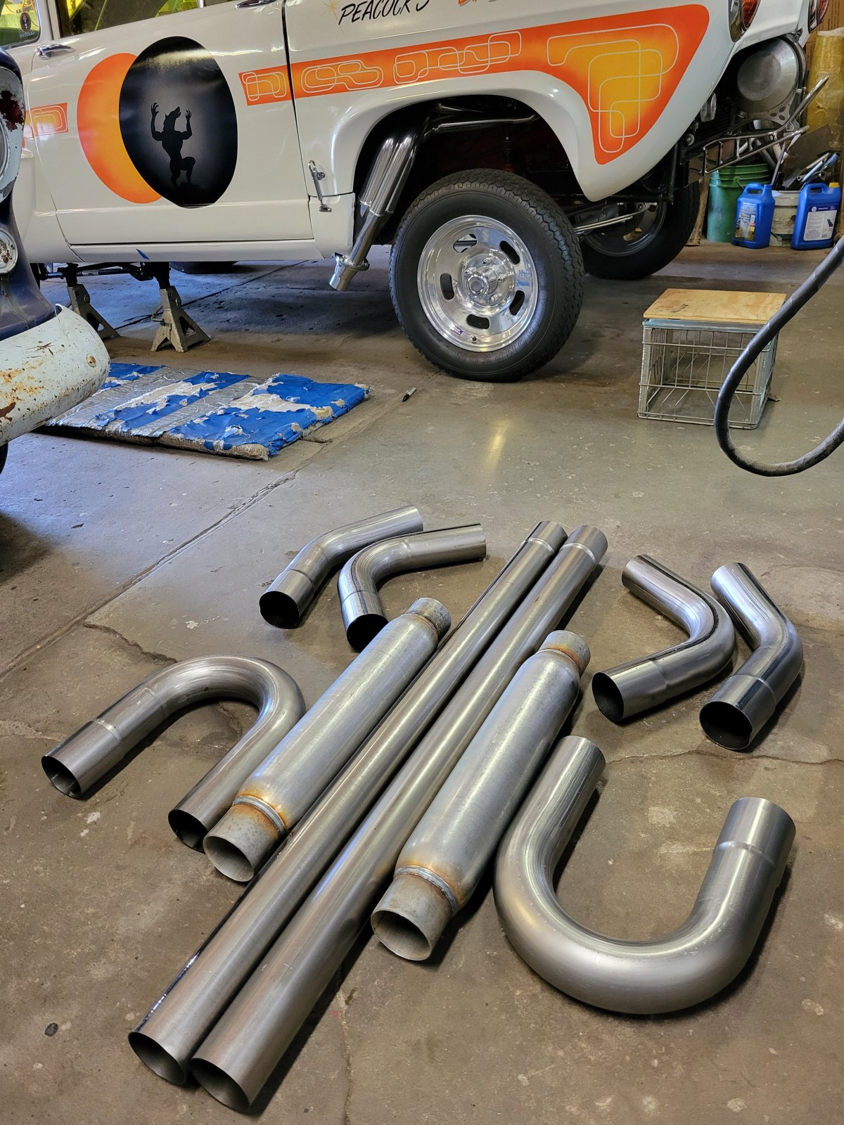

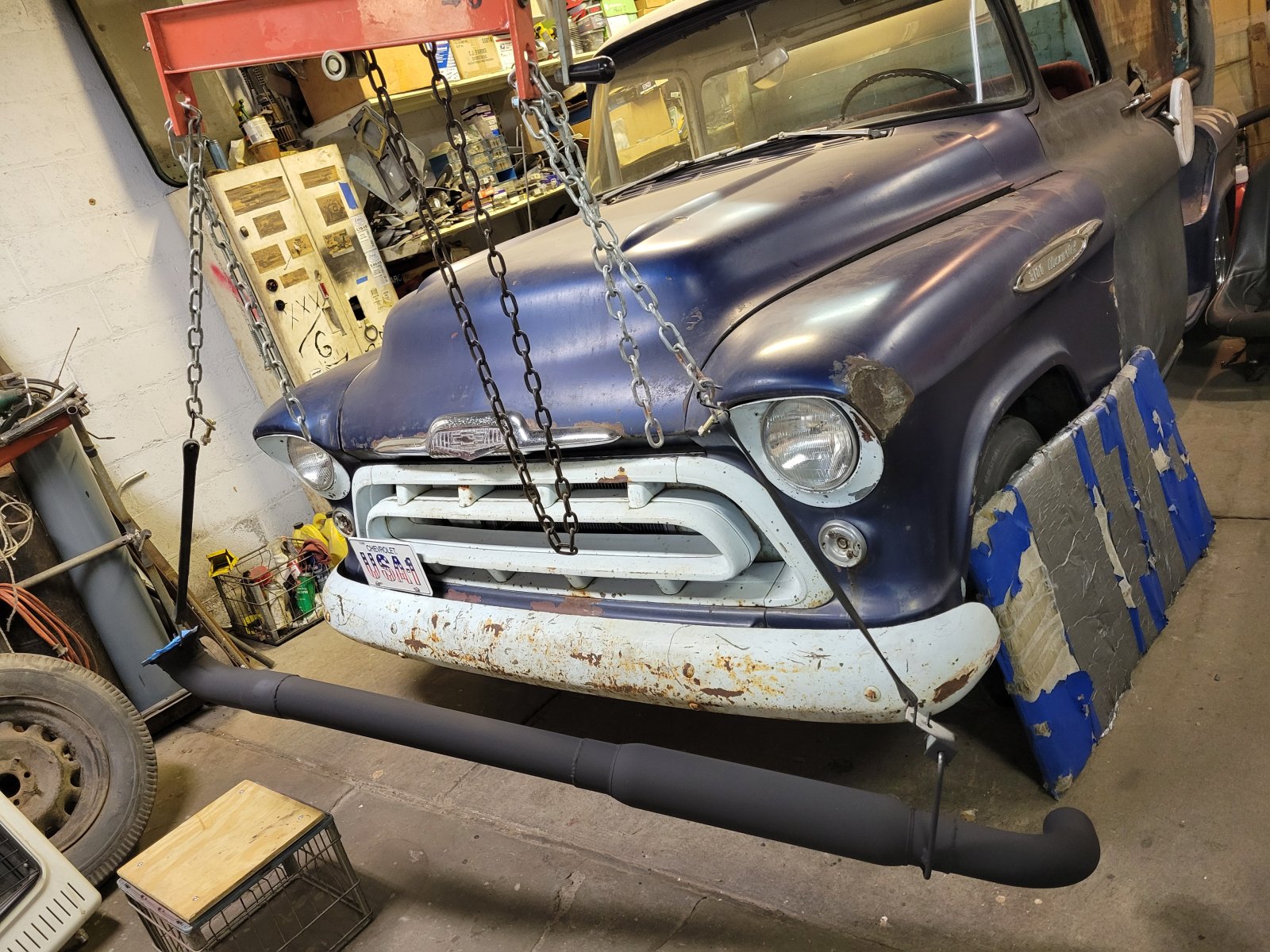

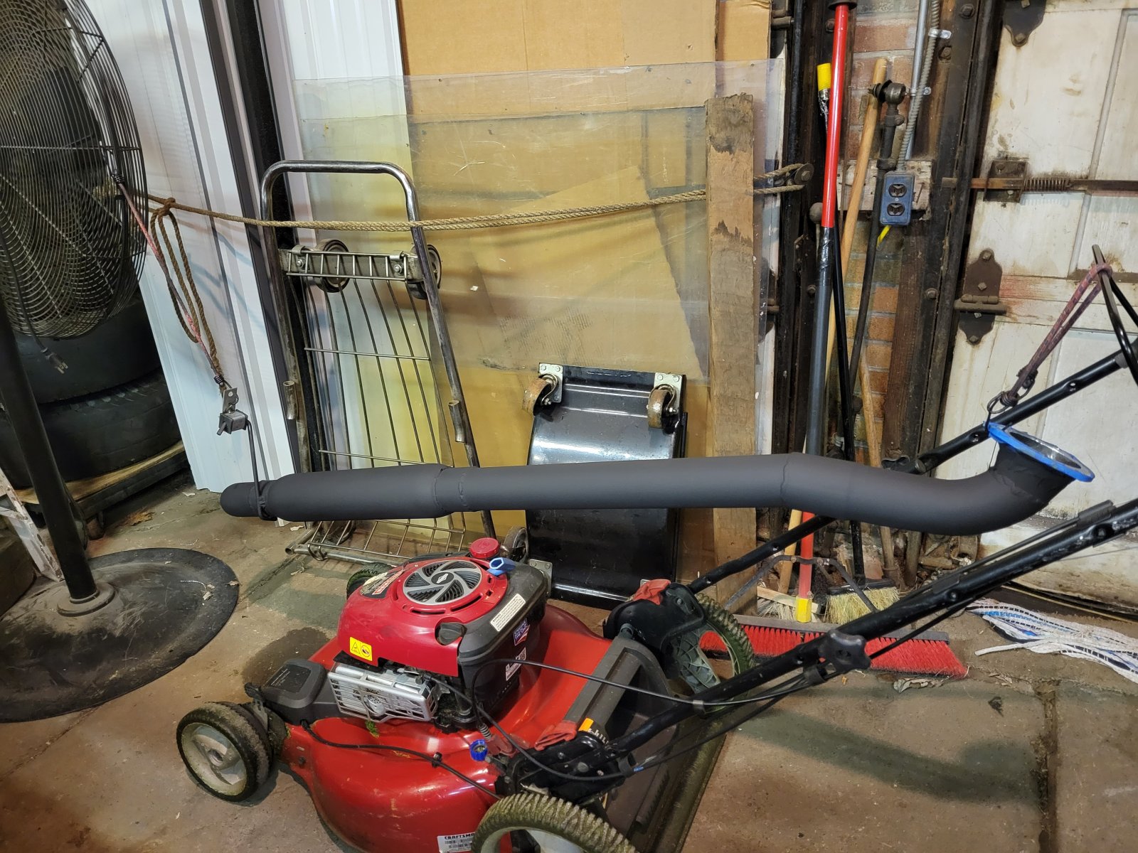

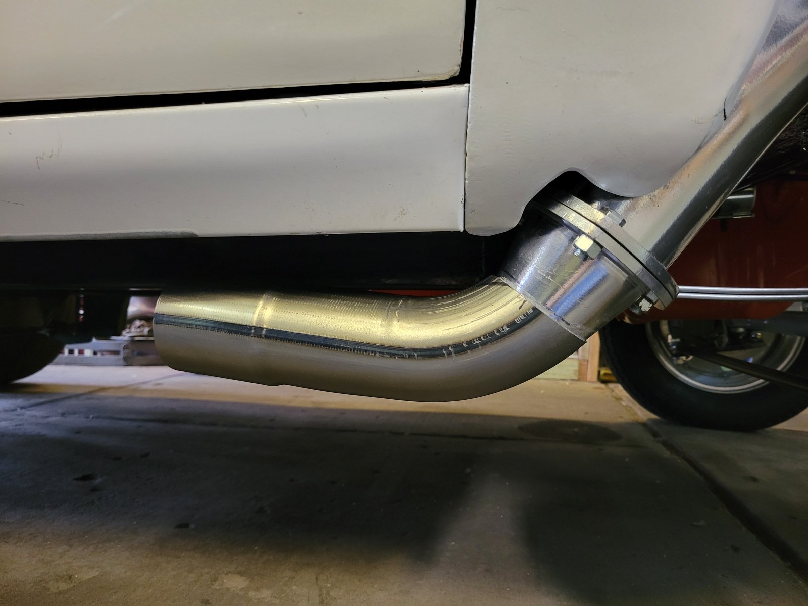

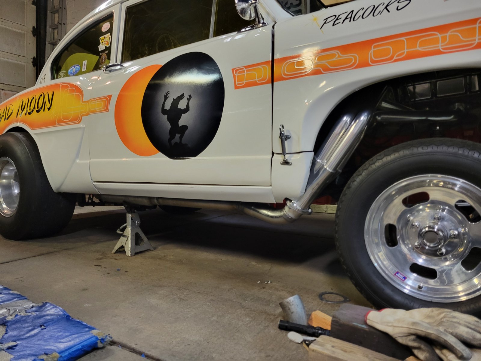

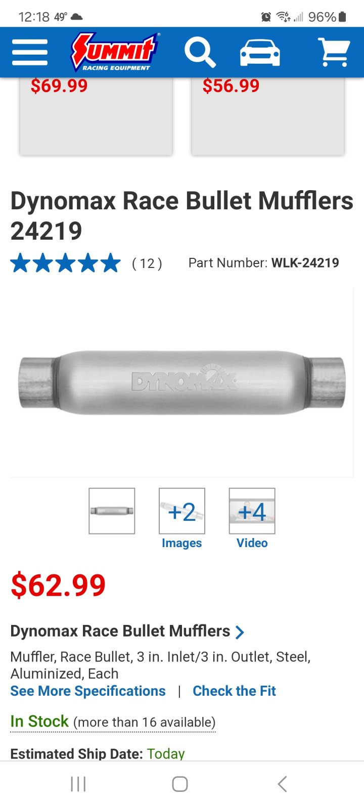

    I ordered a 3 inch exhaust "kit" and a couple 18 inch Dynomax Bullets off Amazon
    With the collector ending at the rocker it was tough to come up with a free flowing pipe idea and not hang down looking like dog ****.
    I cut up the U-bend until it had a nice flow with a 6 degree sweep to tuck the pipe back up under the body and exit before the rear tire.
    I got them to match side to side pretty close but the p***enger header sticks further out 1.5 inches from the block than the drivers side and the roll bar outrigger was slightly different side to side. With the muffler in the only place it would fit, kinda far back, I experimented with several tip designs before deciding on a straight out in front of the tire.
    I painted them with VHT flat black high heat header paint to get them to "dissappear" under the car.
    Mission accomplished

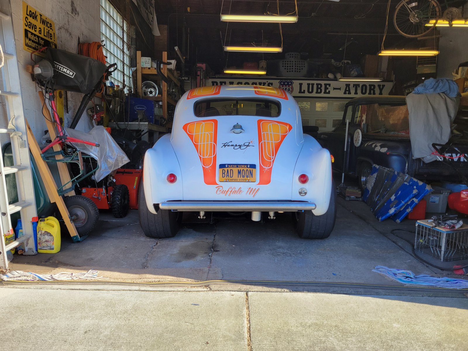

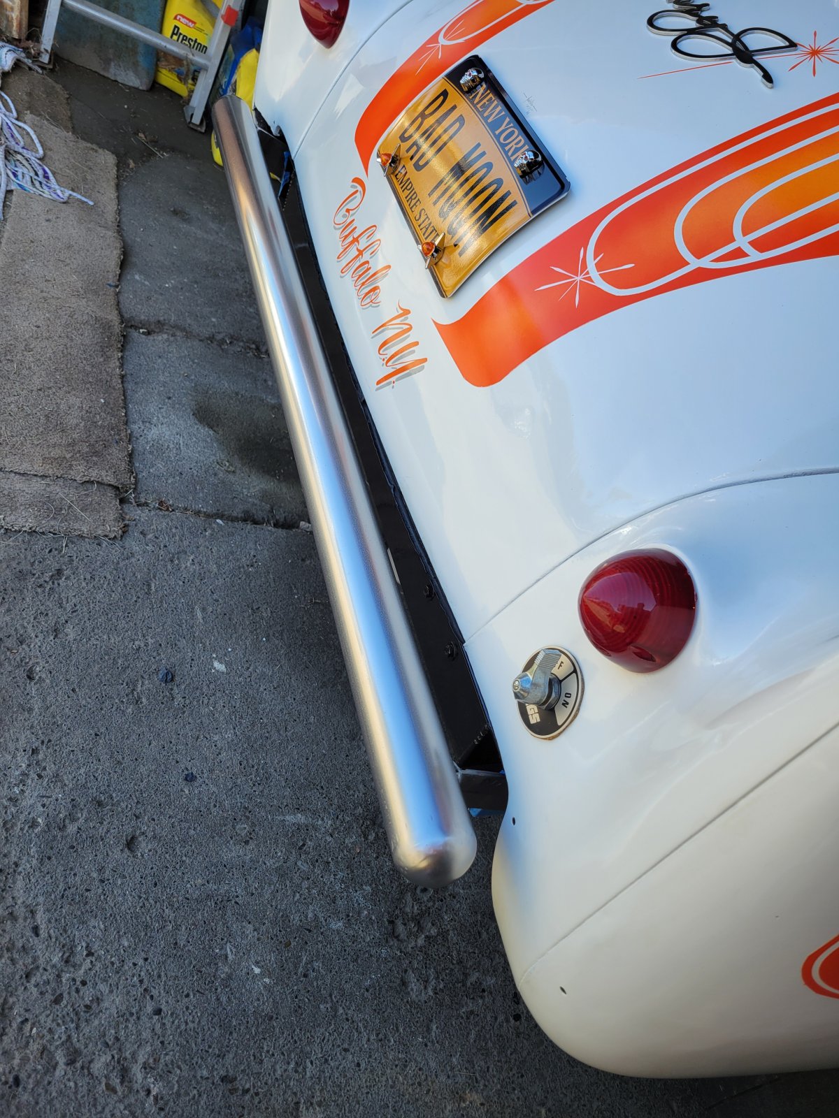

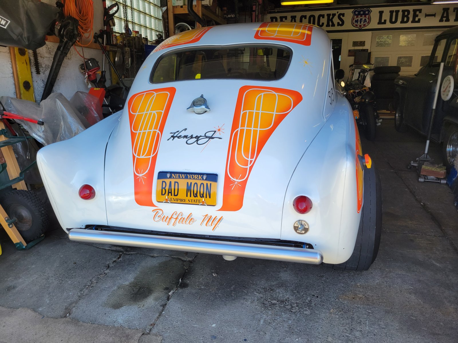

    Time for a new rear tube bumper, the old one was good except I lost one of the ends and the mounting brackets don't fit the new ch***is.
    The old one was an oddball 2 3/4 in. diameter so I figured I'd just use 3 in. since I had some left over 3 inch exhaust pipe to mock it up with. I didn't like it, looked to big to me, so I got online looking for the 2 3/4 but shipping prices were more than the tube !
    I looked at my local Metal Supermarket and they showed they had it so today I drove over to that side of the city for nothing. It turns out the website shows inventory across the whole country throughout all it's stores, they would have it shipped from another store in about a week.
    I decided to grab some 2 1/2 inch while I was there since it was only $35 bucks, if I didn't like it I could always order the 2 3/4.
    I mocked it up and it's actually not bad so I'm going to move forward with welding mounts to it to really get a good mockup. I've got it all marked out just need to grab some 1/4 bar stock for the mounts, thought I had some so I didn't grab them when I got the tube, turns out I had 3/8's which is just to thick to blend into the .065 wall tube.
    Mockup with a piece of wire holding things

    Made the brackets, tacked them on and test fit, waiting on the round end caps

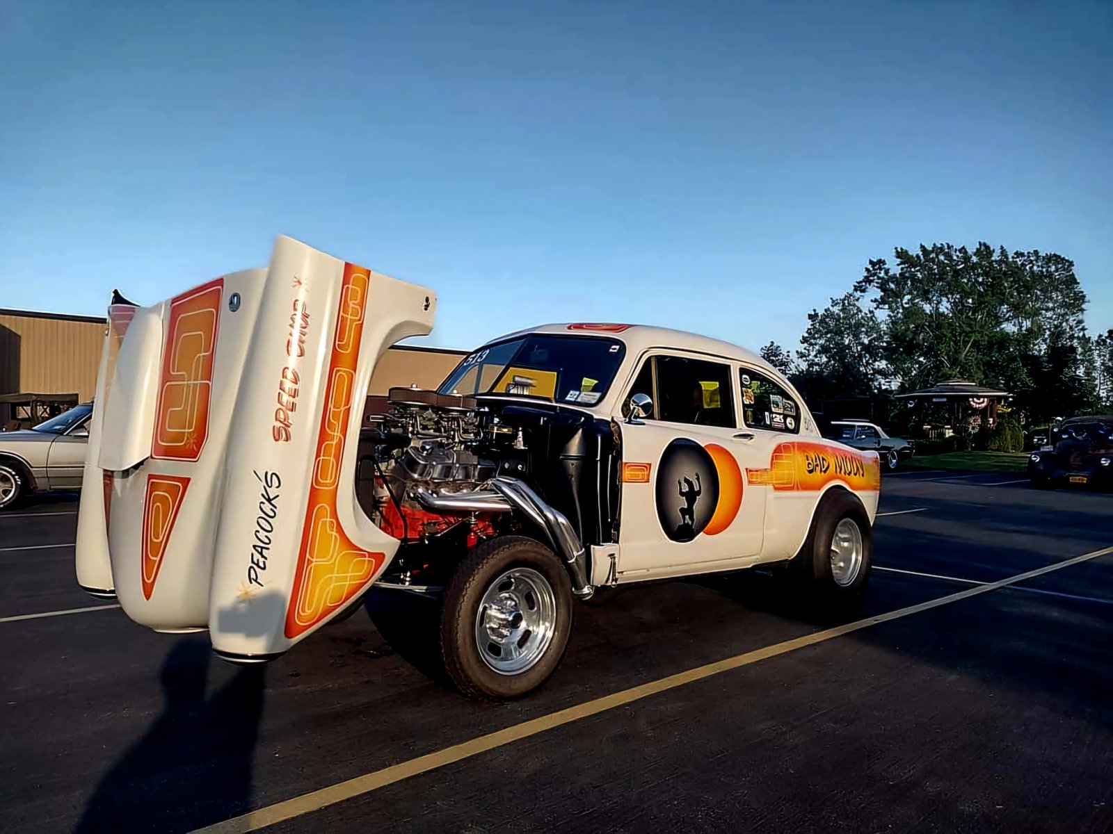

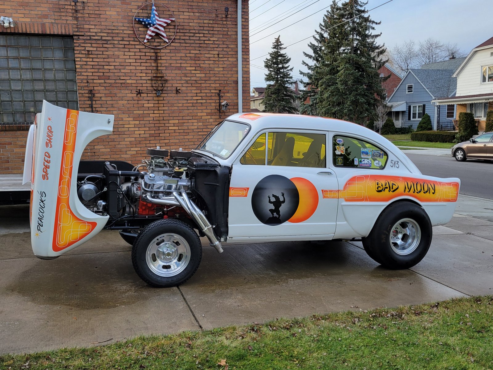

    swade41
    from Buffalo,NY

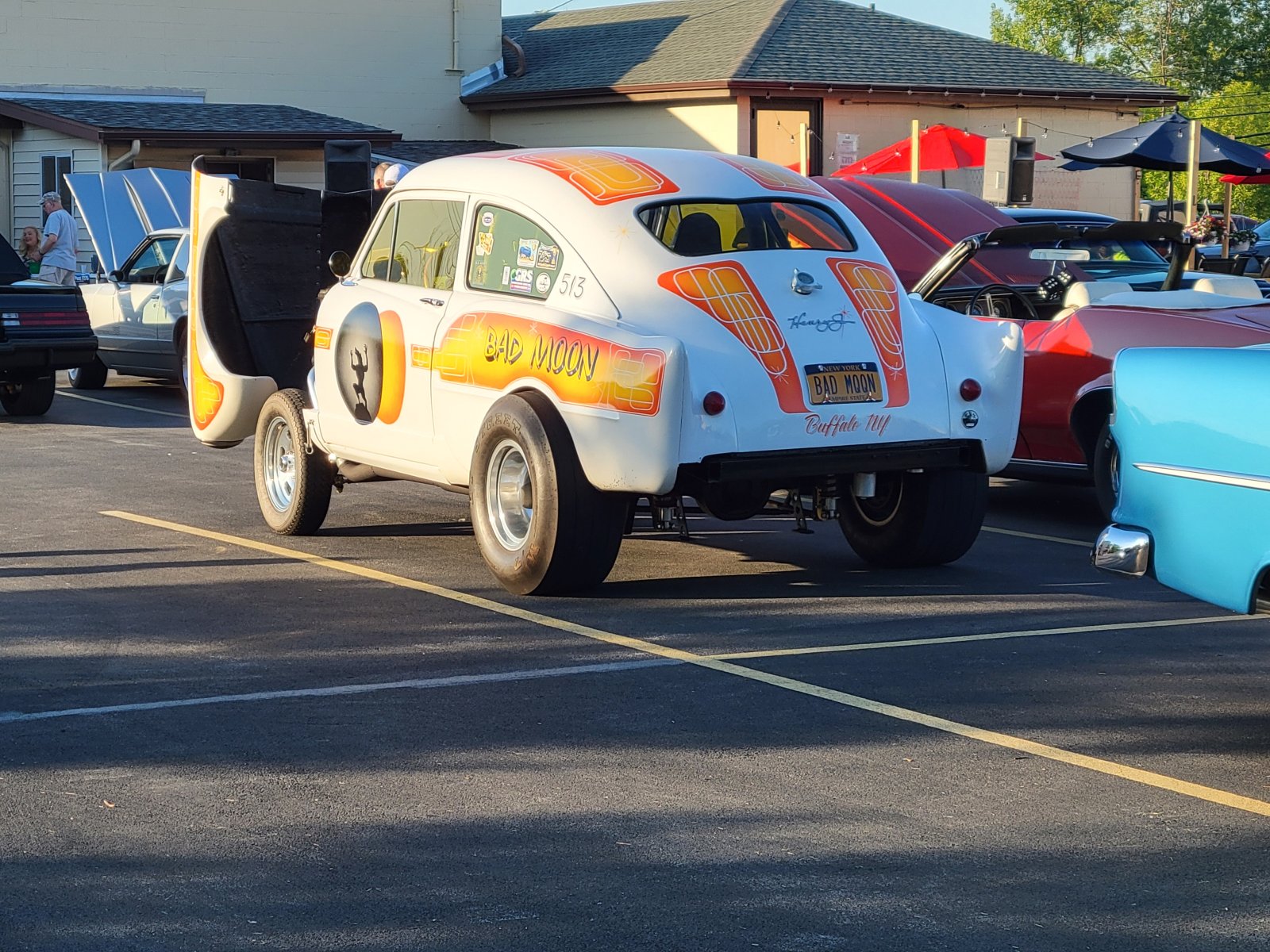

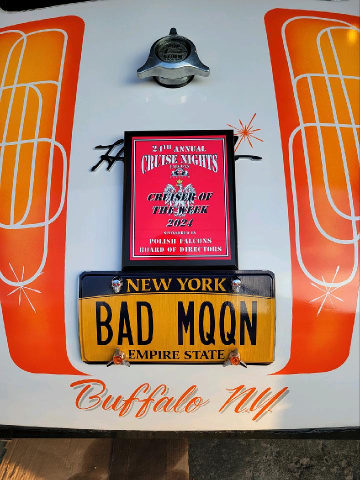

    I gave it another wash and took it to it's first cruise night in 10 yrs, got close to 200 degrees stuck in traffic but it dropped once I began moving so that's telling me a shroud would work if I need it.

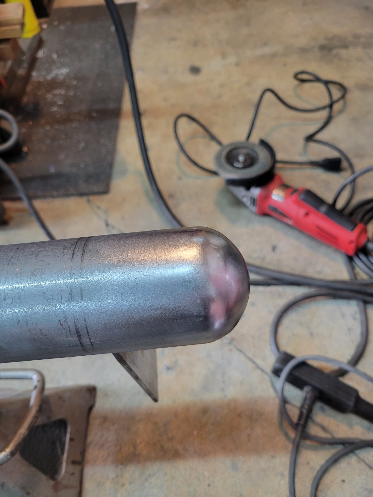

    Back onto the tube bumper, I decided to cut off the brackets and move them outboard an 1/8 inch and my half round caps were delivered today.
    Welded those on and they turned out pretty good, tomorrow I'll sand the tube and see how it all will turn out.

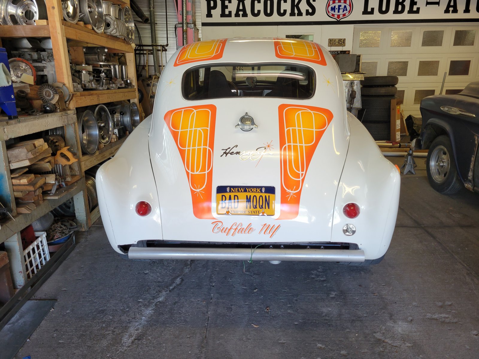

    Spent the afternoon getting the bumper right where I wanted it, then drilling the frame and brackets. Took entirely to long on the drilling part thanks to my 4 boxes of mediocre sharp drill bits and not being able to get any leverage on the drill drilling the frame.
    Now to sand it down and see if I can get it powdercoated the same chrome as the Eelco tank bracket.

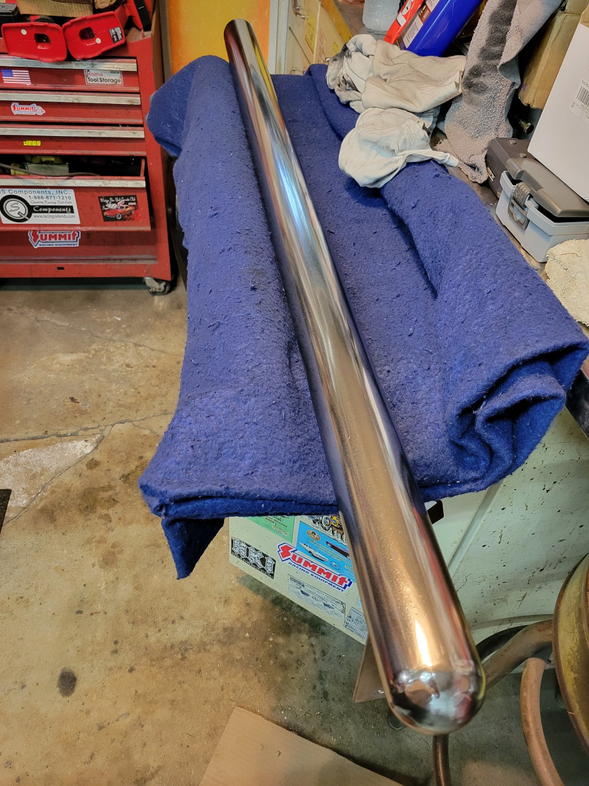

    A little sanding to shine things up, should look good with that chrome powdercoat
    20240616_172858.jpg 20240616_173017.jpg 20240616_172926.jpg 20240616_172825.jpg

    I took it one step further and polished it, I gave it a coat of Mother's Chrome Polish followed up by red Wenol.
    I'll run it like this for the summer just because I don't want to tie it up in powdercoat jail.

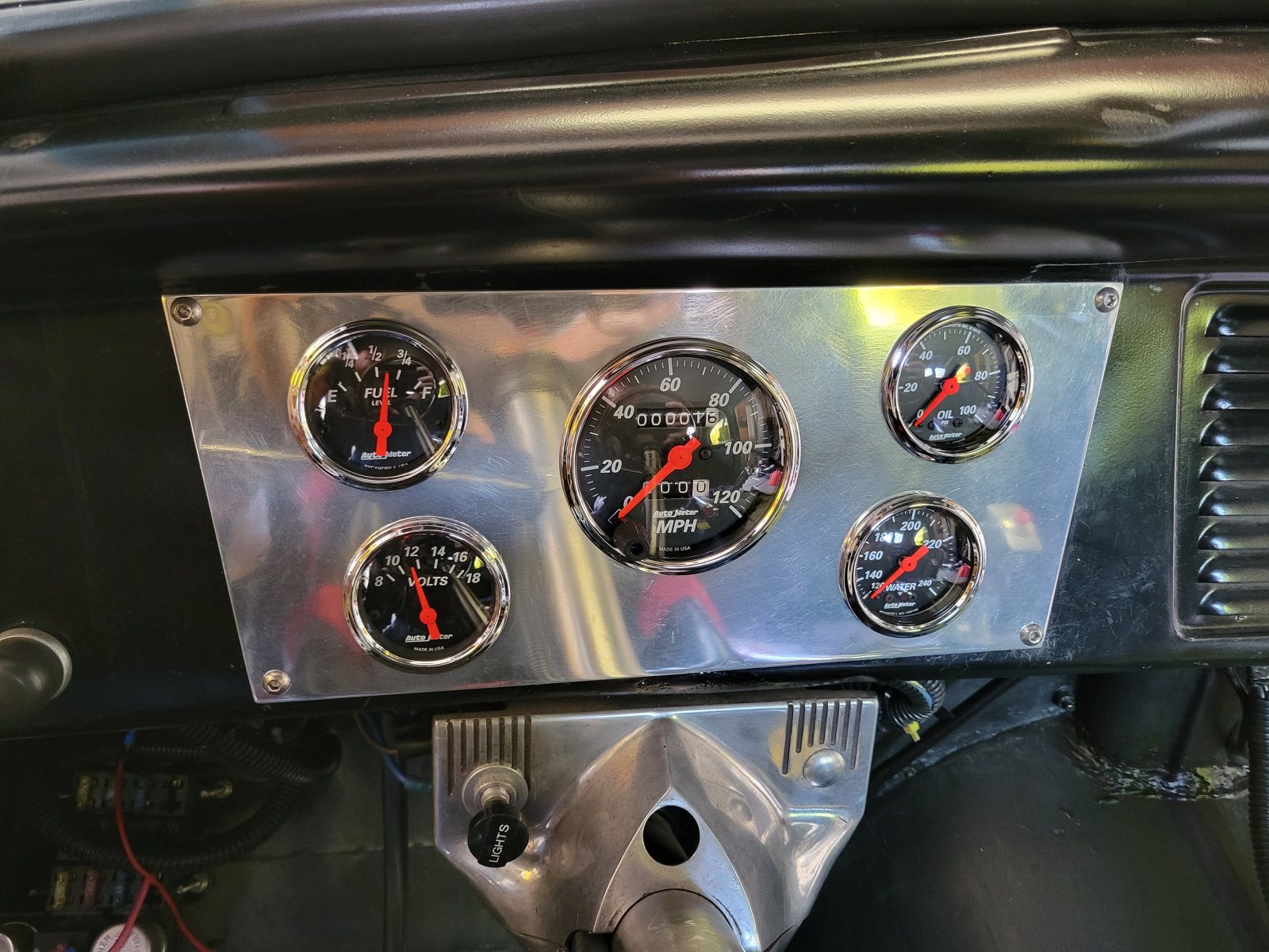

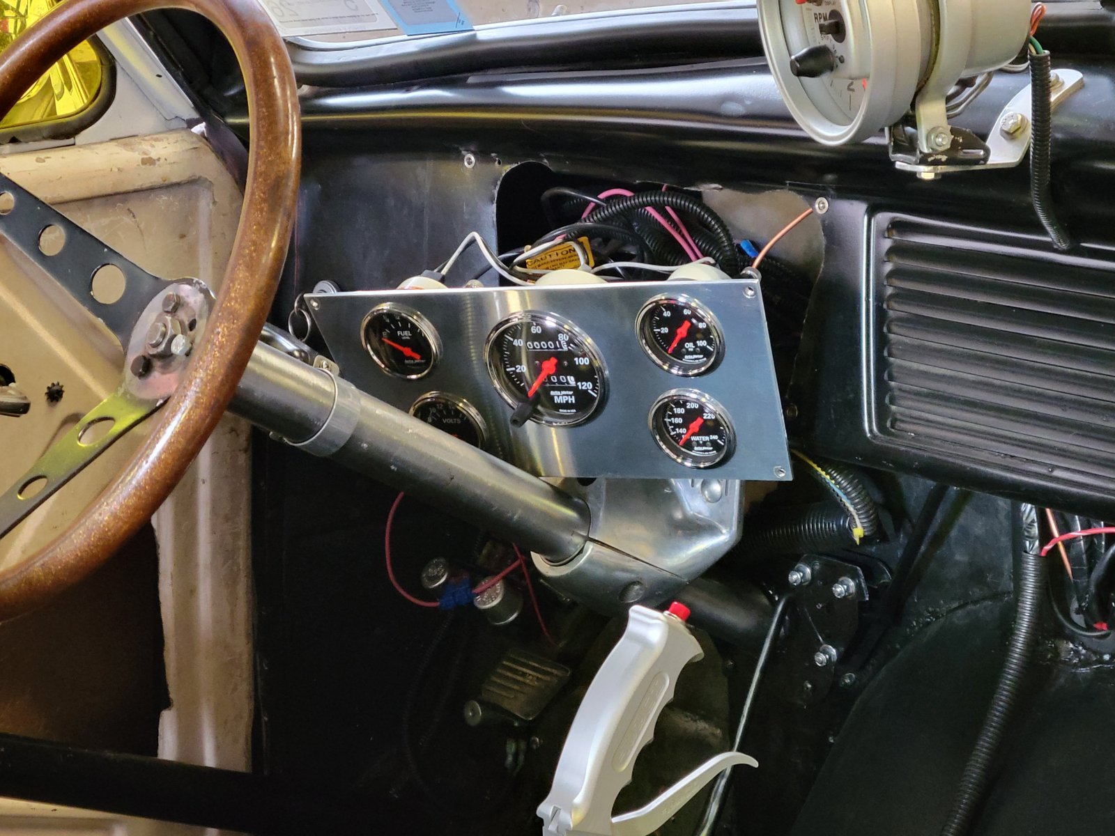

    Spent a couple days figuring out the gas guage issue, turned out to be the transponder thing inside the sending unit.
    Autometer didn't want to know anything when I called their tech line on how to fix it, after some runaround he switched me to customer service and same song and dance there.
    I took it apart and sanded, filed, scotchbrighted, used a drill bit in a couple holes and removed some tension on a couple screws to get it moving freely.
    20240623_153643.jpg Screenshot_20240624_093959_Gallery.jpg 20240624_160701.jpg 20240624_171414.jpg
