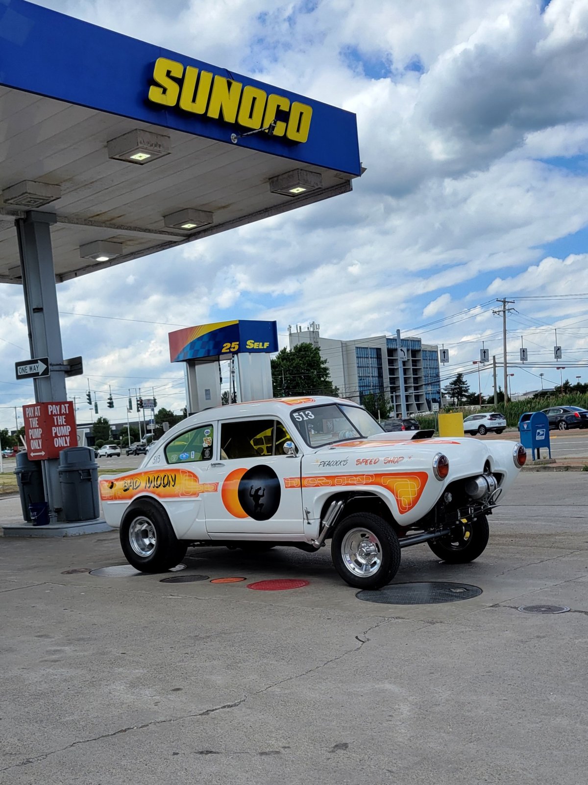

    I put it out in front of the house where it's pretty flat, I'm the last house on a hill and my driveway has about a 4 degree pitch to it. Anyhow, to check the trans fluid because it seemed to loosen up the stall last time I drove it, it's the same converter I had in it and I knew the big block would make it stall higher, but just how much higher was unknown.
    The trans fluid was low so maybe it won't "float" as much on the next drive, getting it sorted out, by the way the extra fender clearancing did stop the shrill squeaking noise.
    I gave it a drink while at the truck stop, nice that the fuel guage works now.

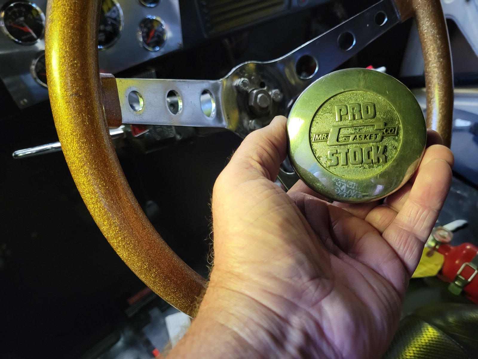

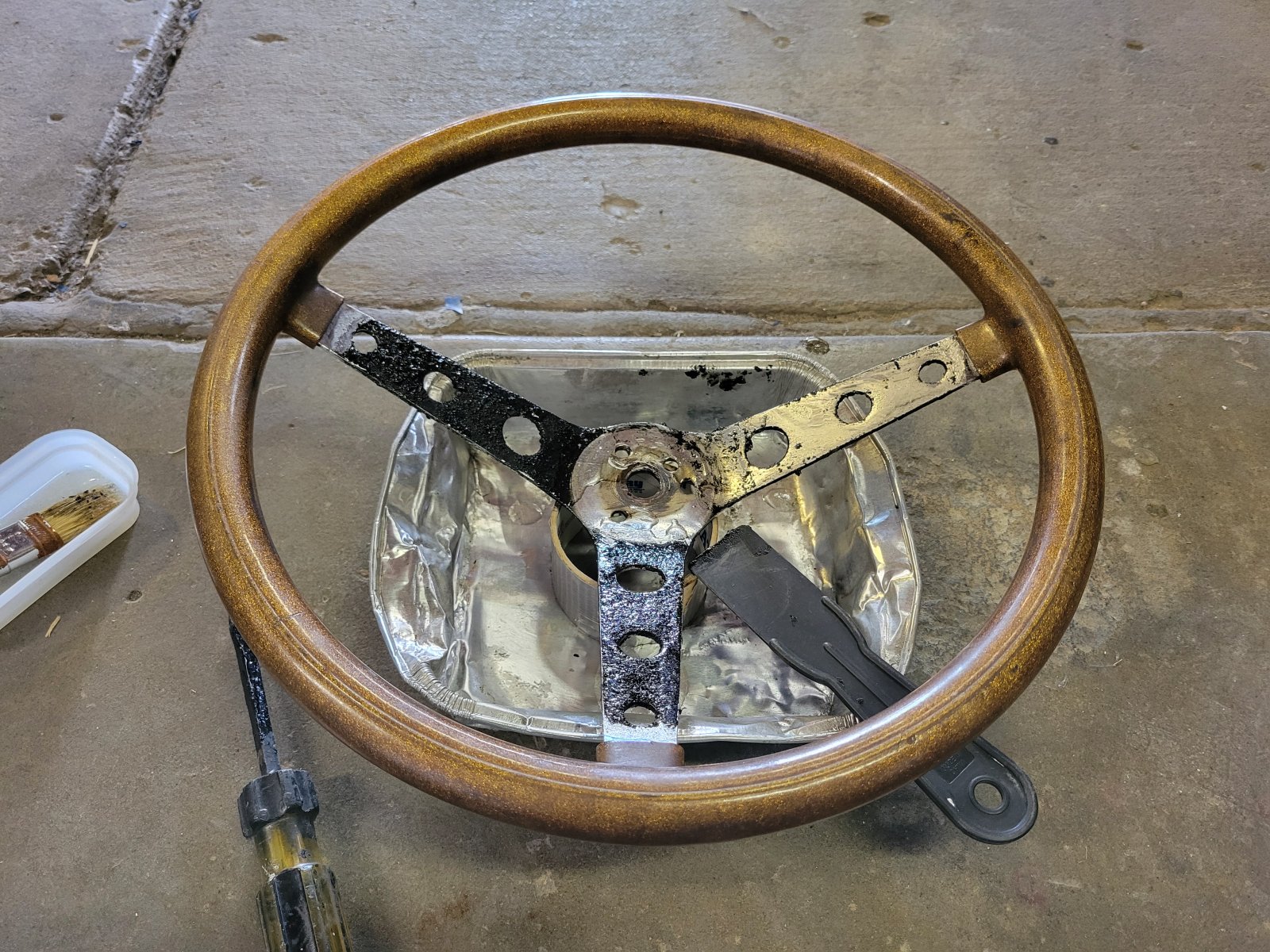

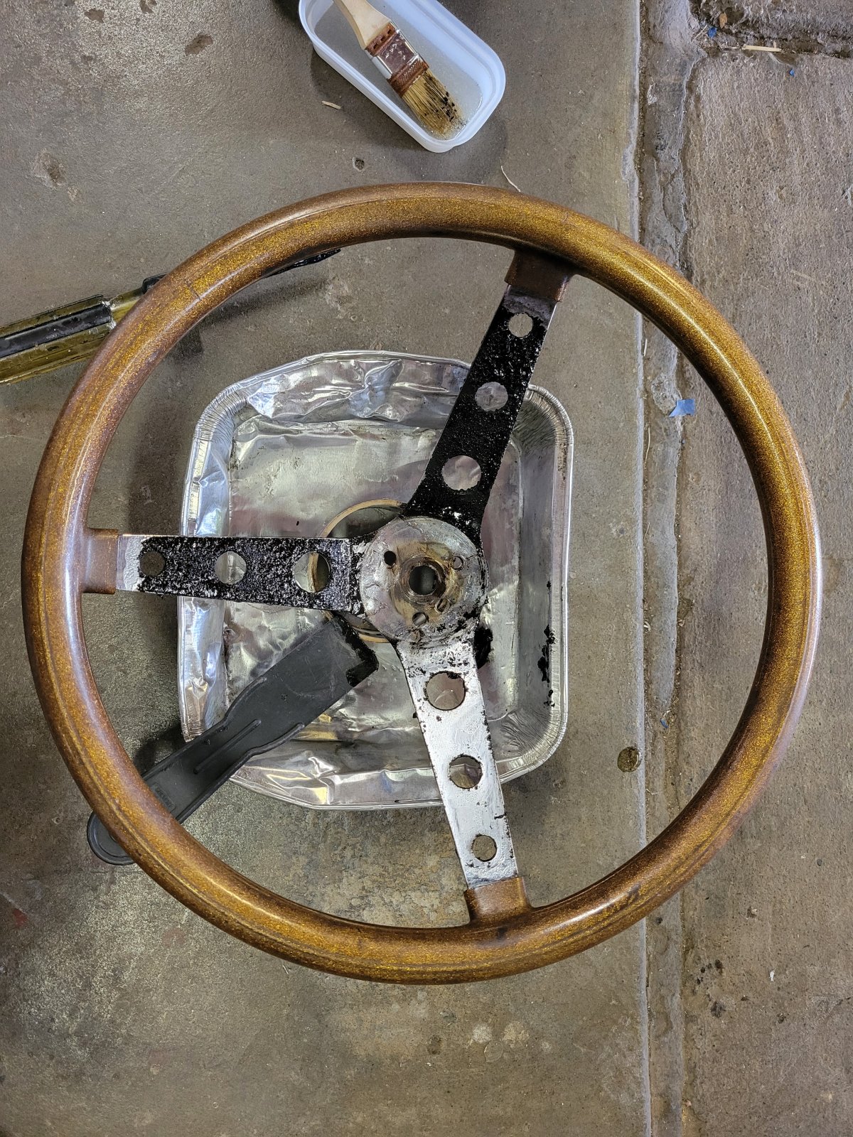

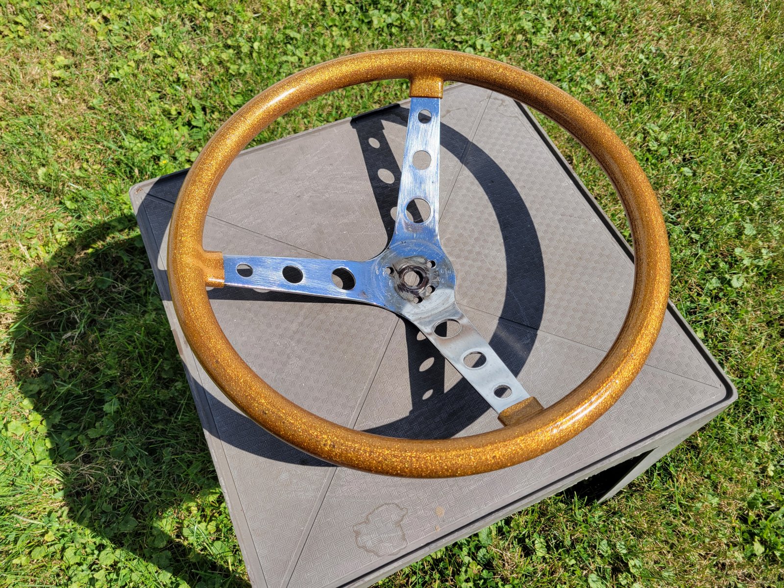

    Today I decided to re-clock the steering wheel since everything seems to be where it's going to stay. While I had it off I decided to strip the black paint off the spokes and clean up the gold flake.
    Not sure what brand it is or why it was painted black or why they welded an adapter onto the back of it, but they did.
    I started with a razor blade up near the rim then went with paint stripper afterwards.
    It by no means looks brand new but it does look 100% better
    Then I inspected an old wheel center cap, same as I used in the gas cap, to possibly use as a horn ****on, maybe one day I'll get to that

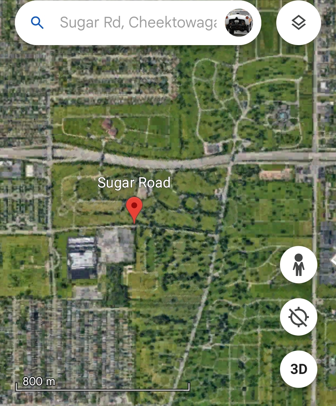

    I agree but where I live is just to populated to to find a remote street to do shenanigans on.
    I had to go down this street twice and still had to pull over for cars to go by just so I could give it the beans.
  19. swade41
    Joined: Apr 6, 2004
    Posts: 14,999
    swade41
    from Buffalo,NY
    Crazy as it seems this 1/2 mile long road is surrounded by 3 very large cemeteries and still has a ton of traffic on it.

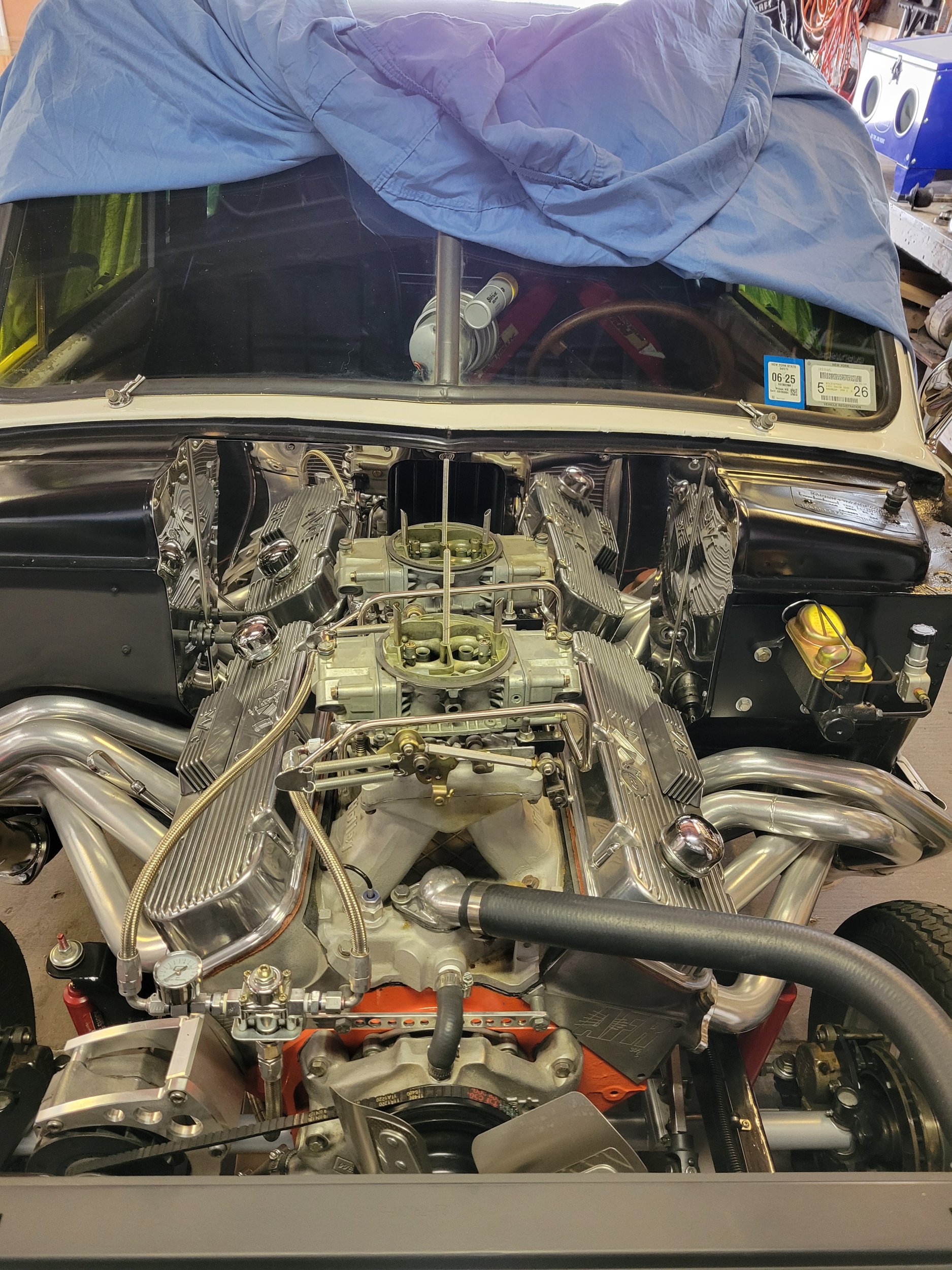

    Spring maintenance to address a couple issues found while driving it last season, first was the weeping intake at the two halves.
    Turns out, it ain't got no gasket in it ...
    So I made one
    Even got the holes in the right place
    It had ran rich, giving a puff of fat black smoke on the hit, so I knocked 2 jet sizes out of the mains and secondaries
    70 front to 68
    80 rear down to 78's
    All ****oned back up with the new gasket and jets
    If you recall the kill switch wouldn't kill it so I moved the alternator charging wire to the other post on the switch, hopefully that fixes that. I haven't put the battery back in it yet to test any of the new fixes.
