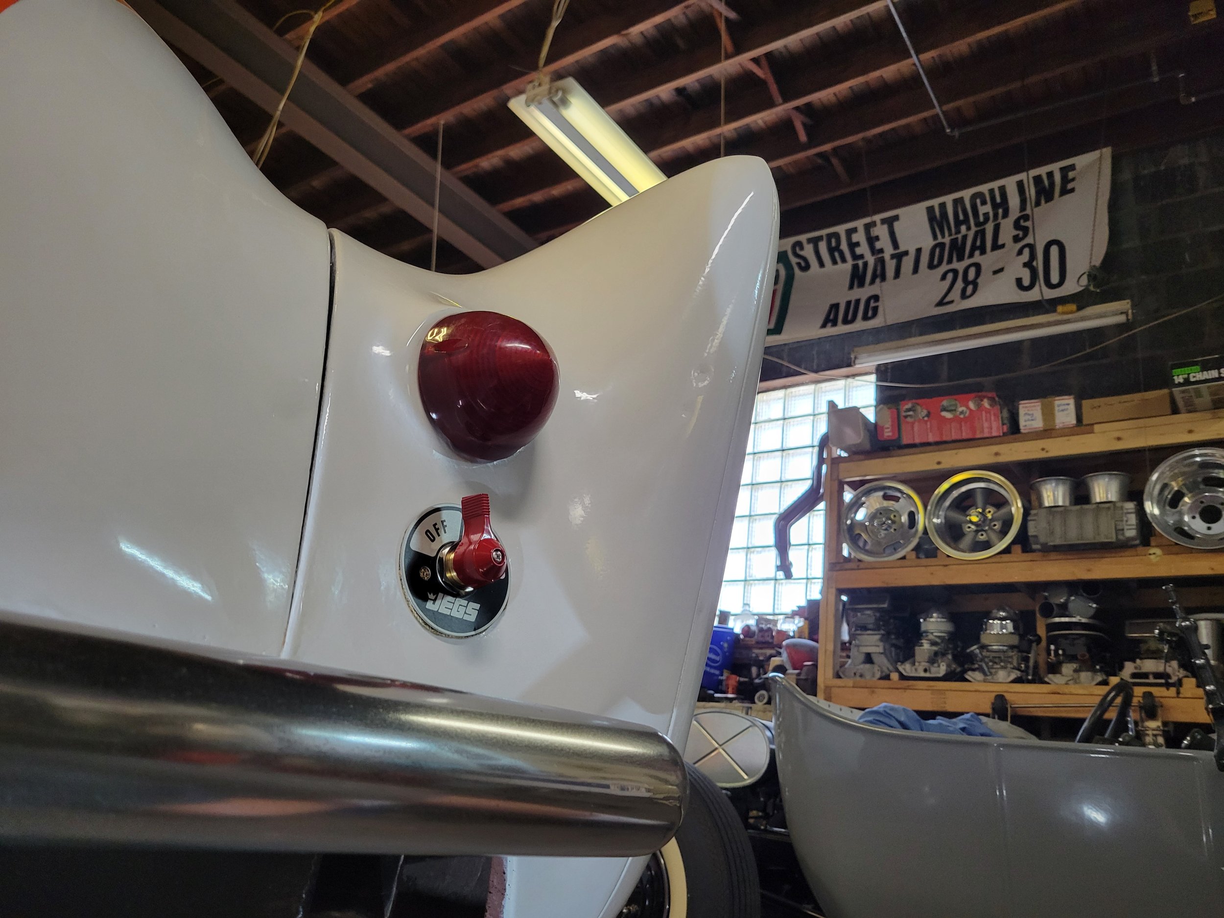

    New parts for Bad Moon, double adjustable shocks with a 130 lb spring to replace the single adjustable with unknown spring rate that seemed a bit stiff.
    Also got a new 4 way cutoff switch to hopefully fix the issue of the 2 way switch that wouldn't kill the car.

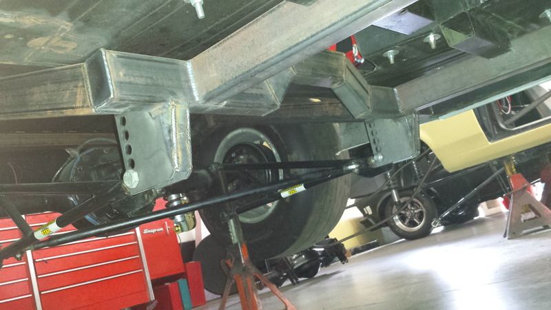

    I dont know how much street this car sees vs track, but how do you find using rod ends on the shocks vs poly/rubber style ends? Any issue with those or the ladder bar rod ends, regarding harshness, banging, clunking, high wear, noisy, etc?
    The '60 Falcon g***er i'm putting back on the street has all rod ends on the rear suspension and shocks and i'm hoping that wasn't a bad mistake. it'll be a good while before she's a driver to find out.

    Are you running a telescoping wishbone track locator on those ladders or an X brace hiding in front of the pumpkin?

    I drive the car all over and I don't notice the solid rod ends, but I also didn't build the car to be a comfortable cushy mushy impersonator either. It's a legit street strip car that's void of any civil items.
    I run a diagonal link

    Success !
    The new 4 post battery cutoff switch cuts the car off, glad that's behind me.
    I couldn't figure it out back in 2011 so I cheated and put it on the negative side and nobody ever checked the actual routing, just if it killed the car or not. On the latest rebuild I wanted to get it right but it still didn't kill the car after I added the charging wire to the switch and adding a diode.
    I guess the moral of the story is you can't kill a car with an alternator using a 2 post switch.

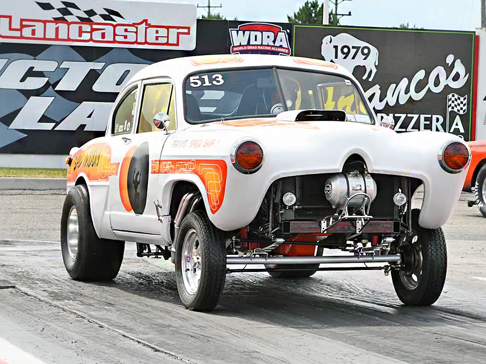

    12 years later me and the J tempted our fate by going back to the drag strip.
    First thing was getting it ready, bolting on my slicks that have now became a little stiff, not the original slicks but a used set I bought off of a friend. They are a little bigger at 29 x 11 vs. the 28 x 10.5 I had on before, was hoping to cut that 4.57 gears down just a little and the bigger footprint can't hurt right.
    Flushing the antifreeze
    https://youtube.com/shorts/kbJawrUUWII?si=t6dukYrHubnaL2PM
    Dropping the exhaust and a new set of plugs, time to pack tools, jack, air tank, what all did I used to take, man it's been a long time since I done this !
    On the way I'm feeling a little nervous thinking about is the car going to launch straight, is it going to have death wobble, is it going to shake my filling out at speed, is it going to stop from speed and negotiate the short shutdown and sharp turn ???
    How am I going to feel physically, is the ICD pacemaker going to shock me if I get to excited, I don't want to get shocked, if I do get shocked my days of racing are over, why am I thinking about all of this ???
    Get to the track and my mind is back on track also, let's get unloaded and set up.

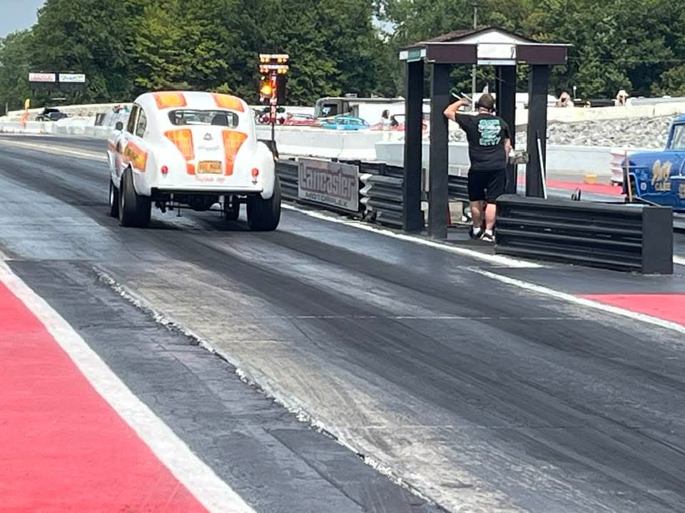

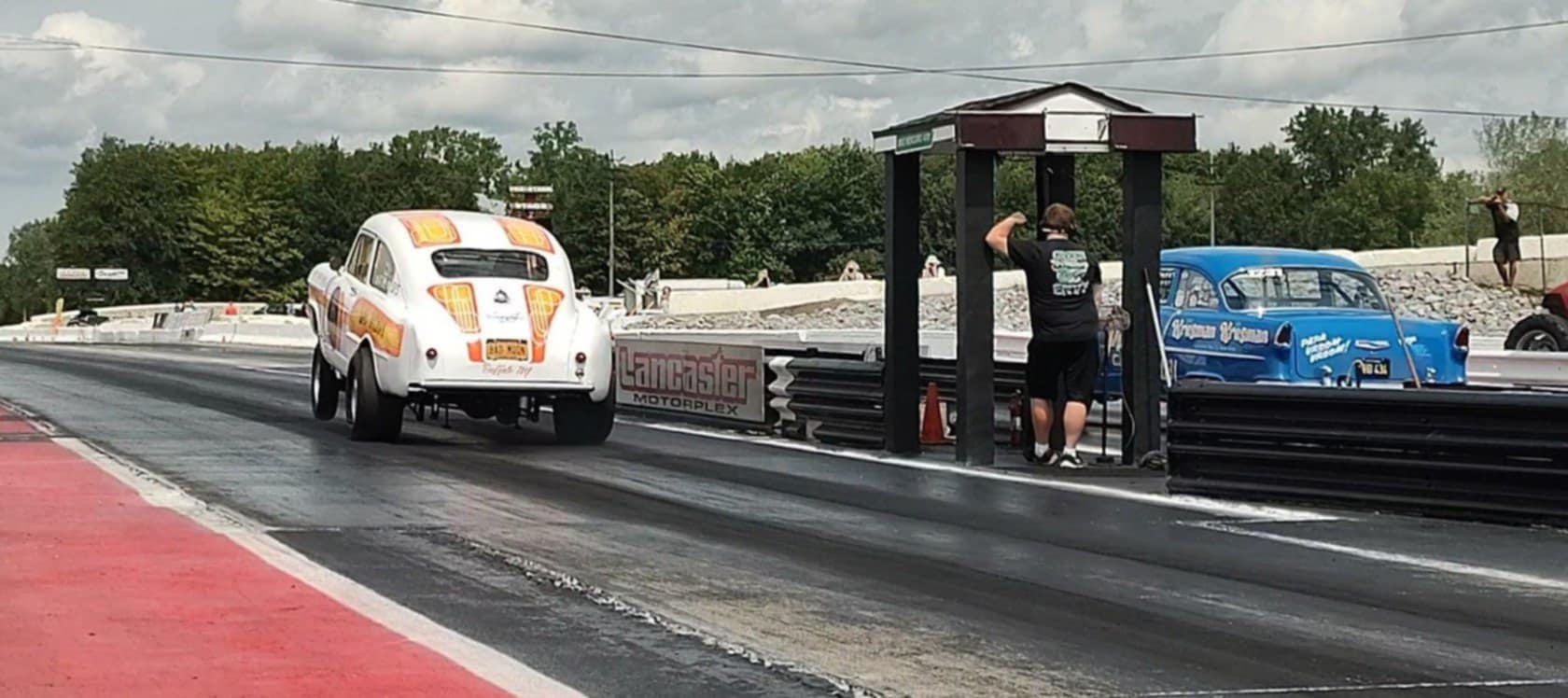

    The big Oh **** moment ...
    All was going good ... until it wasn't.

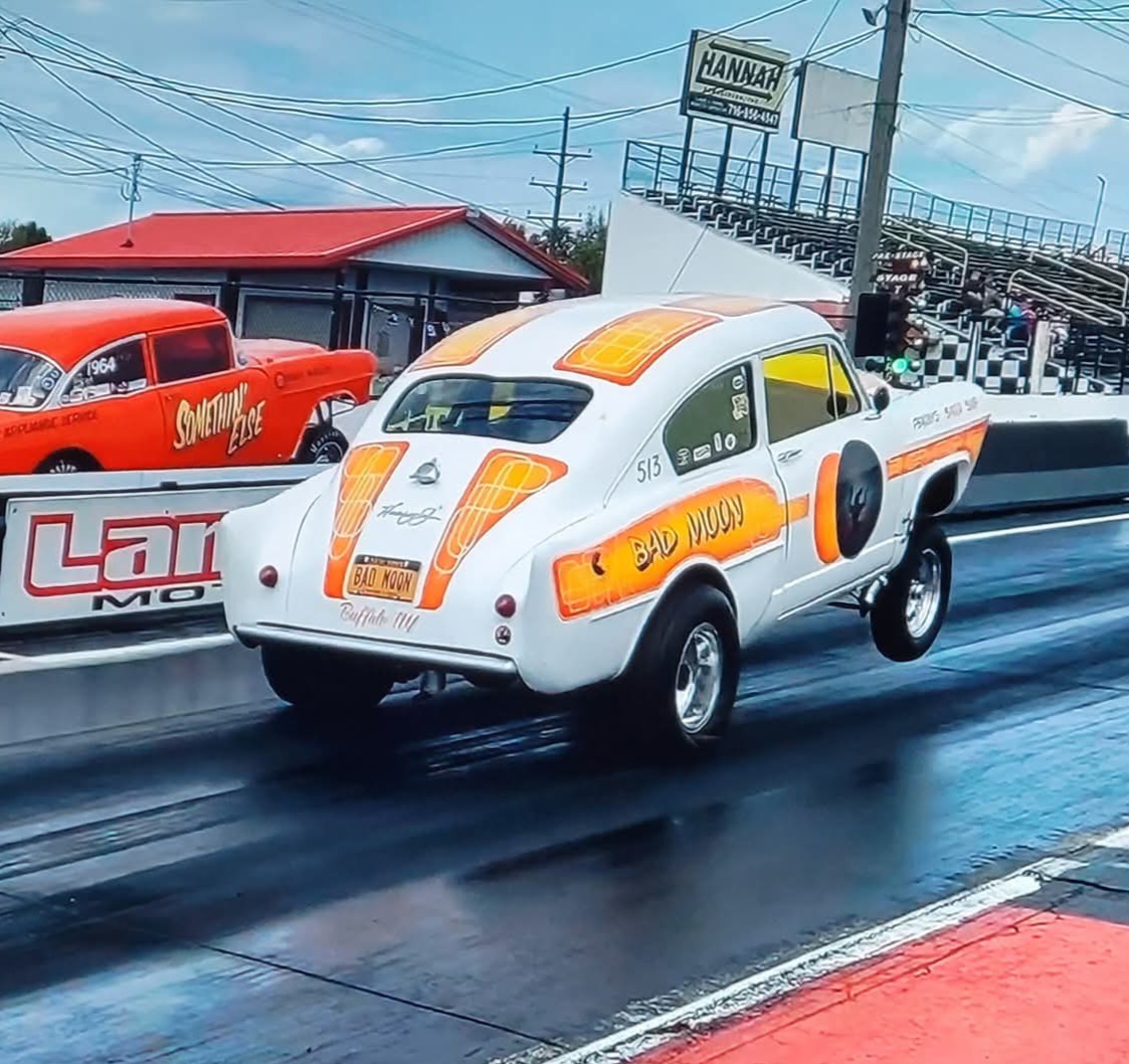

    I stayed in the gas through the wheelie and it picked up a tenth in the 60 ft clocking a 1.42, oh yeah !
    The car started drifting towards the centerline so I put a little left input in the wheel, still going towards center so a little more left input. It was right about that time I realize the left input isn't working because I ain't got no damn steering, the steering wheel is free floating !
    I throw it into neutral and gradually apply the brake, do I jam on the brake and take a chance the car darts left or right, I just keep pressure on the brake.
    It crosses the center collecting a cone, the white thing above the blue 55
    All this time I'm actually pretty calm, it's not making any sudden moves, nothing to get excited about. It keeps going towards the wall and I'm at a point I know it's hitting the wall regardless so when it's close I jump hard on the brake.
    Nothing like the grinding sound you can hear over open headers, the **** flying around outside the window and the sudden jolt of the stop up against the wall.
    I get my harness off, climb out while getting my helmet off, right across from the approaching safety team. They yell what's wrong, I grab the steering wheel and spin it like a roulette wheel and yell back, no f'n steering !
    I look in the space above the front tire and see the steering shaft isn't where it's supposed to be, came out of the lower Borgeson joint. The safety guy is on repeat "I don't know how I'm going to tow this" I interrupt and say let's push it back so I can flip the front open and I'll drive it back !
    We do that, I put the shaft in the Borgeson joint as far as I can, close the front, fire it up and drive off towards the return road. Once on the return road I pull over and open it up to access the damage and try to understand what the hell just happened, that's when I noticed the steering wheel is out of the column about an inch.
    The dimwhit bulb goes on, I pulled on the steering wheel during the launch and somehow pulled the shaft right past both set screws ! Thankfully Brian's 55 is a lot faster and I scrubbed a lot of speed off, things could of been a lot worse, I got away lucky on this one.
