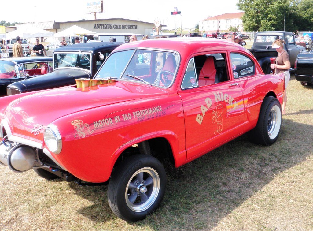

    This is my Henry J (Henry J Puggle that is). I adopted a puggle named Henry last fall after my Dixie Belle p***ed on. So he got a J added to his name.
    I love your HJ and I posted one I saw at last years Garlits show
