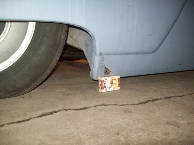

    cut out the floor pans and I tacked in the rear pan out of 16 gauge.
    Found a broken body mount under the front floor board
    put in some bump stops so I wont slam down on the rockers if I lose air
    [​IMG].
    I need to find some new bags for the rear (it has firestone bags for mock up only) I found out I can't take the rear tires off with out unbolting the bags any one have advice on some good bags the will give me more lift?

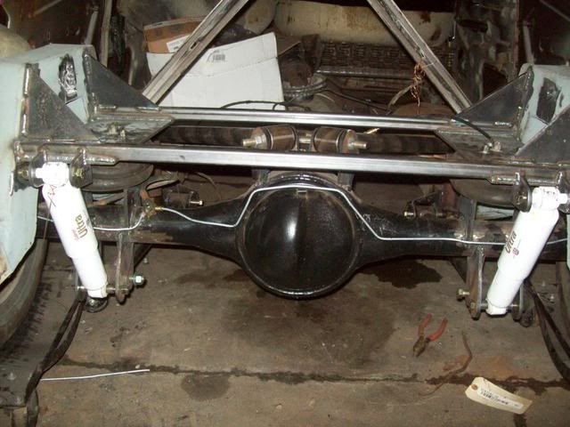

    I don't know if any one cares but I got some more work done, the rear end is done and I got started on the break lines.
    Went to u pull it on sunday and they had a 54 lincoln so I pulled this off the rear bumper, I think I'm gonna narrow it and flip it and put bolt to the bumper, but I'm not sure yet.

    Holy C notches batman! - Can i ask why the notch is so big???? "No Plan" and I are currently 2 linking my 54 so it'll lay the frame with 2600lb bags & the notch we are doing isn't near that big - (although it still isn't done, so maybe it will be lol)
    Looking good though! - Subscribing! - Love the pics!

    My brother in law (whom I bought the car from) did the notch a long time ago, I don't know what he was thinking but whatever....haha

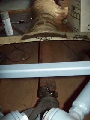

    got the drive line in (thanks to hamber JeffB2 for giving me the part number for the u joint). I thought I was going to have to cut up the transmission tunnel but it was only a 1/8" difference between aired out and where the drive line hit so I just moved my bump stops to save a ton of work.
