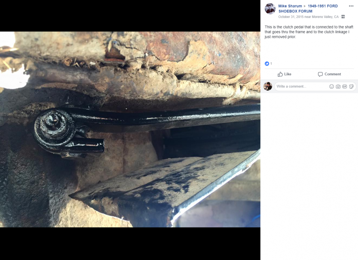

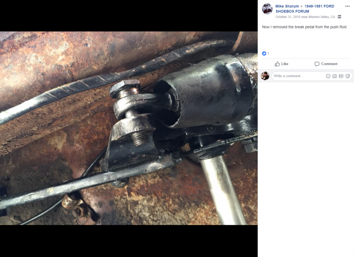

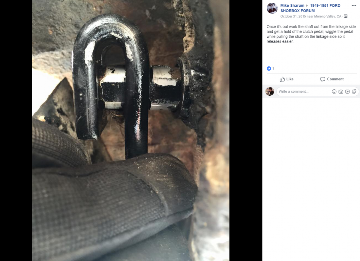

    Tips, yeah. Remove brake pedal pad, disconnect clutch pedal from clutch shaft. Remove clutch linkage holding screw at trans. Disconnect brake pedal return spring. Remove the master and brake pedal from the car. Best tip is to give yourself enough time, this isn't a two bolt and lines job

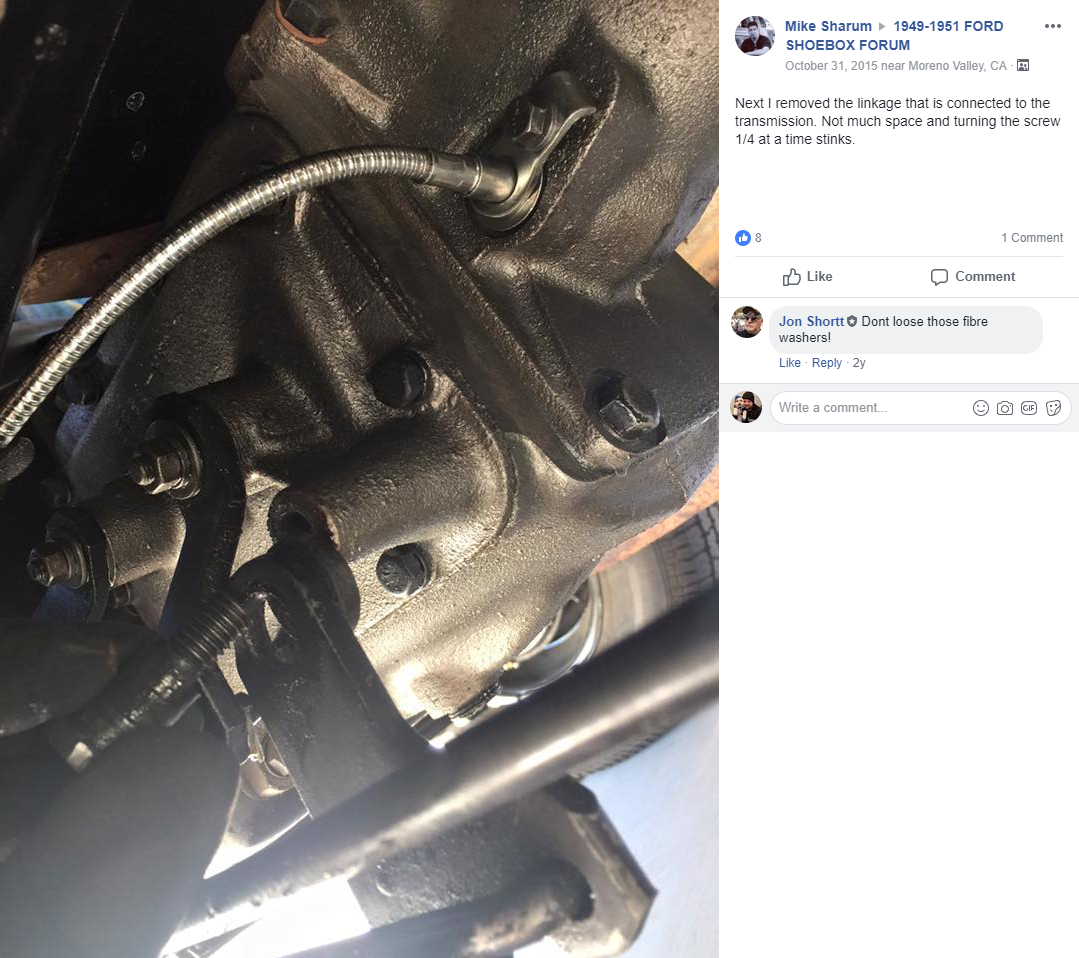

  23. fadingfastsd
    Joined: Jan 30, 2008
    Posts: 365
    fadingfastsd

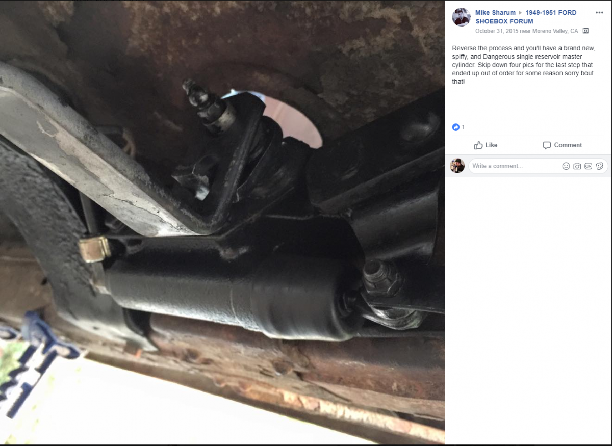

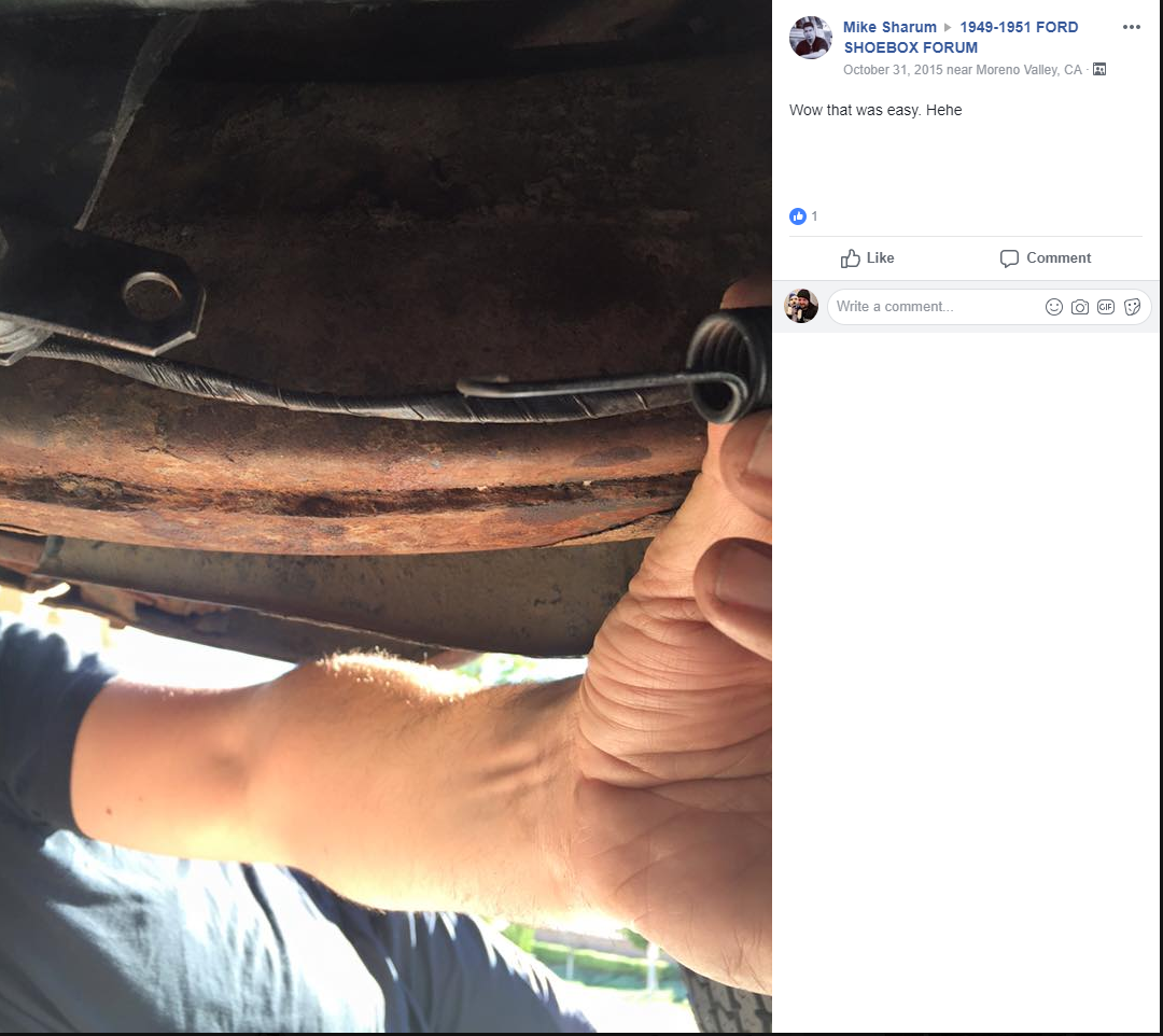

    Well, yesterday was a pain in the ***! Thanks for the tips guys! Nifty One your info was dead on. I also found a great post on the Ford Shoebox facebook group, the guys pictures were excellent. I will make another post in a minute with his pictures and description (not trying to steal his content, all credit goes to him, it was just super helpful).

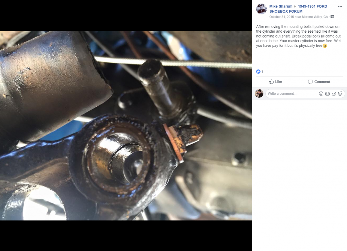

    I got the old mc out in about an hour. Definitely have to disconnect clutch pedal from the shaft, and remove both mc mounting bolts in order to til it enough to get clutch shaft to clear the transmission. Other than that, no real surprises. Good time to adjust clutch freeplay when you put it back together as well.

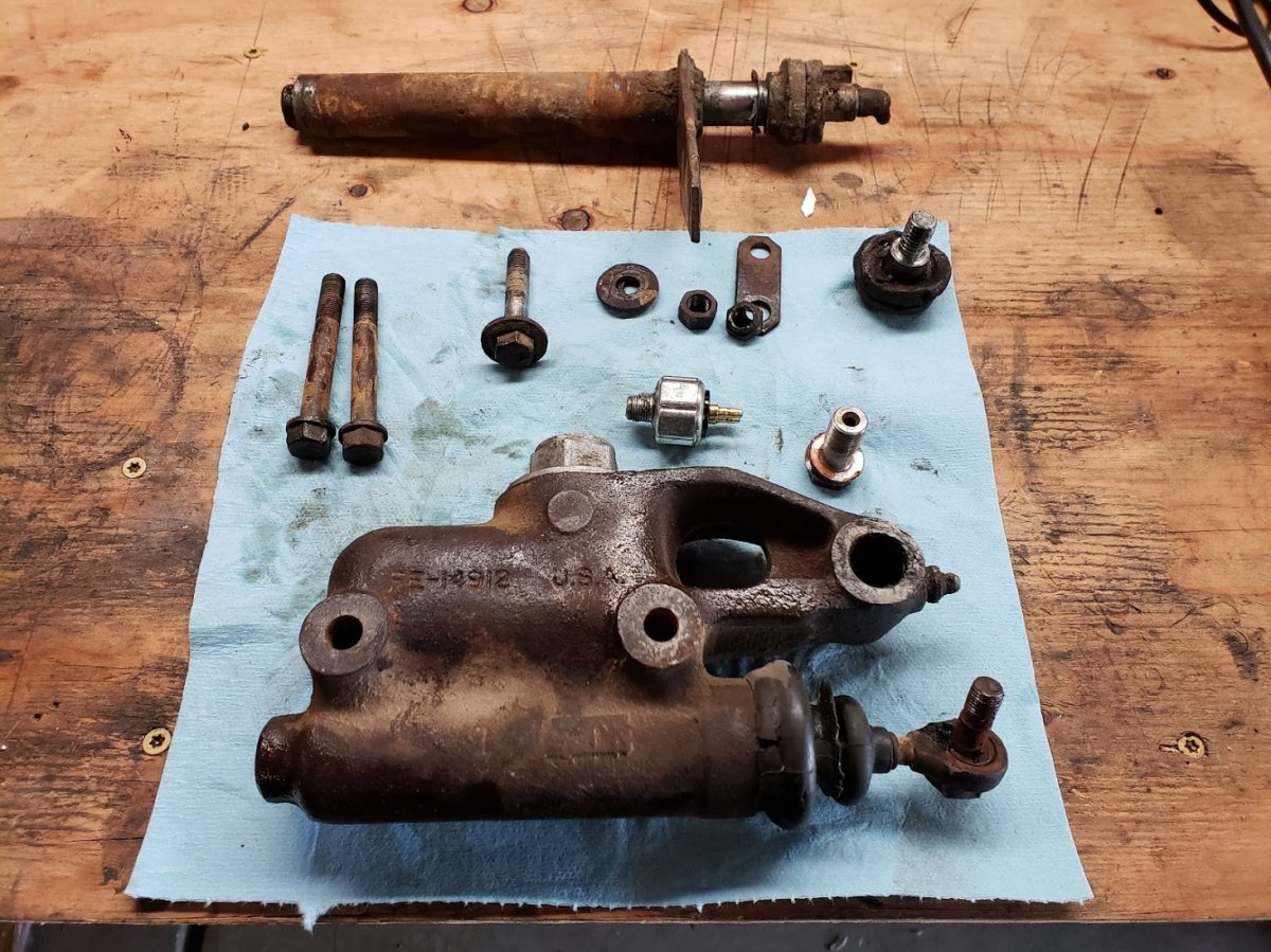

    Got the new mc from Shoebox Central back in, under an hour to put it all back together. Everything looked good.
    The problem seems to be a bunged up old junction block. I was reusing the old banjo bolt, it was in great shape. However, no matter what I tried (new copper washers, old washers, new brake pressure switch, old switch, etc) I got bad leaking from the pressure switch, and the from the banjo bolt around the washers at the face of the mc.
    At this point I ***ume something is screwed up with the junction block and it just won't seal. I'm going to replace the junction block, banjo bolt, and washers and see if I can get it sealed up. Just frustrating, gotta wait another 3-4 days for parts and see if that solves it. Oh well!
    Both headlights had also failed on my drive home last week....so in went a new pair of 6v sealed beams from Shoebox Central, and they're working great. I'll spend the time waiting for parts trying to sort out non-functional dash lights and running/brake lights. I definitely remember why I love and hate having (but mostly love) having an old car again!
  24. fadingfastsd
    Posts: 365
    fadingfastsd

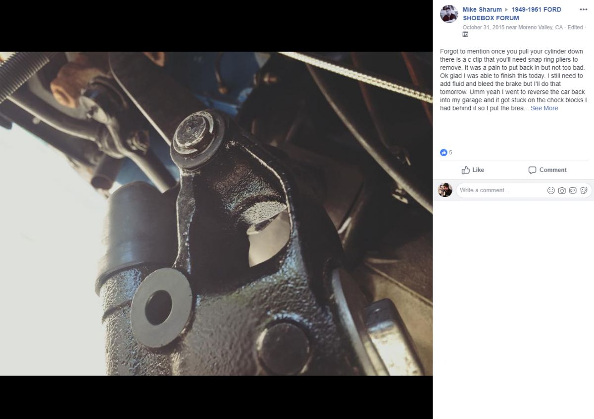

    Here is the really helpful posts by Mike Sharum in the Shoebox Fords facebook group. I couldn't find a way to share it without taking screenshots, you'd have to join the group to see it. Good pics and description of the order to do stuff to replace the mc.
