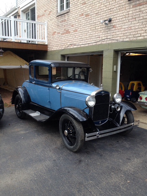

    Would like an original if I could find one, if not going to go for a little more compression so like the Winfield. I do agree the wheels are horrible- going black as soon as the new rubber comes in. Then I got '40 Ford 16" steelies on their way, also want a set of '35 wires while I have a fendered car- nice thing is that I can change the tires between them since they are both 16" wheels. The 16" wheel/tire combo will be a little down the road, when I can afford the tires but I want to get the speed parts first so I can keep up and keep driving this thing to work etc...

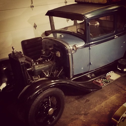

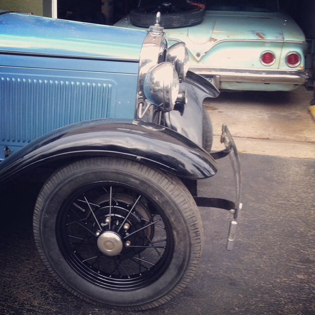

    ImageUploadedByH.A.M.B.1413848578.345880.jpg ImageUploadedByH.A.M.B.1413848589.393240.jpg
    Got the wheels back on and dressed in black. Way better than red if you ask me.
    Also got front spring reversed and took out one too many leaves. So, back out she goes and add another leaf back in.
    Now for the question segment...
    Can I pull the back end down and leave the rear spring attached to the axle then take a few leaves then re install? Read about the c clamp removal and all but I figure since I am not actually pulling off perches it may work, any thoughts?
    whtbaron and grego31 like this.

    I would completely pull the rear end out to perform the work. Clamp the spring with two big c clamps and remove the center bolt. Replace with longer bolt or all thread. Start backing everything apart slowly until just the main is on the axle. Installation is reverse of removal.

  8. You probably already know but you need to run wire wheels on the mechanical brake drums and solid wheels on the hydraulic (1940-48 Ford) brake drums or you must use adapters or make modifications. Just because you can bolt them on doesn't mean you won't have problems in the future (wheels cracking or coming off). See
    http://www.jalopyjournal.com/forum/threads/40-ford-wheels-on-a-model-a.750368/#post-8330045
    for more info. For what it is worth I would go with bent spoke Kelsey wheels if I decided not to keep the original ones.

    I thought that was the case. Eventually going to get hydraulic brakes so already have the wheels ready. '40 ford steels already powder coated.

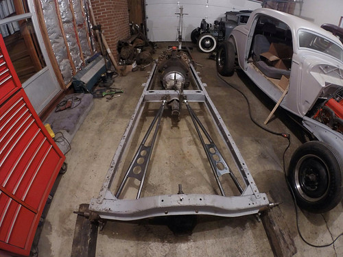

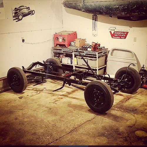

    Ok, so I haven't been around for a while but I am busy use like everyone else with a family and work. Here is an update. Ben Haag has decided to build me a ch***is and swap over the body. Whoa, what was I to say other than hell yes please.

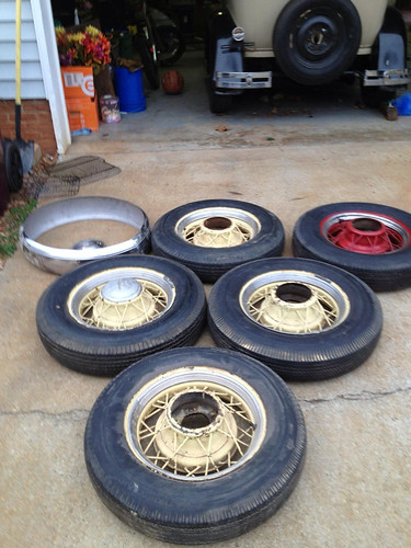

    We got a flatly motor complete with a vintage rebuild tag from an authorized Ford rebuilder (awesome) and a T5 trans, turned out to be a world cl***. Ok so that isn't traditional but I thought it was the right upgrade for a daily driver. That's right I wan to drive this shlt out of this thing so keep that in mind. I bought F1 brakes and rear but turns out the '40 brakes work better with the 2 options of wheels I want to interchange. I lined up a set of sweet *** '35 wires with the help of Ben and his buddy down in NC and I also have a set of freshly powder coated '40 steelies. So will be swapping them out based on how sinister I feel. Ok so that is enough typing, here are some pics of the progress, hey Ben feel free to chime in because you are busting balls on this thing. Elaborate if you wish.
    Acquisition of parts
    http://flic.kr/p/qDes7X
    http://flic.kr/p/qD5xvw
    The mill
    http://flic.kr/p/qDesR2

  20. Sounds great. You probably already know this but you need adapters when you run wires on the '40 drums.

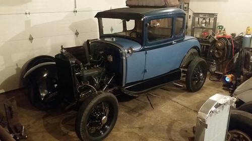

    Fenders came off last couple of days and body ready for its new home Hotrodderhaag sure is tearing through this thing.

  26. Be sure to think twice about the trim rings shown in the next to the last picture. I painted my wheels and added the rings only to decide that it was too much "glitter". There were only a few scratches when I removed the rings. It is all a matter of taste, you may like them and they may look good with the rest of your car..
