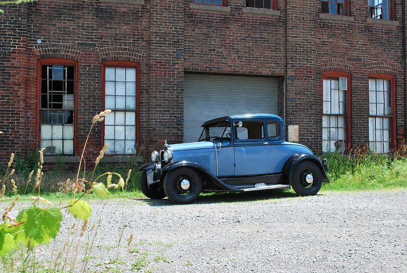

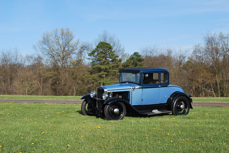

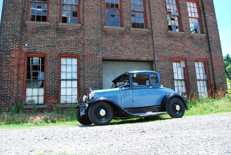

    We had a beautiful Sunday here so took the boys for a ride through the local park. They were ear to ear in the rumble seat. Here are some pictures I took afterwards.
    [​IMG]DSC_6263 by Bob G, on Flickr
    [​IMG]DSC_6253 by Bob G, on Flickr
    [​IMG]DSC_6261 by Bob G, on Flickr
