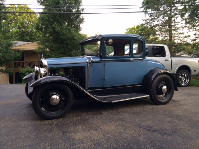

  13. Malibob
    Joined: Feb 23, 2009
    Posts: 503
    Malibob
    from Pittsburgh
    They are excelsior. I know they aren't your typical Firestone but they match which was a real big deal to me, and they are both car tires so that was another big issue.

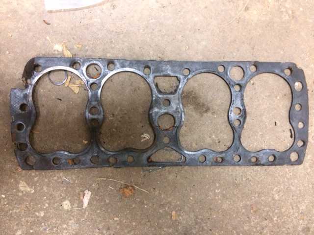

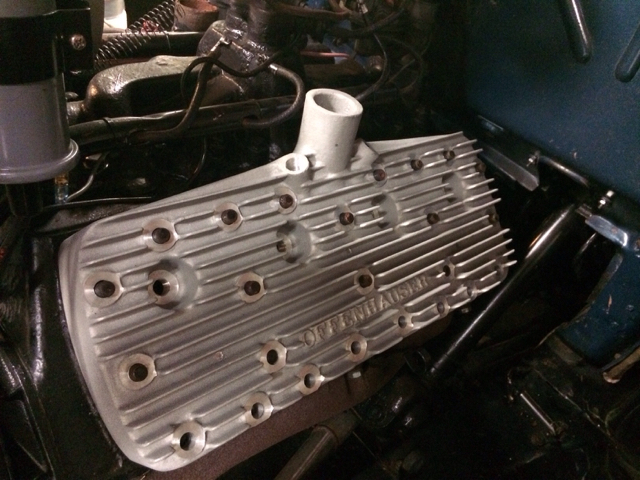

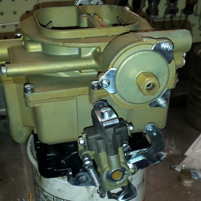

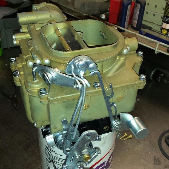

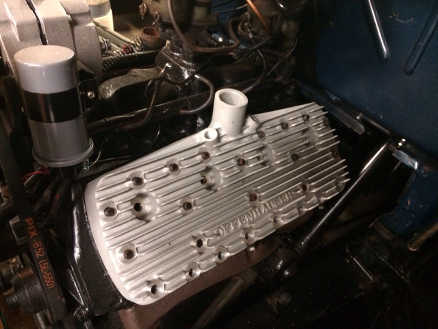

    So this thing hasn't just been taking up room in the garage this winter I have actually manned up and decided to try and put some aluminum heads on and get the carb on too.
    Stromberg Aeroquad all rebuilt and cleaned up
    Thanks to Rich for the work, now get better so you can send it back man. Seriously though - get better
    So if you've been following you will remember that the radiator is also off to get fixed, since the whole front end is off I figure it's a perfect time to take the heads off and try to break some studs. Got the drivers side off and so far one stud came out. I am using the trans fluid and acetone method for relieving the bolts. You can bet I will *****, I mean let you know about how many I break. Anyways here are some pictures and some motivation pictures of the Offy resting in place.
    Ok so all this is pretty common to you guys but I do have a tip in all of this, it's RockAuto. I looked everywhere for gaskets and they aren't cheap, but then on a whim I looked on RockAuuto's site and they had a complete engine gasket kit for less than I could pay for one head gasket. It's a fel-pro too. So look there before you call your speed shop who's charging for the trend of traditional rods.

  24. hotrodderhaag
    Joined: Jan 22, 2007
    Posts: 2,146
    hotrodderhaag
    You should be running copper gaskets , sprayed with copper sealant if your going aluminum heads . It's a life saver !

    Little update. Got the heads on finally. Only had one stud that leaked and just took it out, put more permatex on and we are in good shape. I think I broke about 8 studs which all things considered I didn't think was too bad.
    So the next step is to flush the cooling system. It has been running about 160 on a hot day so gonna need thermostats too.
    Surprisingly enough I noticed a difference in torque and the exhaust note.
    So after all that... I decided to run the hood sides. Nothing like spending a few hundred dollars just to cover it up.

  28. Malibob
    Posts: 503
    Malibob
    from Pittsburgh
    Did a little rod run to OH with my buddy this weekend. Car did exceptional. Almost 100 mile shot and only one stop... for gas.
