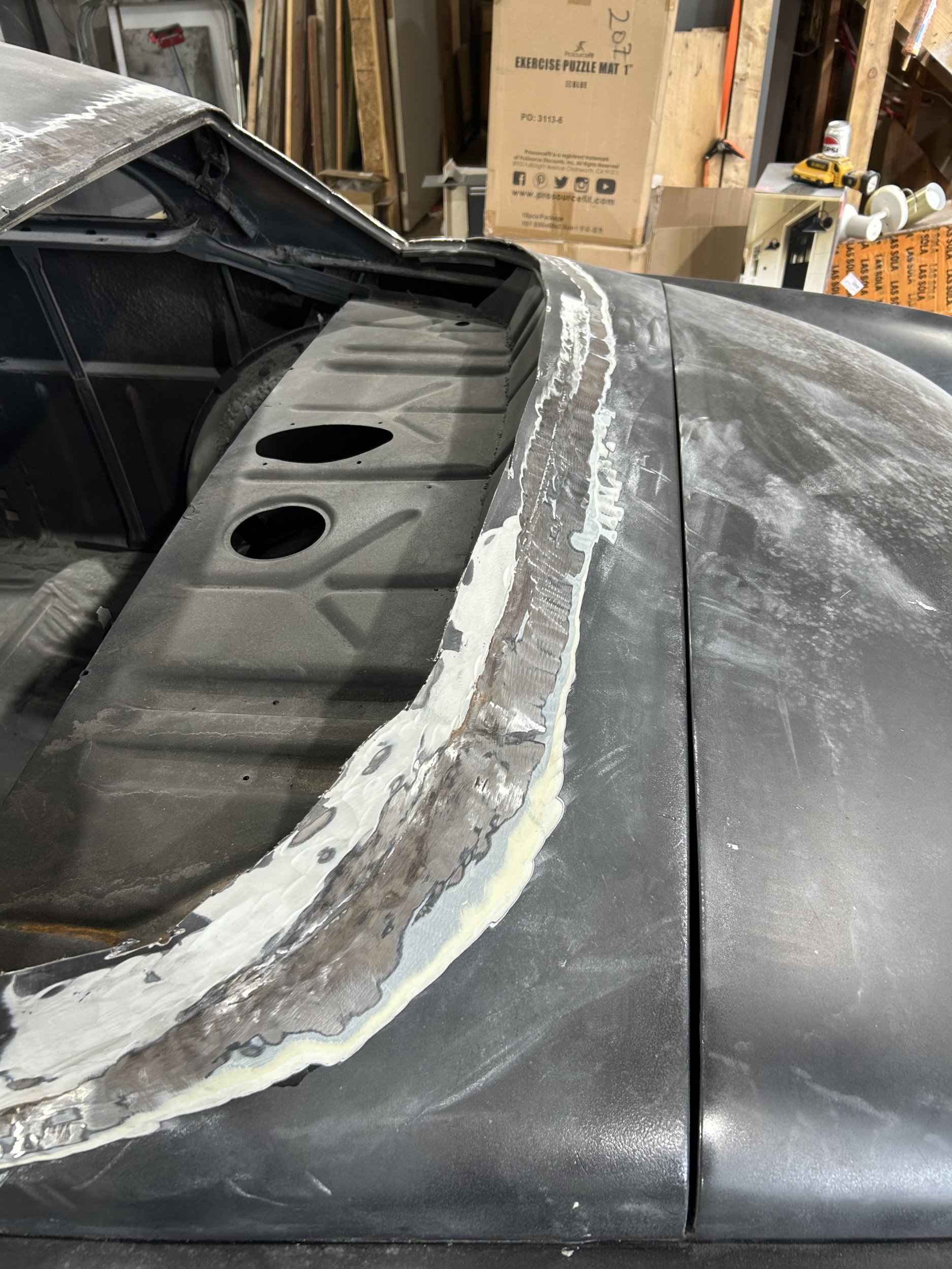

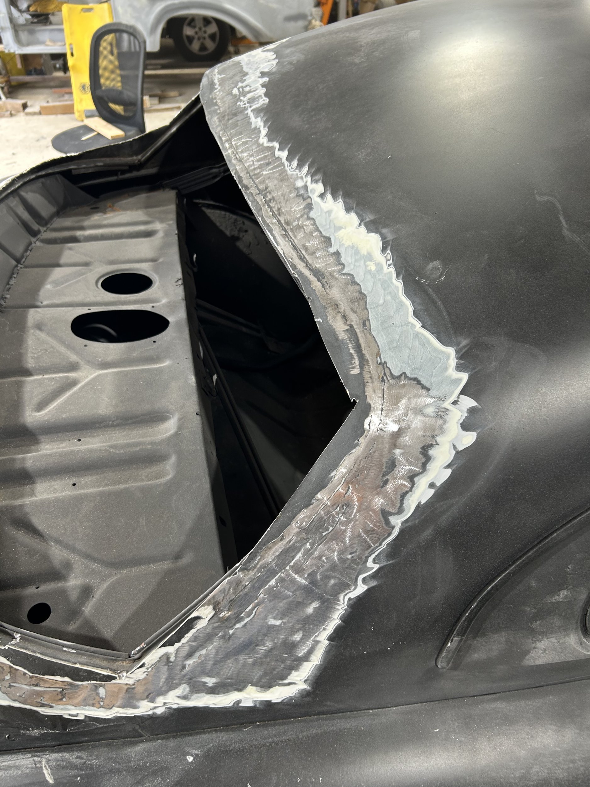

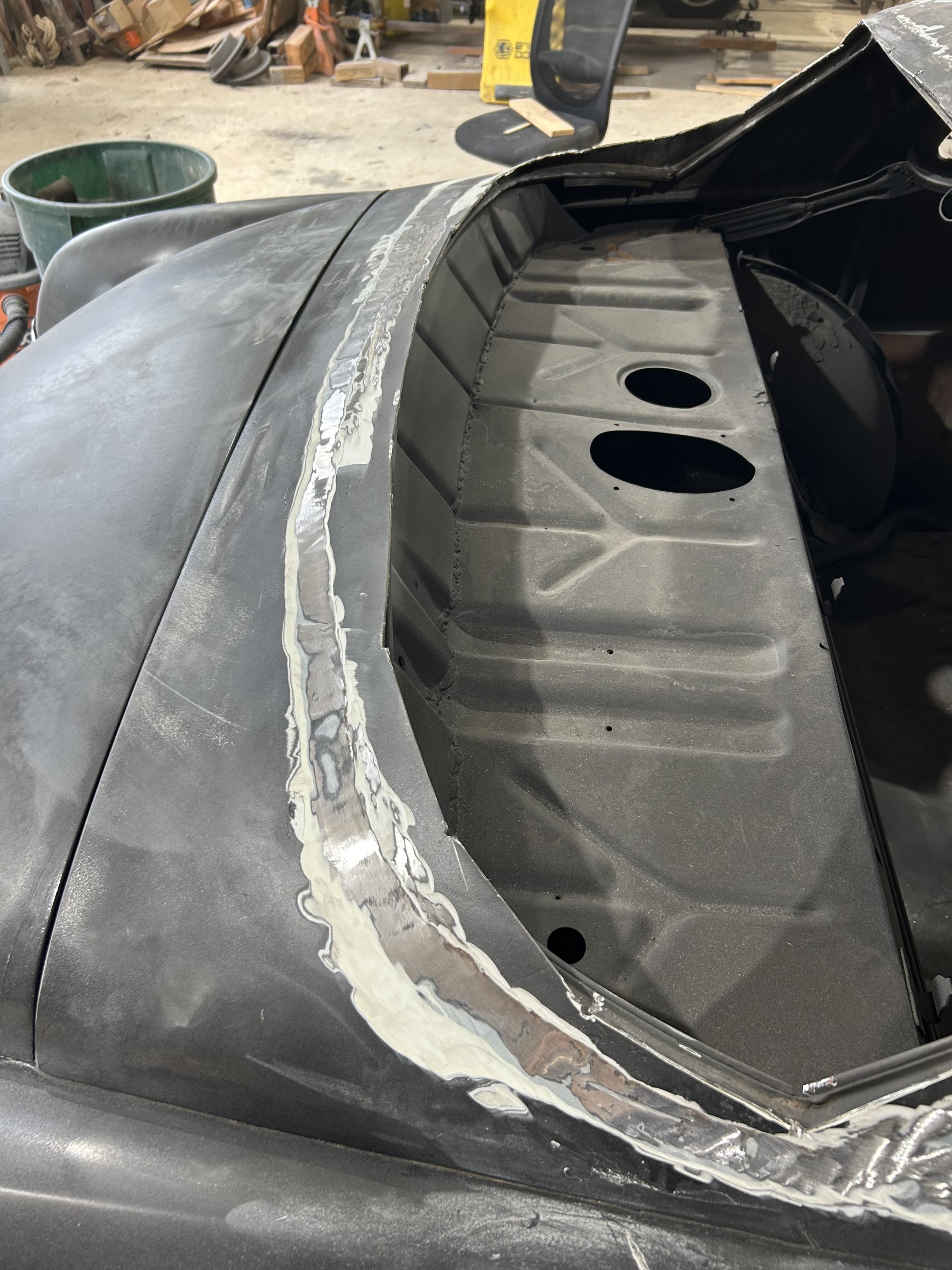

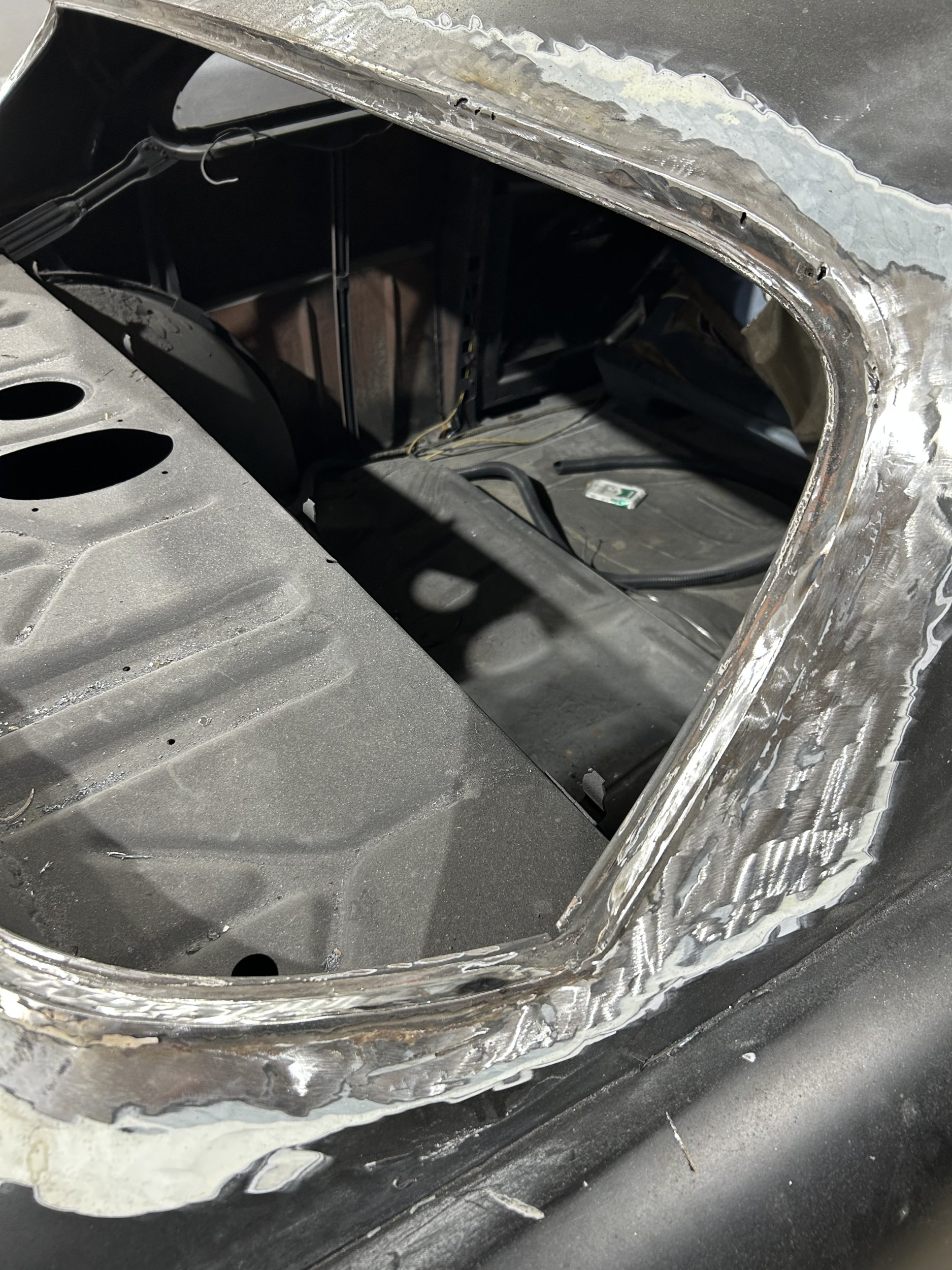

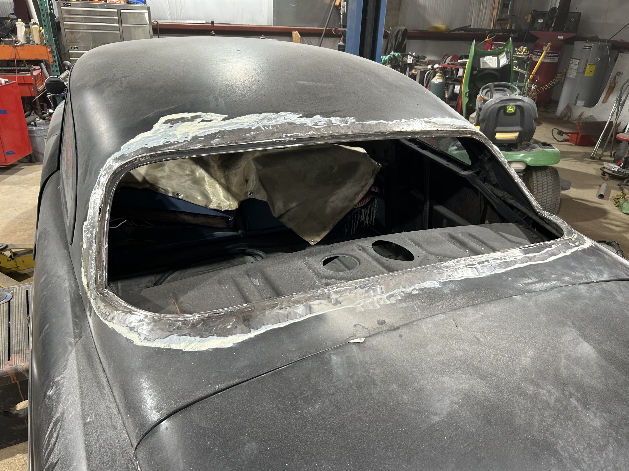

    Well, she’s opened up! IMG_1336.jpeg IMG_1335.jpeg IMG_1333.jpeg IMG_1332.jpeg

    Great work, can't see in the pics, how does it look?

    ok-put in the factory window or 3 pc poncho?
  13. This looks promising. No big surprises that I can see.

    There’s quite a bit of Bondo involved here. But the metal looks good. I’m thinking take the bondo down as much as possible and start fresh and fix the bondo areas.
    I have a 50 window opening that I’d like to go with as again, all I hear is 51 windows are hard to find and hard to fit when chopped.
    I’ll form the sheet metal and tack in the window opening from the 50. The current opening is larger than the 50 opening. Do I just leave the 51 opening in place and work from it, or remove it completely and start over?
    Thoughts?

    Looks like the last guy couldn't find a '51 rear window either. Must have had one at one time. Either somebody broke it and couldn't find one, or they screwed up the frame when they chopped it, so the gl*** wouldn't fit any more.
    Just my 2c, but it seems a pity to use a '50 window, as the '51 gl*** looks so good when it's laid down.
    54delray likes this.

    Man, If there is really an entire 51 window opening there I think I would carefully trim down to it, make sure it is square and true and put a 51 window back in it. 51 windows look awesome in a chopped car. I can't imagine the Hirohata car with a 50 window can you?

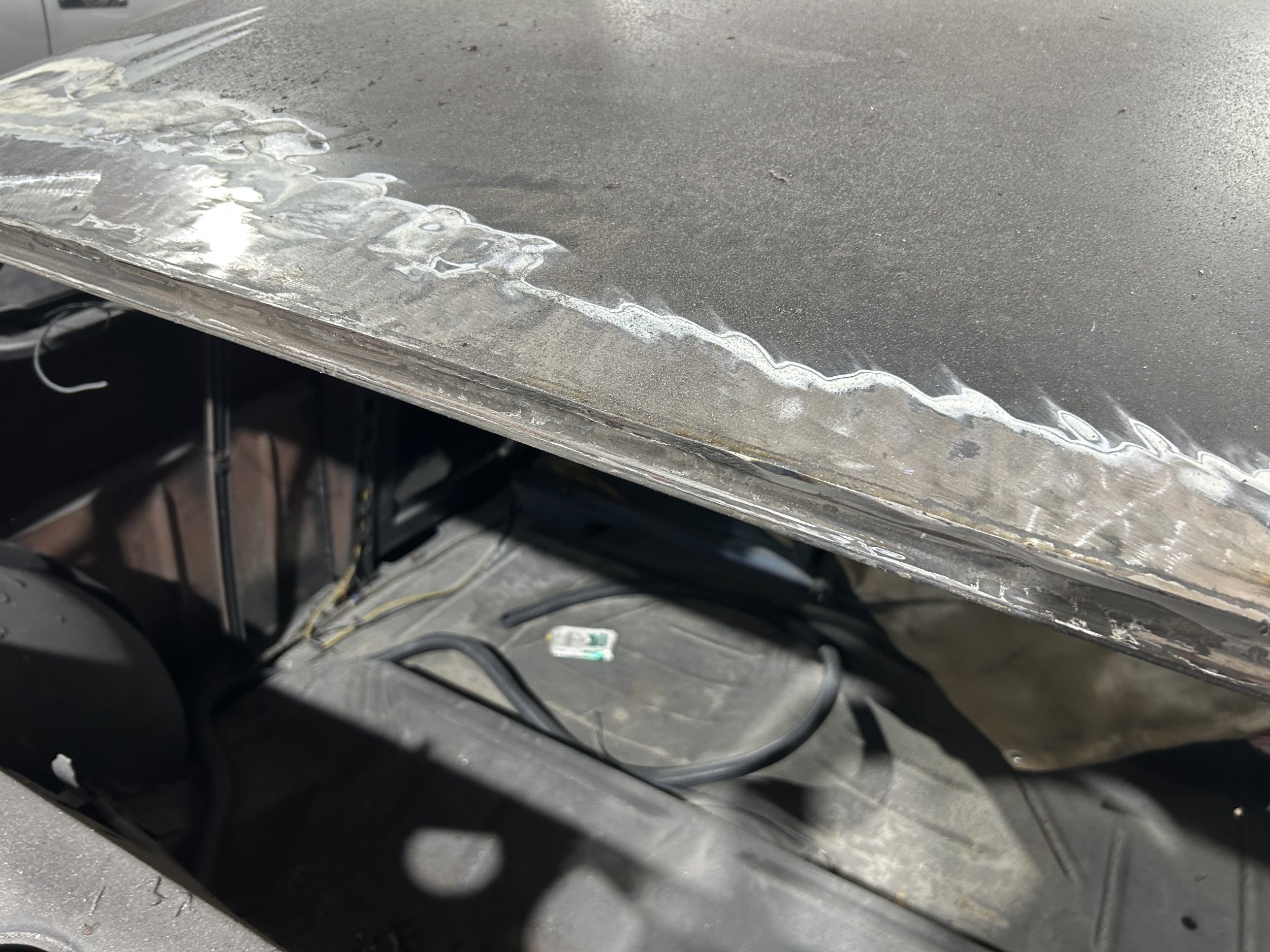

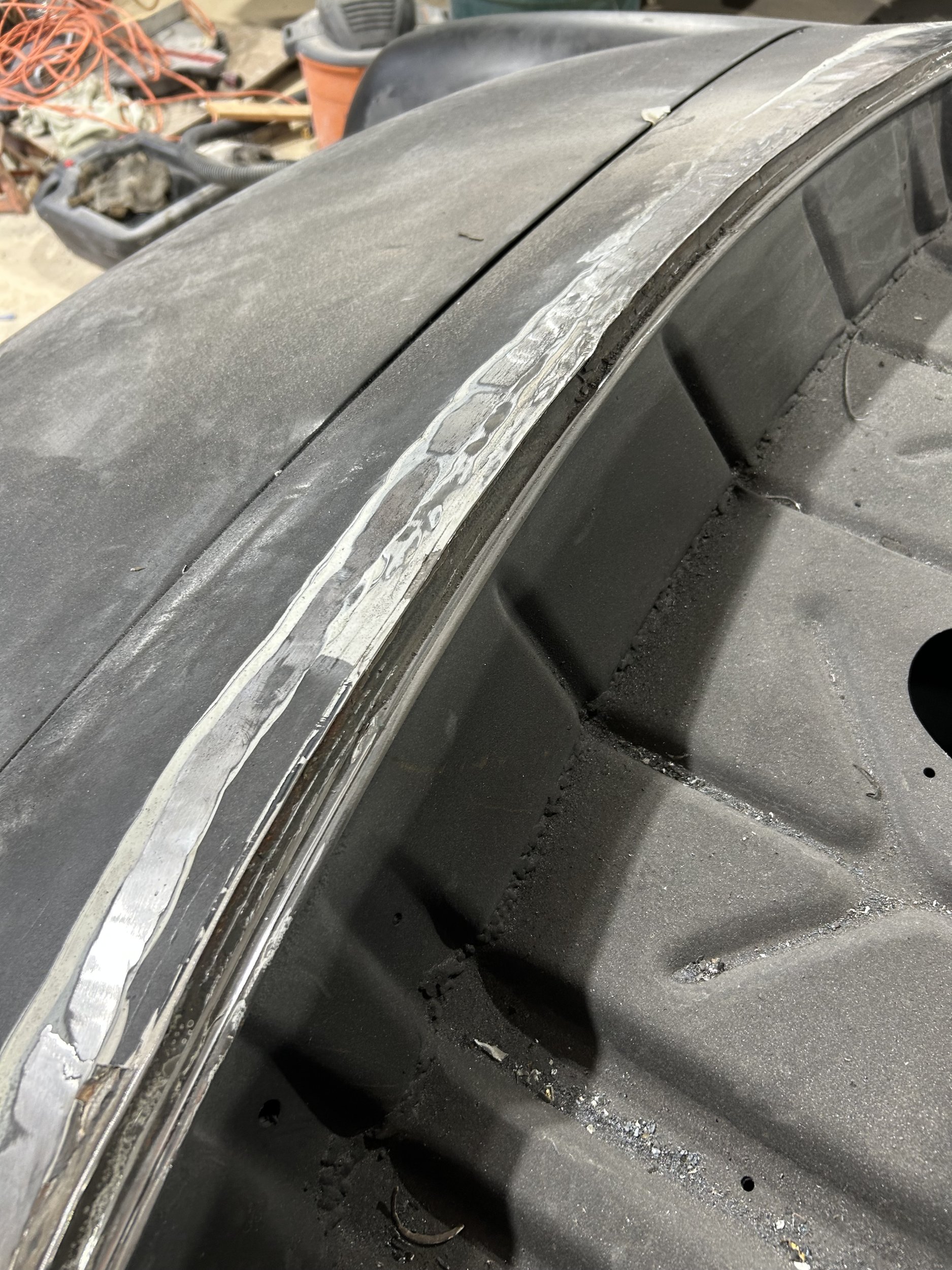

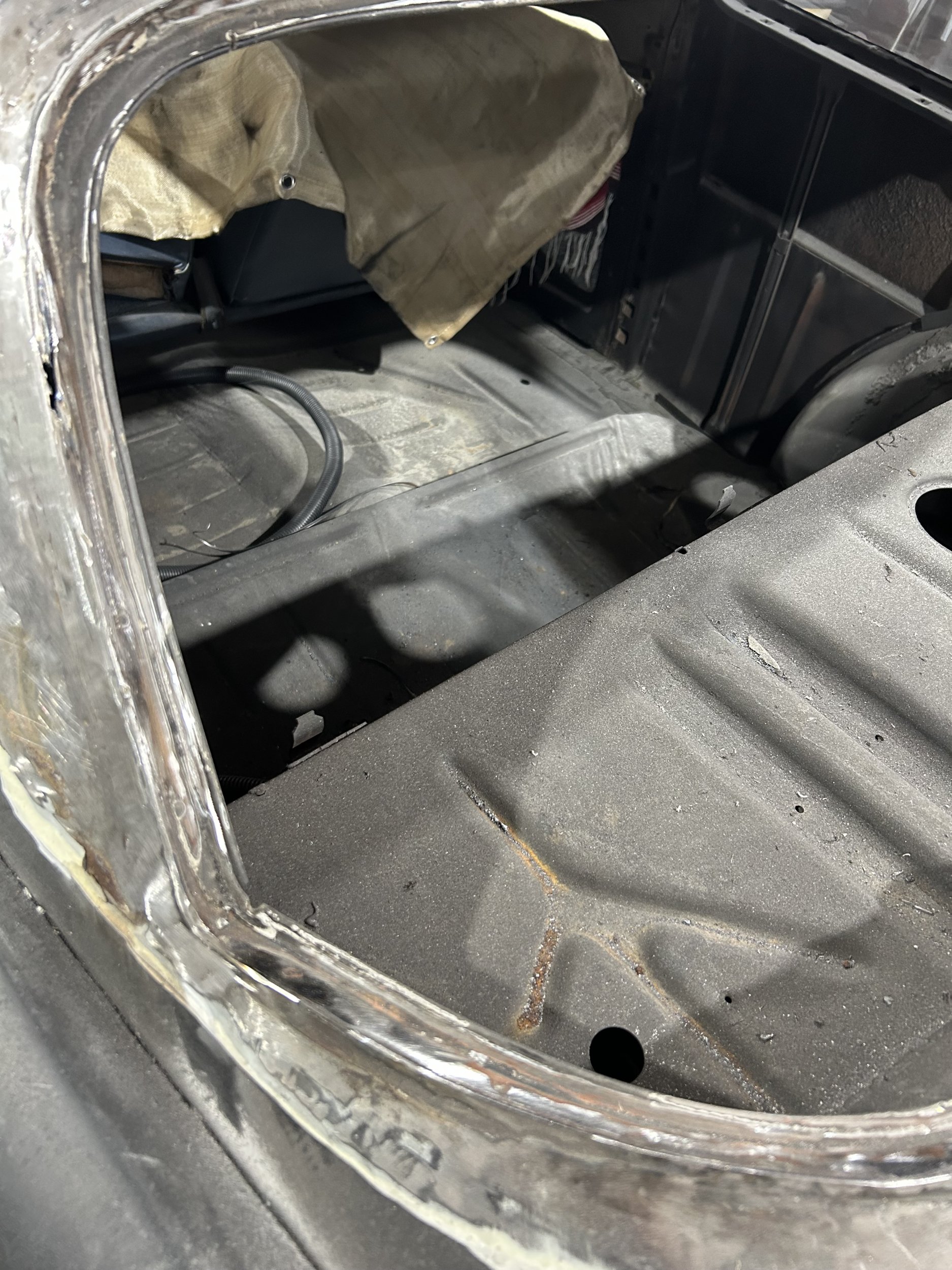

    A few more pics after today’s efforts.
    The window from center of hood to the top, daylight to daylight is 20.5”.
    Can anyone confirm on their 51 what that measurement is?

  21. I agree that reinstalling a 51 back gl*** is the best fix for this project. Let's hope that the choice to do what it had prior wasn't due to poor work on the Chop that distorted the opening so that a stock 51 gl*** didn't fit well enough to seal properly. We'll find something locally to verify prior to going any further.

    wait! Someone covered the 51 rear window with what was there when you bought it? that seems crazy. I hope you can find a 51 window and make it work. That's a nice car and the right rear window will be a game changer

    You uncovered gold when you deep sixed the "dog nostrils" rear window to find a 51 frame! The only sure course is to lay a 51 gl*** in there to see if the sheet metal surround is dead on or wonky. Well worth the tedious work, if it needs some metal work adjustment to make the opening perfect!!!
