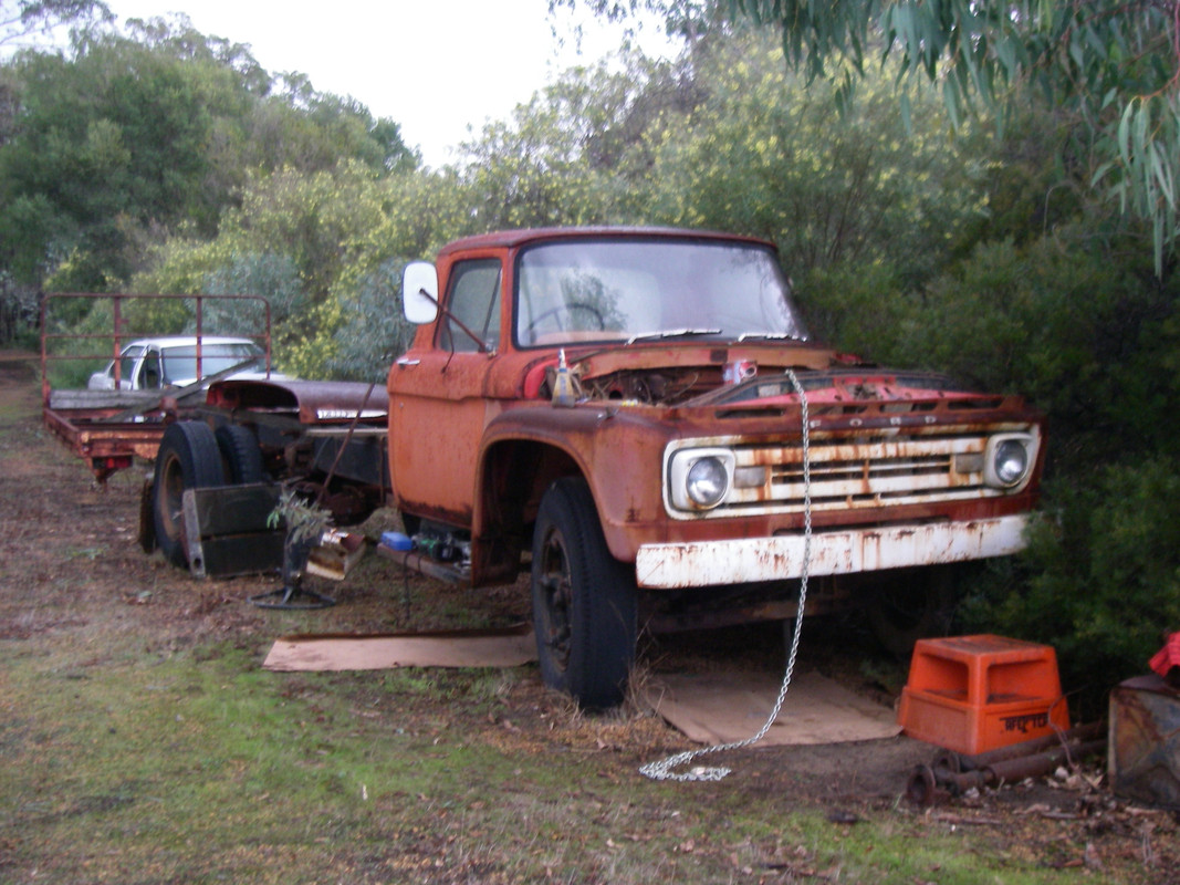

    well after 18 months of waiting i have finally got my motor.....
    might not seem a big deal to you guys...but finding a 292 over here in oz is a bit of an ordeal...
    we did not get many of the "big" motors.

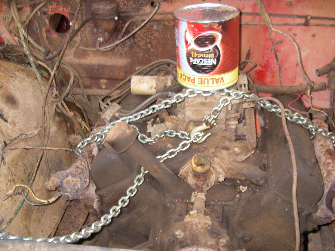

    i think it is a 64 model truck and the motor is a C2AE 60150

    the motor is a lowish mileage ....for now i have closed all the water orifices and filled it with citric acid because it has been sitting a loooooong time...that will clean the internal rust then when i pull it down i will check internal condition and rebuild accordingly.

    hey guys,had a bit of spare time today so dumped the citric acid out of the motor and must admit it came out cleaner than i expected, although still discolored so flushed it out and refilled it with fresh stuff.
    then i decided to see if it turned over,so i removed the plugs and they were very black,running pretty rich i would say,i then filled the bores with diesel and started turning it over with a socket on the balancer...no luck so tried the screwdriver on the ring gear and that got it moving...went back to balancer with a socket and breaker bar and spun the motor a few times...sounds like plenty of compression so i am pretty pleased with my "new" motor....
    not surprised with the richness on the plugs as it has what looks like a 350 holley on it...not that they are a bad carb..prolly just badly adjusted.
