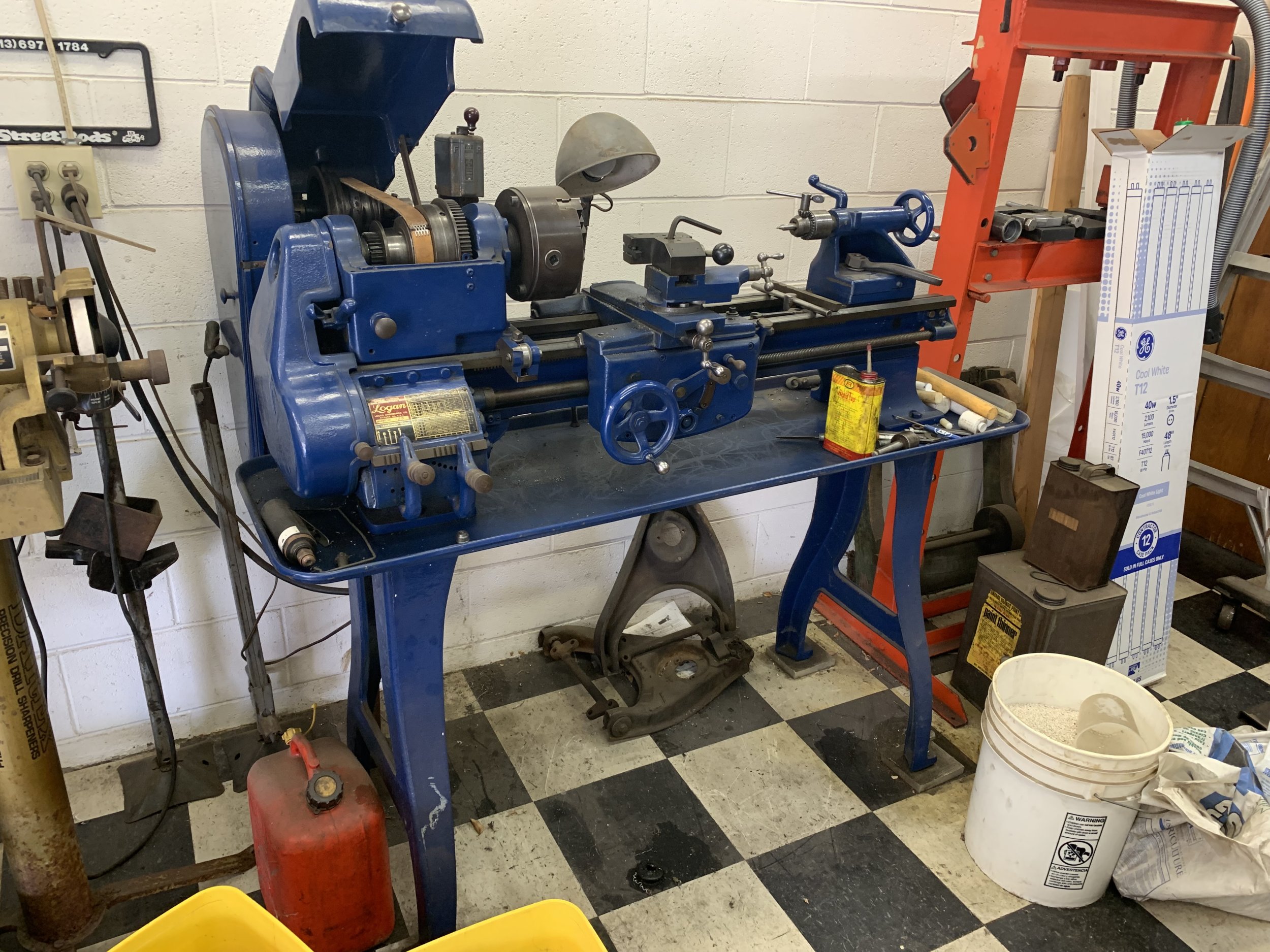

    Now it’s time to rewire this thing. (Photo of lathe taken at sellers property). IMG_2773.jpeg IMG_4360.jpeg IMG_4361.jpeg IMG_4362.jpeg

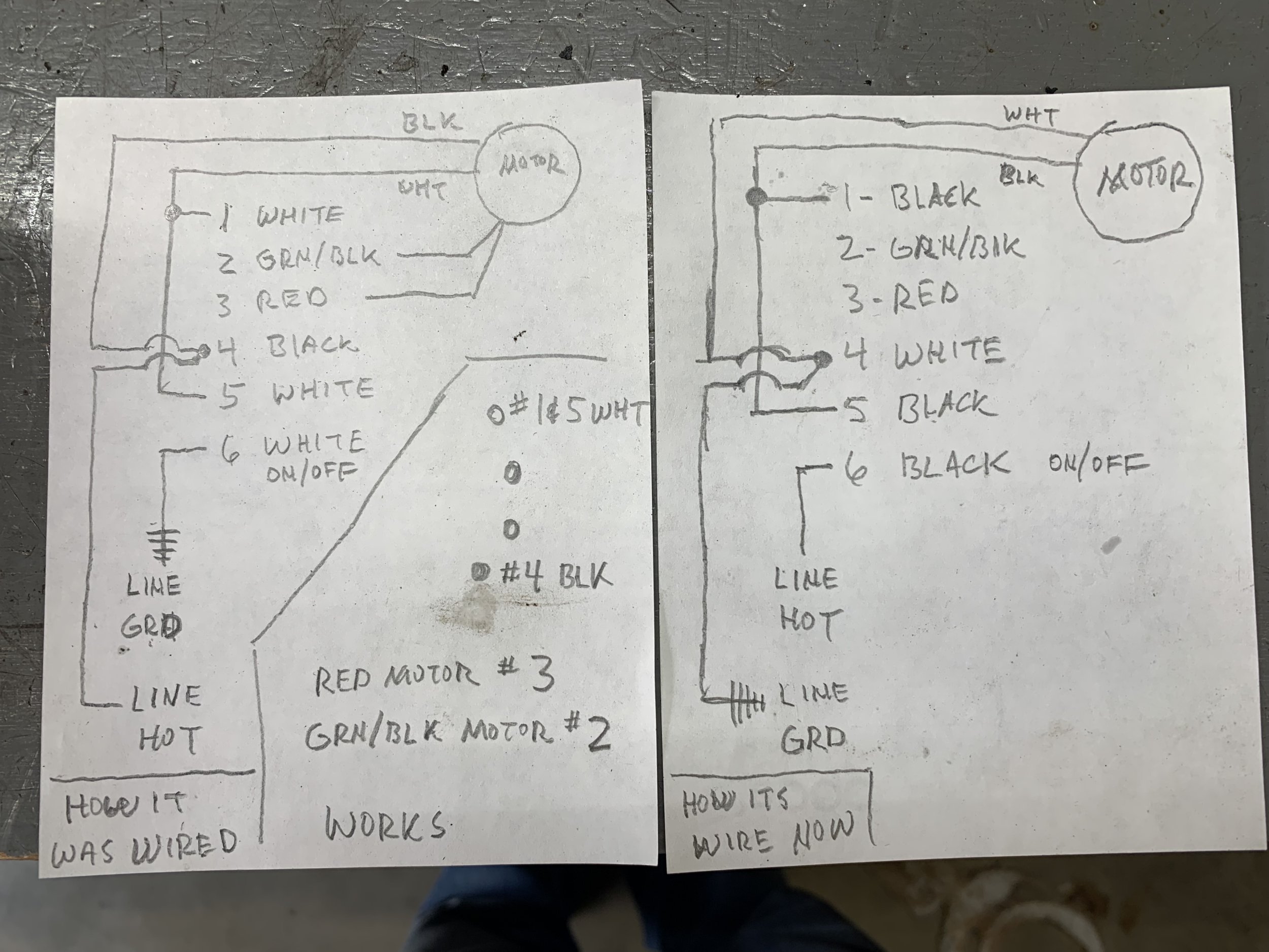

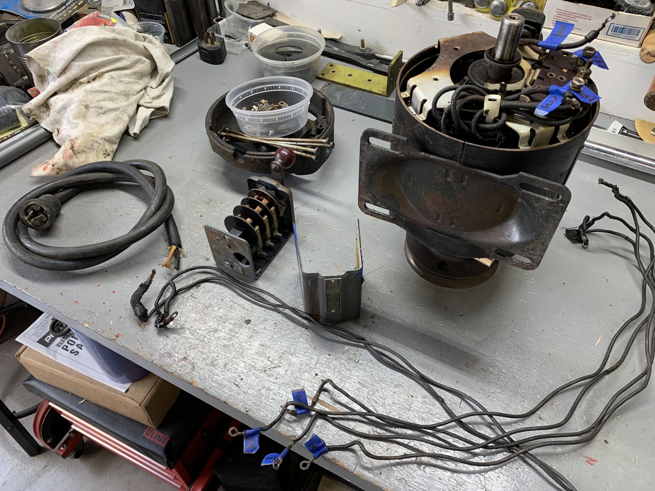

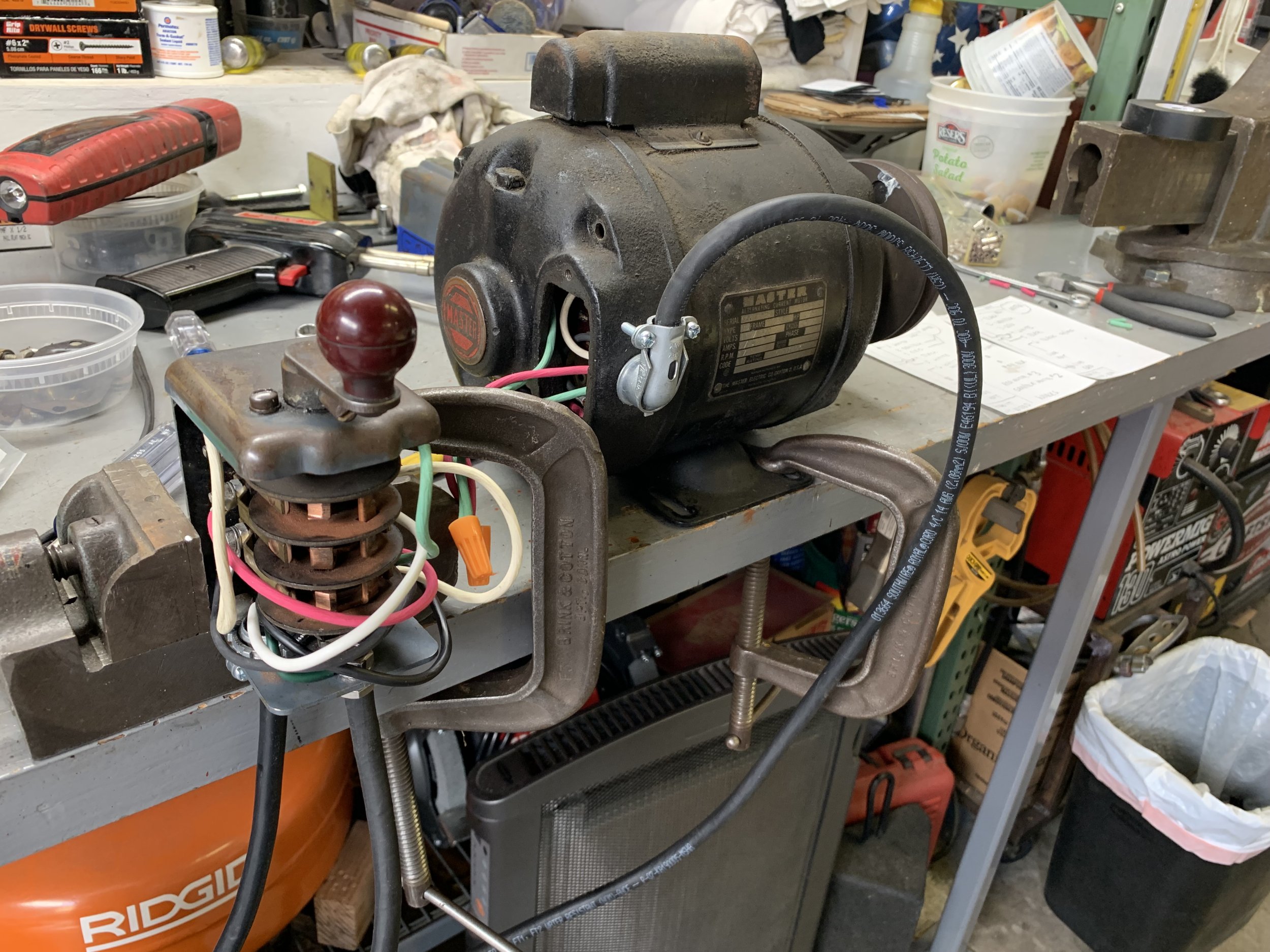

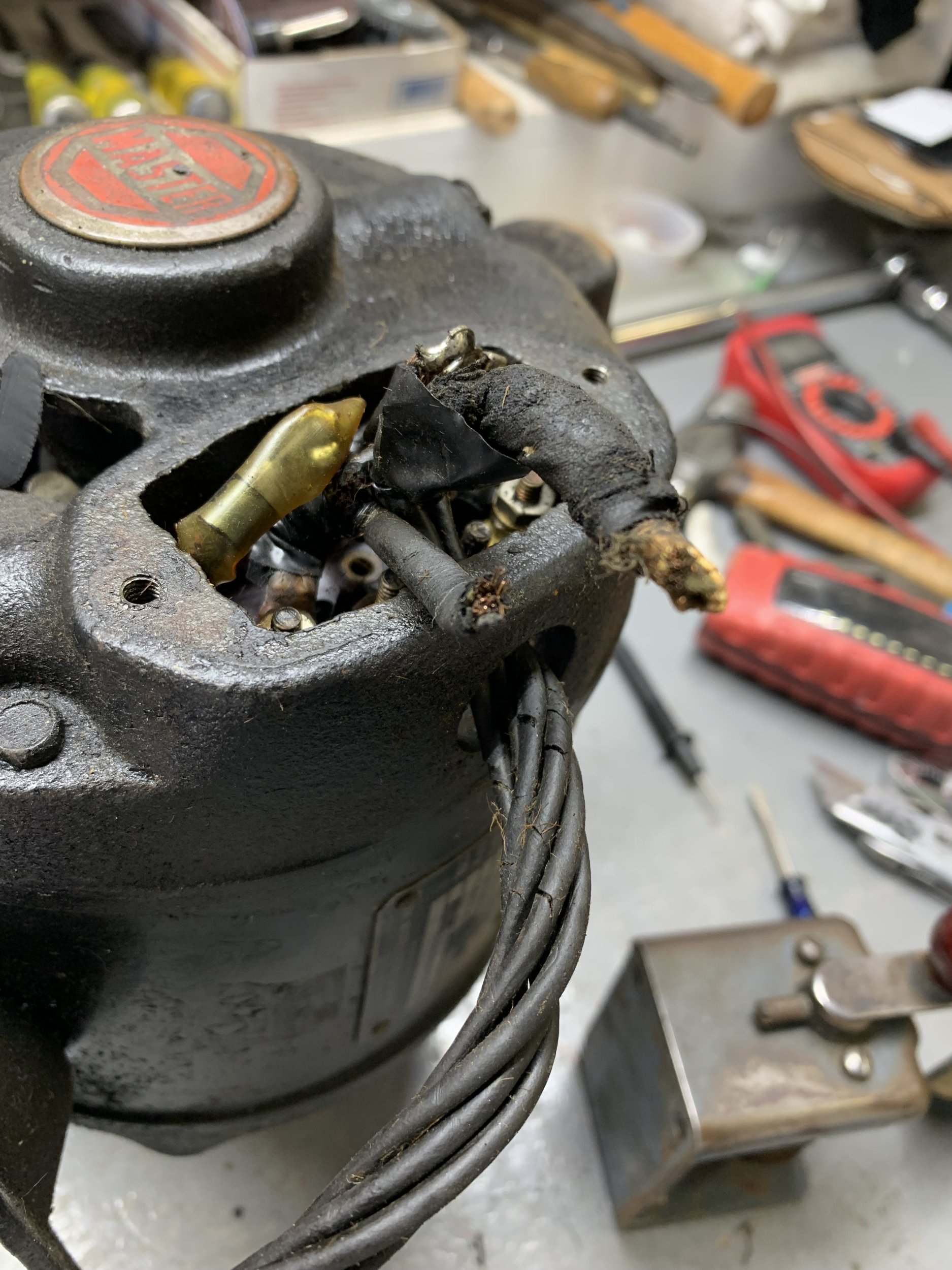

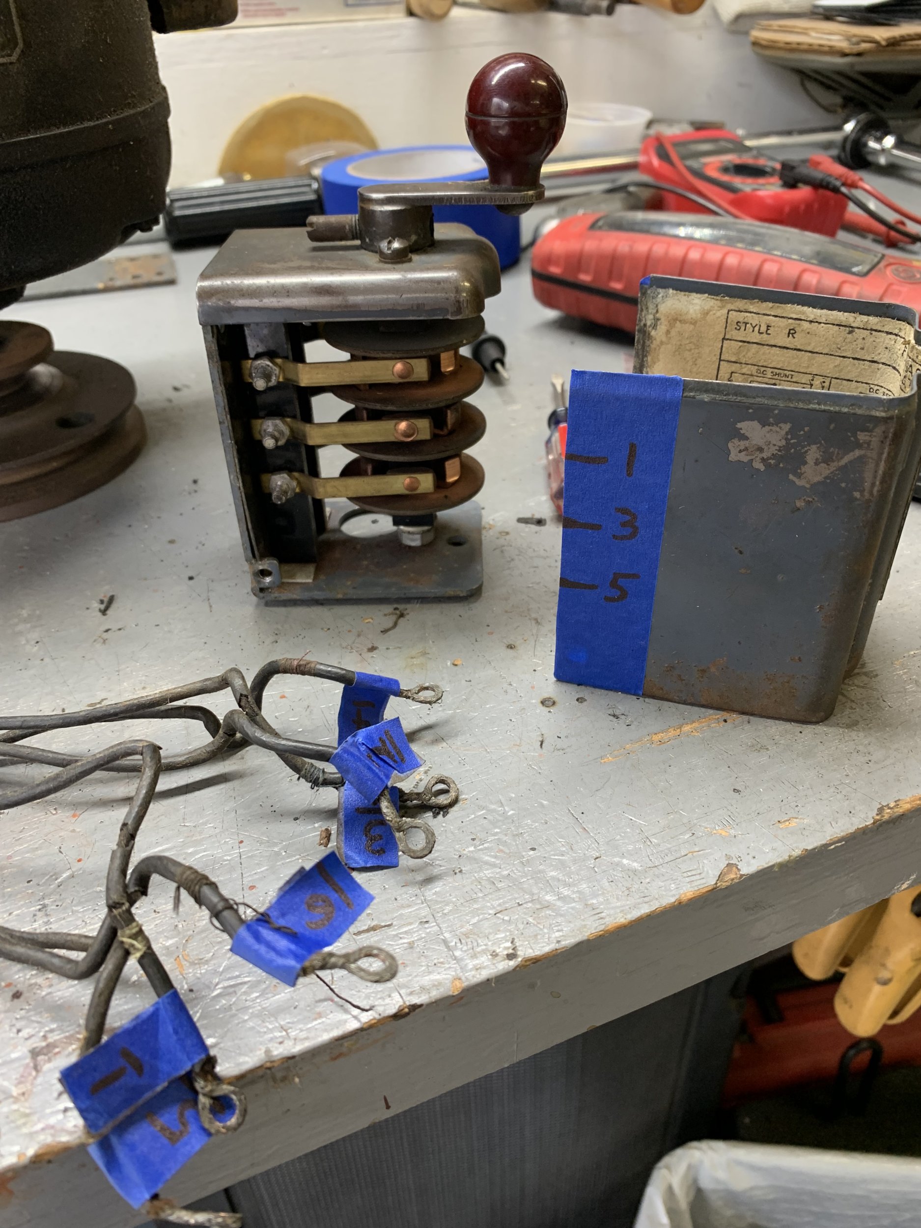

    It survived the test wire up. Wired it at the first time just as it was. However the neutral was wired up as the on/off??? Leave the motor internally Hot at all times. But it worked as needed I guess.
    So I scratched my head and hoped for the best. Now the Hot line is switched. Much better in my mind anyways. IMG_4368.jpeg IMG_4369.jpeg
    Now it time to clean up the wiring and ****on it up for good.
