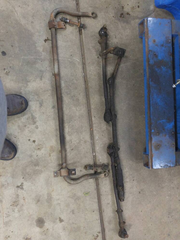

    Okay starting with the steering and front suspension. Hopefully by spring ill have the basic mechanicals on this car disassembled, degreased, blasted, painted, rebuilt and back on the car. I've been able to find all the seals, bearings, ball joints etc I should need but this stuff's expensive! I did all this on my 52 customline for probably less than half the price! Ah well, ill forget all about the cost when I'm cruising with no worries next spring. Ill keep you all posted as i scrape away at nearly 60 years of smeg.

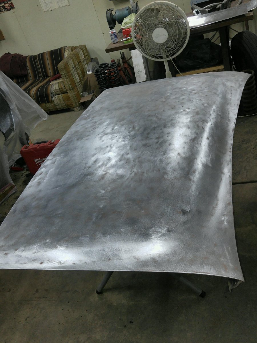

    Alright well the front suspensions done. I'm gonna take a break from the mechanicals and decided to give er a face lift with some new single stage super jet black . So i got the trunk lid stripped, some emblem holes welded shut and a couple coats of epoxy. I'm gonna strip one panel at a time, do the metal work, epoxy primer, body work, a coat of polyetester primer, block, prime, wetsand, spray.

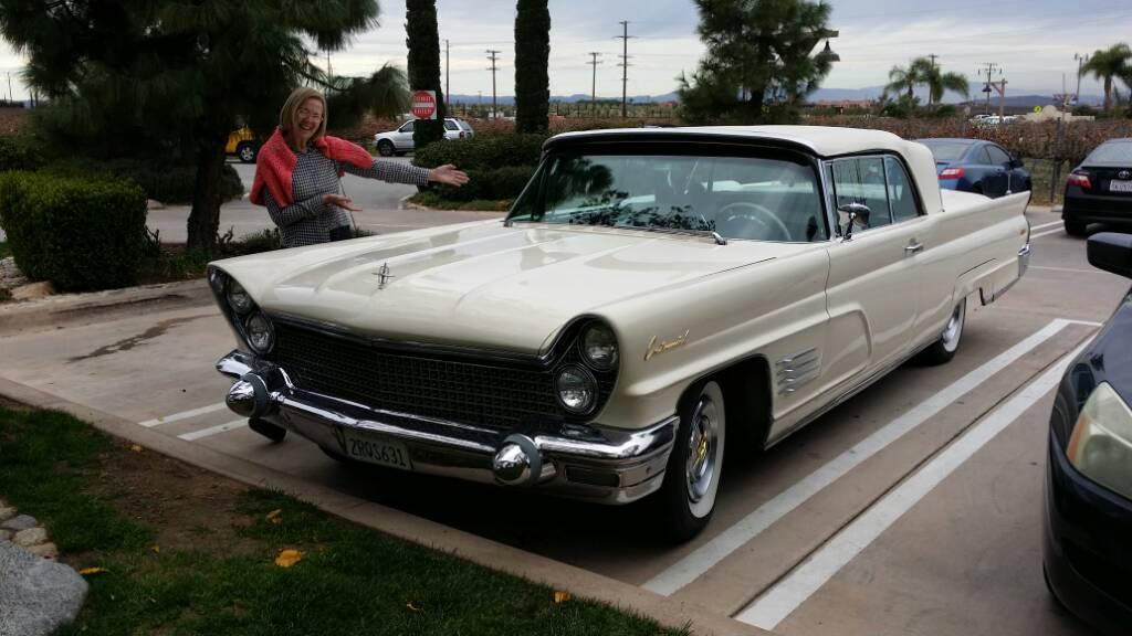

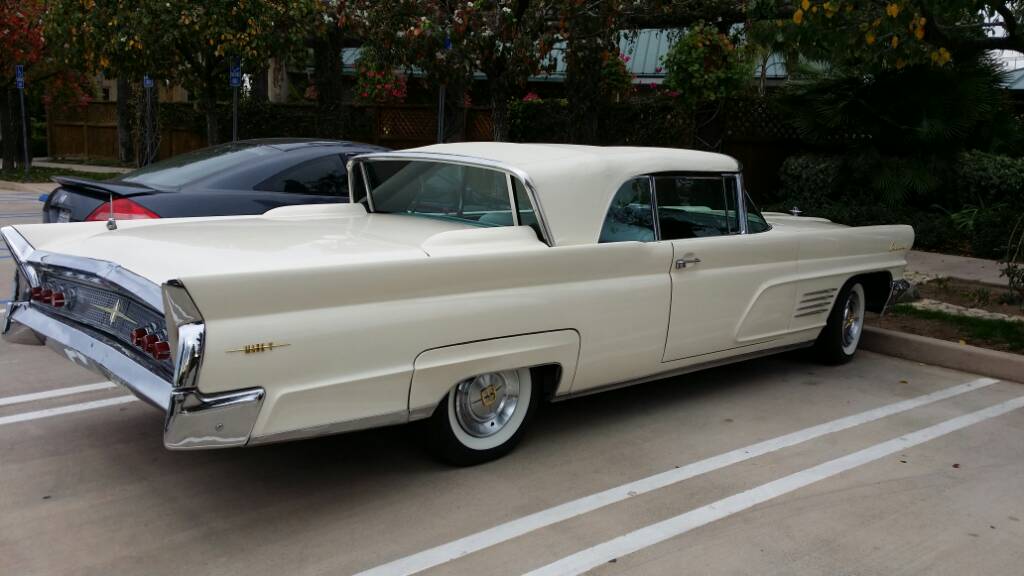

    It is wonderful to see you rescuing the 58 Lincoln. They are at the height of 50's styling at it's best extravagance. I see this white one driving around Temecula, CA and it always stops me in my tracks to admire the great style. Keep us posted. Thanks. TEB

    Tevintage thats a beautiful rag top! Thanks for sharing
