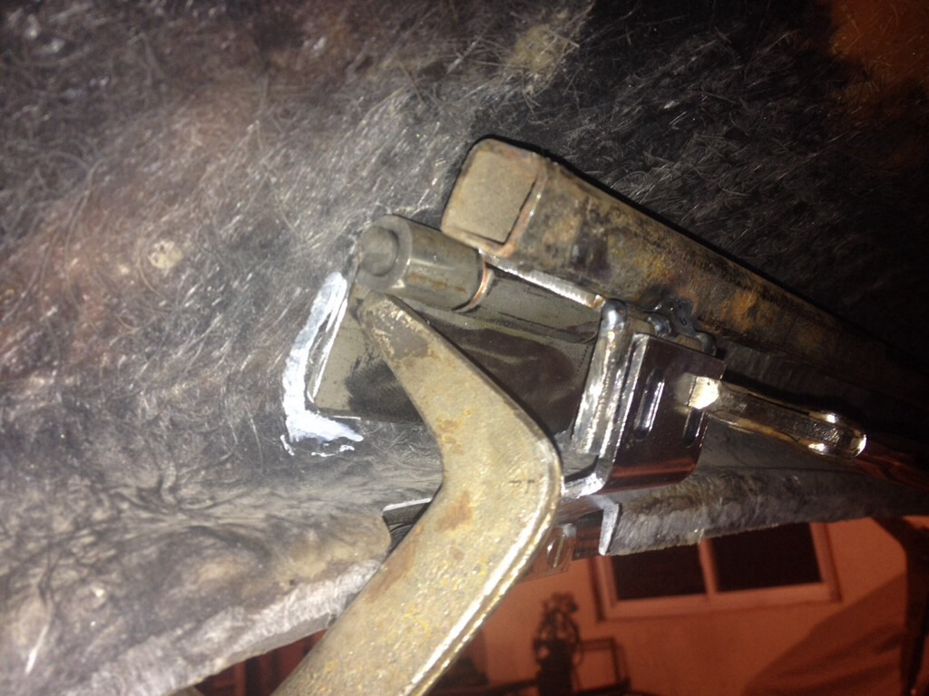

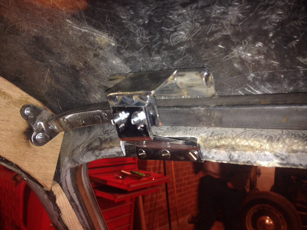

    I fabbed up some hinge brackets for the windshield. I used some stainless hinges and trimmed them way down, tacked some tabs on that would attach to the original brackets on the windshield frame .. Once I get it all tweaked , I will glue the hinges in place.. I did tack a piece of tubing on the hinges so I knew they were square. It's coming .. Slowly but surely
  4. alchemy
    Joined: Sep 27, 2002
    Posts: 22,548
    alchemy
    I would recommend welding the body-side of the hinge to the long tube, and gluing the whole length of the tube into the car. There is a lot of force on the windshield, especially if you have it opened up. I don't think the small area on those hinges is enough surface of glue to hold it into place.

    That's the plan. I want to make an entire cross bar up there that is glued to the body and holds the hinges. the tube on there now it's just to keep em square

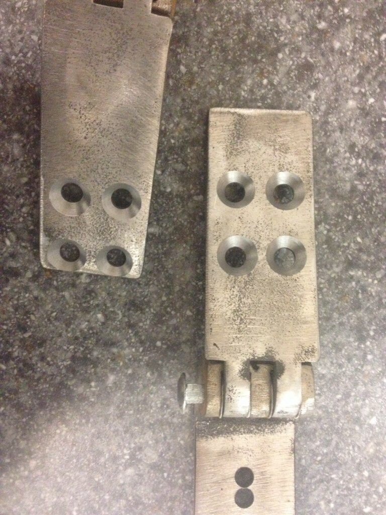

    I clamped my hinges in the Bridgeport at work to countersink all the bolts. Soo Much better. And I also ordered special bolts and also stainless rod for my hood hinges . That all came In today.. Still more casting marks to smooth out on them.

    Last night was productive. A few hours got the windshield hinge mount all installed , sill needs all smoothed out and bonded in but it's screwed in for now. Also I installed all the passenger side door hardware and hung the door. It took some work I get it to close nicely.. But a few small shims and it's good to go! I sill am waiting on my new striker bolts to be made. Time for windows and glue some outter doors on

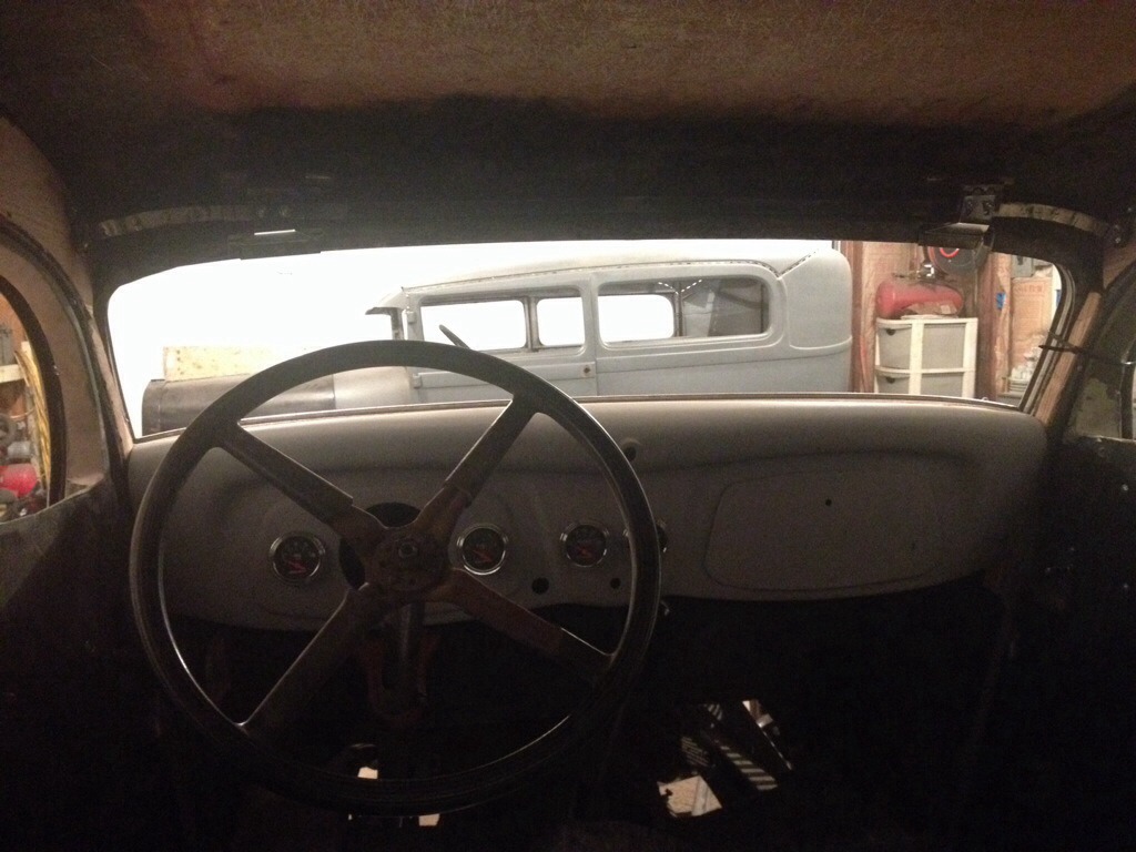

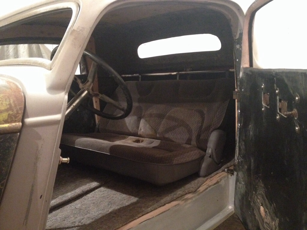

    The inner structure is all done! Body mounts are all done. My buddy called me at 10pm to let me know he had a nice dodge caravan seat that will fit my car. So he brings it over and we blow all the crappy brackets of it, set it In the car and it's perfect! I'll have it re covered in black leather but the fit, the shape, size, everything is good. And it reclines also. Even better! With it sitting almost flat on the floor, I have a good range of view, but I will have to bend my shifter to sit back a little further.
    That's tomorrow's project and get the front of the car bolted down tight. I also installed the window channel . Struggling a little with making the window templates perfect .. I want to get them exact for Chris to make me windows so I can glue these outter skins on. That will be major progress to me!
