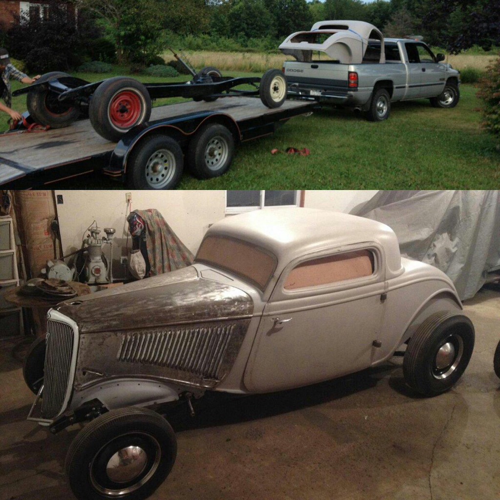

    I was sitting in the 34 with the doors closed shifting gears and making engine sounds..
    Waiting in to window crank to come in. And I started finishing all the body work inside the car, smoothing out seams and edges.
    Pictures make it look rough but it really looks great inside !

    Haven't done much other than finish all the inside of the car. All the inner brackets and tubing is done.
    Spent a few hours sitting in the seat figuring how i want things .. So I broke out the torches and fixed the shifter that was way to far forward for the chopped and channeled body

    Hand stripping the hood .. Louvers are terrible to do! But It looks good and they are extremely straight

    I bought this car 6/19/2013
    It's come along ways since. Hoping to have it done in less than a year

    I gave the good a thick coat of high build primer . Much better . It's very straight .. Much better than I figured. It's a lot easier to see with an even color on it
