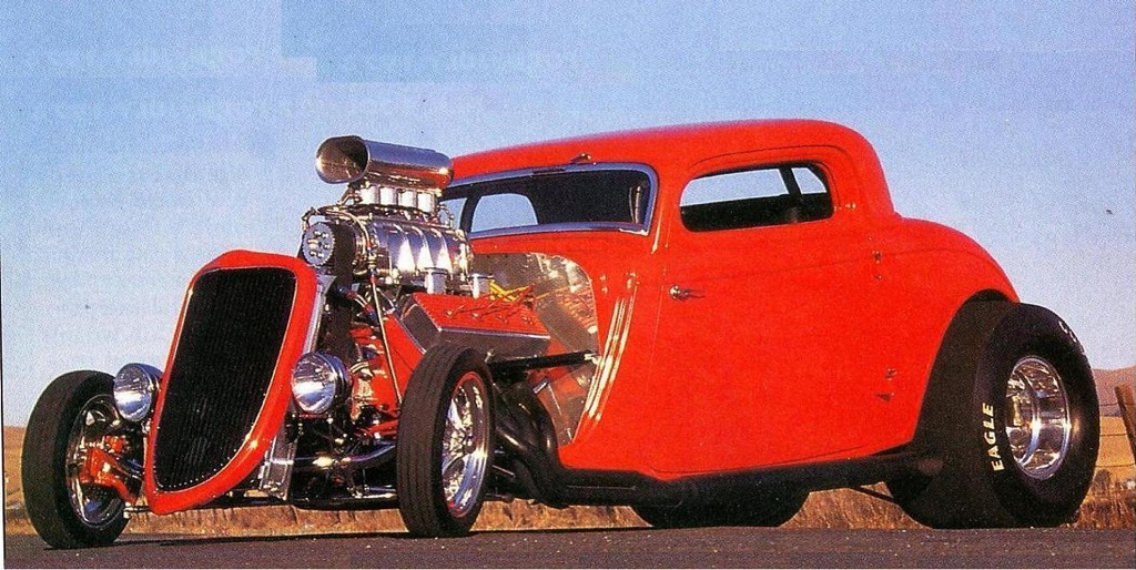

    First off I want to say you have two damn nice cars. Over the last couple weeks I have read through both of your builds the A coupe which is really badass and the 34 you are building now and so far I have seen nothing but good craftsmanship I do have one thing I would like to suggest on this project and that is some suicide safety pins. As a person with some experience of a door blowing open at 70 mph on a 34 coupe I strongly suggest you put some safety pins in just to keep all the good work you are doin in good order.
    Next I fully understand your using a glass car as a guy who has Willys stuff (a 40 pickup and several sedans all steel of course) I really get it I would like a coupe but they are just way too pricey for me so I will probly do the same thing you are doin.
    Finally I really dig your style of car but wanted to share a pic of my favorite 34 coupe of all time and it just screams hot rod I know it's probly not what your all about but I figure you can get it. Keep up the good work

    That orange coupe is ignorant. it does not have to be original style to be bad ass.! its a nice car for sure. the stance is killer
