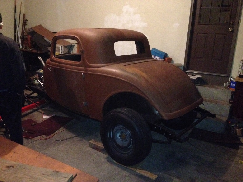

    My deck lid arrived today. Rough but fixable!
  12. hotrodderhaag
    Joined: Jan 22, 2007
    Posts: 2,143
    hotrodderhaag
    Took the deck lid home and it's 1 inch to big in all directions. My buddies 33 lid fight rite in. Wonder what the difference is
    Oh we'll, I guess it was worth a shot

    The deck lid Came off this 34
    But my buddies 33 3 window lid fits my car? That's why I'm lost . His is a factory trunk car . Is that different ?
  15. general gow
    Joined: Feb 5, 2003
    Posts: 6,472
    general gow
    MODERATOR
    That's really strange. I've never heard of rumble lids being bigger...
  16. hotrodderhaag
    Posts: 2,143
    hotrodderhaag
    Me neither. I very puzzled. I've never herd or seen anything like it. I've called my friend again and we double checked all dimensions and it is 100% different. It's an inch to big all the way around.. Which seems hard to believe..
    It's a shame I wasted the $$, but now I'm stuck on what to do since all the deck kids that are reproduced are the size of the one I just bought . And now my buddy is curious as to why his is so small also.?
  17. alchemy
    Joined: Sep 27, 2002
    Posts: 22,674
    alchemy
    Without seeing these up close, I'm guessing your buddy's lid has been modified. Originally the lids are the same stamping for trunk and rumble. Just different nuts inserted at different spots for the hinges.
    Your new lid is obviously original and did fit a real car. I'd just cut the gl*** gutter from your body and move it out. You have lots of experience with gl***, and it warps less when you "weld" it.

    This is my buddies 3 window. It's never been touched. All original body
