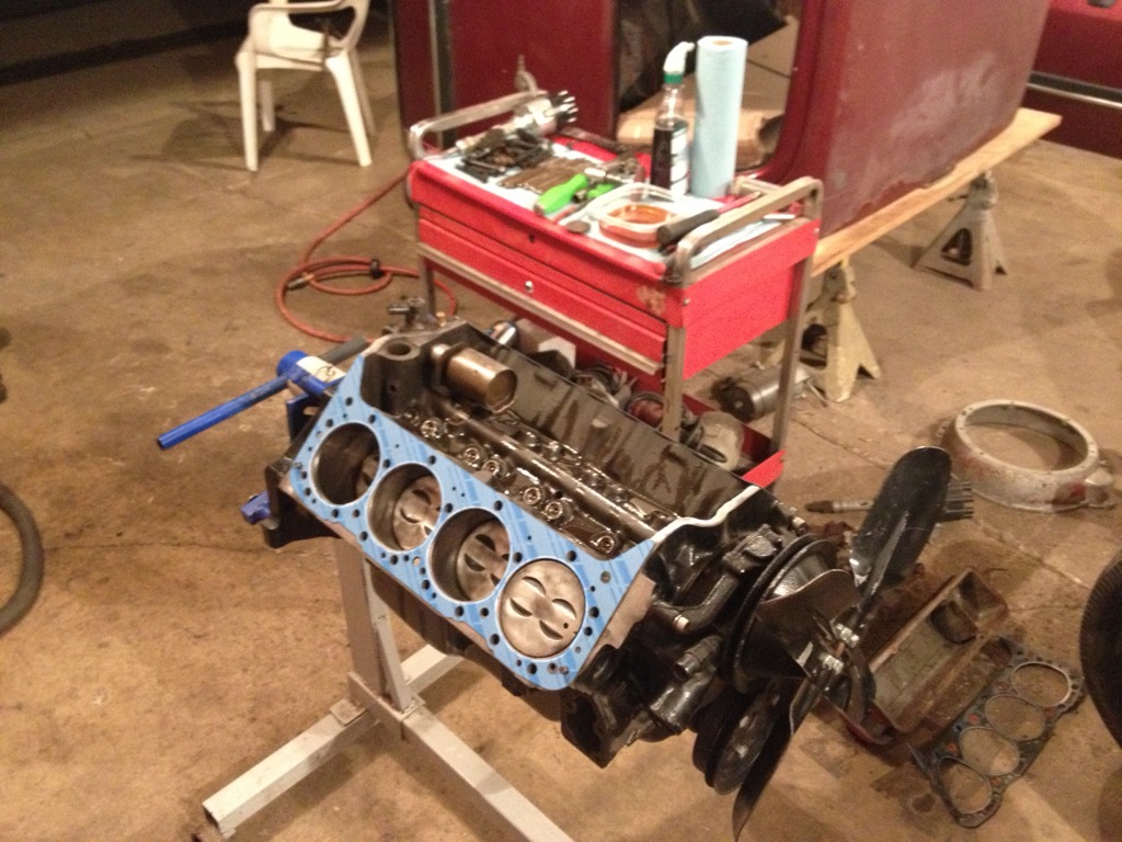

    Correcto... Flathead guys, chill. It's not permanent . I was looking at my budget till speed week of 2015... There isn't a spare 8 grand for what I had planned . Not saying a flatty is expensive or unreliable. The one I am building is expensive as hell! And it will be an animal when it's done . But this little 1966 327 small journal is gonna carry me to Bonneville an back for my first time worry free.. It's been totally rebuilt. I picked it up for next to nothing from a good friend. Brought it home and tore it all down. Went through every inch of it. It's almost a new engine. And for less than a grand, i purchased everything to set it in an go. Ram horn manifolds, tri five 3 bolt starter, old school mallory dual point dizzy, old school 12v generator. Wilcap adapter. Everything!
    This is what started it, my $40 swap meet find :

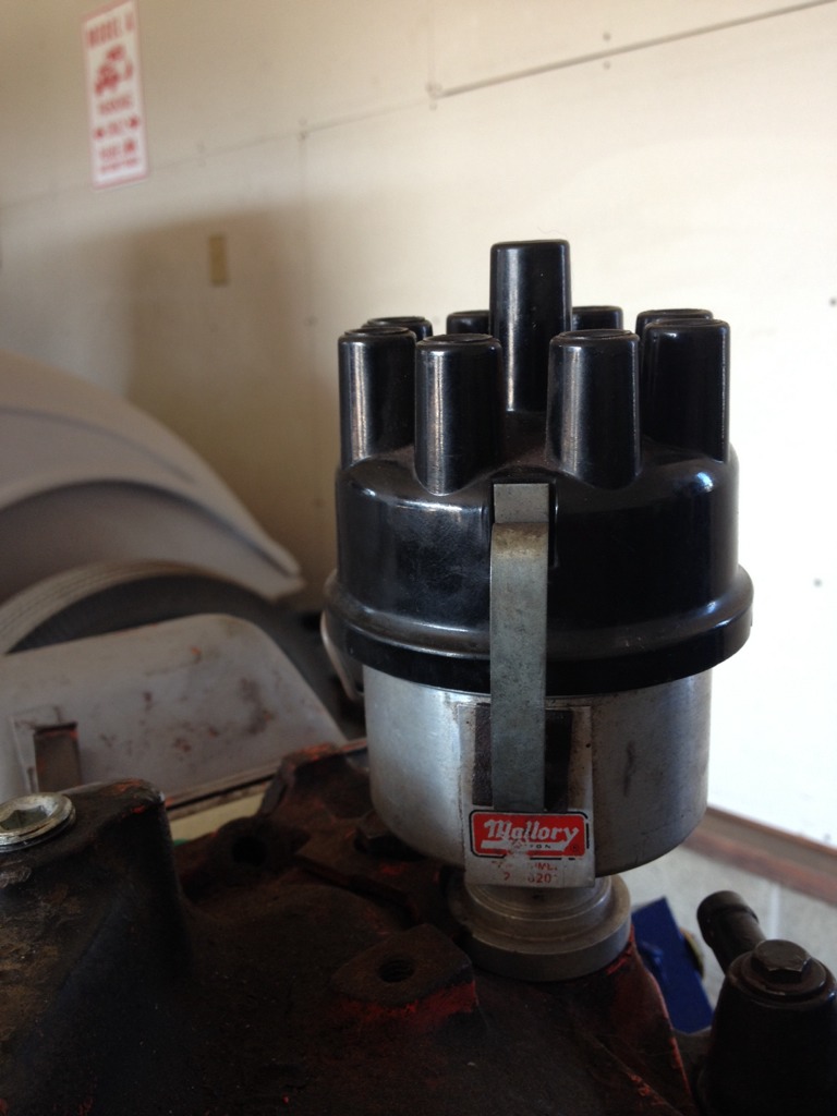

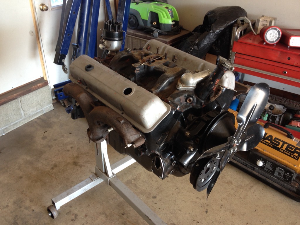

    Then my $450 327 with a new gasket set and a mallory dizzy
    Now. I still need a good Rochester 2 jet 2 barrel with the 3 1/4 bolt spacing cause the one I got is newer and it's 3 3/4 ..
    This engine will be all black. A simple... " leave the hood closed and blow by people" kind of engine. I also picked up a nice older t5 with mechanical speedo. But that's not going in. Not yet anyways. I wanna run the 39 trans and torque tube . So when my flathead is done , it can slide right back down in.
    Chevy guys, I'd prefer a flatty , but you can't beat a sbc if it's correctly done. My 70 something year old buddy Alvin said this , and I quote : " hell when I was a kid, you got picked on for running an old tired flathead, back in fifties and sixties, a small block was the hot rod engine to have! Not some vortec headed junk, we're talking a good old corvette motor or some other hot car motor" " hell we used to drop those flatheads out like ******* on a prom night" Ha!

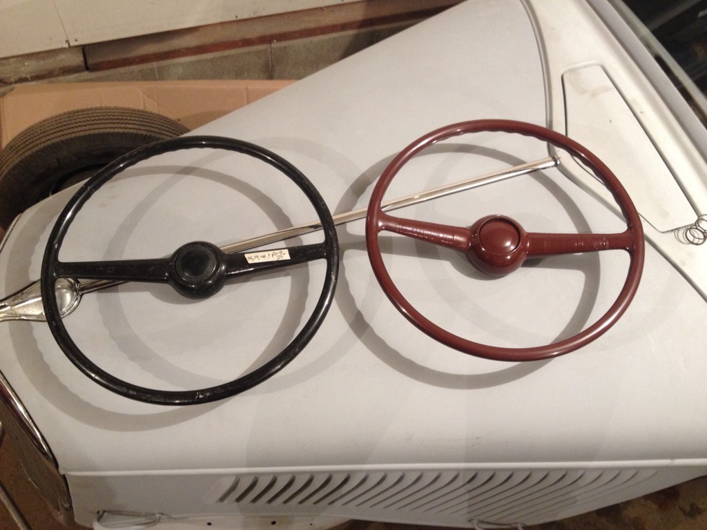

    Here is some parts a good friend if mine decided to give to me....it's the perfect length drop for my channeled car.
    Also this one of a kind guy, restored me the steering wheel I always wanted! 40 ford.. And it's not a cheap o speedway 15" repop. It's the real deal.
    So he restored it and sent it down to me with the column, drop, and the bell.
    I've always wanted a 40 wheel. He did an amazing job. This wheel was close to junk when he started! And at the same swap meet where I got the wilcap adapter, I found a black 40 wheel with center cap for $25!!!
    Here they are
    Gonna be a sweet view

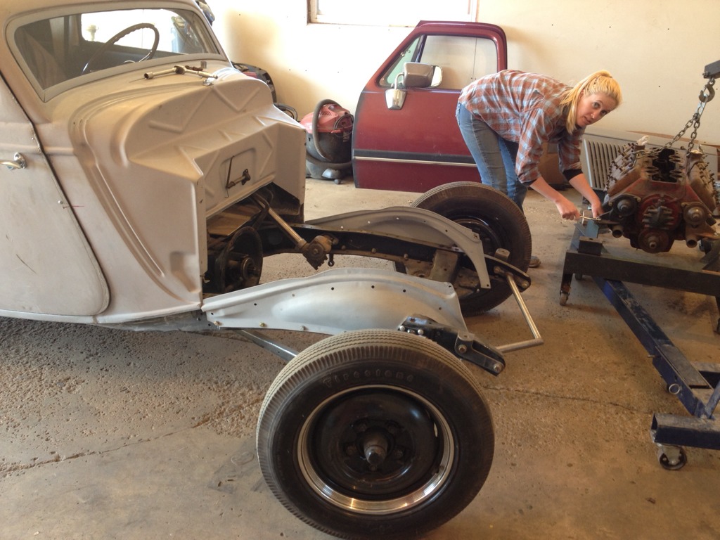

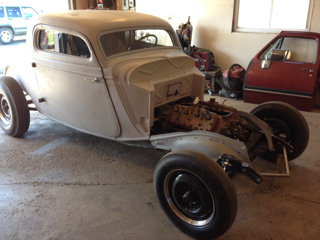

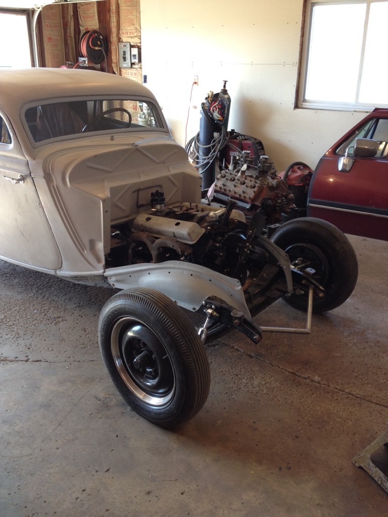

    This morning my out if state friend went and looked at the steel body for me since it was 12 hours from home.. Ouch!! It was junk.. The roof was smashed down in, the doors were bent straight down over an inch, the floors and sub rails were all made from heavy plate steel, and it was all cut out for a heavy channel, then rear of the car was severely mudded up covering lots of rust, the indent for the windshield frame was all rusted out, and someone cut all the inners out of the body. To top that, the chop was 3/4 inch crooked and very poorly done. The shell was paper thin . If this would have been a coupe, I woulda brought it home. But being a sedan, I'm too far into my car for that kind of a project. That thing needed completely redone, it is savable by a guy with the right tooling and skill. But I'm not there yet.
    So I p***ed :/ it wasn't meant to be... So Today I jerked the flatty and installed the new power plant. It fit in great . I still need to fab up the front motor mount plates . But I'm happy with it. Mainly because it's about ready to run and move !
    And my garage help for the day

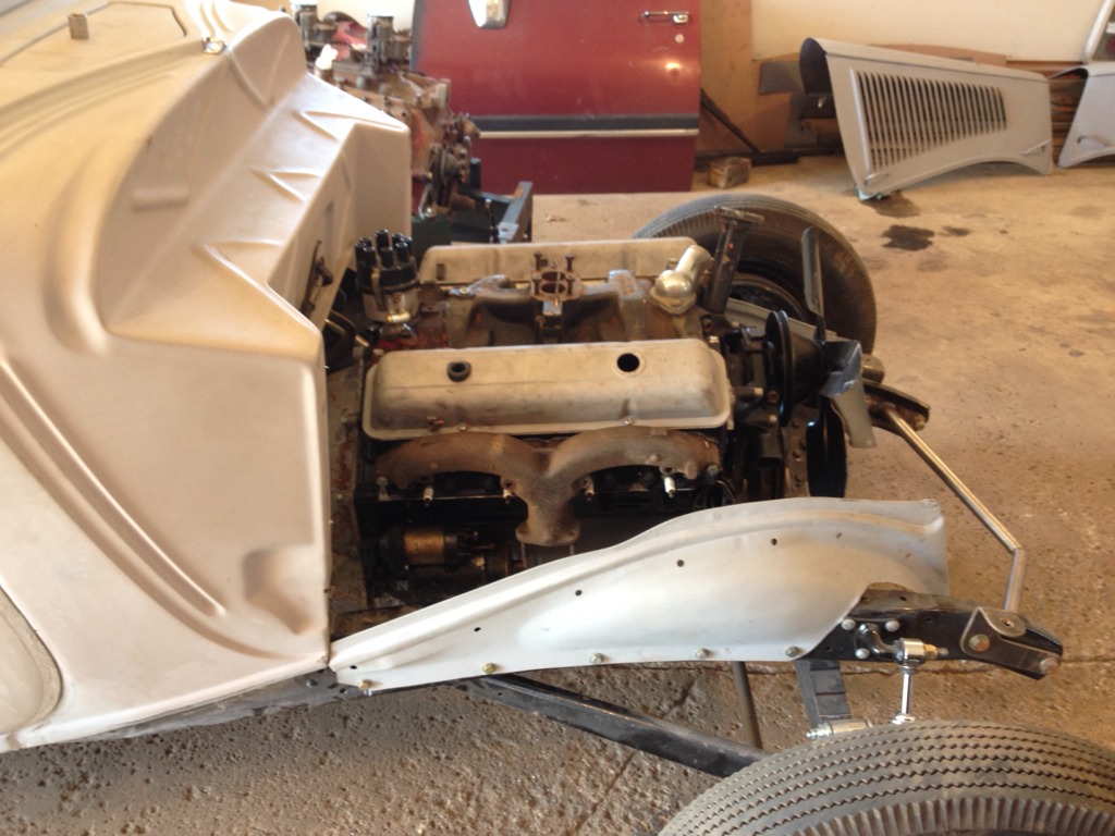

    Today i worked mainly on the steering column and the drop for it. I ended up shortening the column and shaft a little over an inch for some extra room inside the car. Then I pressed the bell onto the end and it was in a great position. I decided I needed 4.5" of drop to make it easy to see out the windshield and be able to get in and out of the car. Luckily my buddy gave me that tube and drop which was perfect. . The tube was rough so I pulled the drop and am going to clamp it on my new tube.
    I also fused a steel bracket to the inside of the firewall. This is the gas pedal bracket and support. Sitting In this car, everything is in a great spot. I'm very happy so far
    I also drew up some front engine brackets which I'll make tomorrow. Looks like it will all work great

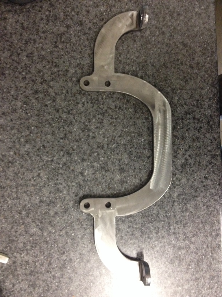

    Front engine mounts

    Good to see ya back into it Ben. Did you consider a solid Hurst style mount. Made similar myself, and was persuaded toward hurst. Hey, I bet hundreds have done the same split mount as yourself. Be interesting to hear.

    I was gonna do a solid mount but I'm setting my engine as low as possible since my car is channeled. The solid hurst mount hits the crossmember . Atleast with the way I want the engine I sit .. I may have to weld a cross tie in afterwards , easier to figure out what I may need

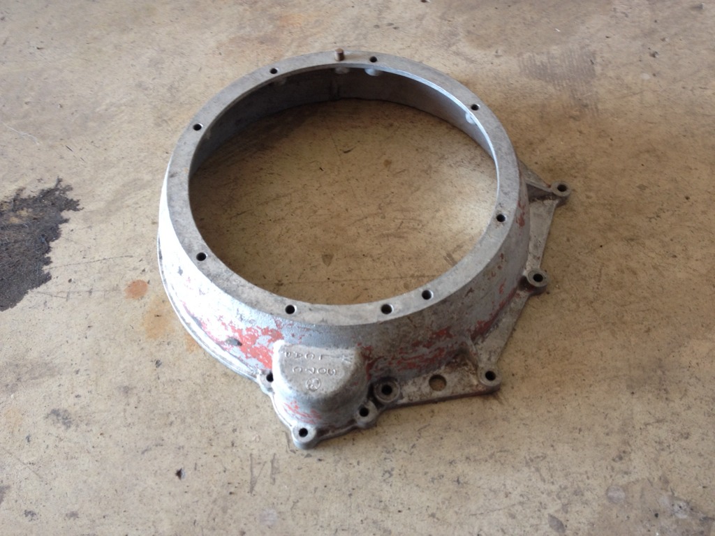

    Beautiful work all around but I have just got to say this....
    The front mounting holes in the block were not located to take engine torque or twisting loads, that was taken by rear mounts at the bell housing back in the day. Those locations are too close together. Usually when using those holes in a hot rod a cross piece is used to tie the two brackets into one sold piece. It helps a lot and many many have been used that way over the years without failure in normal use.
    The other thing is, if you should apply enough torque or shock loads (read aggressive shifting and or clutch use) to twist on those bolts you will need a few spare input shafts and cluster gears for that poor old 3 speed ******.

    This car is a driver.. I'm wanting to cruise my way to bonneville. That's it. It will be driven like my model a. Yes it's a hot rod, but it's not gonna be hammered on. I didn't build it for that. I'm not concerned about the trans. Andy Kohler went to bonneville with a healthy y block in front of a 3 speed and banjo..
    To add to the motor mounts:
    Now that's something to be scared about.. Aluminum. No way! Atleast Mine are heat treated 3/8 plate steel.. I may tie them together once I see what kind of room I have.

    Fair call. You want the flatty to slide back in later without having to alter it's mounting pads. This'll be easy after doing those ****in doors..

    I just had to say something haag, not trying to be banging on you. :) If you drive it sensibly the whole setup will indeed work beautifully. The weak spot is NOT the bolts themselves but the bottom corner of the block breaks off.
    Same thing with the trans, drive it forever no problems until that one time you just gotta grab 2nd gear, or leave aggressively in a bit of gravel and then catch on to some good pavement.

    If low in the car is the goal then I'm guessing you picture shows the mounts upside down???

    all in good fun :) MY car is low. the engine mounts are correct in the pic.. this is keeping the single crank pully 1/2 inches off the crossmember. if you look at the pic if the engine in the car, thats what these mounts are designed off of, that height. ill snap some pics when i get home.
    and trust me... i know all about the grabbing second gear, even my blown model a has left a few black marks.. but i have put a lot of time and thought into making this 34 what it is. and after it makes it to bonneville and back, i may throw my T5 in it. who knows.... but my mind is still saying as traditinal as possible, ( returning a flathead in it ) then the other half of me says ROLLING BONES style, y block or built to hell flatty, t5, QC rear, excelsior tires, and drive it cross country all the time.
    we will see what direction the wind blows, that i will determin what ill do in the end.

    An observation -- you may experience some fore/aft flex in your front motor mount. I have the same motor/trans as you and I originally was running a Speedway front mount which had considerable flex. I had my motor out over the winter and changed the front mount out to an old Hurst mount which is very stout. The movement I saw was when the clutch was disengaged the motor/trans ***embly would move forward and then back on release.

    I made my front out of 3/8 heat treated steel. It's over kill as it is. We had to bend it in a 250 ton hydraulic press. If it flexes, I quit! :)
