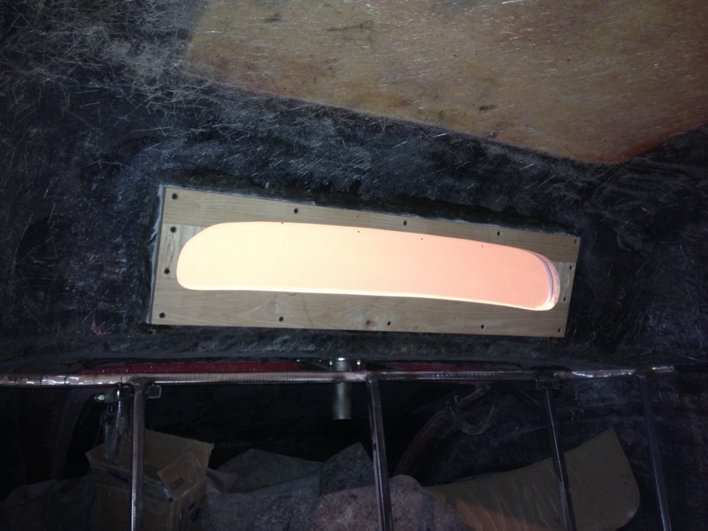

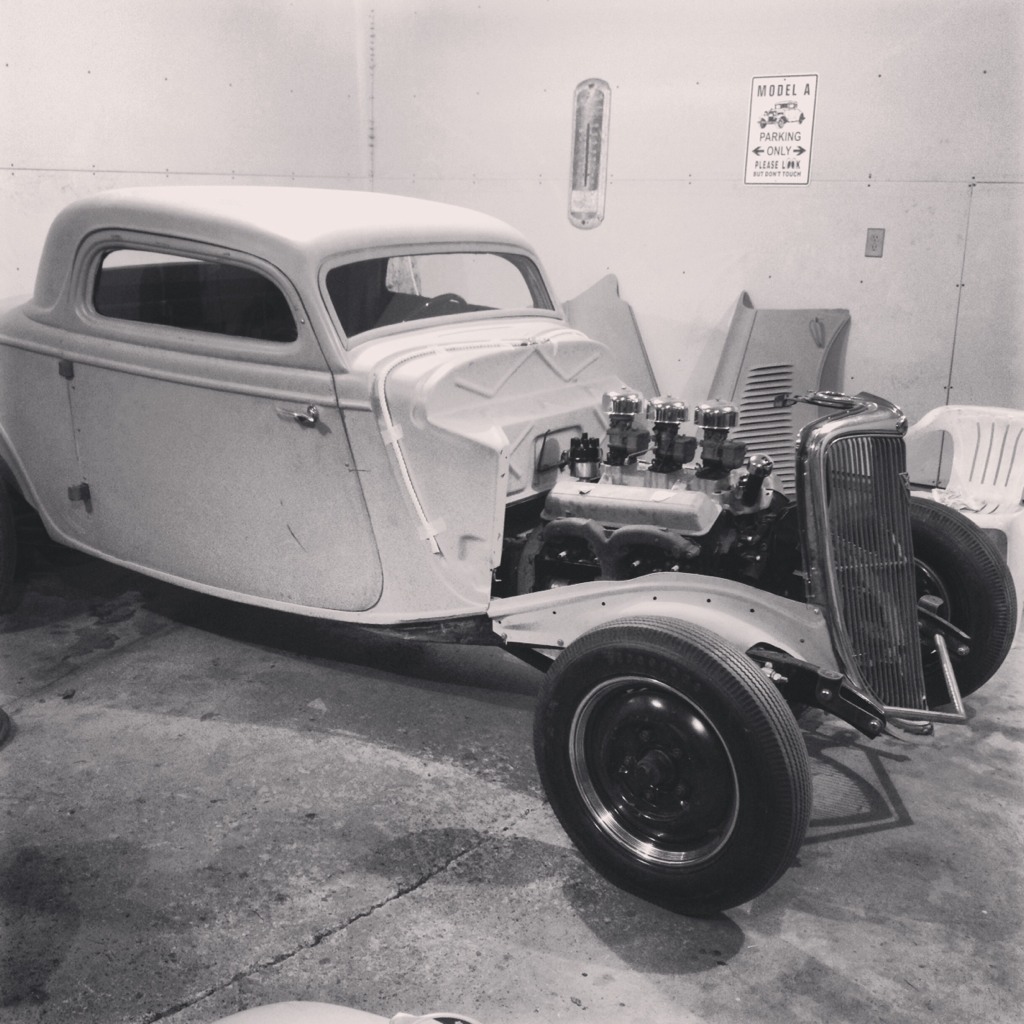

    I've been brain storming how to make a Column drop shim that fits compound curve of the dash and the column drop from the cab over truck . So were gonna give this a try! I made a mold.
  2. hotrodderhaag
    Joined: Jan 22, 2007
    Posts: 2,143
    hotrodderhaag

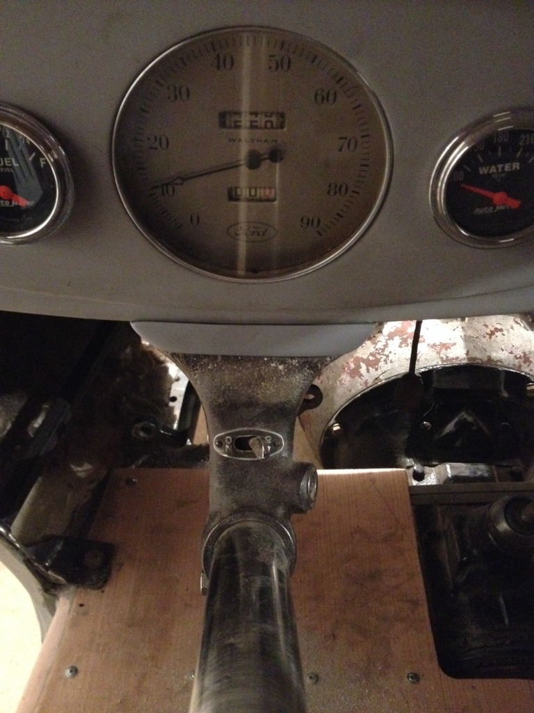

    And the finished product. After I peeled it all apart and did some shaping and some glazing, it actually has a piece if ash inside .. So it's strong as hell..
    A barley noticeable shim that looks almost factory

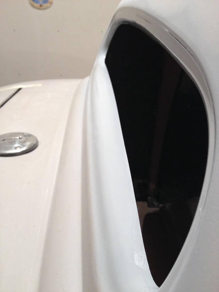

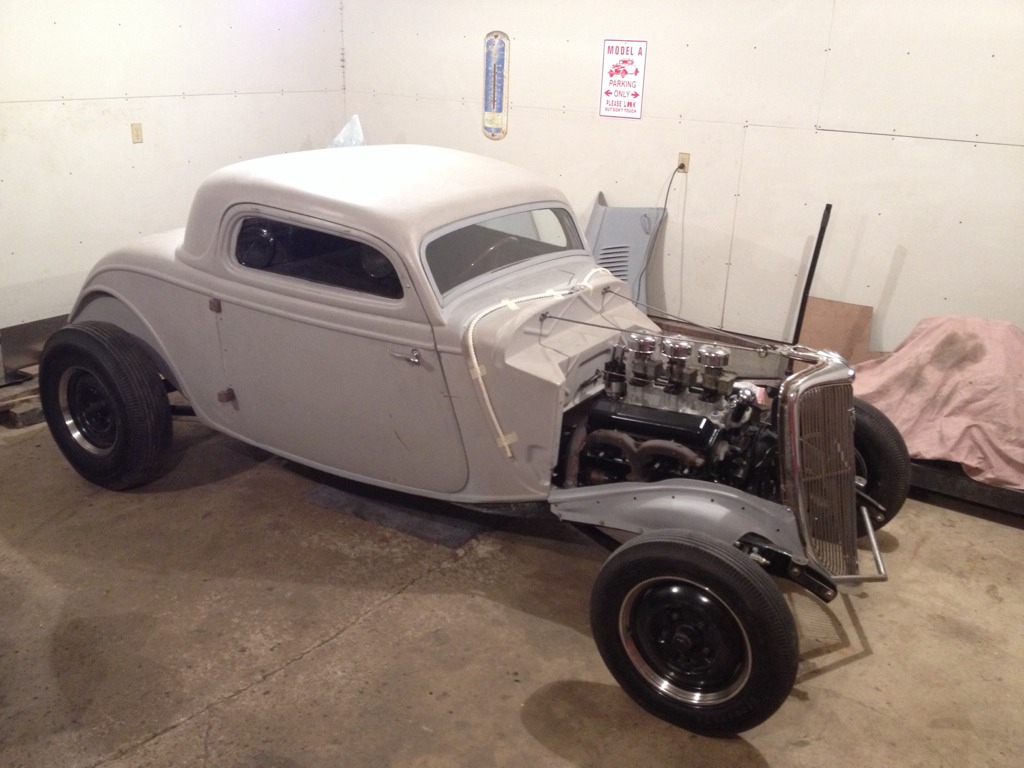

    I spent about 4 hours on the back window today . It's all trimmed in and smoothed out. It looks so damn good . Much better than I expected . Time to install the gl*** tomorrow !

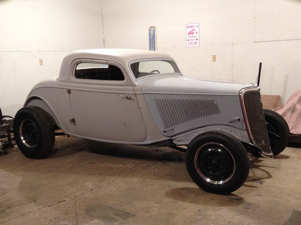

    the hardest part i am running into, is getting the body lined up with the hood, sidepanels, and grill.. my body doesnt seem to be sitting on the frame properly. which i can just make some different blocks.

    Hood looks fairly close judging by some of your earlier pics. Lay a couple of strips of 1/2" rope on ya cowl. That'll get hood up high enough. The grille is dropped same as channel I presume. Can you snap a pic to show exactly whats misaligned.

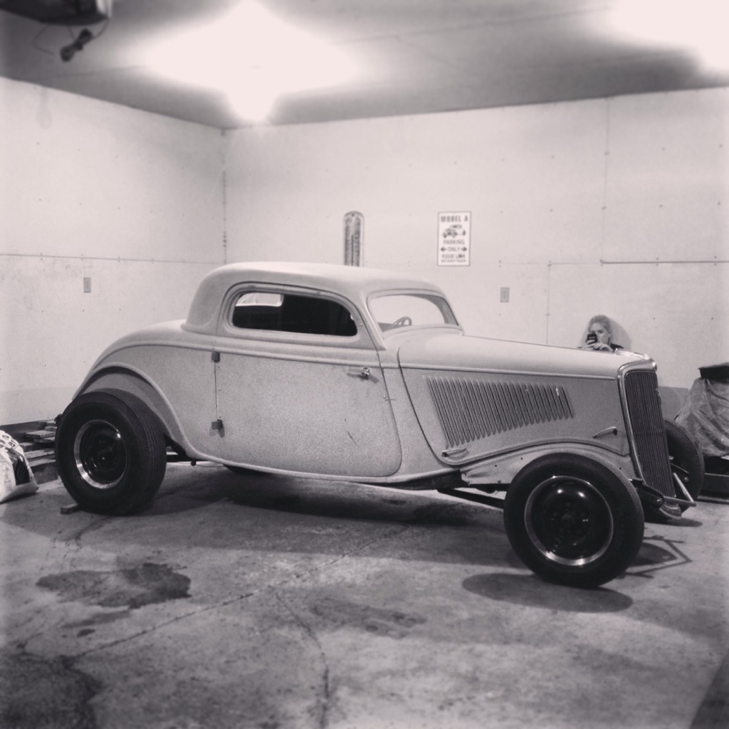

    Rear window is in!

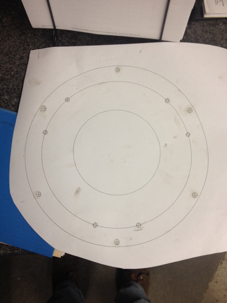

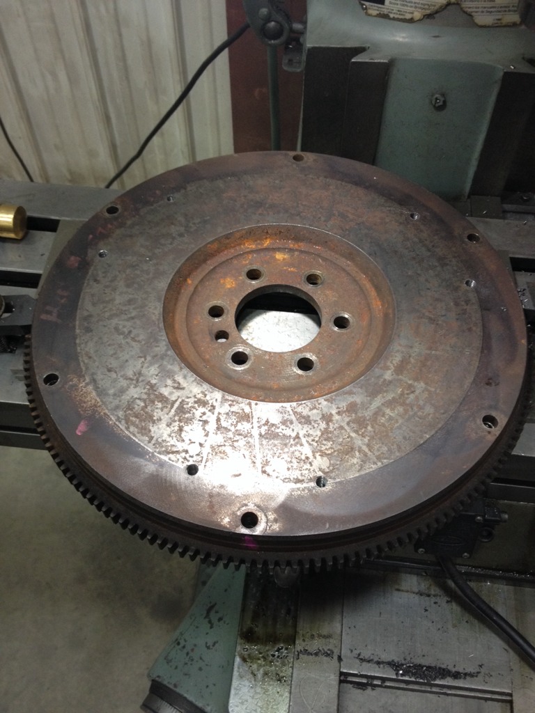

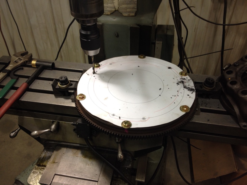

    I managed to Atleast get my flywheel drilled. The motor was just test fit in the car..
    So I broke out the scribe and some measuring devices. First, after a lot of measuring ,I laid it out on the flywheel . Then I drew the flywheel in auto cad with the ford pressure plate pattern. Then I plotted a template. I overlapped the two to verify my math was correct. Next it was off to the Bridgeport to drill and tap some 5/16-18 holes. I got them all done and bolted the pressure plate on. I herd from an older fella to stick it on an old bubble tire balancer to check it... So I stopped at a friends house and did just that.. It was perfect! So we should be good. Tomorrow I will be milling out my new pilot bushing and surface grinding the flywheel

  14. mad mechanic
    Joined: Apr 8, 2009
    Posts: 138
    mad mechanic
    Very clever mate! well thought out, thanks for showing how you done it....it helps those of us that aren't from engineering backgrounds.

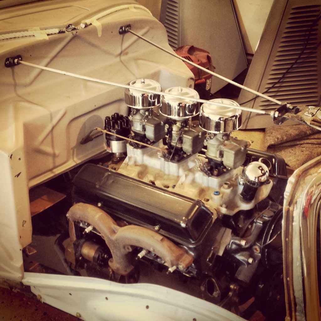

    hotrodderhaag
    Hoping to fire next week! Especially with this baby!!
    Almost a shame to cover it up with a hood and side panels

    hotrodderhaag
    No finned stuff. All steel parts that are plain jane... And it's gonna get hood and side panels . They just look way to damn good on there
    I filled all the valve cover holes since I'm running the factory lifter valley canister breather and I painted them up. Installed the hood rods and brackets for those. I'm going to put new studs in the exhaust manifolds tomorrow and get them bolted on all the way. Still looking at new progressive linkage kits. This setup had 2 carbs blocked off and the fuel fittings were soldered shut. So I changed all that so all 3 will run. What's the point of a tri power if they don't all work!
