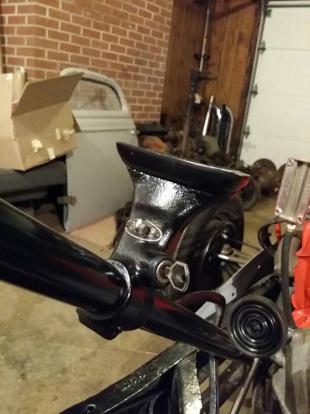

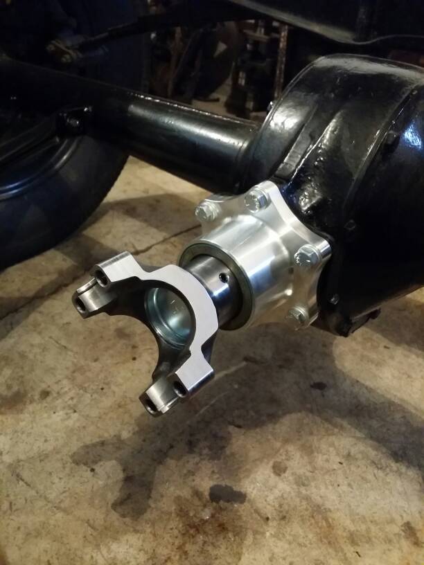

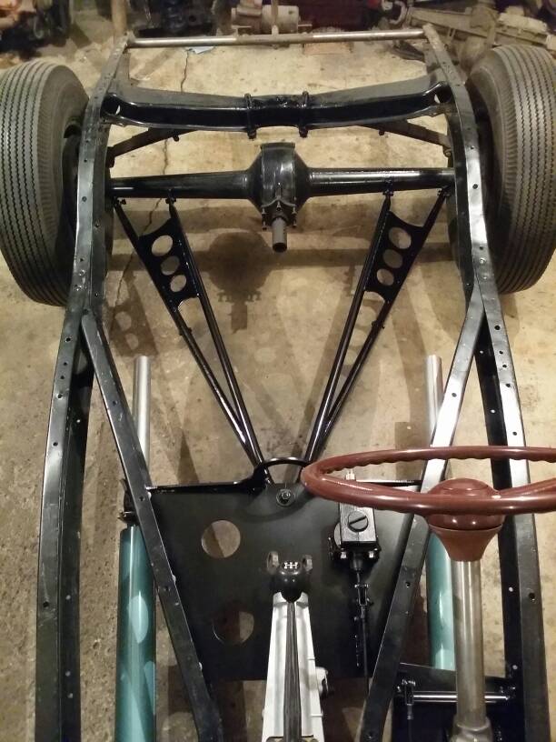

    a small update.
    i built the open drive ladder bars how the rolling bones built theirs.... used some schedule 40 pipe and flattened it in the press, welded them to the existing 34 bones and added some nice gussets...
    I received my open drive kit from hot rod works.. what an amazing quality product. loved it! bolted right on and looks great.
    also i yanked the engine and did some detailing! installed a new 1 wire GM alternator. All new brake system had been installed, wheel bearings and wheel seals.. The driveshaft is at the shop getting built. Time to do the rear shocks tonight and bleed the brakes... This car is going to be a sweet ride across the country! And of course i plan on doing a day by day thread on the 3 trips we are taking! The race of gentlemen, Bonneville, and a trip to NC to see some friends.

  6. K.L
    Joined: Jul 15, 2014
    Posts: 93
    K.L
    It all just looks so clean and well done, great job!

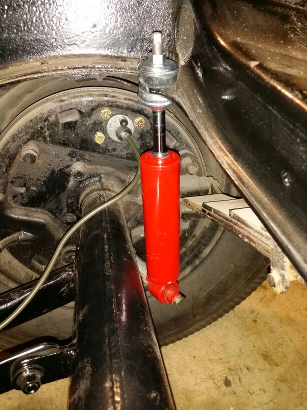

    Ran all the brake lines and installed the rear shocks.. the rear shocks are from a 78 dodge charger . They fit right in the existing holes in the rear crossmeber .. and i used a small spacer to bolt the bottom through the rear wishbone hole..
    Waiting on a new set of brake shoes and the ch***is will be completely done
    Also I managed to extract a key thay was broken off in my column drop. I ordered a blank from early ford store and my brother hand filed it to fit.. it works like a charm

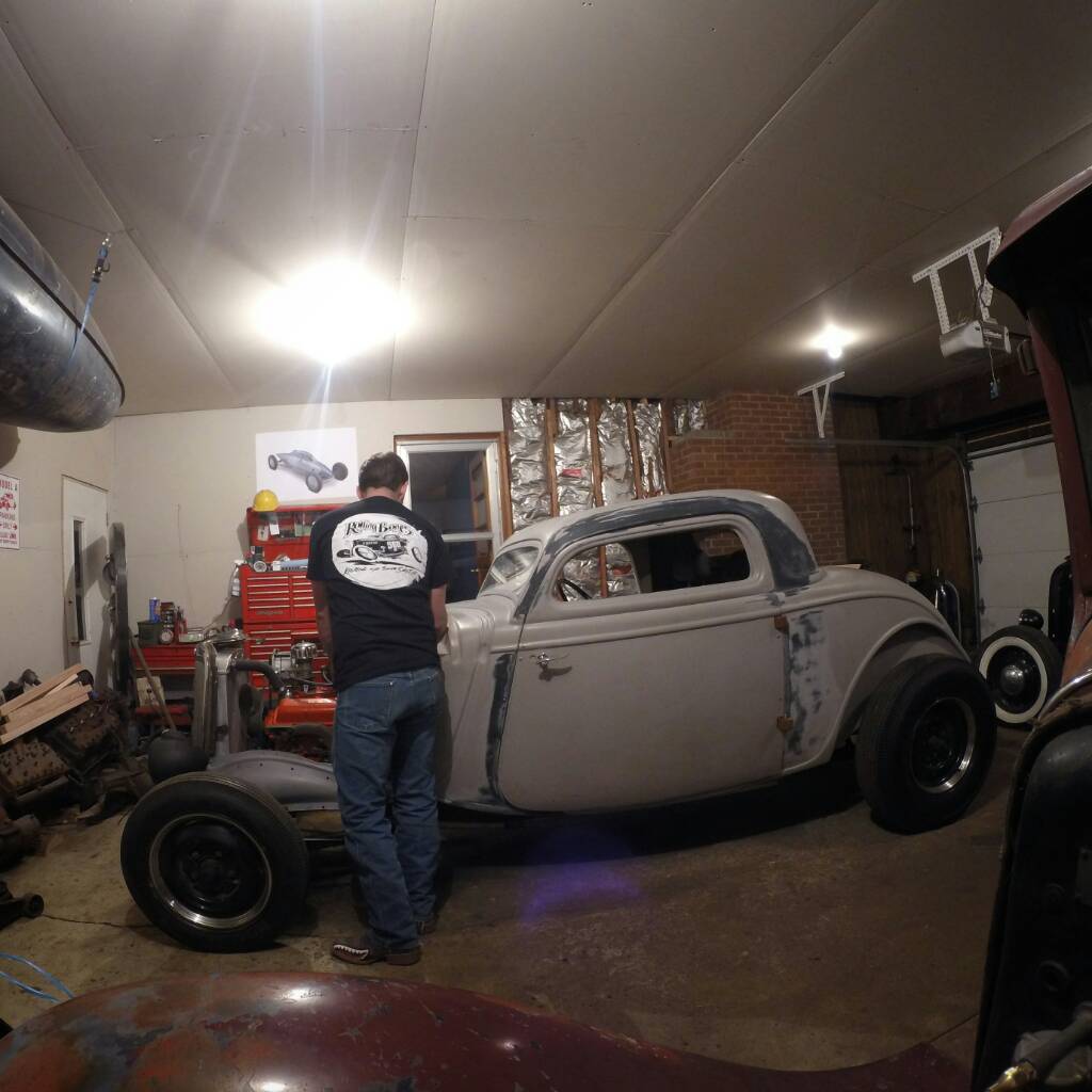

  10. hotrodderhaag
    Joined: Jan 22, 2007
    Posts: 2,145
    hotrodderhaag
    The body has been reinstalled and ready to finish ***embling the car. Once it's a fit back up I'll adhere the outter door skins on and start straightening out this wavy fibergl***
