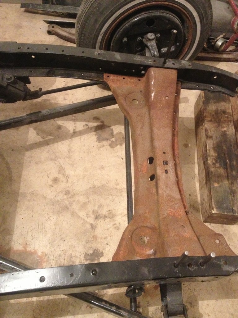

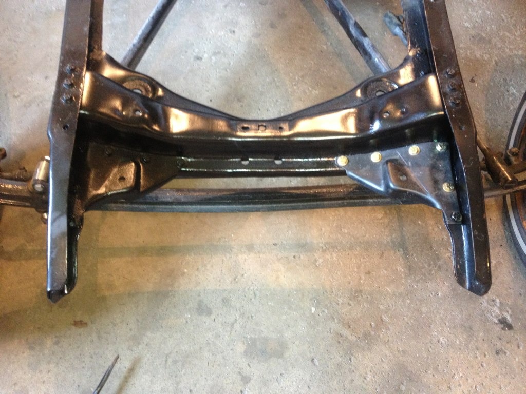

    I got my front cross member from Chris today. Very happy with it. I'm missing the drivers side radiator support gusset... So if anyone has a spare laying around.... Decided I didn't like the grill at all, so it's leaving . Ill find an original.

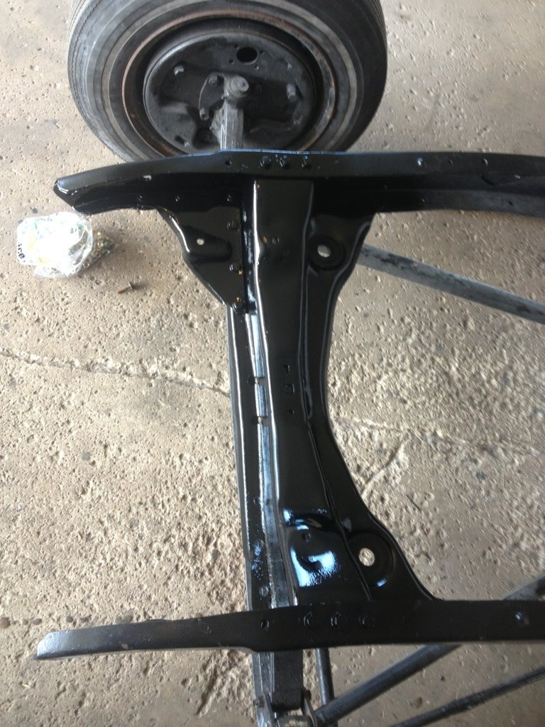

    Installed .

    Good call on the grille - find a real one - even if a little beat up they can be fixed - and it will give the car a LOT more authenticity....

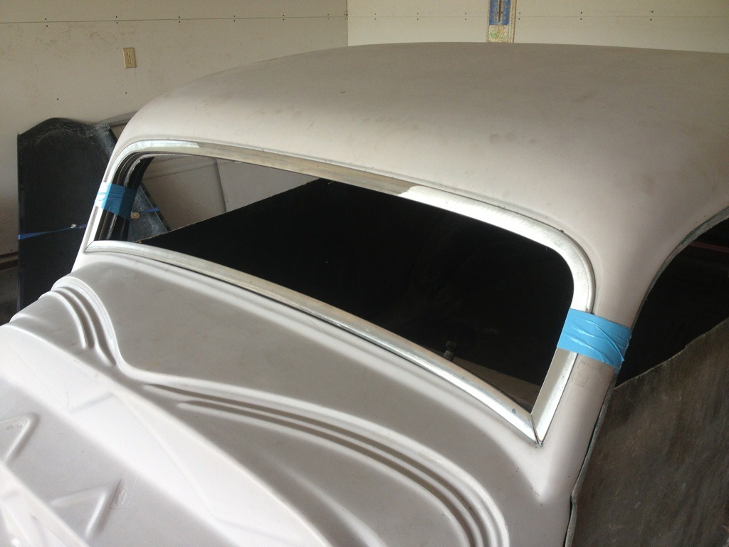

    I chopped my windshield frame down and got it fit... ImageUploadedByH.A.M.B.1376852796.426389.jpg

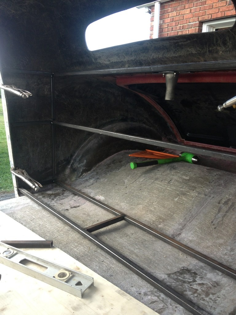

    I started building the inner structure for the seat and dash area.. Some helpful photos from other guys builds have really come into play. I will get most of t welded up tomorrow and see how it looks and functions .

    Some of the inside structure got fabbed today. I have all the bars to line the truck and attach to frame. I woulda had it mostly done but it seems I keep forgetting that welding gas doesn't last forever! Damnit. So tomorrow is anther day. I should have it all fit and finish welded . Then I can get the dash board bolted in and trimmed down. The. It's on to the dreaded doors

    I wanted to build the inner frame of the car so the doors had support to bolt to.... I temporarily bolted them to a plate I made inside the door jam .. But please , any opinions are greatly appreciated ... This is my first time with anything of this nature...

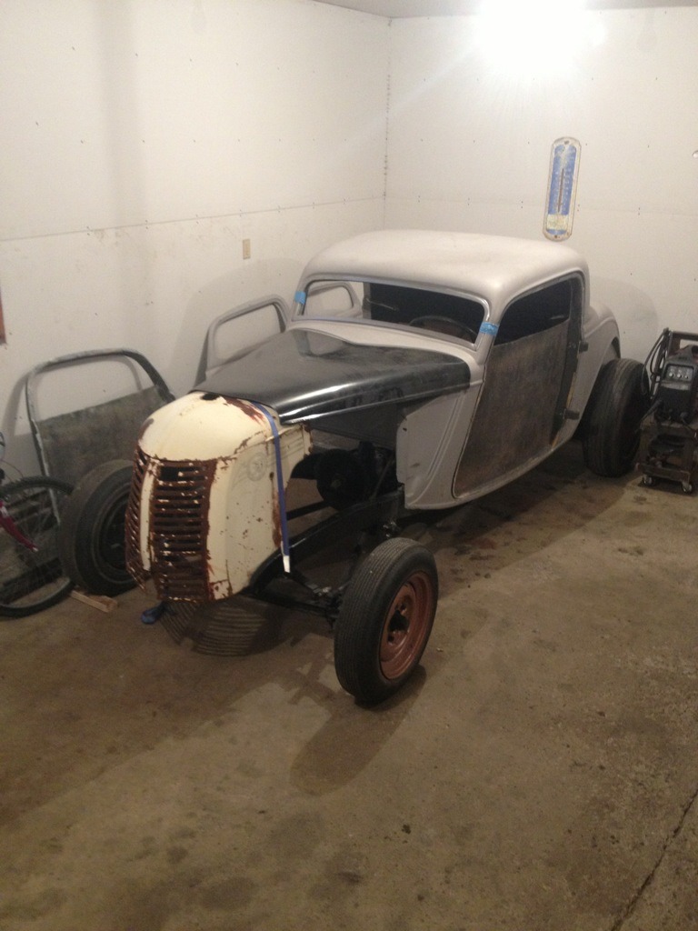

    Ok we'll the news is I am cheating this project a little bit.. A local veteran hot rod builder is going to do my doors for me.. He is really confident with fibergl*** and fabrication. He says no problem at all. He will make em close and sound like steel. Or close to it . I picked up my new grill today also. I'm cheating on that too... I'm using a ****shutt tractor front end just like te rolling bones did. I fell in love with that car and with my background of tractors, it makes the car a little bit more meaningful from my past even. I will be working on the drivetrain while they have the shell of the car getting everything fixed for doors . This will be the time to really get the suspension set right and the brakes all rebuilt with the motor in place .. I'm stoked .. It's a relief having the help with the doors.
