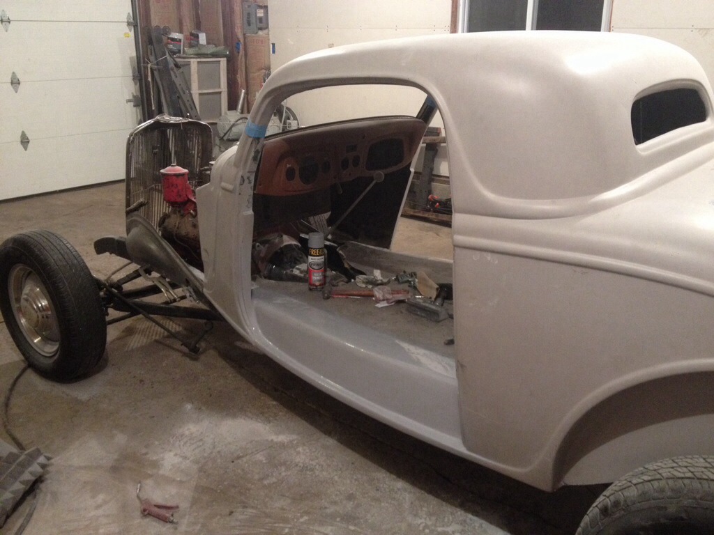

    Today's progress:

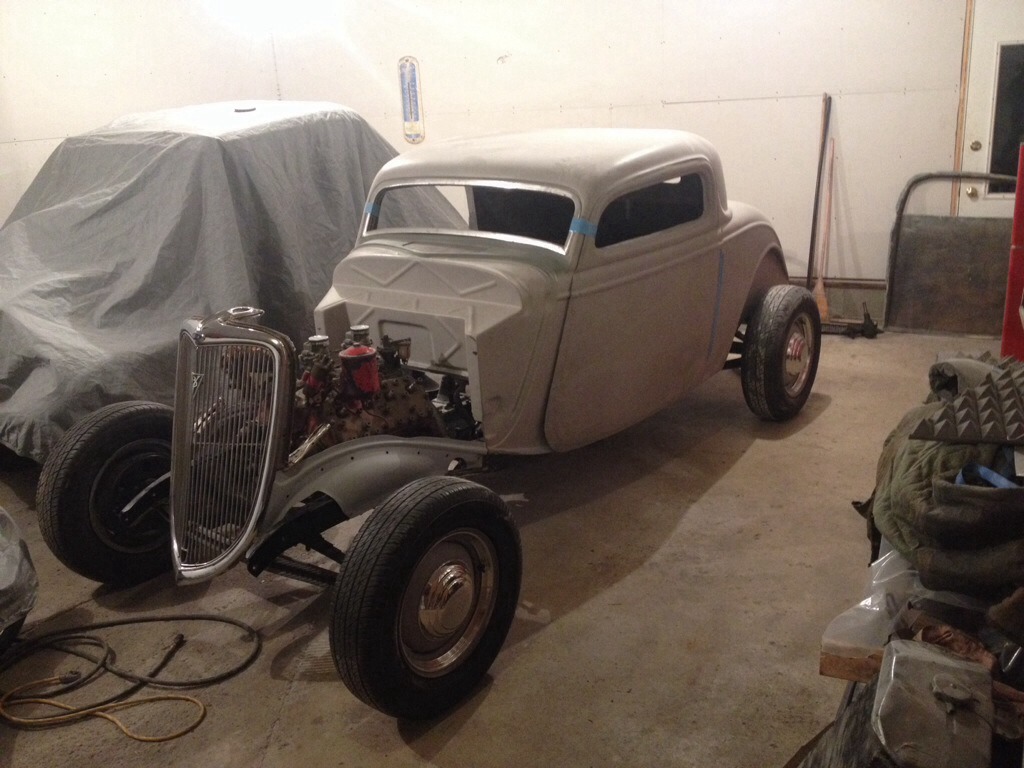

    I realized when I bolted the fender aprons on that my body was 1 inch to far forward..-! And what ****s is that the floor is molded to the frame imams is glued to the body now.. . So I cut some oak 1 inch spacers for the body to sit on. They run the entire length of the frame and cross members. They give a lot of support. It was perfect because with an inch of height, the Body could tightly slide back an inch. This left me with a 3 inch channel instead of a 4... I want to run a stock hood and side panels now thar I have my fancy *** grill. So I lowered the fender aprons down 3 inches on the frame . I trimmed them out to fit around the frame . I will wait to drill the new holes, I want to have the real hood sitting here and on to make sure it all gaps nicely. So I clamped the back on and used some copper round stock to check the hood line from the cowl to the grill. Perfect! So far ....
    I also installed the gen bracket and generator to see if it will fit in the side panels... I may have to lower the offset bracket some but it should be fine ..
    Waiting on the custom radiator to come in! Had one hand made to account for the channel.. Very excited to get it and see how it fits. Very reputable guy is making it!
    Here's a few pics:

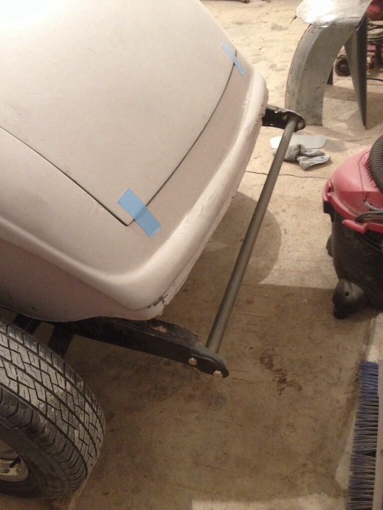

    I finished the rockers today. They turned out well In my opinion. Now Ill move to the doors since I'm sure they will close all the way now.
    I also fabbed up the rear spreader bar. Which later on down the road it will get the salt flat push bar and bonneville license plate topper .
    Its turning more and more into the car I have always wanted... I've also ditched the hood and side panel idea...
    I attached a few pics below. The last one is the best looking 33-34 I've ever seen.. Seen it a lot and it just dawned on me that that's the look... The perfect look

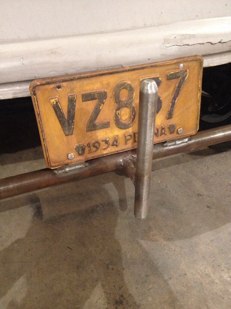

    I built the salt flat push bar this evening and mounted the license plate. The cops sure will love the plate being blocked! I'm getting ready to install the f1 box. It was my spare I have had laying around, it's in rough shape but two new bearings and a shim kit and it will be good as new

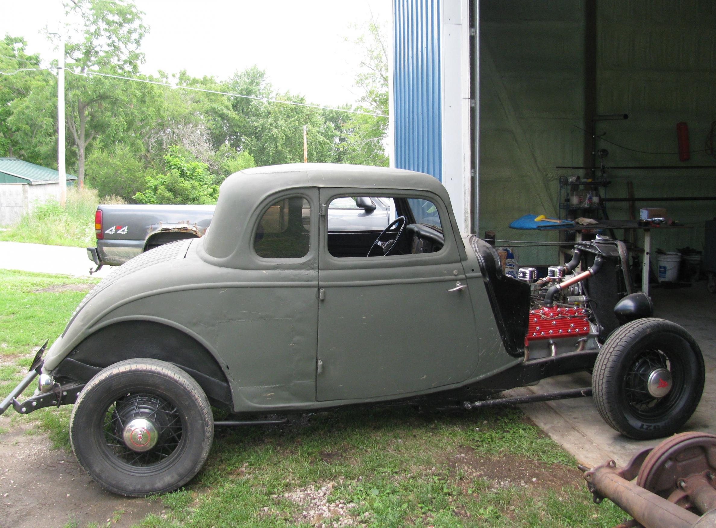

    I'll try n load a pic of one of my 34's , flathead , 30 over , kogel heads , isky cam , fenton intake , 39 ****** , open shaft , 47 rearend , original dash , , not finished tho , I do drive it. Making a new roof for it now , and deck lid .

    very cool car ....i have the same, bad talkers of the gl*** just dont know.. i love driving my car, and always get complements xlnt job on yours

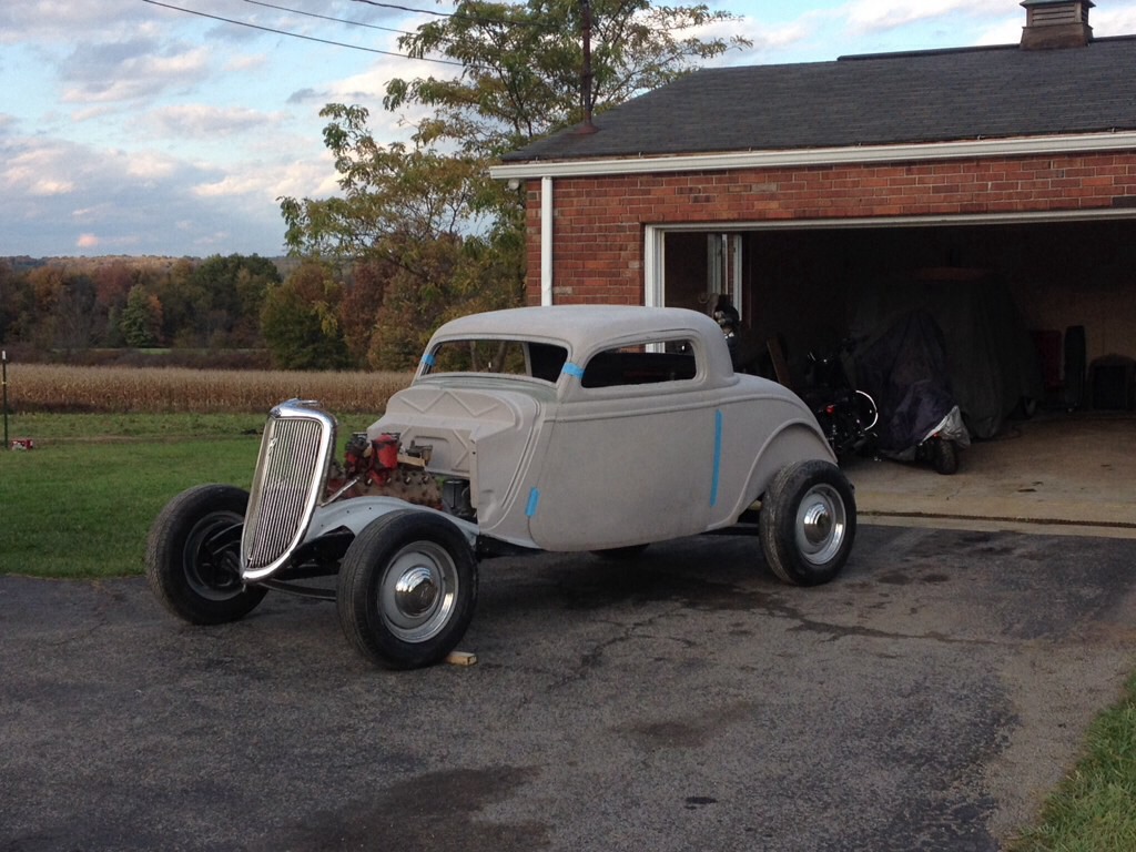

    Ok guys, for my new wheels.... Sold the brand new Coker wheels I had and got these wheels, tires and center caps. I love the look!!! I also fabbed up a front grill guard today. I like it. It's simple but effective. I seen another one like This so I stole the idea . Also I asked the guys on another thread to throw some color to my car ... This is they general type of blue that I may go with.. I love the back ground! Hope it will see the salt by 2015
