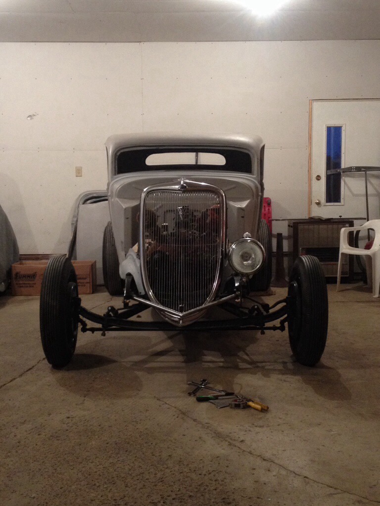

  1. Great work on the shock mount!!
    As for the headlight position, just my opinion, I think the lights need to be lower and tucked closer to the grille.

    I'm feeling the same way.. Vern hammonds car has the high and far apart ... I'm not sure if I like that.. I love his ca and they look absolutely perfect on his car. However Mine isn't pulling that look of worth a damn.. So .. I may be hacking the brackets all back apart and leaving them just shock mounts . My problem is the car is channeled, which lowers the grill , so a nice aluminum mount like Vern's, which is 8 inches puts them way to high on my car ... Decisions decisions

    Regular headlight units instead of those halogens would improve the look a bunch.

    That was my first thought as well: It looks like they need to be tucked in a little closer to the grill. I don't have an issue with the height, though.

    More along the lines of this:

    thats f-ing perfect! thats what i will be doiong when i get home. gonna drop them down an inch also

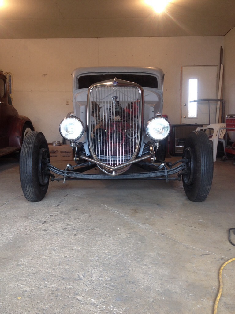

    I came home today and cut off the light brackets... Then I decided I wasn't happy with the location of the shock mounts. It seemed as of my test shocks were in a bind.. So back to the drawing board for those. However I did dream up an easy headlight mount. And it works... ! So I'll take it to work with me and throw it together in autoCAD, and burn it out of stainless, throw a bend in the top and it's done. And the lights are in a good spot!
    ImageUploadedByH.A.M.B.1383692223.269390.jpg ImageUploadedByH.A.M.B.1383692240.751215.jpg

    That looks better!

    Much improved! Personally I prefer them lower still, even if it's not traditional. I like the top of the bucket even/level with the top of the tire, but admittedly that doesn't look best on every car.

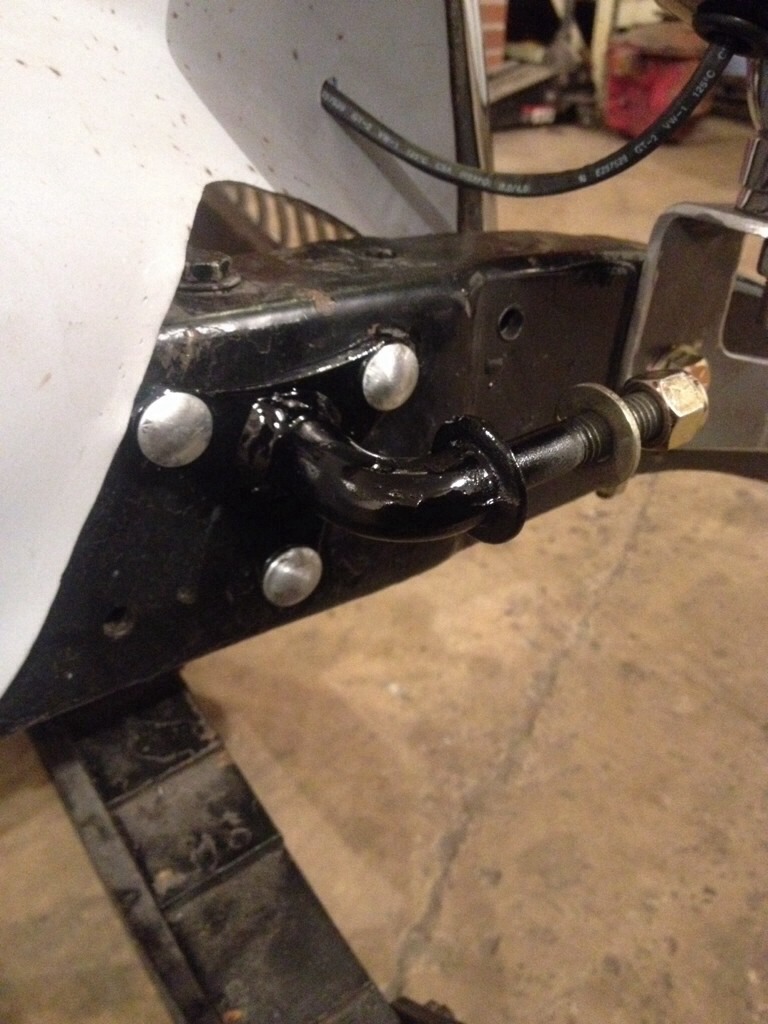

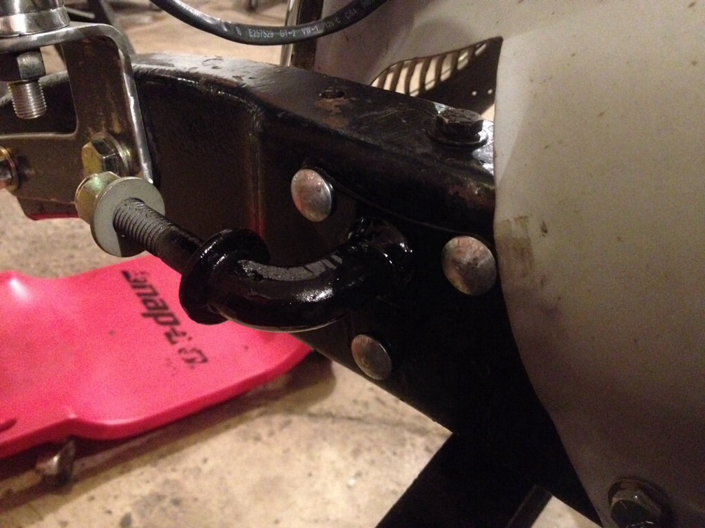

    Mounts are done.. I said the heck with the stainless. It was too flashy.
    ImageUploadedByH.A.M.B.1383769778.255520.jpg ImageUploadedByH.A.M.B.1383769790.080072.jpg

    I got the shock mounts finished. I used carriage bolts that I buffed the heads smooth to hold everything together.. Looks like rivets . So those are on the. I started on doors. Just gathering all my parts to see what I had. I'm still waiting on a few orders to arrive, lower shock mounts, shocks, still haven't found widow channels yet.. Once the car is basicly fit together, I will tear it l down for a nice ch***is paint job and then the body... But here is what I finished up this evening .
