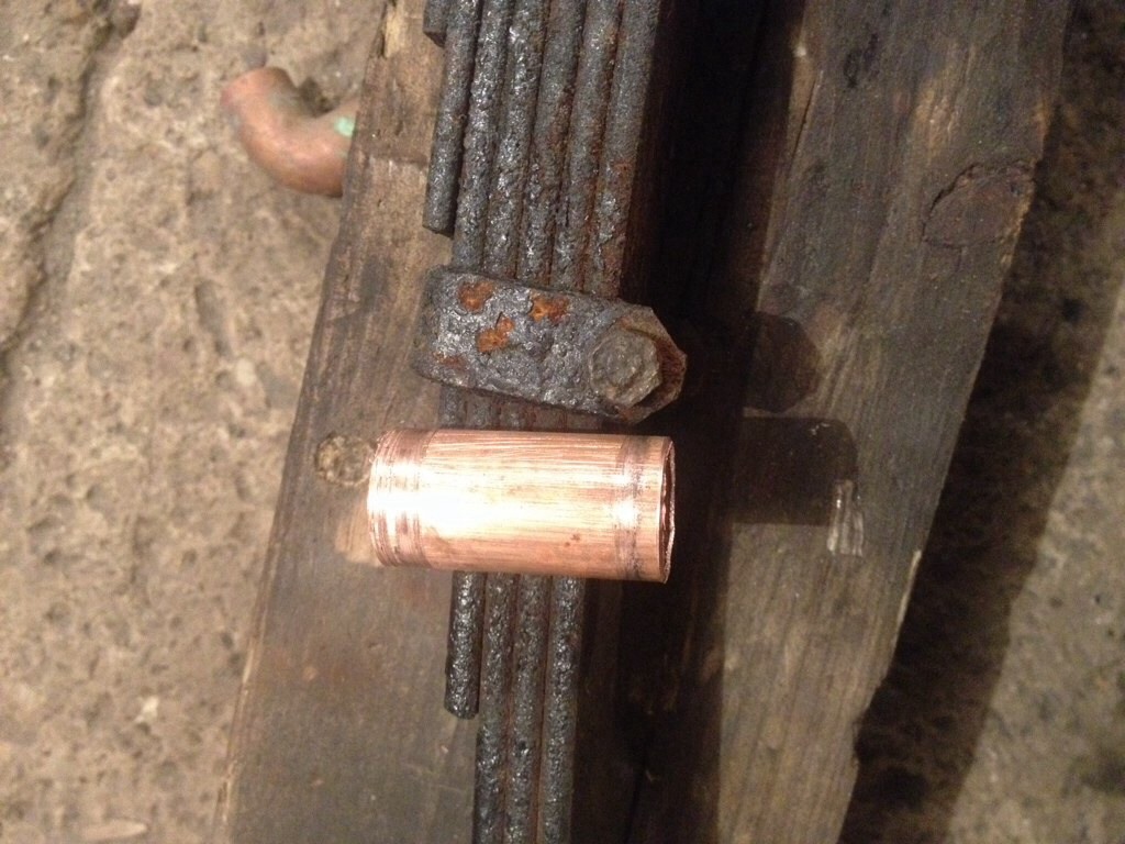

    I was getting the front end ready for my delivery of speedway suspension parts tomorrow, when I ran into a problem .. I was not aware that 34 used 7/8 eyelets on the spring, and 3/4 on the perch bolts .... I had ordered 3/4 stainless shackles with nylon bushings from speedway.... So I was scratching my head. I didn't want to replace the front spring because it is in really nice shape... So I hunted around to see if I had a stock model a spring to steal the main leaf from, no luck.. So I stumbled on a piece of copper pipe in the ba*****t when I was tending to the wood burner... It was 7/8 o.d. And 3/4 I.d. Perfect! So I cut two pieces 1 3/4 long , pressed them into the spring eyes ... Grabbed a bushing and had to press it in the copper pipe. . It's perfect! Now I can run my stock spring with the availability of cheap speedway shackles . And the copper makes a good wear sleeve . I know it may not be the proper thing to do, but it's safe, effective and it's DONE

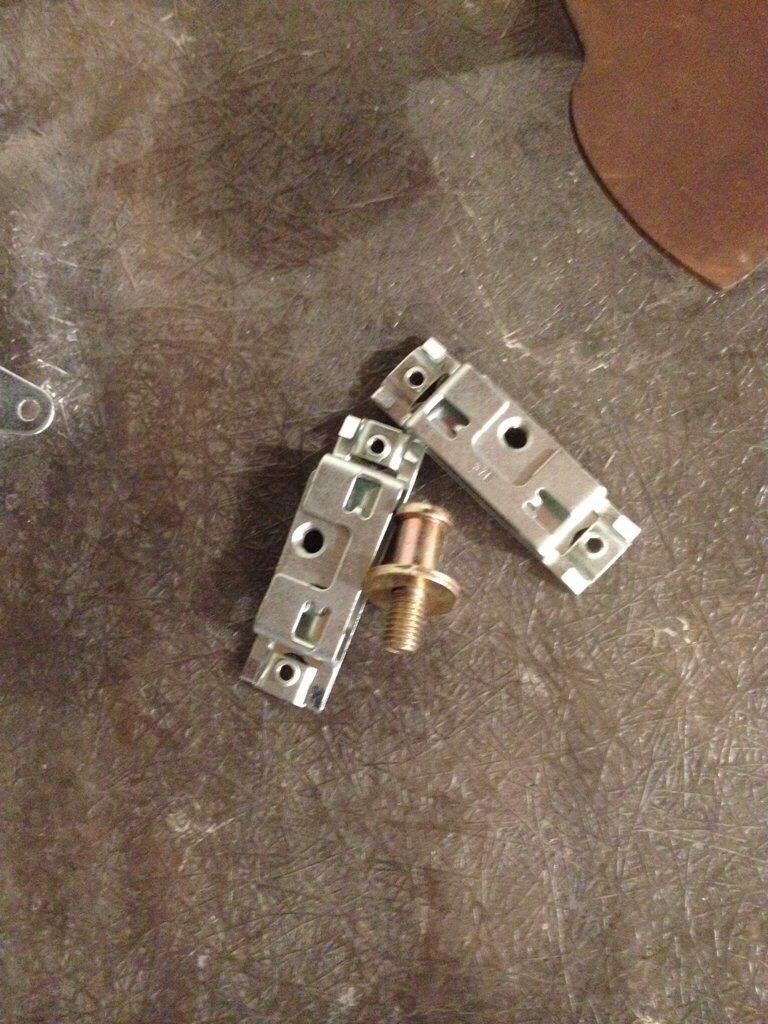

    Sandblasted , epoxy primered, painted, coated all the faces with axle grease and it a ready for installation
  4. Looking good! I like your new headlight mounts, the position is perfect now. Great engineering on the spring too! I had to use a piece of copper as a bushing on the drag link of the truck I'm restoring. works great!

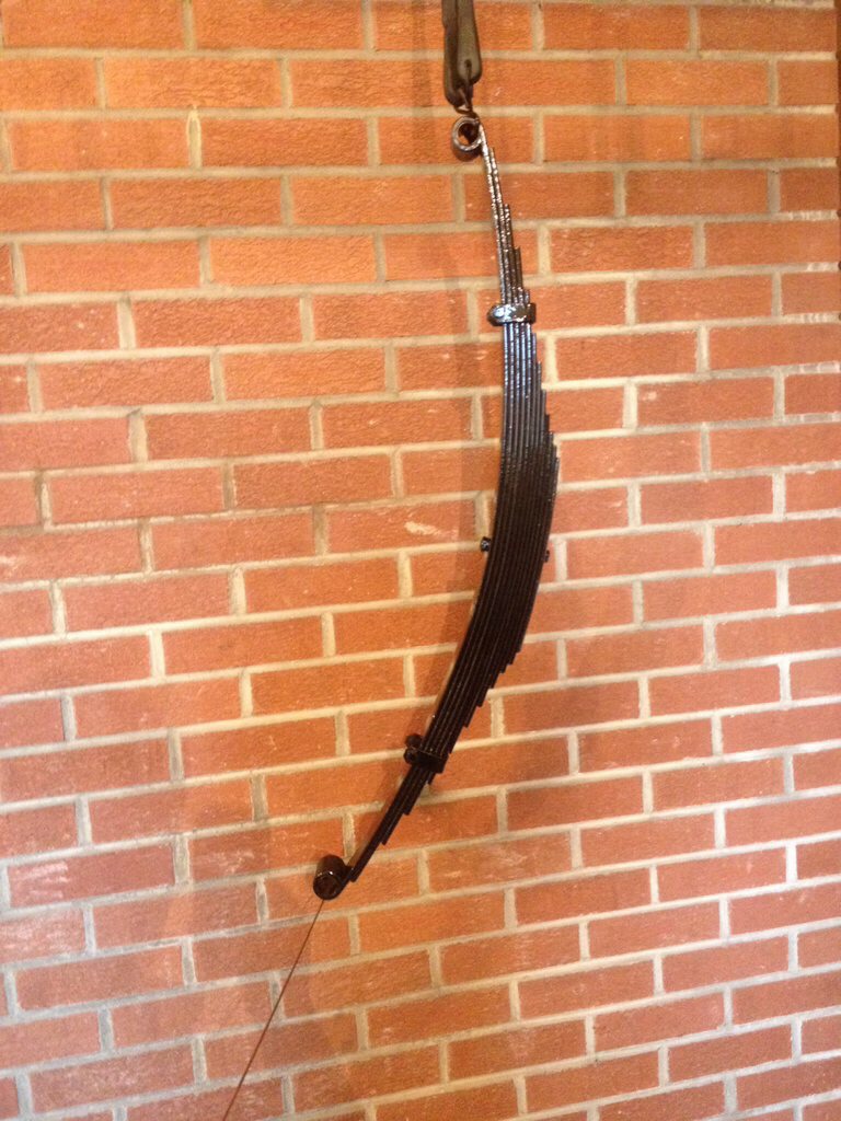

    The rear had home made shackles that were about 2 inches longer than factory to drop the car some.. So those had to go! They were very unstable. The rear had all new bushings installed when they lengthened the shackles ,so all I did was get 4 pieces of flat bar stock and cut them to original length. Drill some small holes in each end, then hand file the holes square to fit the bushings.
    At that time I also removed the top 4 leaves out of the car. This softened it up a bit and helped drop it down. I did the same process on my model a and it rides great.

    I also yanked 3 leaves out of the front , much much better , still a stiff spring but lower and a little smoother now.
    Pics are hard to see the difference

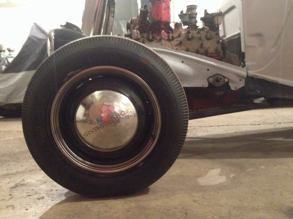

    Rolled it outside today just to see the difference .. It's subtle bit it was needed

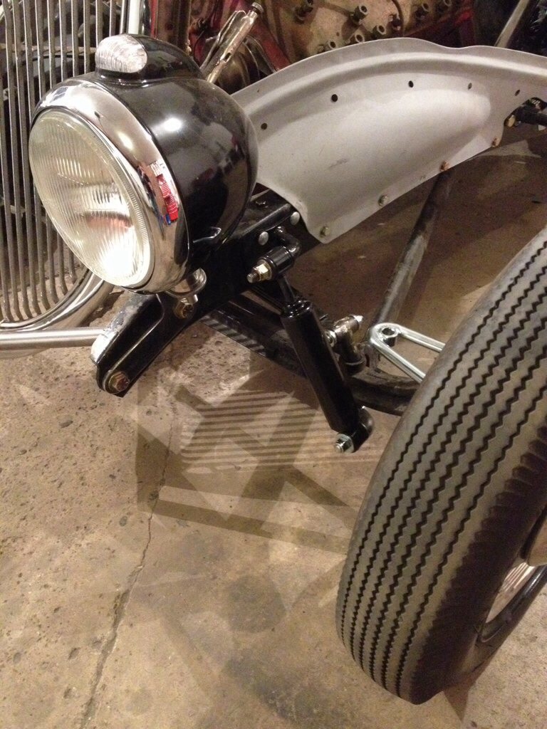

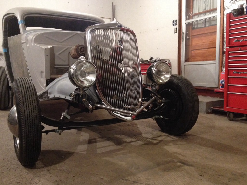

    Just looking at your side pic Ben. The headlights look a bit lost out front there. Would like to see a mock up with them down and back a tad. Make a cheap *** bracket to sit in front of your shocks, slightly offset to the side so no bolt interference. These little mounts work a treat, but I'm sure you can whip something up. Shock mounts are wicked, by the way.

    im glad you mentioned that becuase now i see this and you are 100% correct.. the only problem i am havig is since the body is channeled 3 inches, the grill is further down. id i make them like normal mounts, there way to high. but if i drop them down and back, then they are way to close to the inner fenders and the shck mounts.. its all cluttered. this is something i am going to have to look into. i noticed the picture you attached, do those just slod over the shock mounts or how do they work? where are they from?
    i know mounting headlights should be easy, and it owuld be if it wasnt so far channeled....
    and im way to damn picky! :) i like the look of the rolling bones headlights, but my car isnt that low.. so im not sure where the happy median is.. ill see what i cant think up

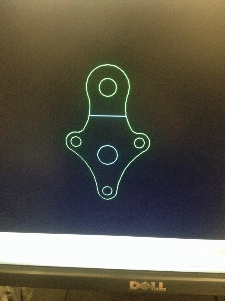

    This is what I am thinking... This plate will bolt behind the shock bracket ( identical shape) and then at the horizontal blue line I will bend it 90 degrees. That will make a good strong , short headlight stand. This will be at the exact same hegira just straight back four inches . Now if it will clear everything. ?...

    Actually, those mounts would require some modification as they don't bolt straight up to F1 stalks.
    Shock holes are too small, and need to be shaved a fair bit to fit over top of shock. And headlight bolt clashes with angled shock. Definitely fab your own.

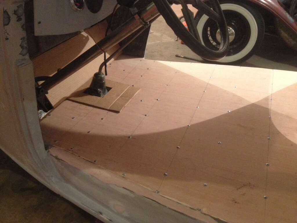

    On a different note I received my window track steel. I have been working on getting it split and been up to fit the contours of the doors. I also use some oak sheeting and laminated the floor of the car with fibergl*** resin . now that the floor of the car is done it is much stronger and ready to be bolted down in place. Still waiting on the wood for my door jams and other parts hopefully the guy gets them done soon because there isn't much I can do without them

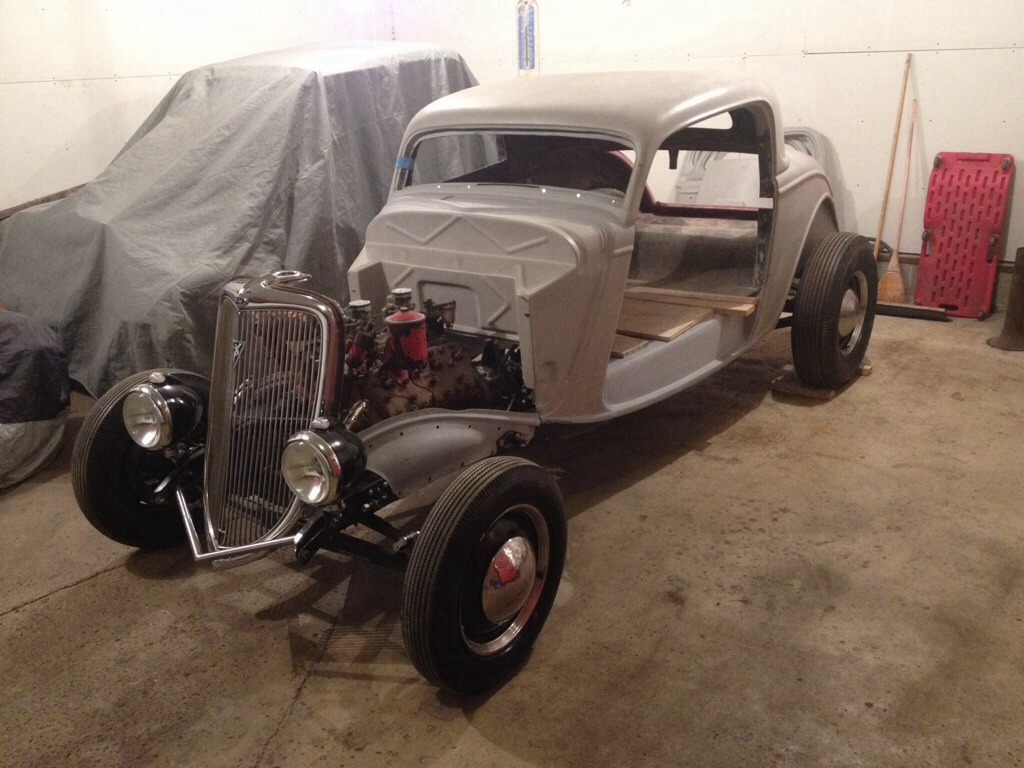

    Just some Mach up
