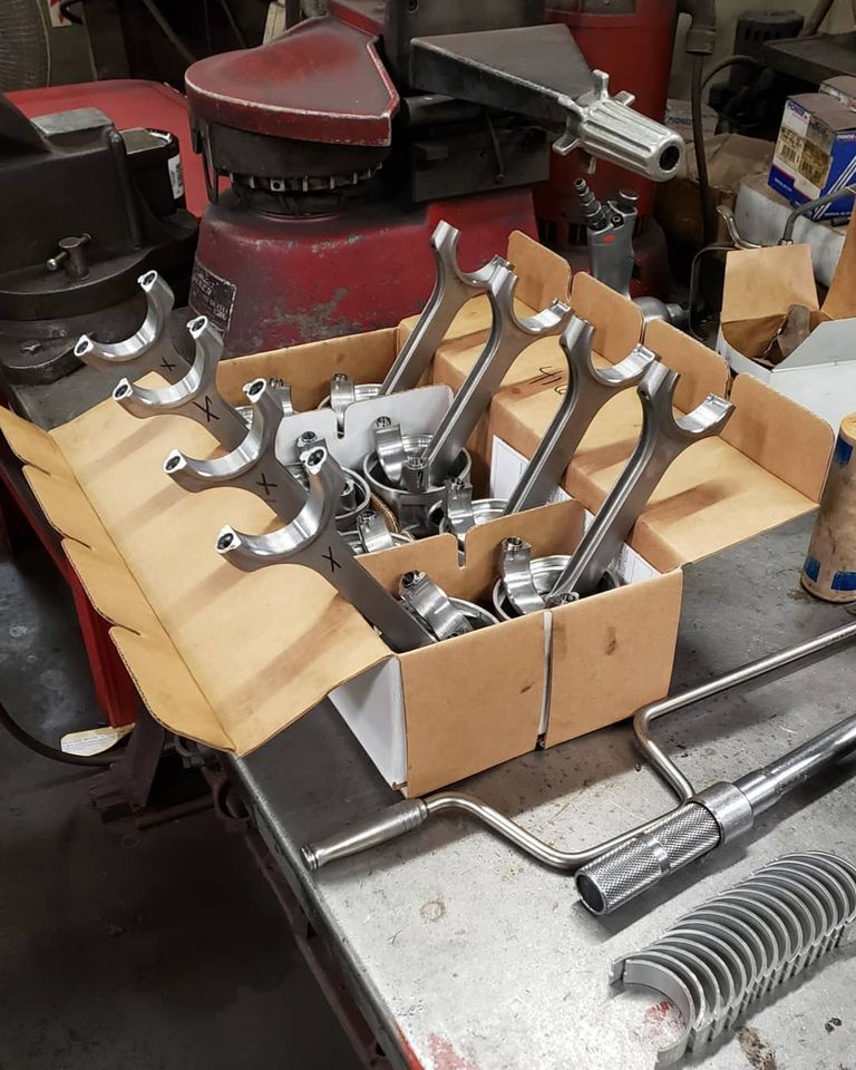

  13. So, needed a little something better to beat Rich Roberts at RPM this year so I began work on a new 296ci Flatty for the 27 Roadster. I started with a rusty old 59 A-B block that was given to me by @Royalshifter last year after he couldn't sell it at the RPM swap meet last year. (you guys that p***ed on it, just wait till you see what you missed out on. lol!) Bored to 3 3/8" and stroked a stock Merc crank to 4 1/8". **** H-beam rods and Egge 3-ring cast pistons installed.
    117444910_10224128495947162_9096689390106554242_o.jpg 118019157_10224197486871892_8410711875272245867_o.jpg 118033090_10224197487951919_3105442189013241720_o.jpg 118015679_10224197486631886_1437350191549611506_o.jpg 117832489_10224197487471907_1638858171337215032_o.jpg
    Wife is calling me out to walk the dogs. I'll add more later. ;)

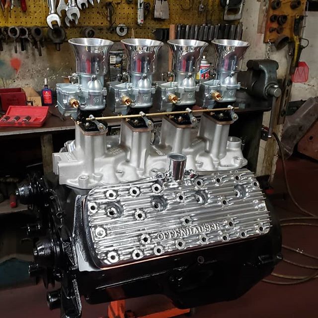

    Top it off with four new 81s on a Tony Baron intake and a set of polished Offy heads and we'll see just how she runs. ;)
    118472263_1779159938.jpg 118855683_1305693559.jpg 118959542_3155303297.jpg 119003775_10224349308307333_2487881854220085169_o.jpg
    Old motor in the foreground, still a good runner and will find a new home in my pending 31 coupe project. :)
