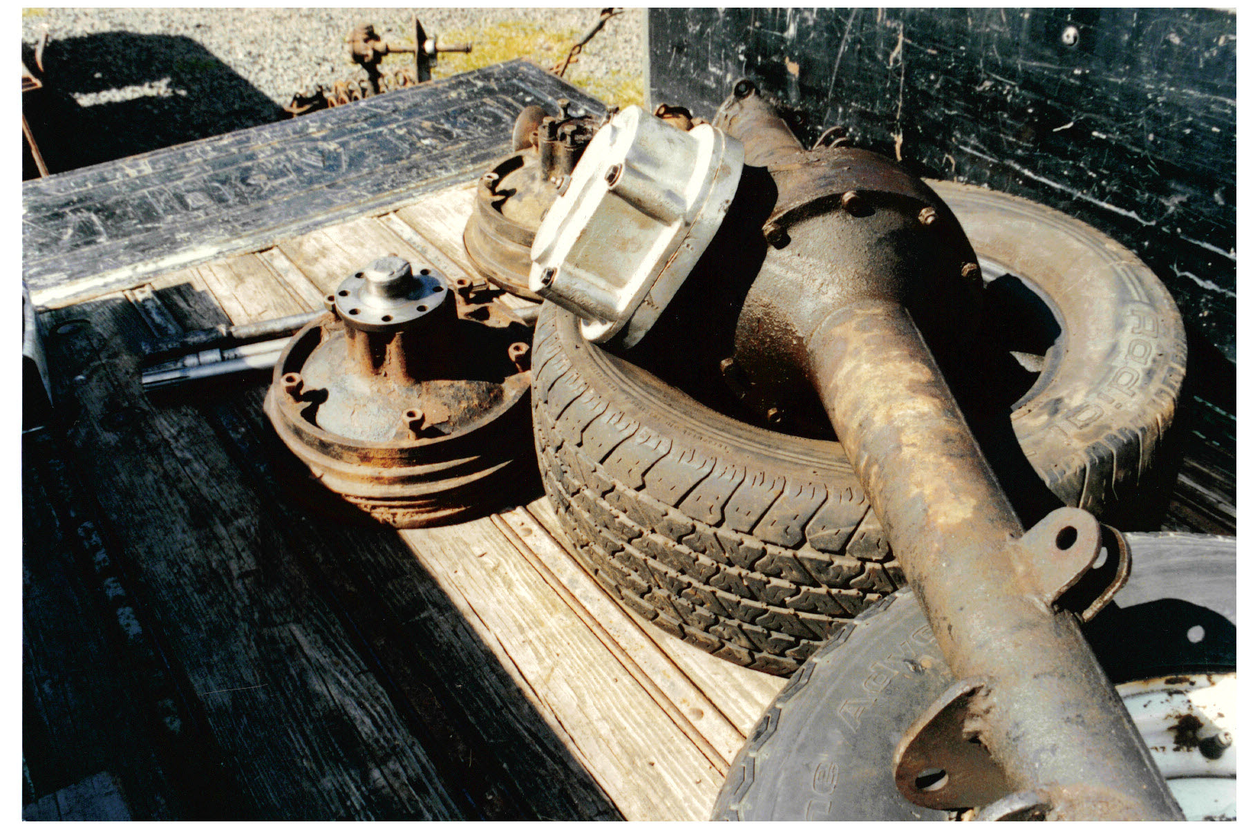

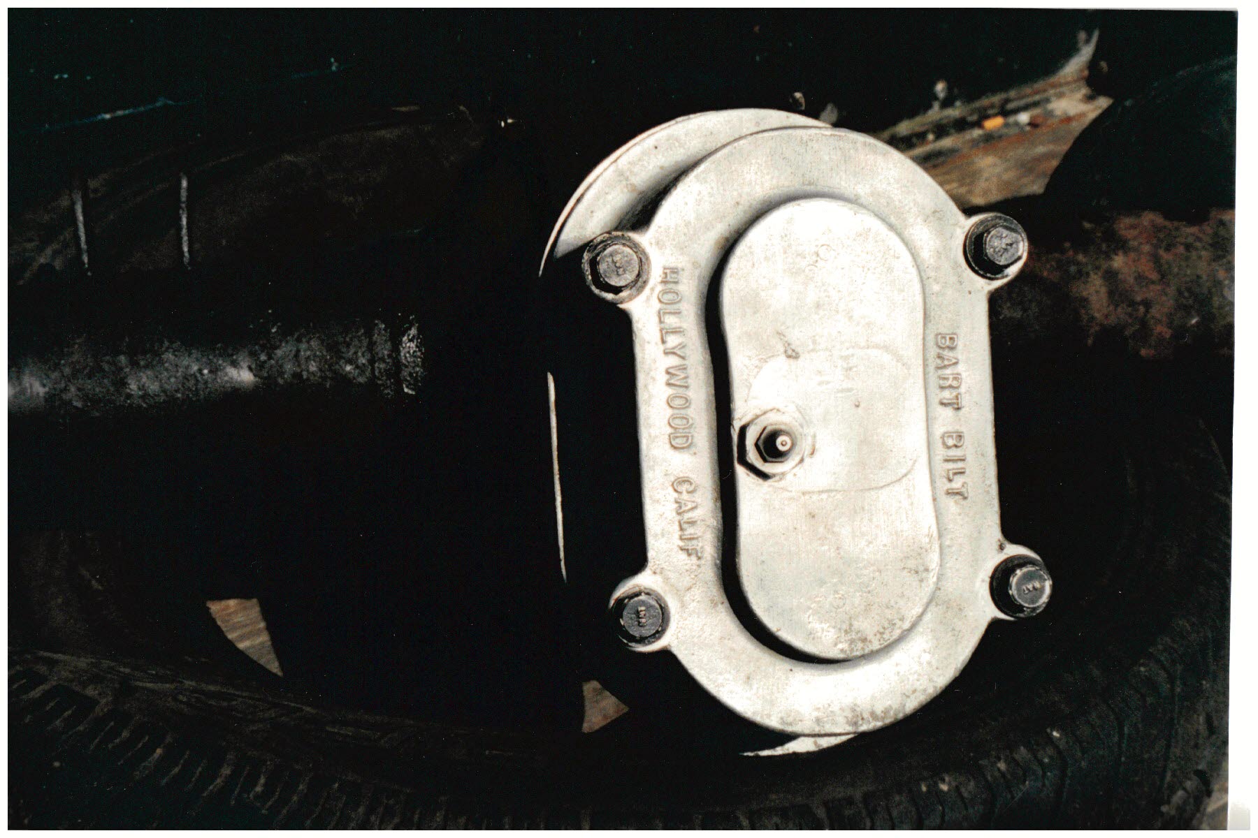

    A *****, building a converted QC, can be a tough slog. The biggest problem that I see, is getting the lower shaft and housing "dead pa 2012-07-03 170107.jpg 2012-07-03 185112.jpg rallel" to the existing pinion. With all of the welding involved, things move around a lot, making it difficult to pull off. Here is a shot of the "Bart Bilt" unit that I used in my Track Roadster, it was far from perfect but for $200 bucks, it worked OK.

    The key there would be to weld absolutely everything and then do all the machining afterwards. Problem solved :)
