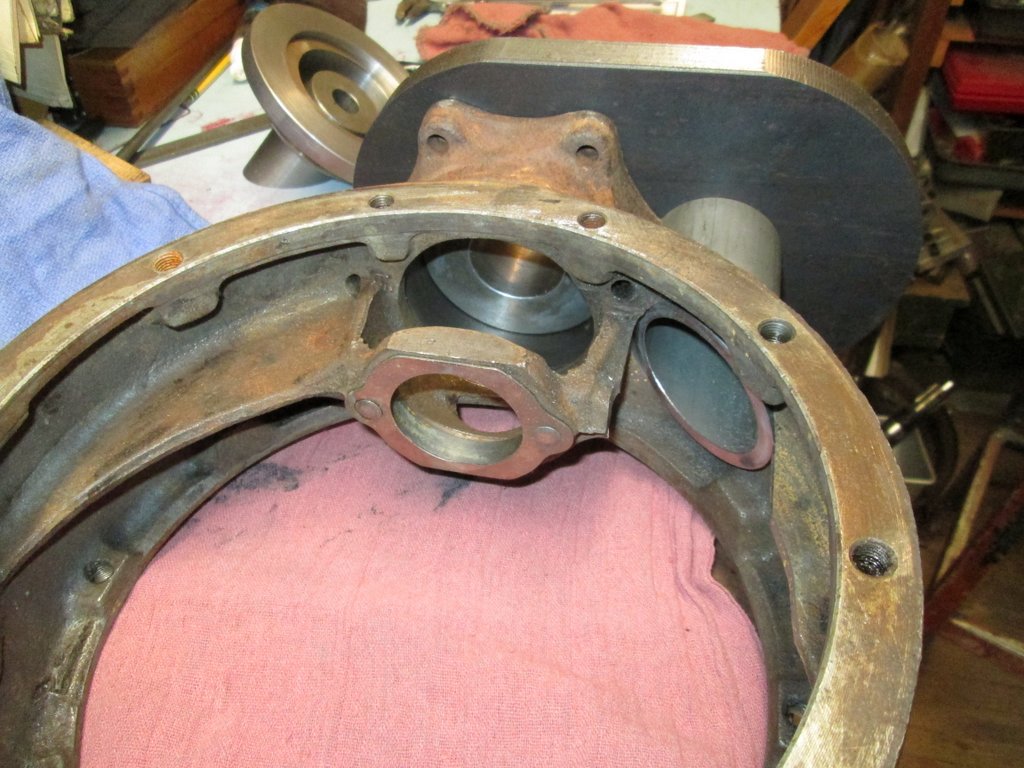

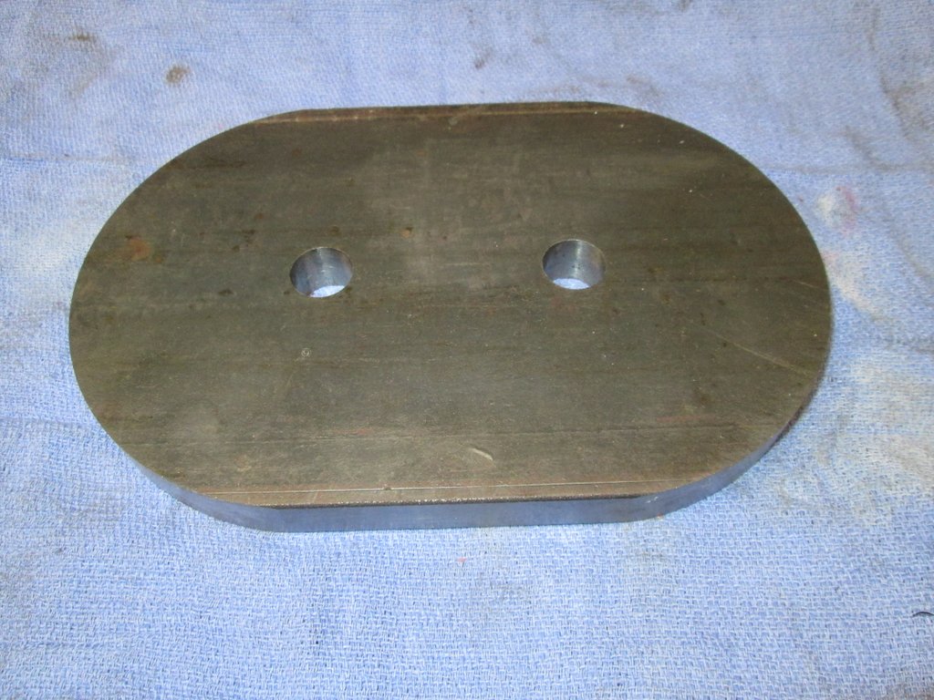

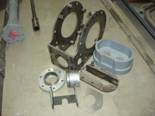

    Rear plate,tubing for rear plate,front torque tube flange and bearing holder this part is made in two parts. IMG_1056.JPG IMG_1054.JPG The two 3/4" holes in the rear plate are centered in the plate and are 3.000 apart.

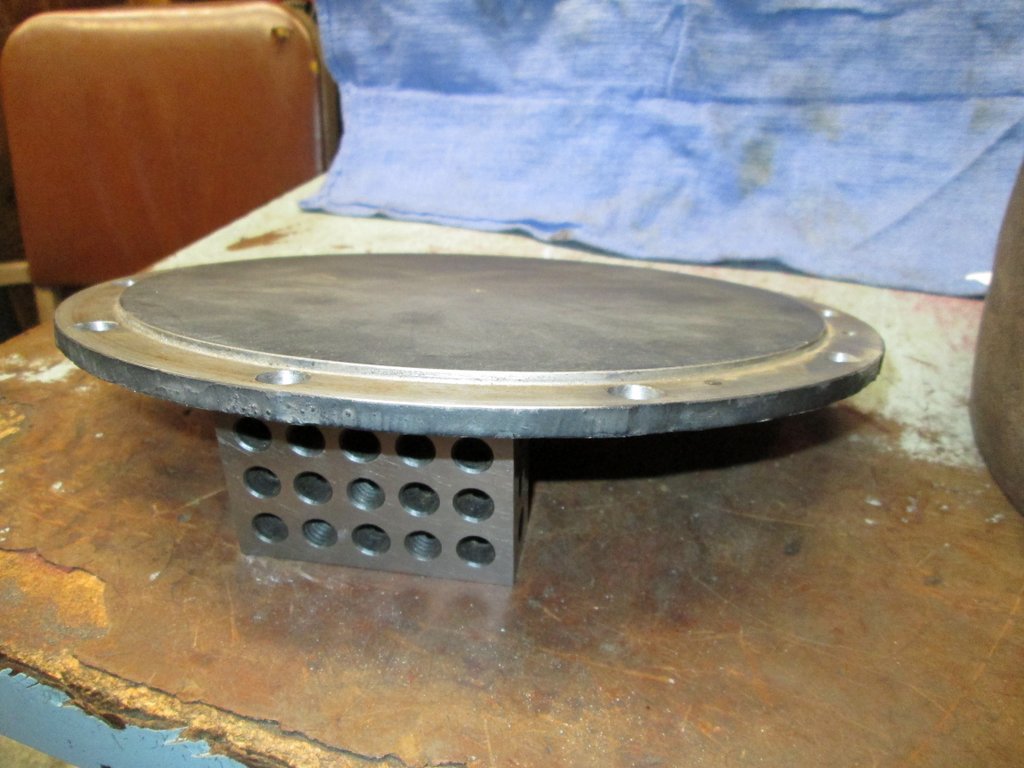

    IMG_0207.JPG IMG_1027.JPG rear plate radius being machined on precision rotary turn table, another tool you need in the machine shop business. IMG_1027.JPG

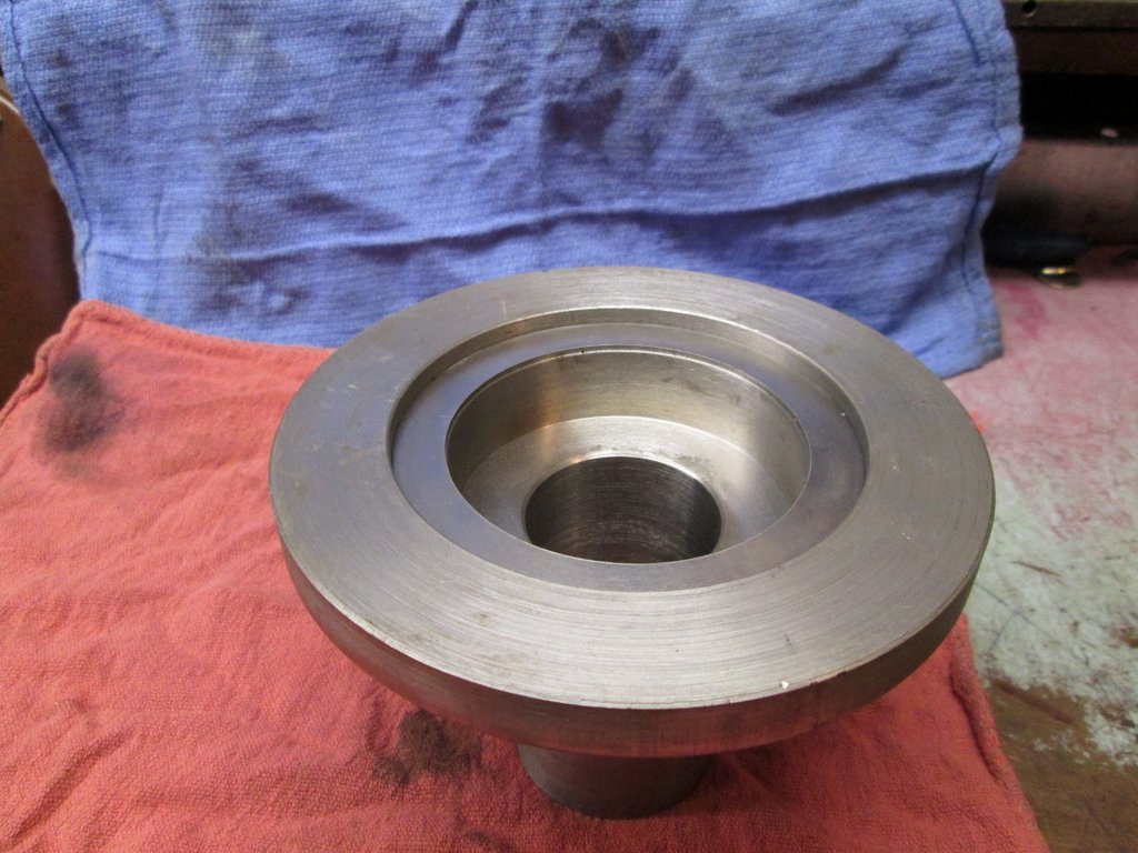

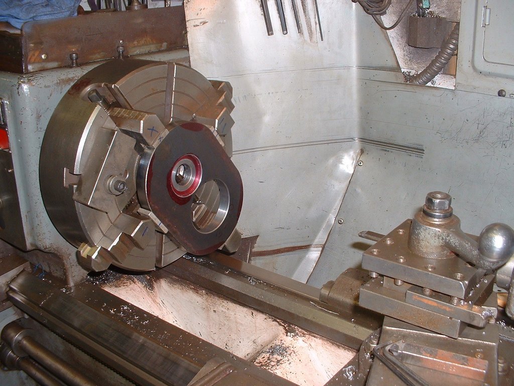

    now to the lathe to bore the large hole which is for the pinion bearings to p*** thru and locate for the welding jig.Small hole for the lower shaft to p*** thru, the counterbore is to locate the lower bearing.These bores are undersize they will be finished later after welding. DSCF0001.JPG

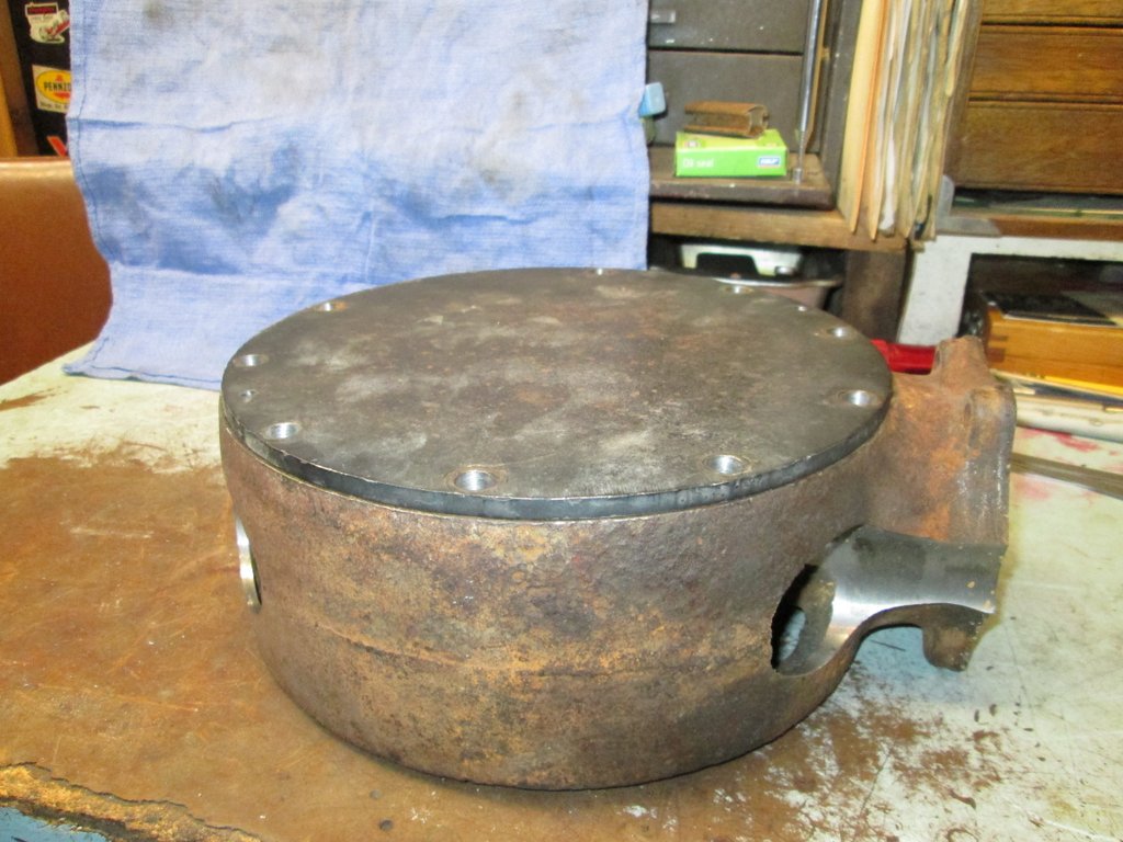

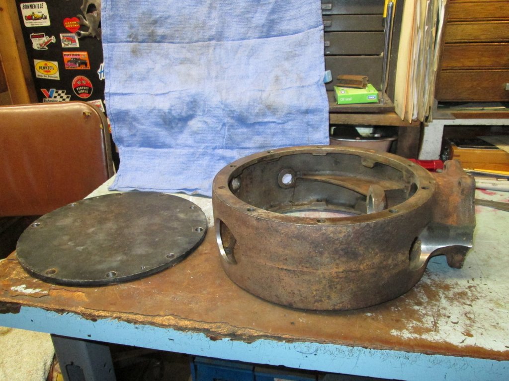

    getting ready to set the welding jigs,plates are bolted on to help to prevent warpage,the turned down lip really helps to hold it. IMG_1060.JPG IMG_1061.JPG [/ATTACH] IMG_1062.JPG

    I have a very good welder do the welding.When the welding is done let it cool not in a cold place but a warm place.Let it sit for five days, then heat the whole thing to about 400 degrees with a torch just where you cannot touch it.Let it sit two more days in a warm place then remove the jigs.This is a way of removing stress, normalizing.This is the way jig and fixture guys make precision tools, a lot of stress with that much welding.The center section was cast 65 to 75 years ago need to treat it nice give it every chance to be strong and stress free, when it is stress free it will turn smooth forever.

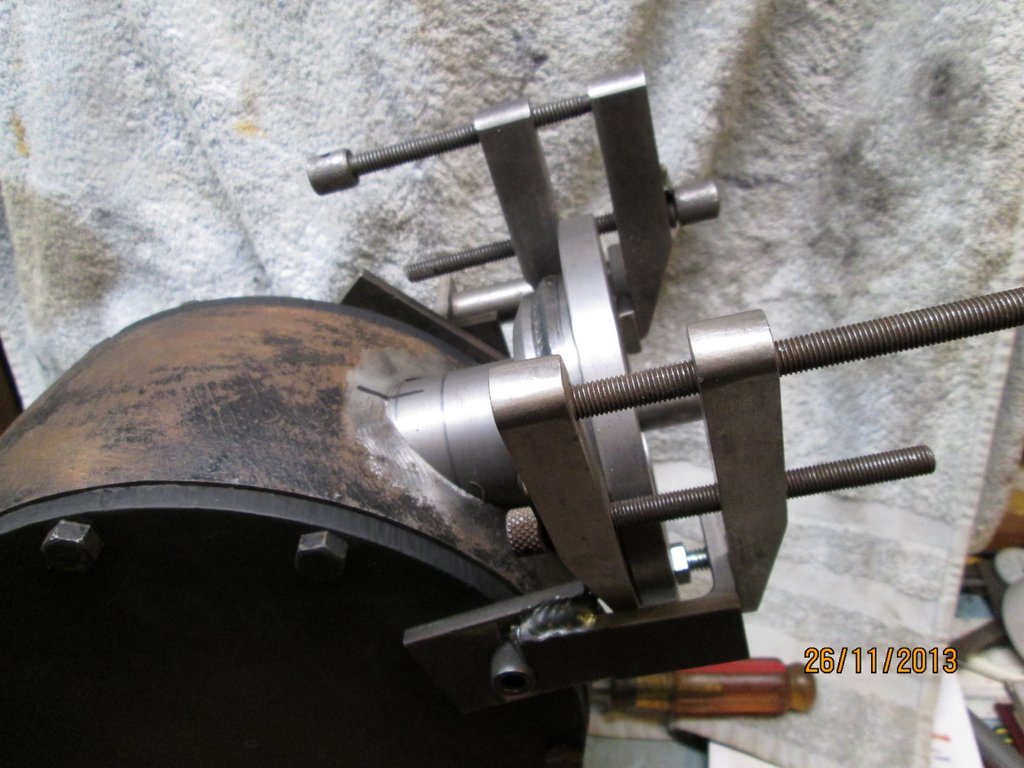

    while we are waiting to machine the housing,the next thing is to turn and grind the end of the pinion.this is to fit the end bearing in the floating plate.This is one of the hardest things to do as it is about 59 to 62 rc hardness like a coke bottle.Most shops will not touch it or send you to somebody that has a cylindrical grinder, at about $400.00 first rough down with carbide tool bit,must be finish ground or it will not be round plus .000 nothing minus .0001 I have a nice tool post grinder about 60 years old works perfect diamond dressing the wheel. IMG_1044.JPG IMG_1043.JPG

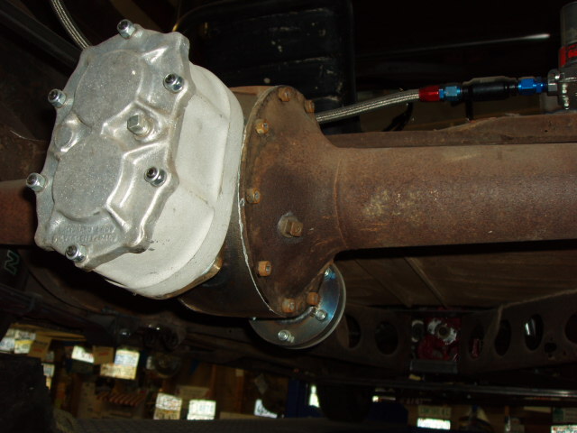

    Trans sprint 033.jpg Trans sprint 034.jpg KISS. built 5 of these. 3 are in my own hot rods. NO milling required. used a hole saw. tube welded to the outside of the banjo. does not extend inside. made a fixture off a Halibrand to install the front bearing retainer. my QC gear housing [ my own pattern] eliminates the extremly heavy 7/8" thick plate. foundry charged me $7.00 a pound for casting. i sold the pattern. plans and fixtures to a guy in AZ.

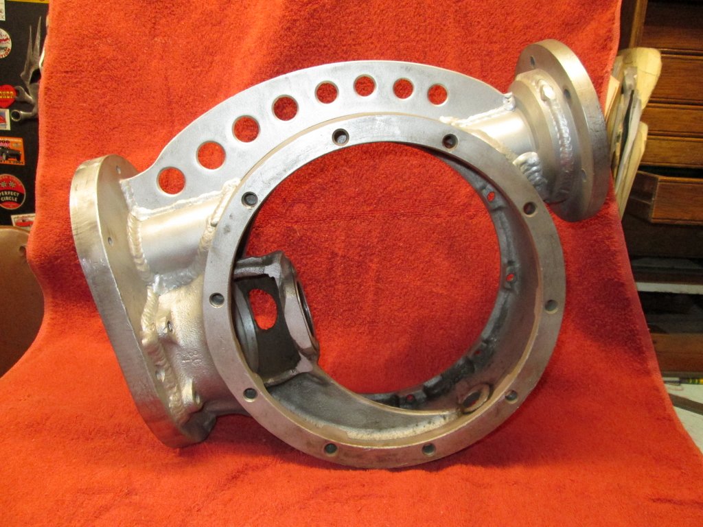

    now we have a solid one piece center section that has been stress relieved the pinion has been installed,the machine work has been finished.Before the machining the head on the mill was indicated to the table within .001 that is one thou. the angle plate to .001 with the table travel, the center section to .001 to the pinion wall.If you work this way it will make things much better none of this a couple of thou. here and there or it is pretty close, as a tool and die maker it must be right.The holes for the pinion bearing retainer,the bearing holder, and the rear housing, have been drilled and tapped. IMG_1089.JPG
