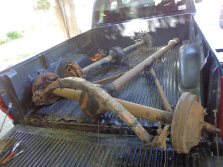

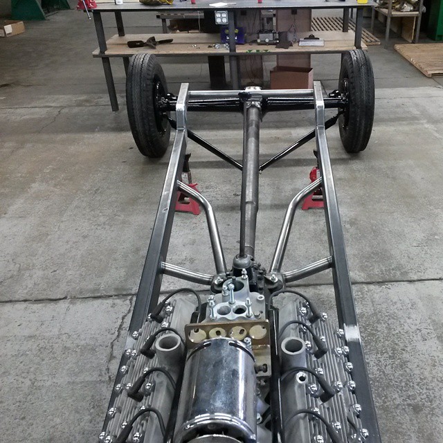

  1. Took the rear end over to Derrek's yesterday for fitting. All looks good and 21 5/8" will be coming out. I will post pix of the shortening process this week. Gonna be ready for that QC center soon. ;)
    10917063_10206007614336447_7538630506585842561_n.jpg 10520791_10206011600156090_3631666514838297268_n.jpg 10922690_10206011592795906_8056500471361513785_n.jpg 10505547_10206011589675828_8712107851021811208_n.jpg

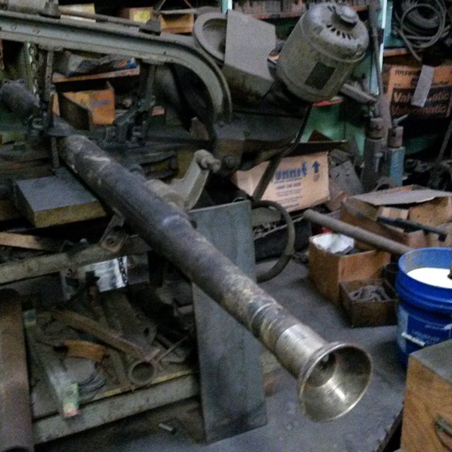

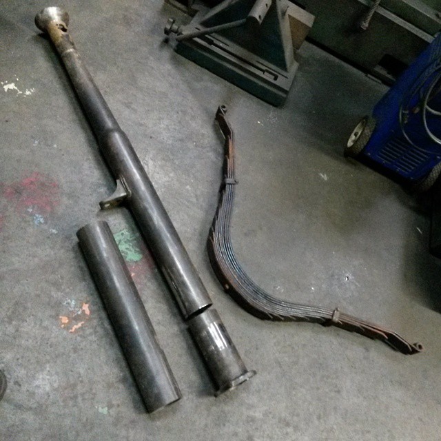

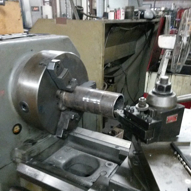

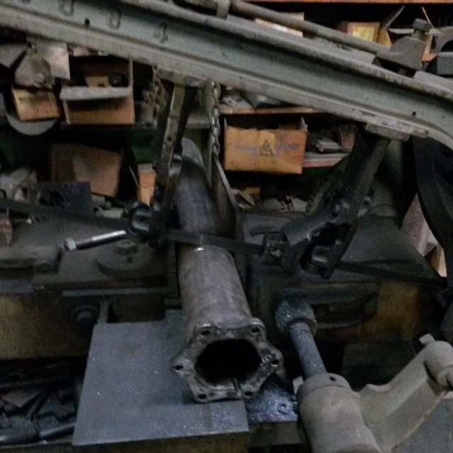

  17. Now that the frame is built and we have measured the rear end it's time to cut the tube to length. The rear end I started with was out of a '41 Merc Wagon I was told and the tube was 71 1/2" long, we need it at 50 1/2" so 21 has to come out.
    Measured twice. ;) Then cut the tube with a little extra as I've never seen a band saw make a perfect cut.
    Now I have three pieces.

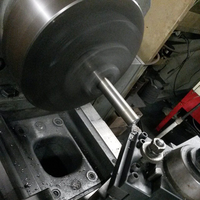

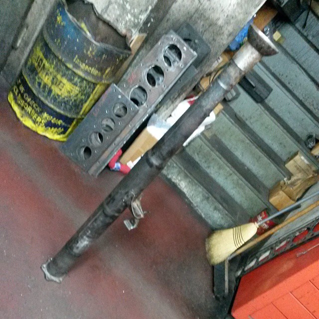

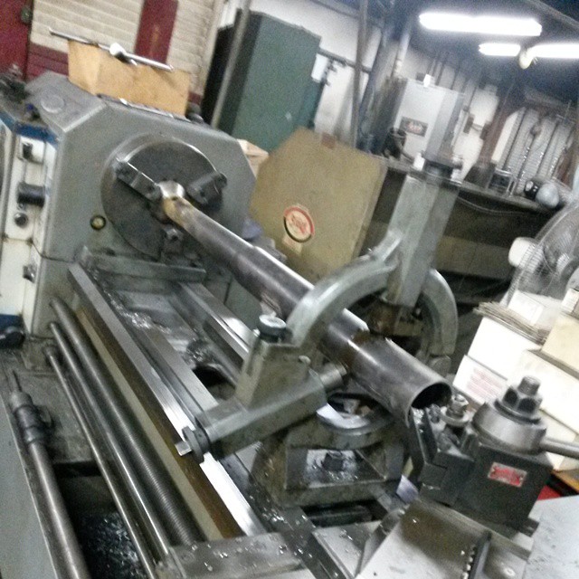

    True up each end of the tube in the lathe, had to be very carful with the short piece as the steady rest wouldn't get close enough to the chuck.

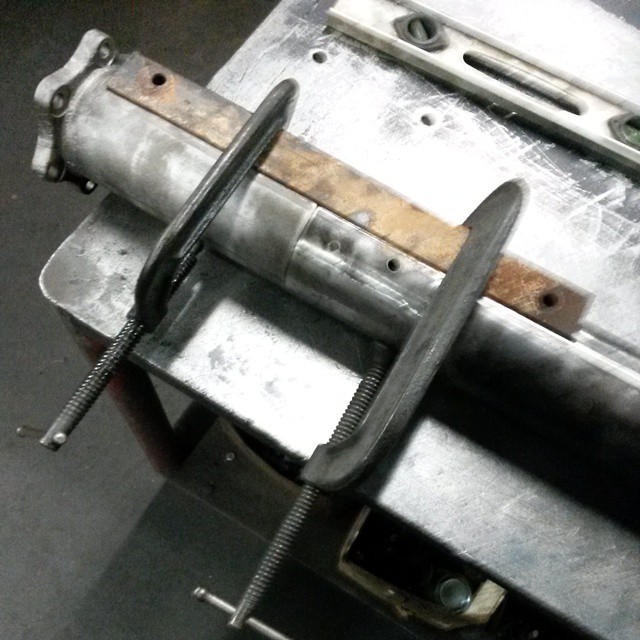

    A piece of angle helps to align the two pieces. I had marked the tube with a sharpie and a square before I cut it but the seam on the side makes a very good reference to line it up before welding.

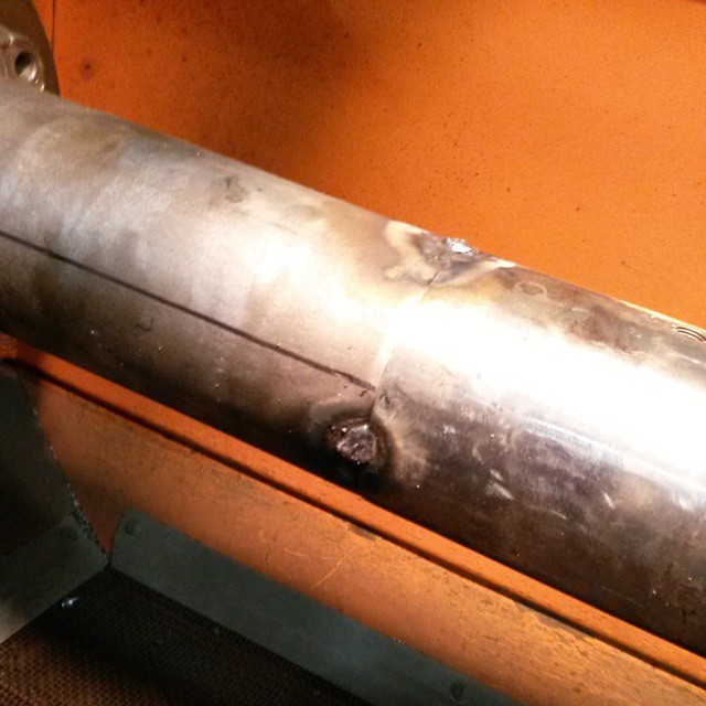

    Tacked in place.

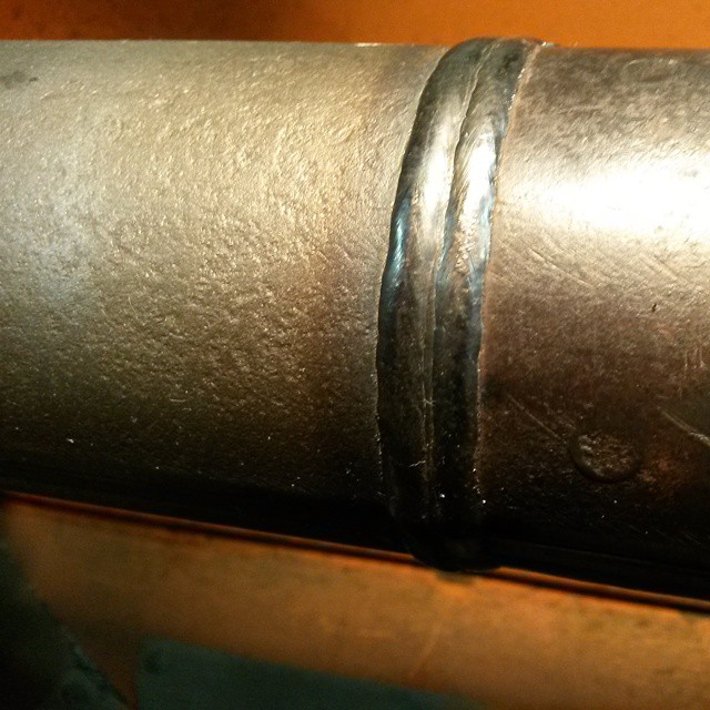

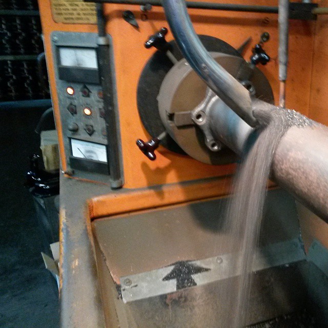

    Now the fun part. We have a crankshaft welder in the shop and I use it for welding anything that is round, makes a very clean bead.

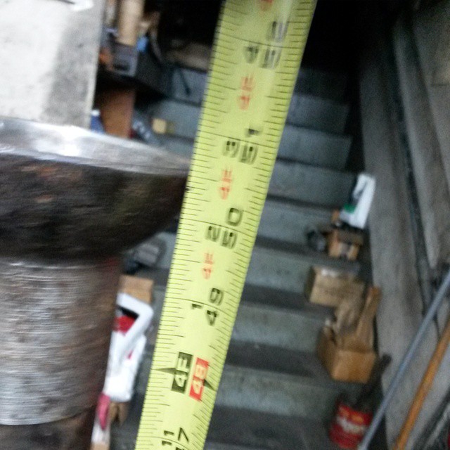

    There you have it! 50 and one half inches! Next I will cut the shaft the same amount.

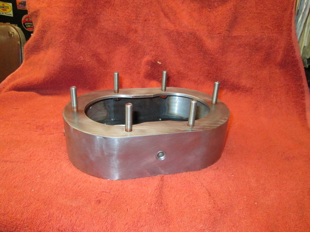

  23. bone31
    Joined: Oct 24, 2006
    Posts: 121
    bone31

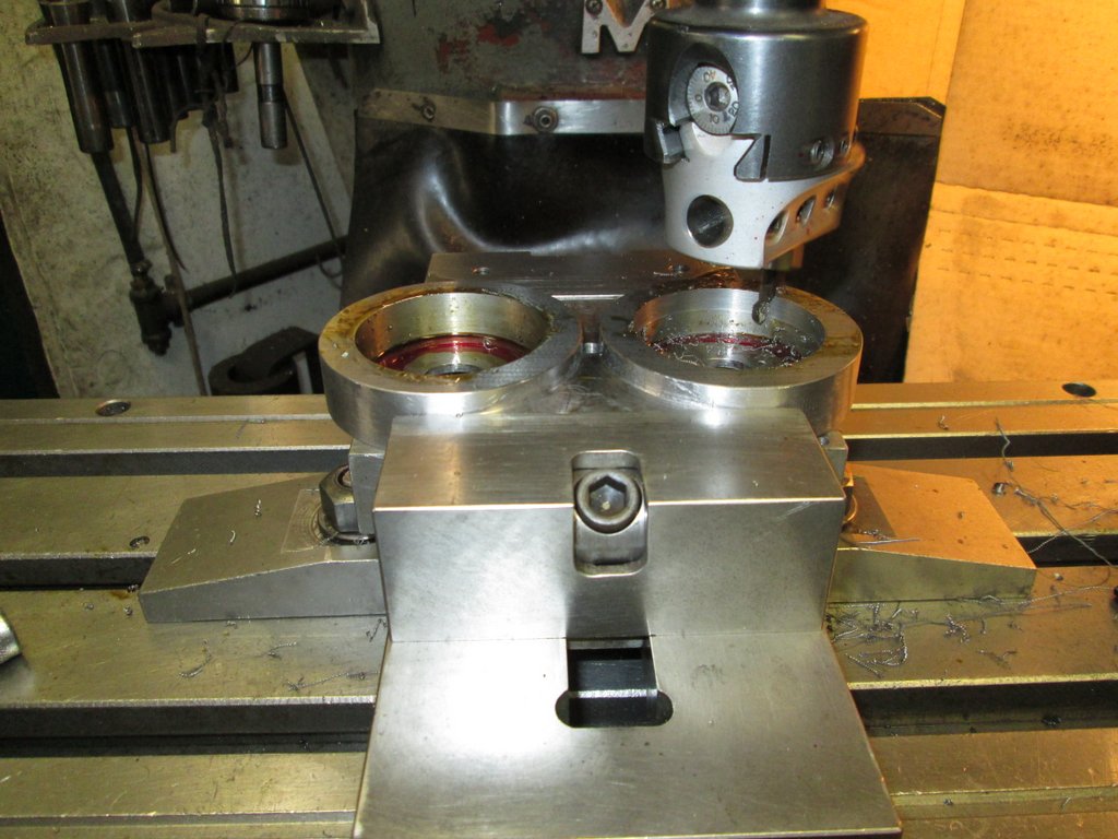

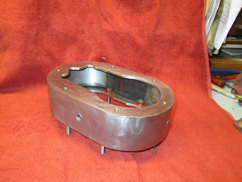

    got the bearing block bored for a press fit for the bearings, the tool is called a offset boring head.The two 3/16 holes in each pocket is to remove the bearings with a punch if you ever need to, never put bearings in a blind hole. IMG_1141.JPG IMG_1140.JPG
  24. bone31
    Posts: 121
    bone31

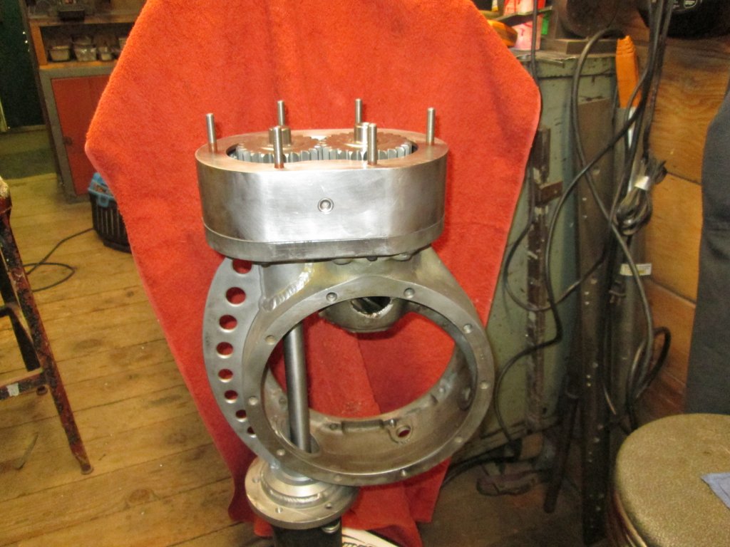

    Almost done,forgot to post the pic. of the test bell fit about half of the center sections need to be ground for a few high spots so the bell fits.Even with all of the steps to prevent warpage that is still a lot of welding , not much to deal with a few spots. Have the bearing plate done, the pad on the back is to regulate the clearance to the cover about .025 . Will finish the cover tomorrow and ship friday. IMG_1155.JPG IMG_1148.JPG IMG_1150.JPG IMG_1153.JPG A

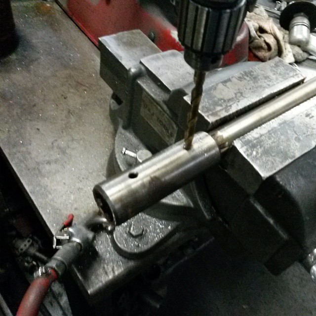

  29. Took the drive shaft and cut 21" off it. Measured the depth into the coupler at 2 1/4" and turned the cut end down to 1.005" with a shoulder at the 2 1/4" point after facing the end off.
    Next I bored the inside of the coupler with a 1" end mill to a depth of just a hair over 2 1/4". With a .005" interference I heated the coupler and dropped it on the shaft.
    Next we go to the crankshaft welder again, after boring out the pin holes and into the shaft a bit I put two "Rosette" welds on the coupler and welded the end with three overlapping welds, letting each one cool before the next one was applied.
    This should stand up to the maybe 160hp that will go through it. Time will tell.
