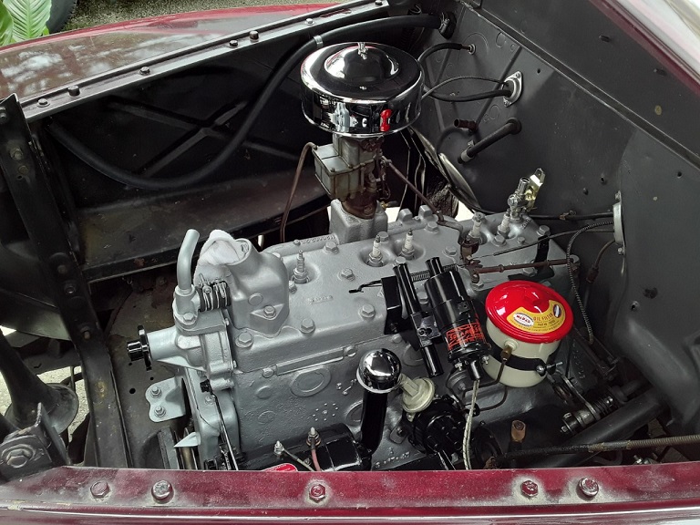

    I purchased a new-to-me 1947 Plymouth Special Deluxe Club Coupe, on August 14, 2020, from a 90-year-old gentleman in Ohio. I don't know much about this car, because he couldn't remember much about the car. He did say it was just like the one his aunt had, that he drove her to shopping and church in and always liked. Also, that he had not had it long and it was from California. Only bad things that he could remember was it pulled to the left, and the wiper motor didn't work and was removed. We (My wife, stepdaughter, and myself) took it for a test drive were the water pump decided to grenade and puke coolant about 3 blocks from his house. We got it back and it was in such nice shape, despite the few problems we bought it. Had it transported back to Wisconsin.
    Then the fun started. I attempted to replace the water pump, thermostat, hoses, clamps, and flush and fill the coolant system. The first water pump water p***ages did not line up with the engines. Put on a second pump, but the impeller rubbed on the casting, remedy that situation. Got to really drive it (5 miles), yes it pulls horribly to the left. Also, the battery didn't seem like it was charging after starting and turn off the engine 4 or 5 times (not in a row). Changed battery cables to 3/0 welding cables. That lead to having the generator tested, it worked. Decided since it was out put new bearing, bushing and brushes in it. Also, bought a new regulator and had it tested with the generator. The regulator was good, but the shop said it should be adjusted it was not putting out enough at operating temperature. The shop adjusted voltage output, and cutout amperage. So, while the generator was out, thought it was a good time to also get the distributor rebuilt. The car also seemed to gasp when you opened the throttle real fast. Was told if you think its carburetor related its probably ignition, that was the reasoning behind getting the distributor rebuilt. The second water pump started leaking decided to do it over, again. With all that open space decided it was a good time to repaint and clean up the engine.
    That takes up today. Having only a 1 car garage right now and can only work in driveway, has led to some delays. The engine has been painted along with all the brackets. New water pump, generator, distributor installed. Along with a Mopar canister oil filter. Plumbed the lines for that, which it never had. New cap, rotor, coil, plugs and plug wires. Took the oil bath air cleaner off, installed a nice chrome air cleaner. New hoses and clamps. Had to prime the fuel system, it went dry over the year it has sat while working on it. Got it fire up on Tuesday, August 31.

    The Chrysler designed carbs like would have been original to your Plymouth are an exception to the "if you think it is carburetor, it is probably ignition". With these, if you think it is carburetor, it probably IS carburetor.
    But someone before you has already figured this out, as the pictured carburetor is not original. It appears to be a Stromberg, and if the individual installing it did his/her homework, and installed the proper Stromberg, there would be no better single carb available for than engine.

    From this last weekend. Here is the engine compartment as far a I am going to take it right now.
