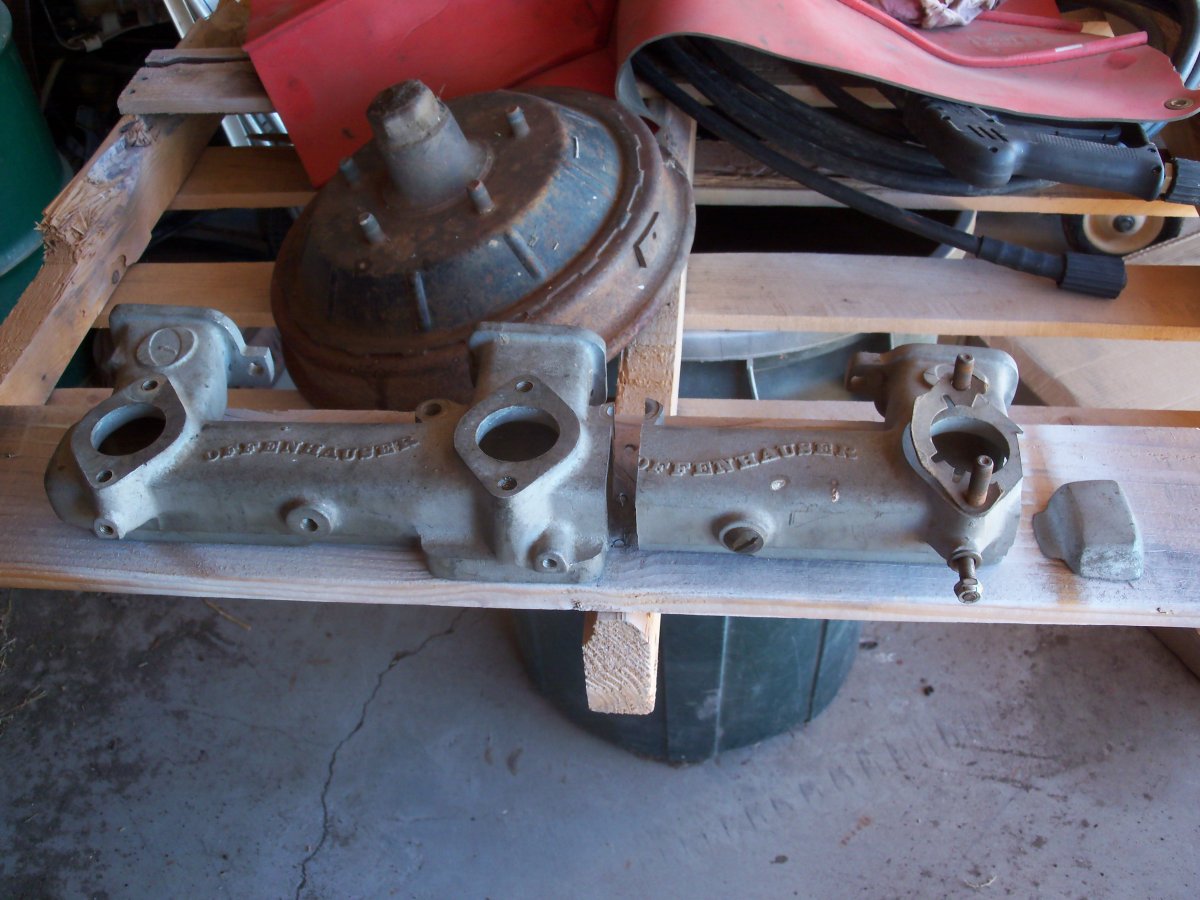

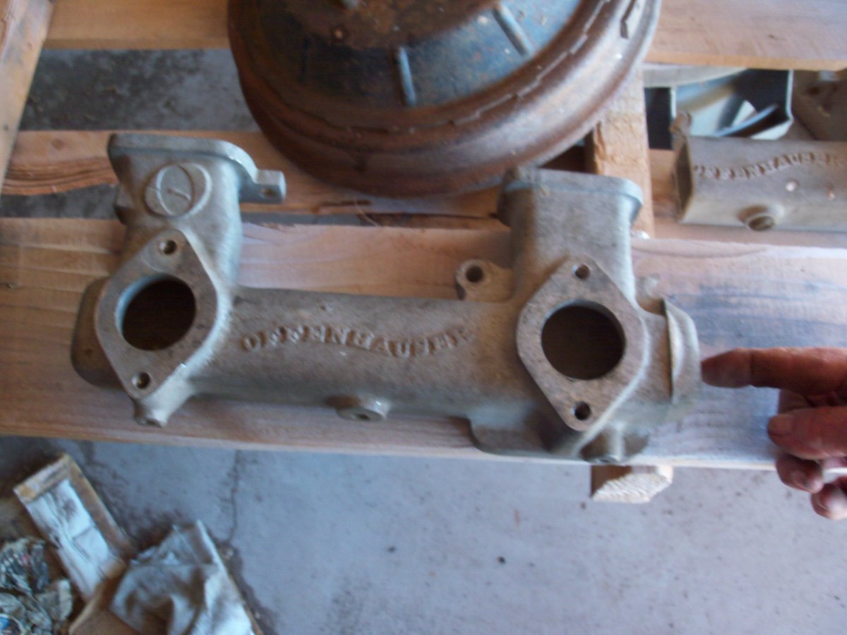

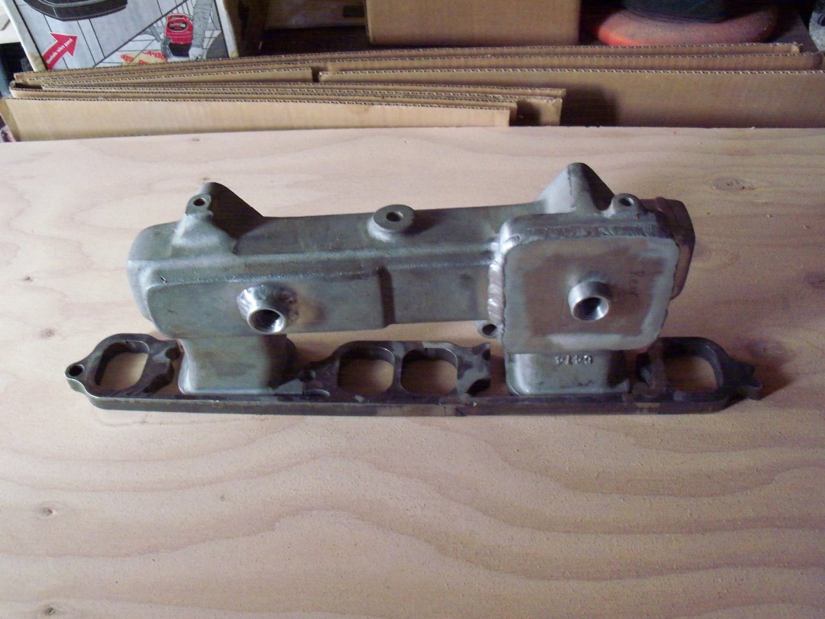

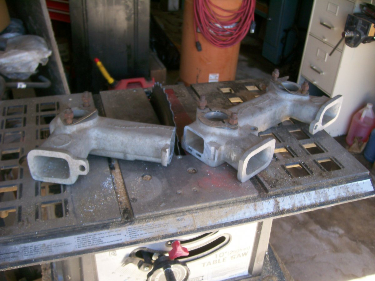

    Here is where the intake manifold came from.
    An Offenhauser 3X1 for a 230-292 Chevy 6 The 153 ChevyII four is 2/3 of a 230 Chevy six.
    A table saw with a carbide tipped blade
    Two cuts
    Get rid of the extra 1/3.
    TIG it back together
    Add a plate and fittings for water heat. Done!

    Thanks, It is a cheap and easy way to solve the almost nonexistent intake issue on these engines. I found this on eBay last month. I don't know what it fits but can easily be adapted to the 153 or the early Chevy 171 pre '29. I is from Ellis. s-l500-10.jpg s-l500-9.jpg

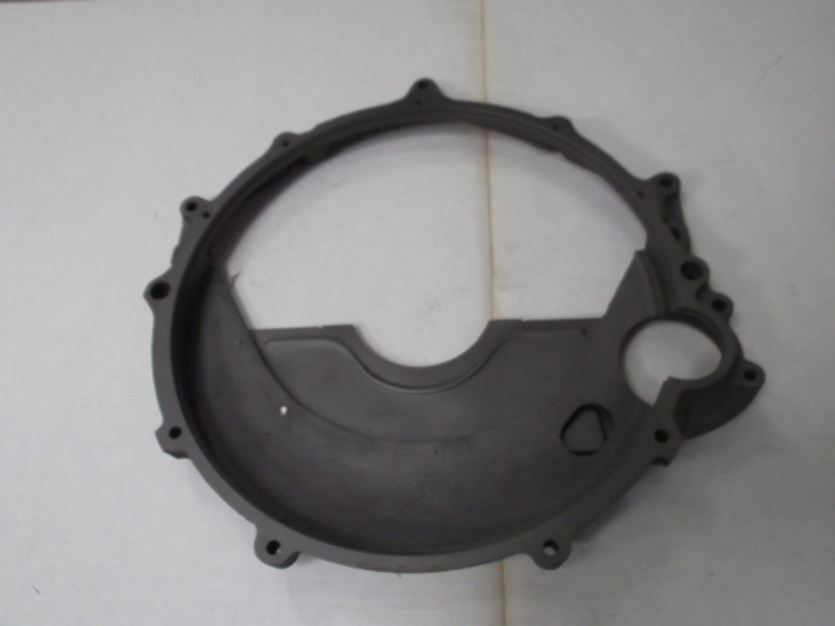

    I added a couple of new pieces. I found an aluminum adapter to put a Chevy engine in front of a Studebaker trans. It requires the cast-iron power glide adapter. It all fits great but....... The 153ci uses a 153t tooth fly wheel with a 10.5 clutch package. The 153t starter bolts to the block with two bolts. The power glide adapter has a 3 bolt starter mount but it is for a 168t tooth fly wheel and blocks the 153t starter. The 153t flywheel was balanced with the engine.
    I'm thinking that the heavy 168t tooth wheel is too much for the 4 banger. I thought if a light weight flywheel but all of those I've seen use 11"-12" clutches. I sure don't need that. There are standard weight 168t flywheels that use the 10.5 clutch. Maybe I can do some cutting on the PG adapter and use the block mounted starter. It's hard to just change one thing. And yes, I do have Chevy trannies that would bolt up but that is just not as cool. s-l1600-5.jpg s-l1600-8.jpg s-l1600-9.jpg

    Yes, I need it. I've got to get all these collected parts in and on the engine/trans so I can take some measurements and see how it fits with the body and frame.

    little motors like a heavy flywheel, eh? I'd just run the 168 tooth and the 3 bolt starter.

    That would be the easiest except for the balance but they are supposed to be zero balance anyway. If the engine didn't like it then I could make the change to a light weight 168 or make whatever change to get the 153 to work. Pulling the engine will be no big deal.

    I did a quick starter check yesterday. I put the PG adapter on a spare block and held a mini starter up to it. I think it will work just fine with a little m***age of the aluminum starter block. There is a starter stud from the 3 bolt that I need to remove. This is in the shed and it's cold here. I'll try to drag it into the shop and set it up to take some pictures.

    Yeah, Ch***is progress. I need to get the engine and trans bolted together so I can locate it in the frame. I'll need to at least have the cowl sitting on the frame so I'm sure I clear the firewall.
    Today I pulled the stud from the PG adapter and tried to locate the mini starter. not as close as I thought. I dug around and found a 153 tooth starter. I could make it work but I'd have to carve on both the PG adapter and the aluminum adapter. Much easier just to use a 168 tooth flywheel. While digging around I found a #3729004 168 tooth flywheel. Those are drilled for the 10.4" clutch like the 153 tooth flywheel. The difference in the flywheel weight will be the only difference since I won't use an 11" clutch. I can not find the weight of either flywheel. The 153 tooth is # 366861N. I guess I could bolt the adapters and trans to an extra bare block to get some measurements.

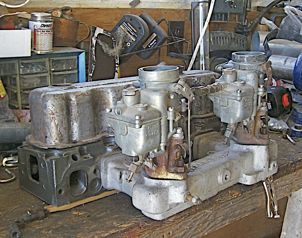

    Yesterday I confirmed a source of venturies for the Zenith 28s I'm using. I have a matched pair that I took from a small port GMC intake. They were most likely on a 270 but possibly a 228 or 248. Their venturies are 30mm. I'm thinking that is too big for a 175ci engine. The venturies are available in 32mm,30mm,29mm, and 24mm. I'm trying to figure this out so I can rebuild the carbs. I'm leaning toward the 24mm because they are sort of inline with what a carb calculator indicated and also because if needed it is easier to open them up than to make them smaller.
