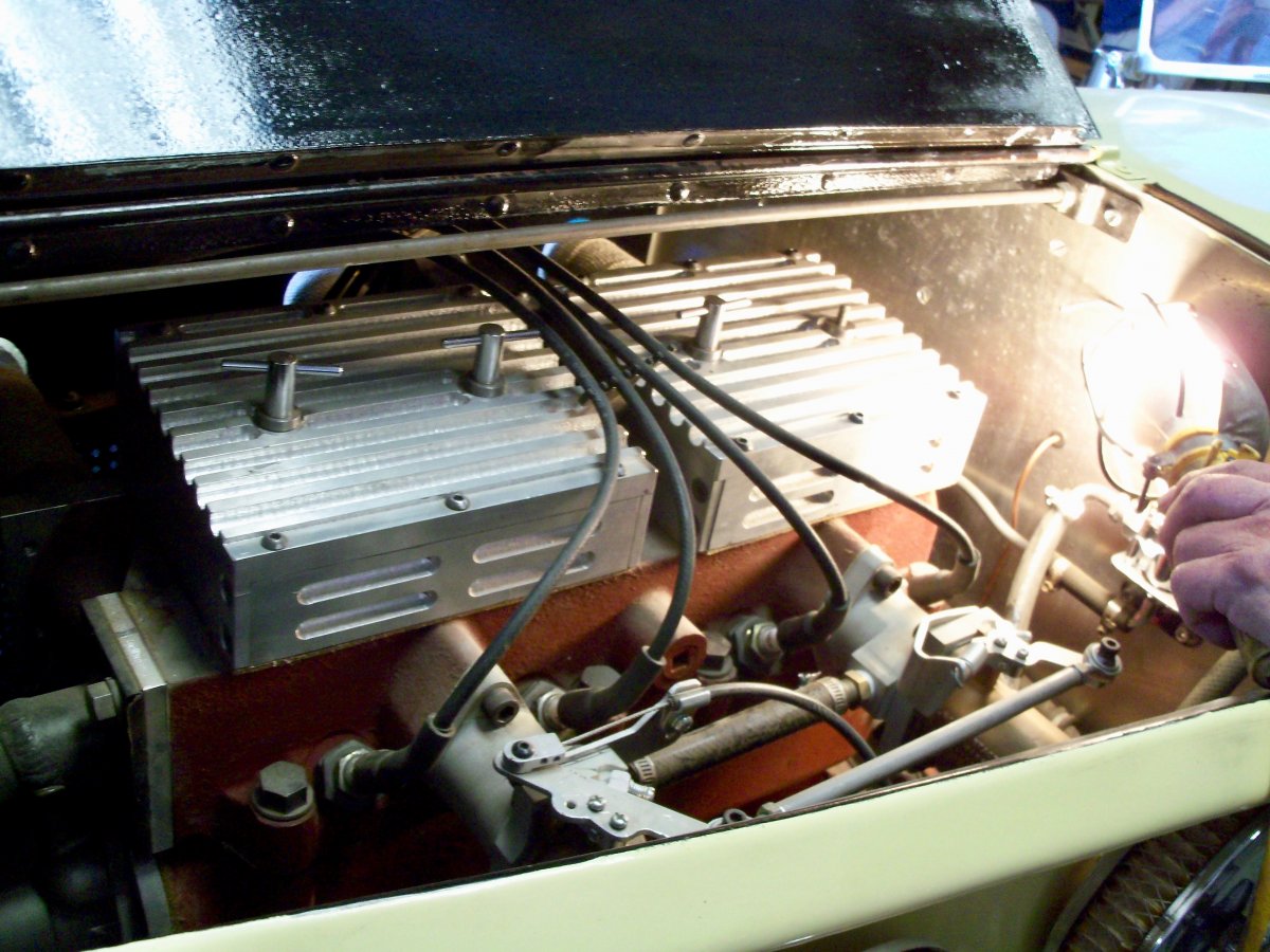

    Six Ball - while the adjustable main metering jets shown in your picture are highly desirable for SINGLE carb applications; they add several degrees of difficulty to dialing in a dual application.

    Stueeee, Thanks. I really don't think I'll have to go that small but there isn't a choice between 29mm and the 24mm so the 24s and a pocket knife might be the deal.:confused: I have a pair of Webers in the drawer too.
    Jon, But they are just so cool. :( Nothing is easy for me with carbs. The more the messier. Actually I've used this type before on Chevy and GMC sixes. I've never tried to run a pair on an engine this small. If I can't get them to work there are other options. Thanks for the heads up.

    Six Ball - if you place sensors to a gas ****yzer in each exhaust port, you can make it work, but just adds several degrees of difficulty. Fixed jets are SO MUCH easier with a multiple set-up.

    Jon, The exhaust sensors makes sense and I could do that. I also have a set of very similar Zenith carbs with fixed main jets. They look the same otherwise. I'll have to check their model #. I know a lot of guys ran these 28/228s in "the day" and they were sought after but a lot has been learned since then. Thanks

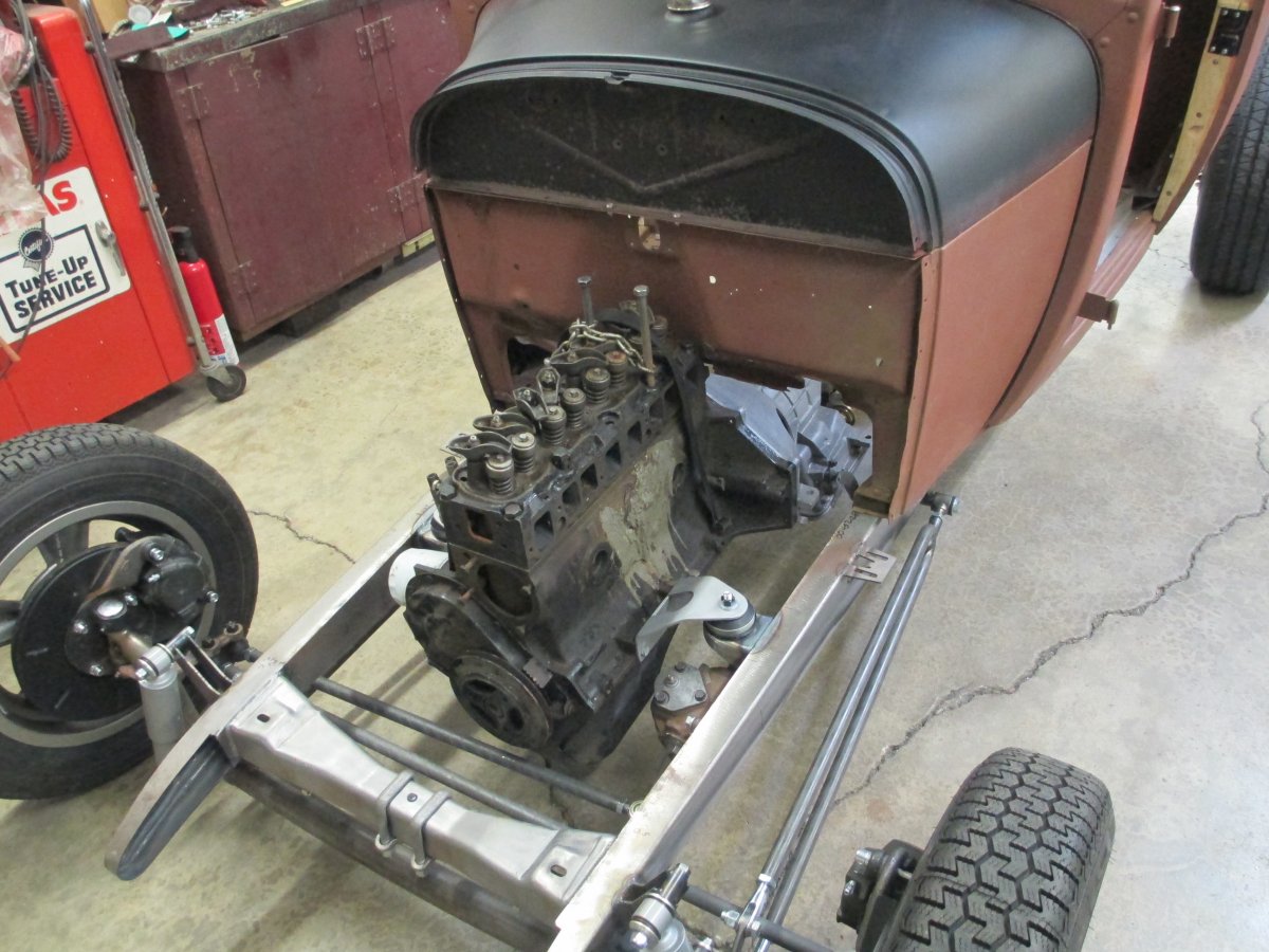

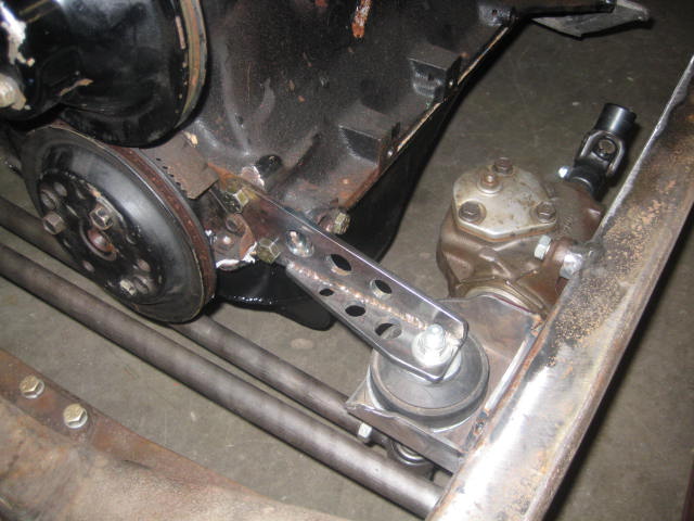

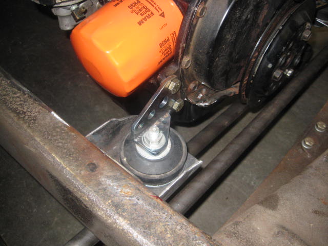

  23. Since I'm not familiar at all with 4 cylinders, how do you plan to install your banger in the ch***is? What does a typical engine frame/mount look like anyway? Any photos to show?
  24. Six Ball
    Joined: Oct 8, 2007
    Posts: 6,956
    Six Ball
    from Nevada
    Mine will have two front mounts and one from the rear of the transmission. The bell housing is the same as a small block and the front isn't too different. They were used in Chevy IIs along with 230 sixes and 283s. There are at least three threads here about these engines. Sadly a lot of the pictures are gone and some of the info is wrong. I wrote some of that. :eek: Here are some pictures I lifted from those treads.

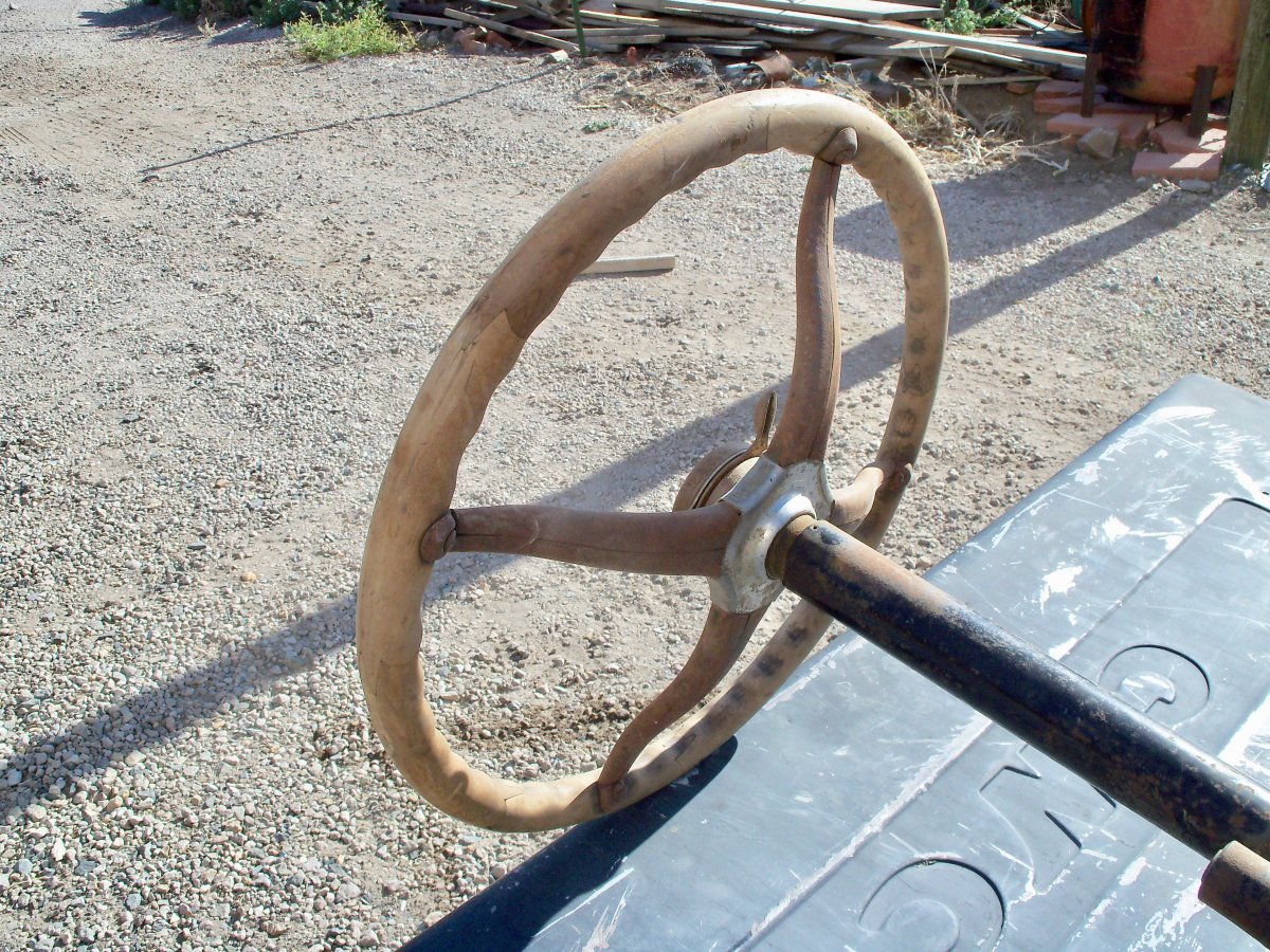

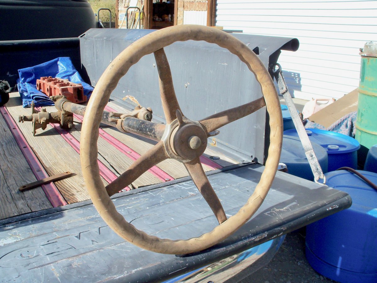

    Saturday I went to a swap meet at a friends shop. To me it is "Early Chevy 4 cylinder Heaven."The parts stash is overwhelming. When I go there the old Chevy bug bites me again. In fact I got a 1919-1922 Olds 3 port head and custom aluminum rockers. (for later) I also got the nicest, tightest, most complete early Chevy steering box and column with the nicest steering wheel I've ever seen. Today I bolted it into the frame. It was a missing link. I had planned on using another box because I never thought I'd find one like this. It will greatly help in locating the engine and firewall/cowl. Every thing on it works. I can even use the choke and horn ****on. I won't need the spark advance but maybe........? I got to see my friends Early Chevy dirt track racer that will be on the road soon. It has a 25 Chevy engine with an Olds head. Pure inspiration! Also some shame. :D
    100_0201.jpg 100_0202.jpg 100_0211.jpg 100_0199.jpg 100_0181.jpg 100_0197.jpg
