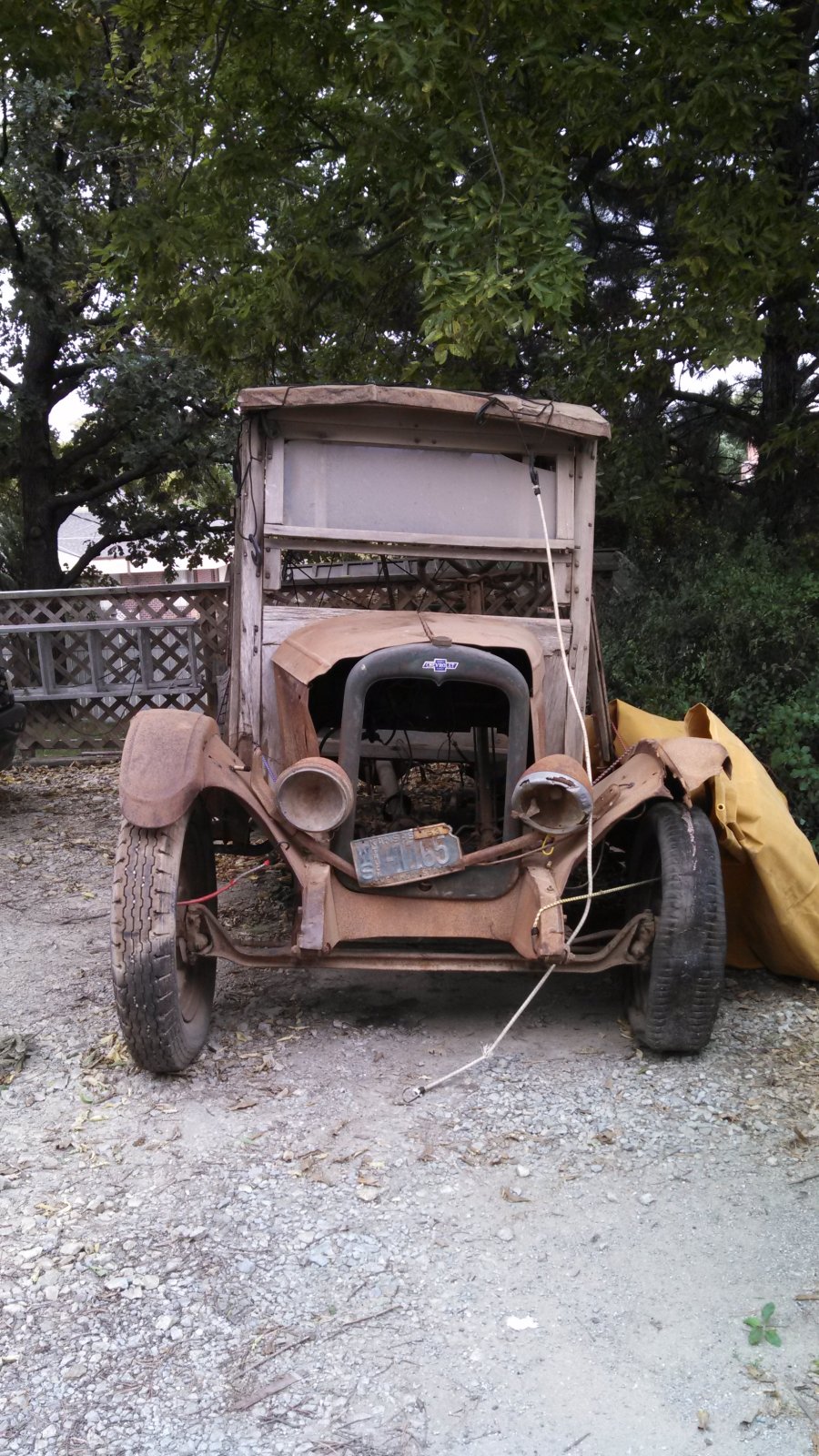

    Like to see pictures of the '27 truck.

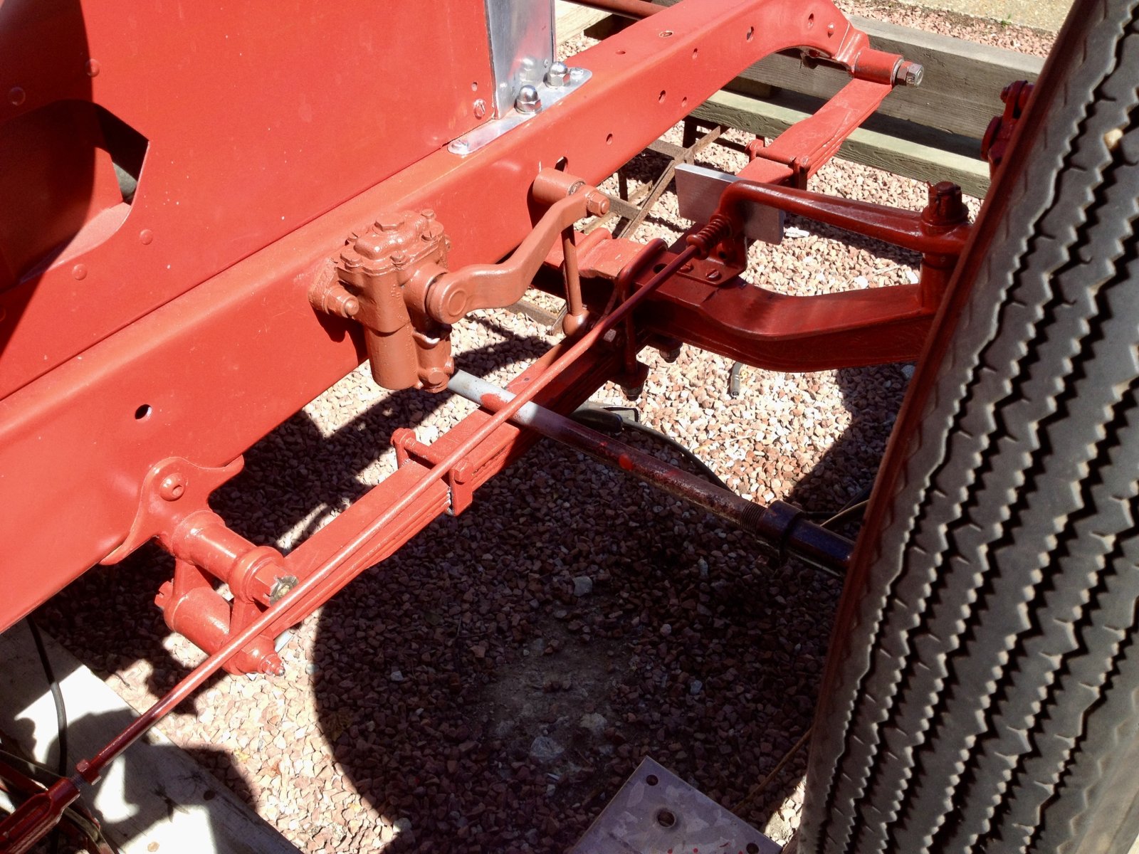

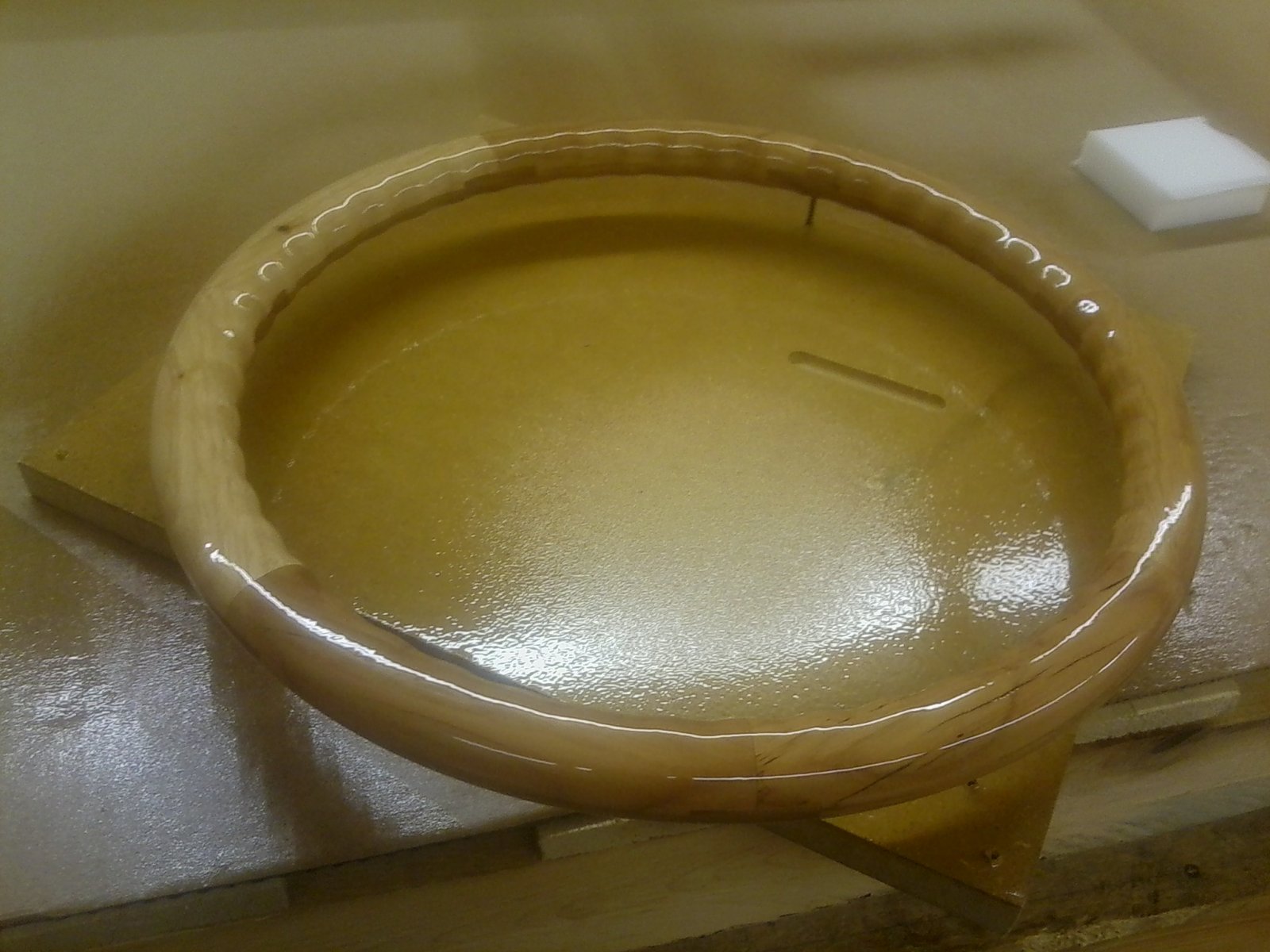

    0413161550.jpg Well, the truck has taken back seat to life in general but I have recently found some motivation and started back on it. You got me to looking for pics and it looks like we have had it for 8-9 years and so far I have not made much progress. The only thing I have done as far as going back new is I made a new steering wheel for it. I have also been collecting parts as there just wasn't much left of the truck when I got it. It was fine with me at the time as I figured I be making most of the body anyway.
    Anyway, I did find some pics of my setup making the steering wheel which was small parts, it might help explain some of what I described previously.
    First pic is the finished wheel with the finger grooves, the next ones are the blank with dowel holes next to the spot on the table I poked holes in for dowels and vac holes. It also got the o ring groove.
    I put the blank on the dowels, turn the vacuum on and then run the program. For this I cut the end/cross grain first at the angle to make the pie cut, I also roughed the perimeter to help eyeball the glue up. Glued it up as a rough ring, then I cut the inside with the grooves and roundover. With that done I clamped it in place from the inside and then cut the outside. I recall having to roundover at least one side on the hand router.

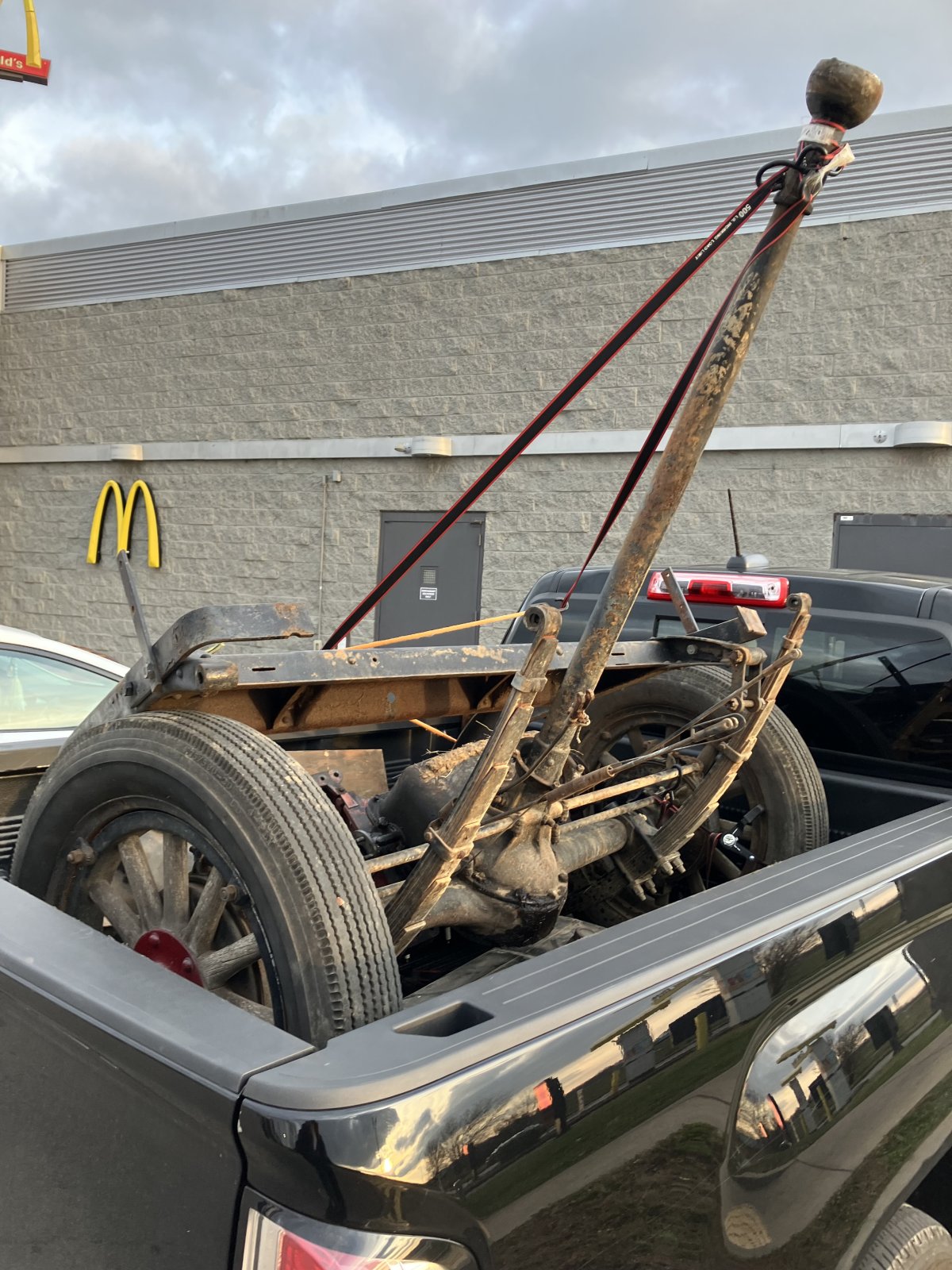

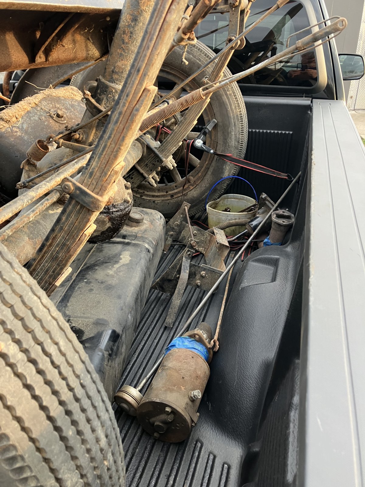

    IMG_3398.jpeg ROAD TRIP !!! Across two states into another for old Chevy parts. A nice person building a street rod gave me a truck load of 27 parts. He has a truck that had been made from a sedan and he is building it into a rod. I think the engine is junk, looks like it has been welded on and a big hunk of the deck is missing. But I got a nice rear end, rear springs, hangers, starter, column and wheel, carburetor, transmission with 27 crossmember, and more … I haven’t investigated it all yet, some of it is wrapped up. We forgot to load the front axle . I am excited that the parts are not very rusty. Most of it is greasy or still has black paint on it. The springs and hangers, are much nicer than the ones I have. It will be interesting to compare the transmission crossmember to the 28 crossmember.

    Great find! Even the engine will have good parts. The wheels looks solid. Is it worth going back for the front axle? Did it have the brakes & wheels?

    You got the gas tank too!

    Yes, hopefully the tank is good. I have a good tank but this one has a gauge. I have a front end but that one is better. It is about 5 hours each way for me, if I have a reason to go back that way and he still has it, it might be worth a diversion to pick it up. The front axle is a 27, so it doesn’t have brakes. If I run across a good 28 front end cheap I might look at using it, four wheel brakes would be a plus. This rear end also has the brake rods. Will post some more pics after I unload the truck.

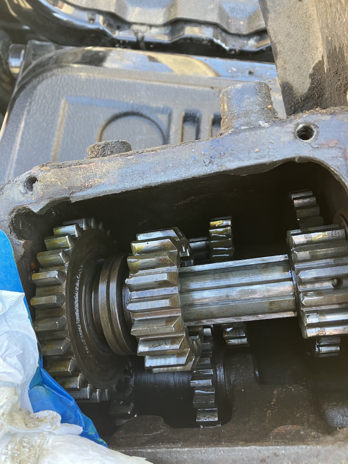

    As promised, a couple of pics. Even though the engine has some issues, pretty sure it ran in the last few years. It had new plugs, a freshly rebuilt water pump(score!), recent points and a modern looking coil. The water jacket has been welded. The fella I got it from said from the bottom, the pistons looked new, but the cam and mains were worn badly. It has a lot of end play in the crank. I need to pull the head and check for high compression pistons, never know. The transmission looks really nice. The crossmember on the trans looks the same as the 28 crossmember that I have.

    Good news! A lot if useable stuff. Really like the fuel gauge. A lot of the engine parts could be useful. Since Chevrolet didn't use a lot of special alloys for their engine parts like Ford did the Chevy parts can lend themselves to fairly simple repairs.

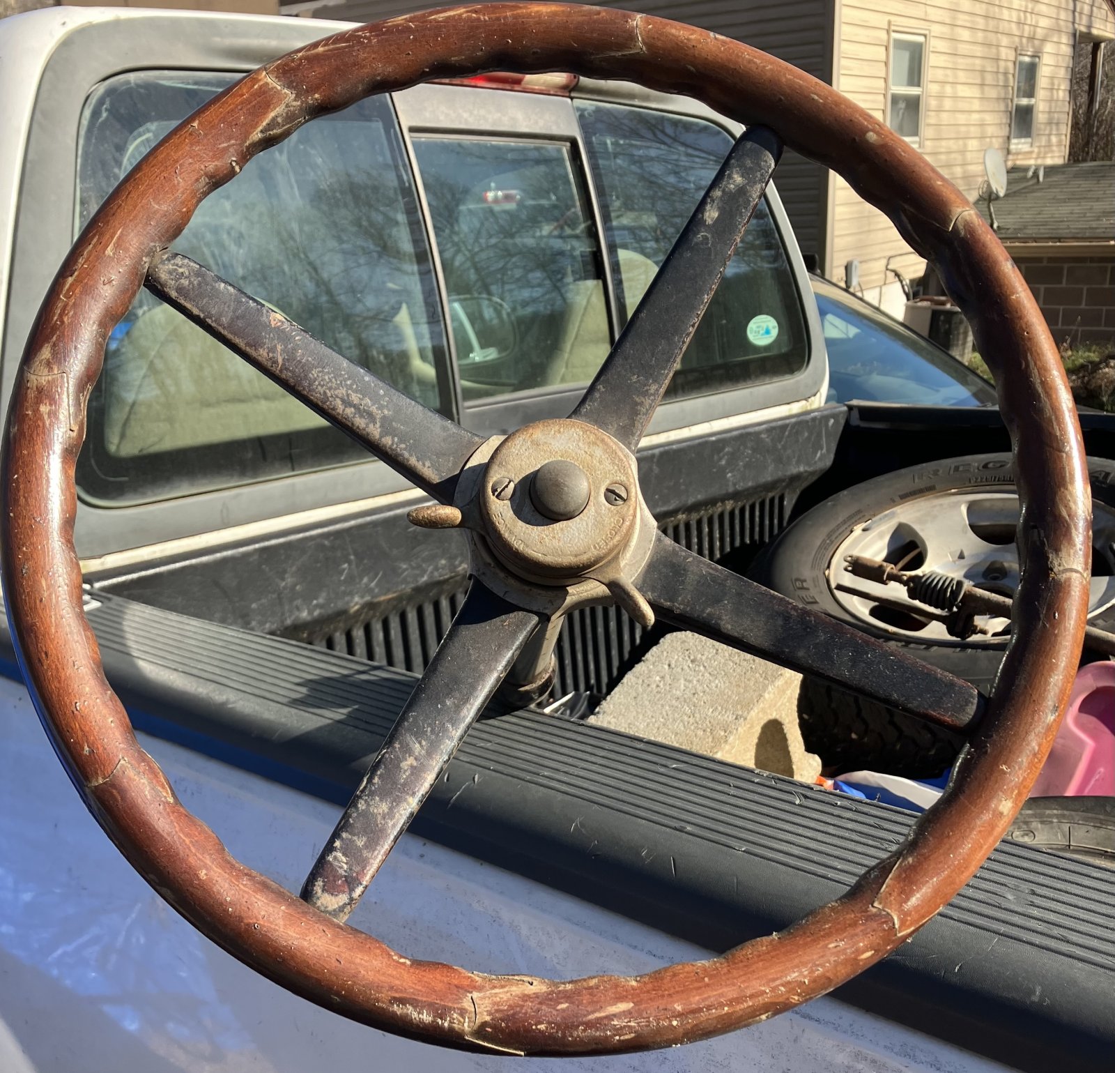

    The steering wheel looks like mine. I've thought of using the levers for a throttle & choke. I won't need a spark advance.

    The steering wheel needs some glueing and a refinish. I probably won’t use the spark lever either as I plan on using a 28 distributor. This load had some really good stuff in it. I am especially pleased with the transmission. I am seriously considering ***embling the ch***is. Fix what has to be fixed and just put it together, patina and all. I would like to put the ch***is together and start thinking about a body. All that is stopping me is a warm place to work. I need about a week of decent weather to clean out and make some room in my “shop” area, but I don’t think I am going to get it. I am going to take about an hour tomorrow and pull the pan and head on the engine I just got and see what pistons it has and how bad the rest of it is. Rear end has 8 leaf springs (sedan I think) wondering if I can move the bottom leaf to the top of the spring pack to effectively get 7 leaf springs.

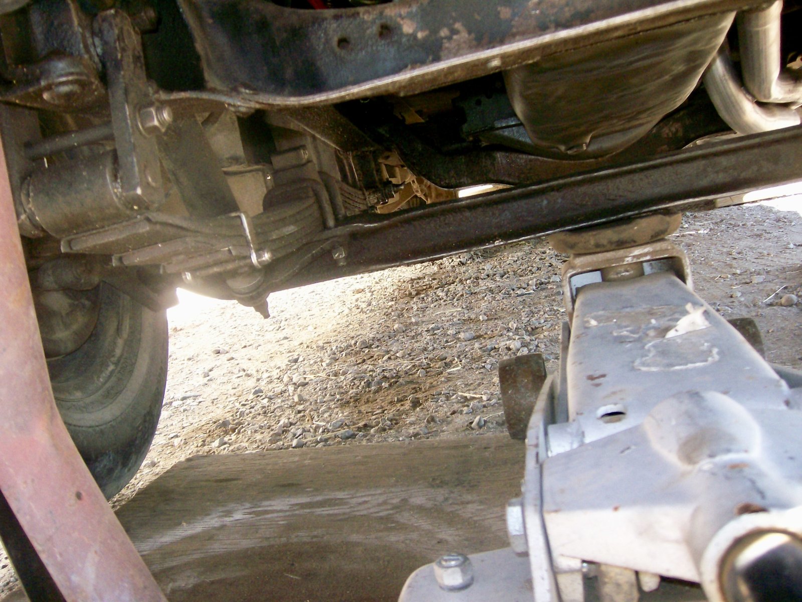

  15. Dan Morrison
    Joined: Jan 20, 2021
    Posts: 100
    Dan Morrison

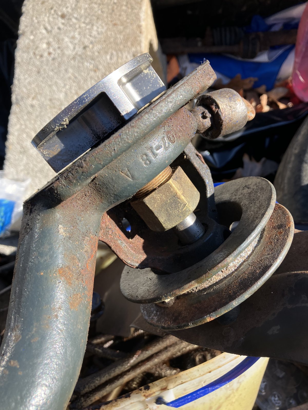

    The front of this is conventional but the way the rear is hung is interesting.

    Dan. Id like to see a better picture of the rear suspension. That is something I'm still throng to figure out. Right now the plan is some sort of 4 link with quarter elliptics being the bottom links.

    "Pop's" Greens' stuff was always interesting, & it worked well. Half-Underslung & leaf springs are in correct position to function as designed. Only theoretical problem could be is if entire spring, or shackles, broke letting frame drop, but it'd be dragging, not digging in as would a front frame-under-axle would.

    That is a Green engineering ch***is from the late 1920s. Here is a crop of the picture.
