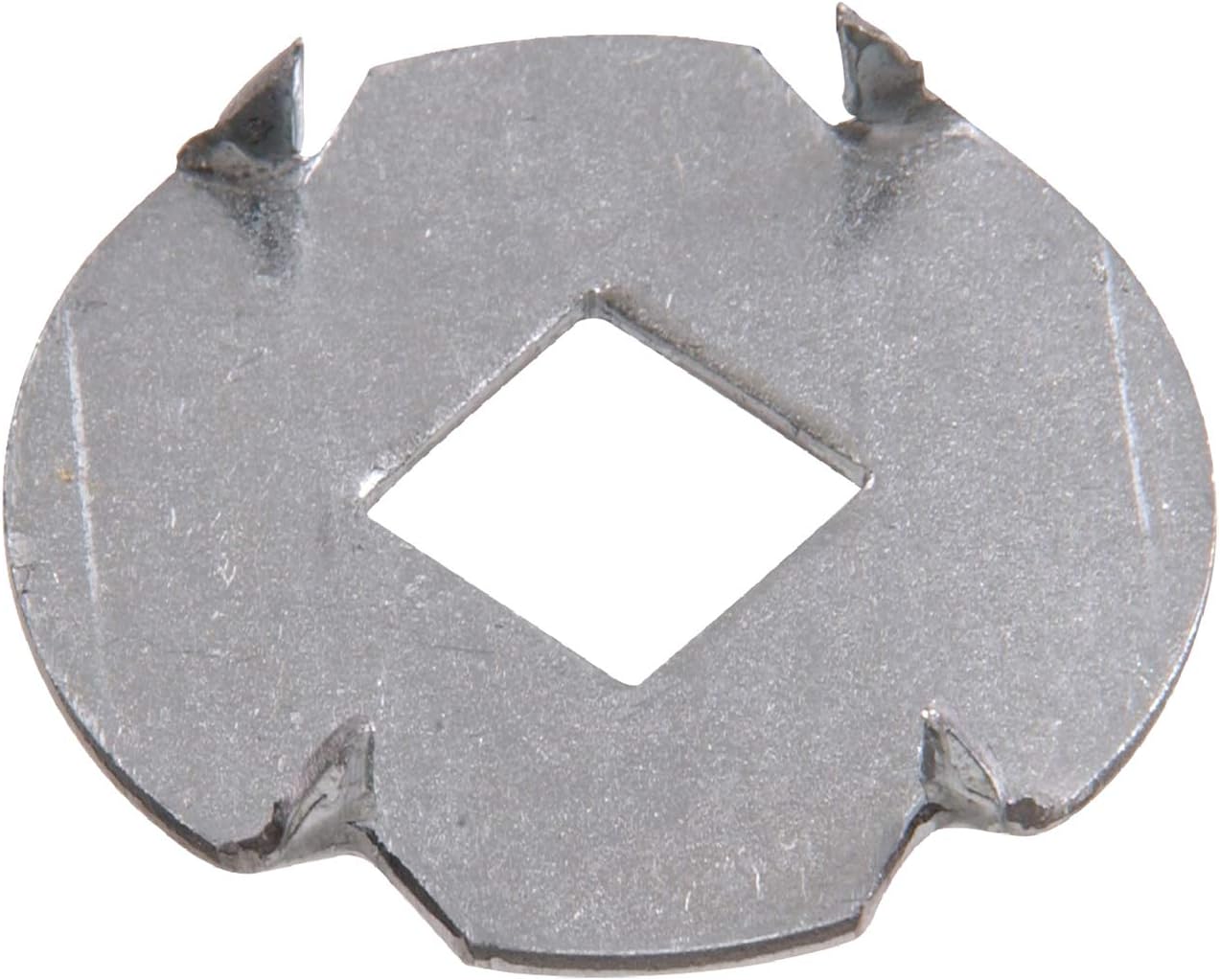

    Looking at my sill it looks like the were bolted to the frame using carriage bolts with torque washers. So far I have not found then in 7/16. Maybe 3/8 or 1/2 will work. I suppose they may have been used in other places.

    Torque washers. So that is what they call those things. I see signs of them on my stuff also. I got a friend out in the shop to make me some crude square ones out of scrap before I retired. I have a small baggy here some place, but do not remember what size of square hole I had him put in them.

    The Home Depot has them online, but not 7/16. I'll check the store next time I'm in Carson. I found some in England where they are called pointy washers. I'm thinking for the few I need the 3/8 might work even if I have to grind the bolts a little to fit the square hole. Maybe use stainless bolts so I won't grind through the zinc coating. I'll worry about that when I get there.

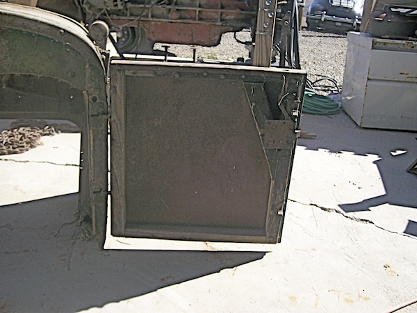

    Still studying the new drawings. I went through the pictures and I don't have any good clear pictures of the #10s & # 11s and I haven't handled them. Here is what I have.
    10 R
    10 L
    10 R
    And GG2s tracing of #10 R (passenger side hinge pillar)

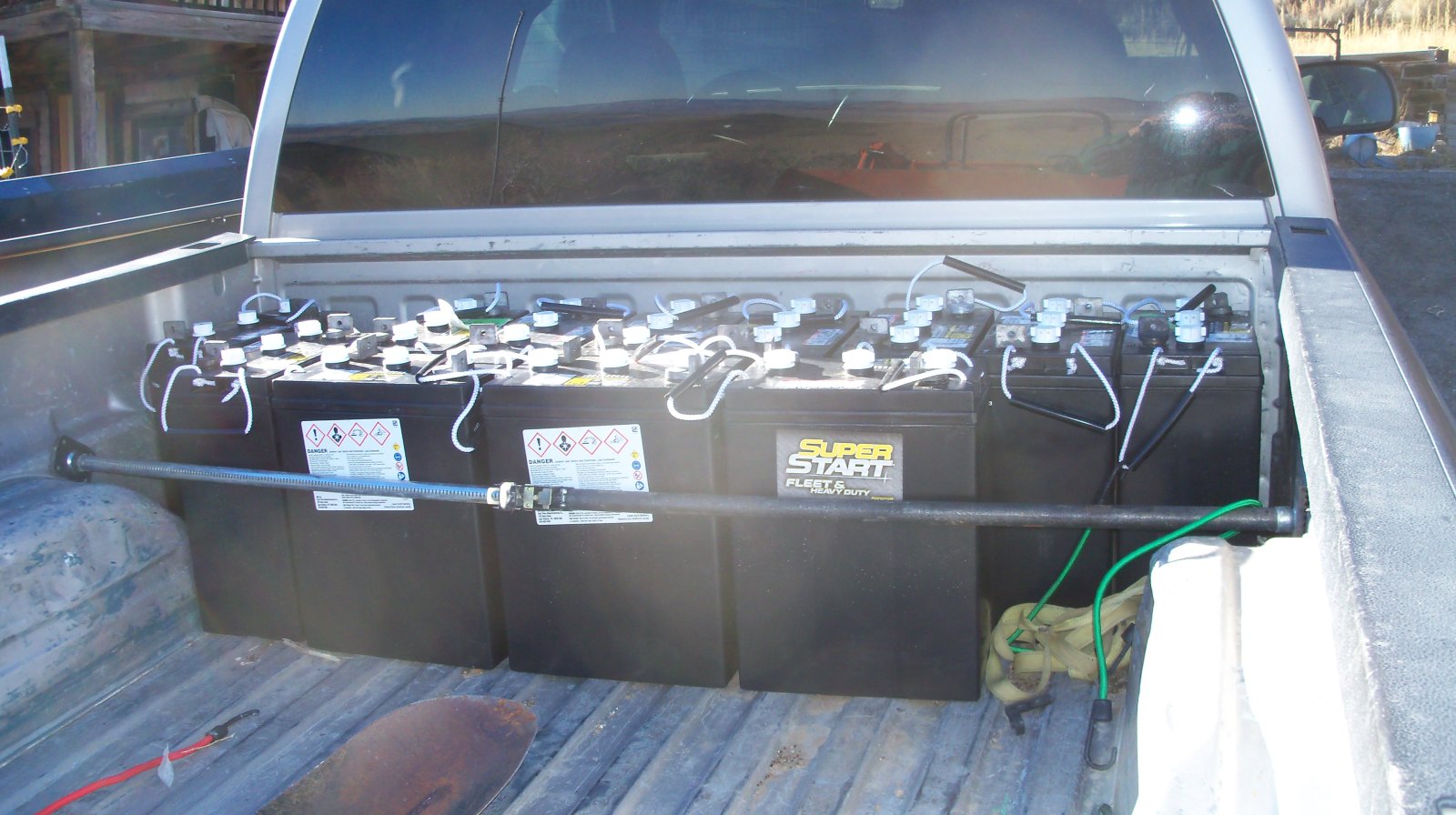

    Done, It took 3 1/2 hours. I'll need the power to run the heating pad and massager. :D
    New batteries in the pickup
    9 of the the old ones still in in place
    All 12 old ones out an awaiting individual testing to see of some will work for the chicken house set.
    The empty box
    The new ones in & working. The toughest part is lifting them in & out of the box as the edge of the board shows. :( 24 batteries @ 115 lbs + 78 year old guy = :eek: Seem to be working well.

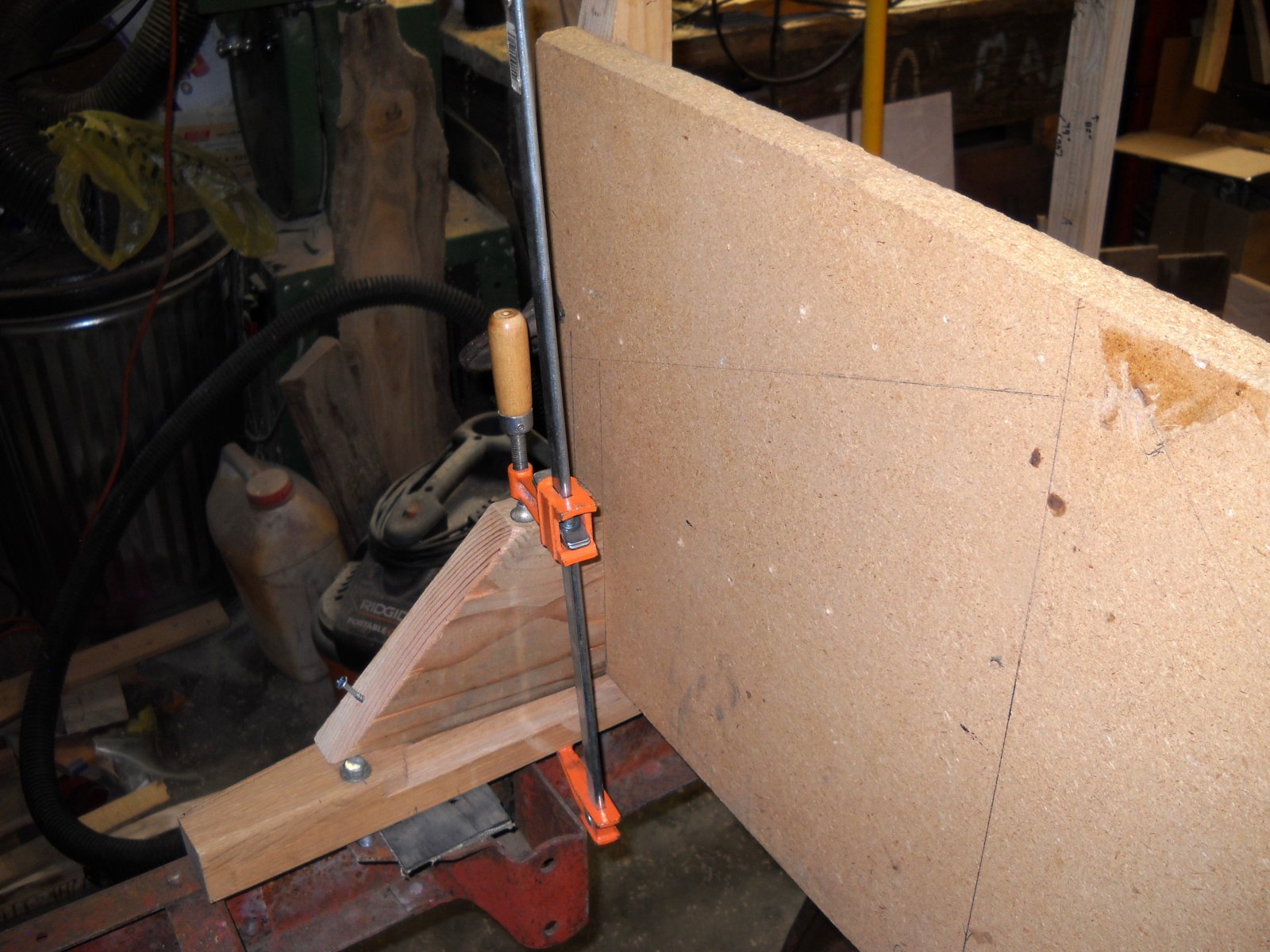

    I took the camera to the shop this morning and got up to date pics. I believe that this is the fifth time that I have put this part together!
    I have a piece of 1 1/4 particle board for my 'backstop' (using what I have) I have it vertical and held by some blocks on the other side. The piece of tin is my 'tilt out' gauge. 1 1/2 degree or marked on the tin 3/8 inch in 14 1/2 inch vertical run. I took a better pic. but disappeared. The tin and partical board are tight to the front side of #10s. I move the tope of #10 out until I see the tilt marks and sand off the lower part of the intersection if needed and reclamp.
    The twist and vertical front to back have already been taken care of.
    One thing that I will have to do before I put in screws and glue is to add a bottom under the sill to hold the correct elevation and also maybe hold some glue in. A piece of tin will do it, and pull it out when the glue sets.
    This is the front side of the 'backstop'. Before I go to drill the screw holes in #10, I will drop these screws into the sill to hold everything from moving
    I am getting pretty close to having this #10l where it will be finished. I did deepen my notches in the sills. 1/4 inch for the #10s and 1/8 inch for the #11s. A lot less sanding, and I think a better connection. The router method worked very well if the two sills are stood on edge together and clamped. BEFORE PUTTING THE 10 DEGREE UNDERCUT ON THE OUTER EDGE! After that it gets tricky but can be done.
    The rest of this fitting will probably done in place with a hand sander after it is glued. You will not have the big notch on the front side like these. I had made a mistake and made them too big year before last.

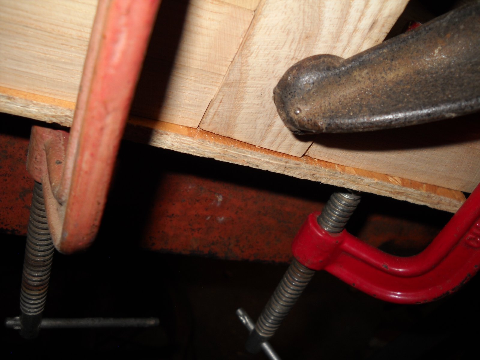

    I spent most of day before yesterday adjusting the angles on #11s. Found out that the front and back are parallel except if the door needs a little angle clearance to open and close. That clearance should be done at assembly of the body just before putting on the quarter panel tin.
    With the adjusted angles to match the drawing 'to be' seem to fit fairly well.

    I missed two pics.
    #11l shown with a small piece of particle board to hold vertically. It is also almost ready. will have to check for rotation, vertical front to back and add the tilt out.
    Doubled up!

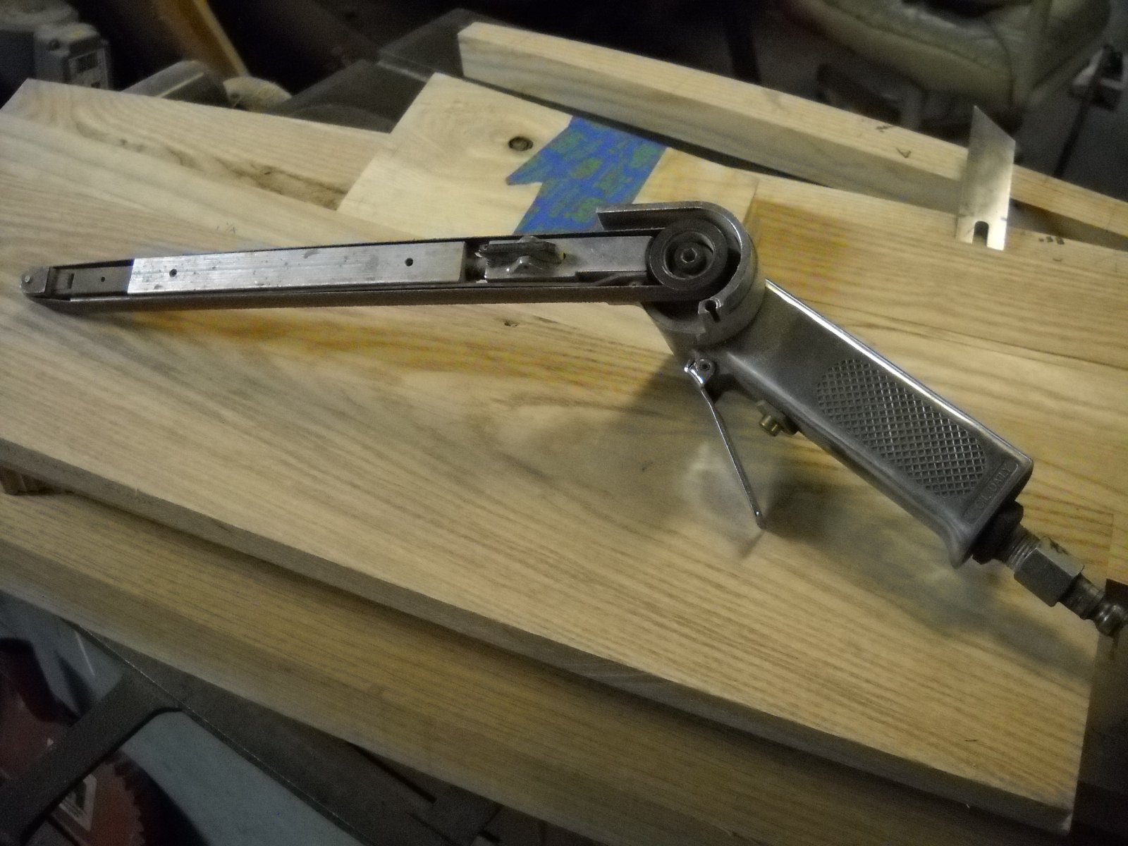

    Mini belt sander

    Air? First I need to find a really good 120v compressor or a 24 v DC one. I could put a DC compressor in the battery shed close to the source with a huge tank and use it for a diversion load when the batteries are full. I could pipe the air to the shop.

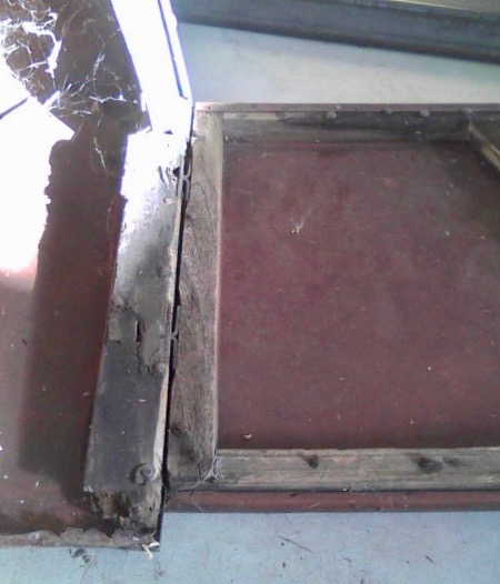

    some of the wood in my model A could use some love but I’m not sure it needs totally replaced. It’s mostly in tact but feels a little soft if I poke a finger nail into it which I believe is not a good thing - not a wood guy obviously- I’m wondering if there’s not a product I could brush onto it or soak it in to firm it up? I feel like I’ve heard of this sort of product in other threads but I’ve lost track of the information.
