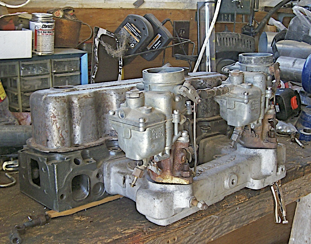

    Wow, some cool stuff going on with this. I like it.
    I'd love to get a set of rockers like that. Are they old Neal Jern rockers or made by someone else?

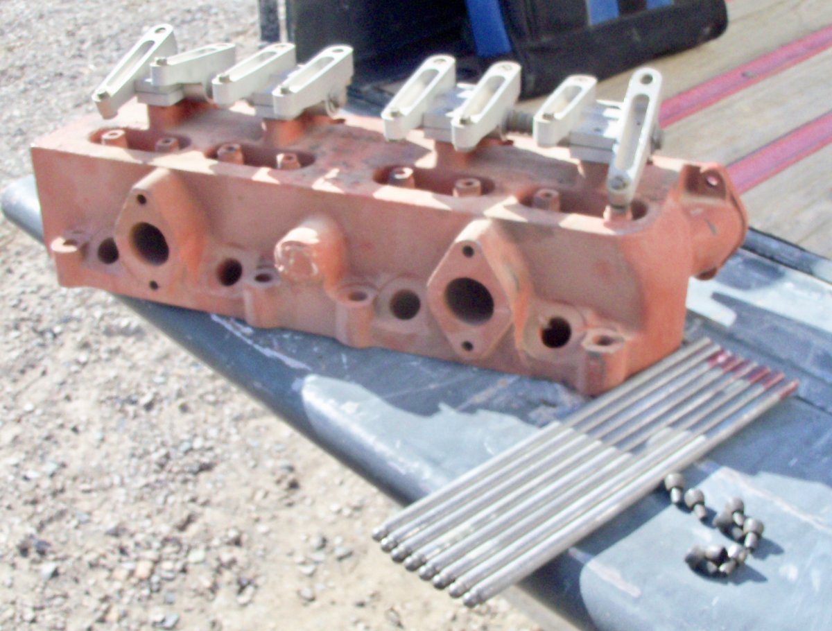

    Thanks. I did point out didn't I that the Olds head is not for the 153 Chevy but the early 171
    The guy I got them from made them. He belongs to a Vintage Speedster club. These rockers were outlawed because they killed the Ford Fours. They are 2 to 1 ratio. I think the reason for that is that there are no hot cams made for these and there is not a lot to be gained by regrinding stock cams. The rockers are pretty simple and could be duplicated by any one with a mill. You could probably play with the ratio as well. They would work on Chevy or Olds heads.

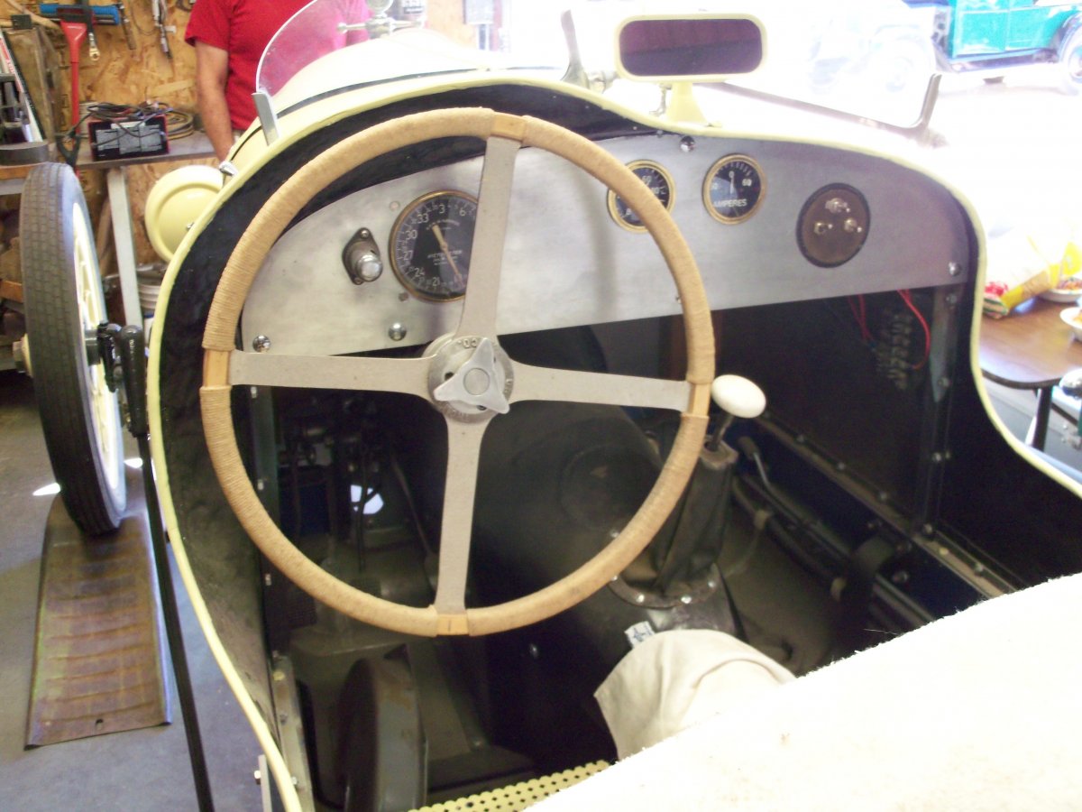

    I bolted the steering column to the frame. It is even better than I thought. A bit of cleanup and it's good to go.

    You are right Mike. Ansen made a head as did Duggan. Ansen made fuel injection and there are Weber carb setups. There are headers and a turbo manifold. Circle track racers used them a lot. I friend had a dragster with two 153s in it. He ran them on one V8 distributer. I actually have some after market stuff that I my uses on another engine.
    A couple of years ago I got stuck on this thing as you can see. I was having trouble finding anyone who could or would do the work I needed for a price I'd pay. In the last month or so I decided get my tools up and running. That took some updates to our electric service. We make our own power and I did some upgrades. Still work to do. I changed the motor on my drill/mill so I can run it and am cleaning it and my lathe and doing some upgrades on them as well. I'll be able to finish some things that I took right up the end of what I could do. I let this stuff bury me but it is coming together now. Hopefully the mill will be up tomorrow and the lathe next week. Too bad the roadster is not the only project that's been on hold, but I'll get to it.

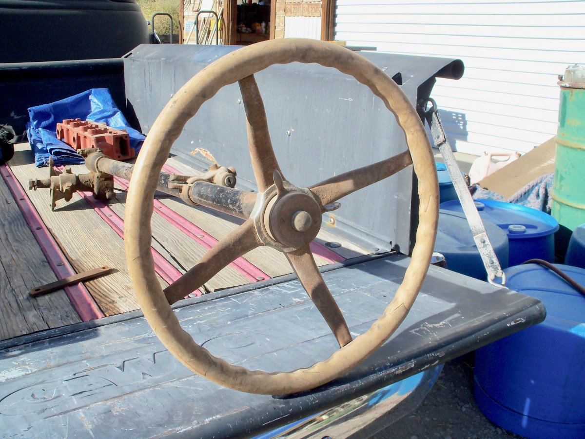

    Thanks for the offer, That's how I got the cowl. We got it here from Texas. Is it just the axle or are other things attached? I have a line on a complete axle, springs, and wheels but it's not Es***. Probably Chevy but that really doesn't matter to me. I would like to find a complete steering box, column, Wheel and control levers like what I found for the Chevy roadster. Pretty sure that won't happen.

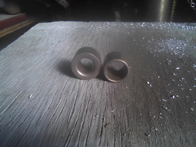

    Baby steps. I found a bearing retainer for the Stude trans that fit the hole in the adapter but I had to drill the bolt holes. I did them one at a time and transfer punched the next with bolts in the one/ones before. It worked well. That is done. I bored the pilot bushing for the Chevy engine to fit the Studebaker input shaft. I busted one by clamping in the vise on my mill. My lathe is down so I took it to my son. We also cut the fuel pump lobe off the cam so #2 rod will clear the cam. That is a hard piece of stuff! We put it in his mill and chipped if off with a carbide cutter and then cleaned it up the best we could in the lathe.
