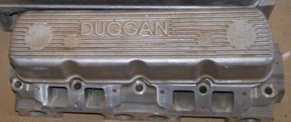

    THE valve cover arrived yesterday.
    It is the one of several others that will be used. I have one of the cute CHEVY ones that has some bad pitting and would require a spacer to clear the roller rockers. There was the cut down GMC that exceeded my skill level, and would have needed an adapter. The Frontenac is a poor casting, too big, and also needs an adapter. The Duggan needs some machining and an adapter. The new one form 12 Bolt Tom is perfect! Quality casting and polish job. It will clear the rollers and bolt right on. I just need to put a pair of old breathers on it and done. I spent too much time fussing with this so I'm moving on. I bought the side cover that goes with it a long time age. At least one of the others will be used on the other Chevy that is emerging from the pile. Oh I forgot the MerCruiser cover, don't like it and it wouldn't clear the roller rockers. 100_2408.jpg 100_1467.jpg 170624_0002.jpg patterns3.jpg
