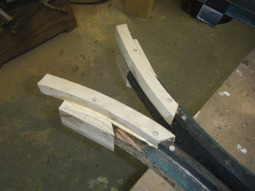

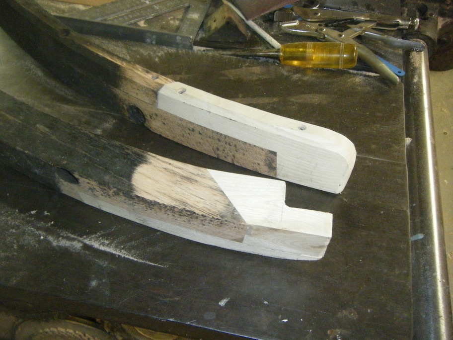

    I said some of this in a PM with grumpy gaby 2 and think it should be here. I had a conversation with my older son yesterday some of which was about the roadster. We spent some time on wood vs steel in the body and decided we both prefer wood. Partly because it's Chevy partly because we don't know better. Between the two of us, my friends, his friends and our friends we have a lot of capability and it's wrong not to use it. There is a lot of good wood in the roadster. It all has to come out whether we use it or not. When it is out we can photograph it sitting on graph paper from several angles. He can load the pictures into his computer and come up with measurements at any point we want. He can also make images of how pieces fit together even if some of that is gone. The wood guys can figure out the proper joints and fasteners. He has a friend with the capability of creating 3-D images from the photos. I have a cabinet maker friend with a wood CNC machine. He said two days ago if there were CAD drawings he could load them in his machine and cut them out. My son's brother in law can do anything with wood that the machine can't. The guy doing the metal work is good with integrating wood and metal where needed. If we put the wood back together we would have specs and measurements that evidently exist nowhere else. At least none of my research or no one else I have found has anything on '25-'26 Chevy roadsters other than what they worked out during their builds. It may be hiding in some serious Chevy restorers shop but I can not find it. We could have it all right here in a few weeks. Even if I end up with steel this wood should be re***embled. It could be it's own thread and might help some others. Here are some pictures showing more of the wood parts I have mostly still on the sheet metal.
    100_1857.jpg 100_1859.jpg 100_1858.jpg 100_1862.jpg 100_1863.jpg 100_1869.jpg 100_1866.jpg 100_1868.jpg
    Need to get back to something close to this '32. I have read on here and other sites of guys replacing the wood with steel and then having wood burning parties. :( 32 chev restoration 215.jpg

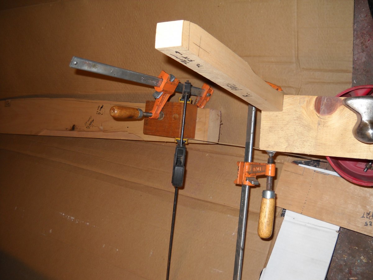

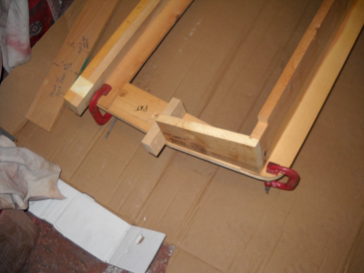

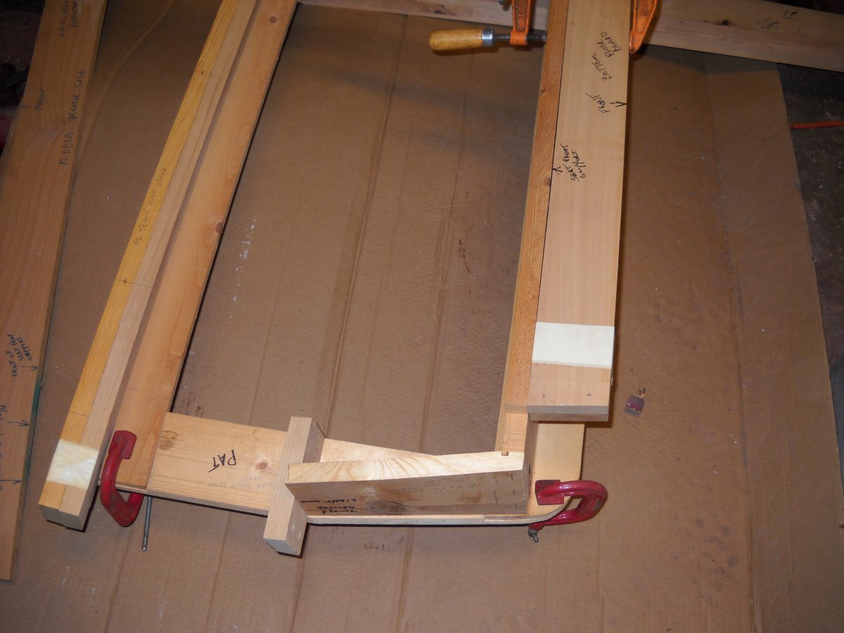

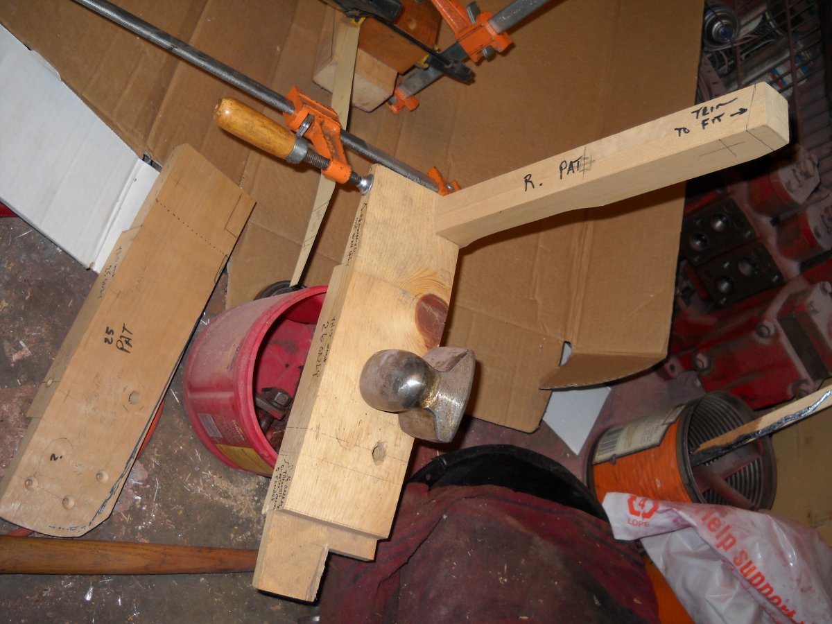

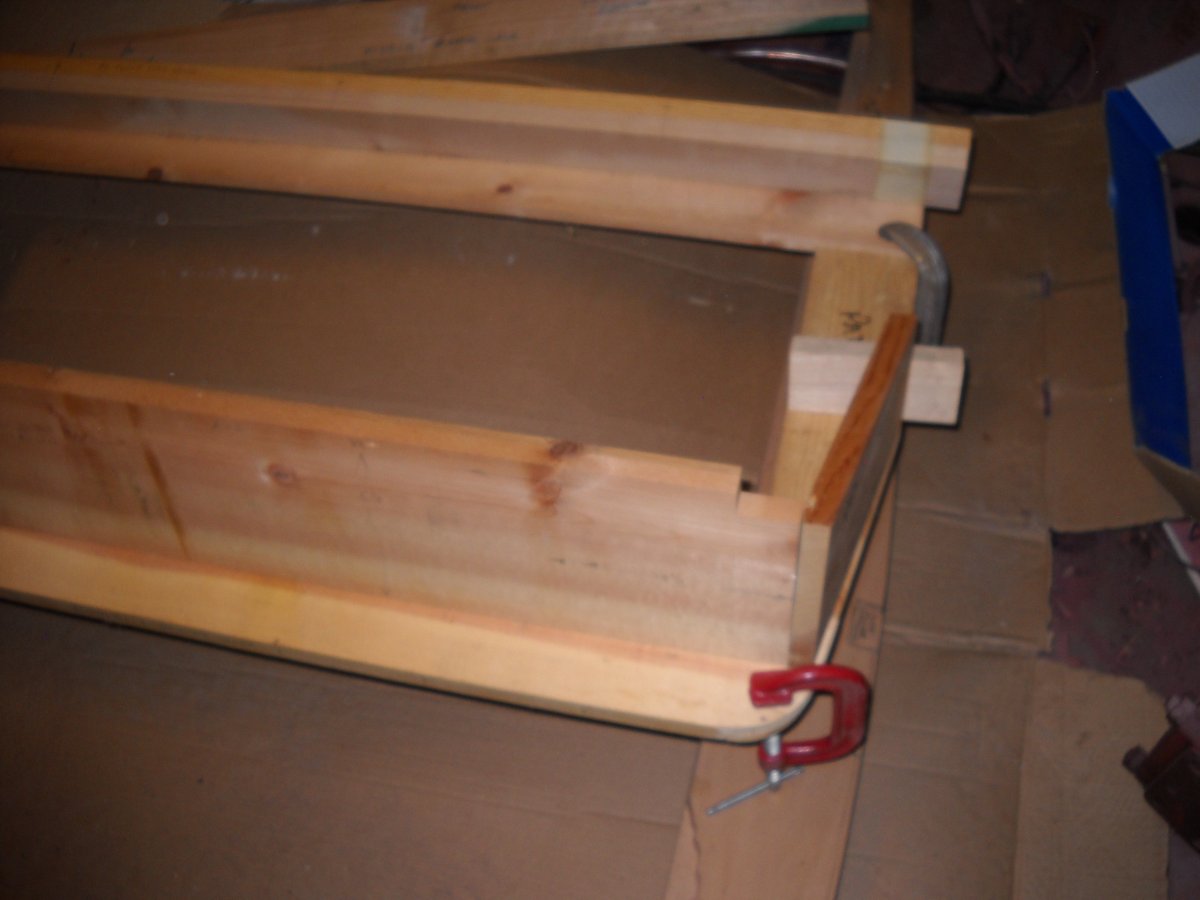

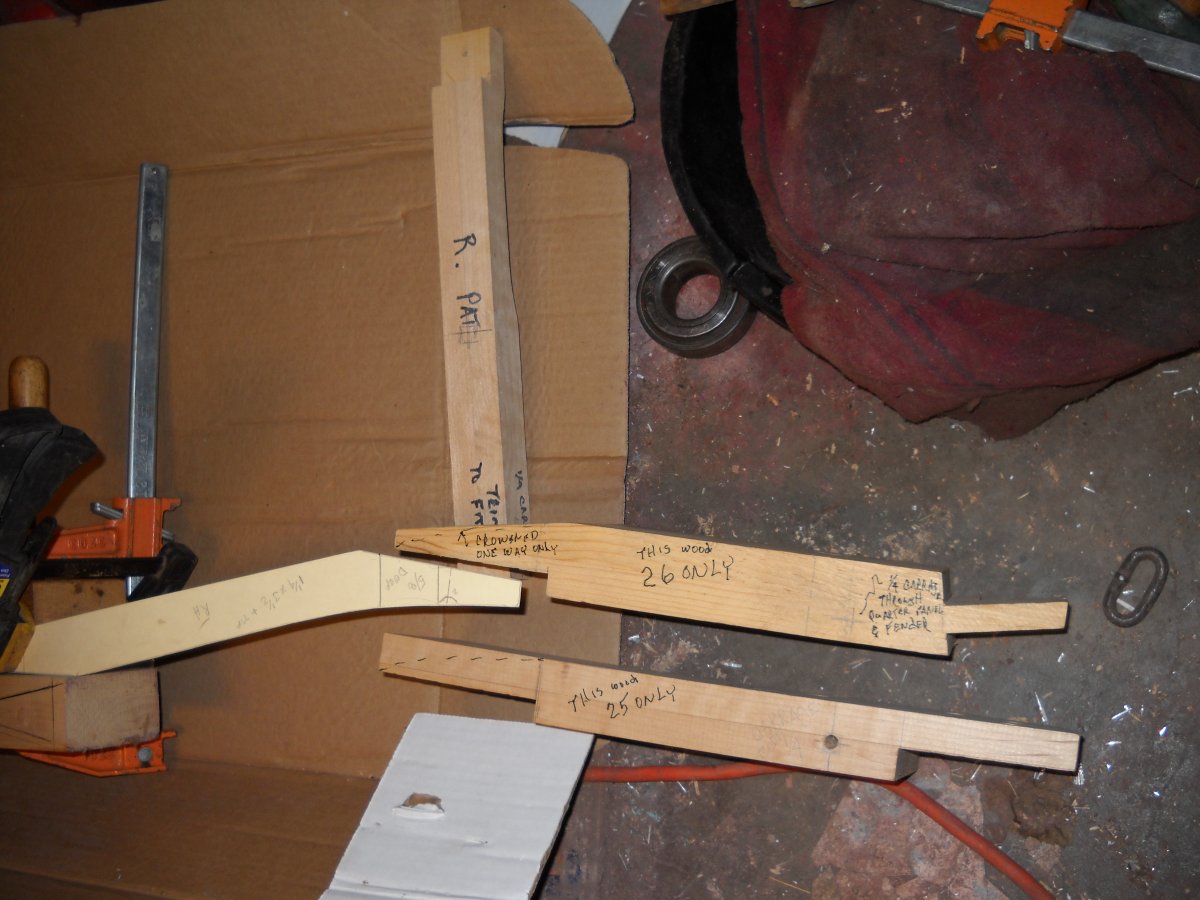

    Got a few more pics today. the first are of the back of the right sill up over the kick up. I did a side view then a plan view. The piece between the end of the sill and the tail end piece is only a 2d piece of card board.
    I also showed what a 25 looked like while I was at it. (pic four is all 25 rear wood) The vertical piece that ties to the quarter panel and fender is upside down in the first pic.

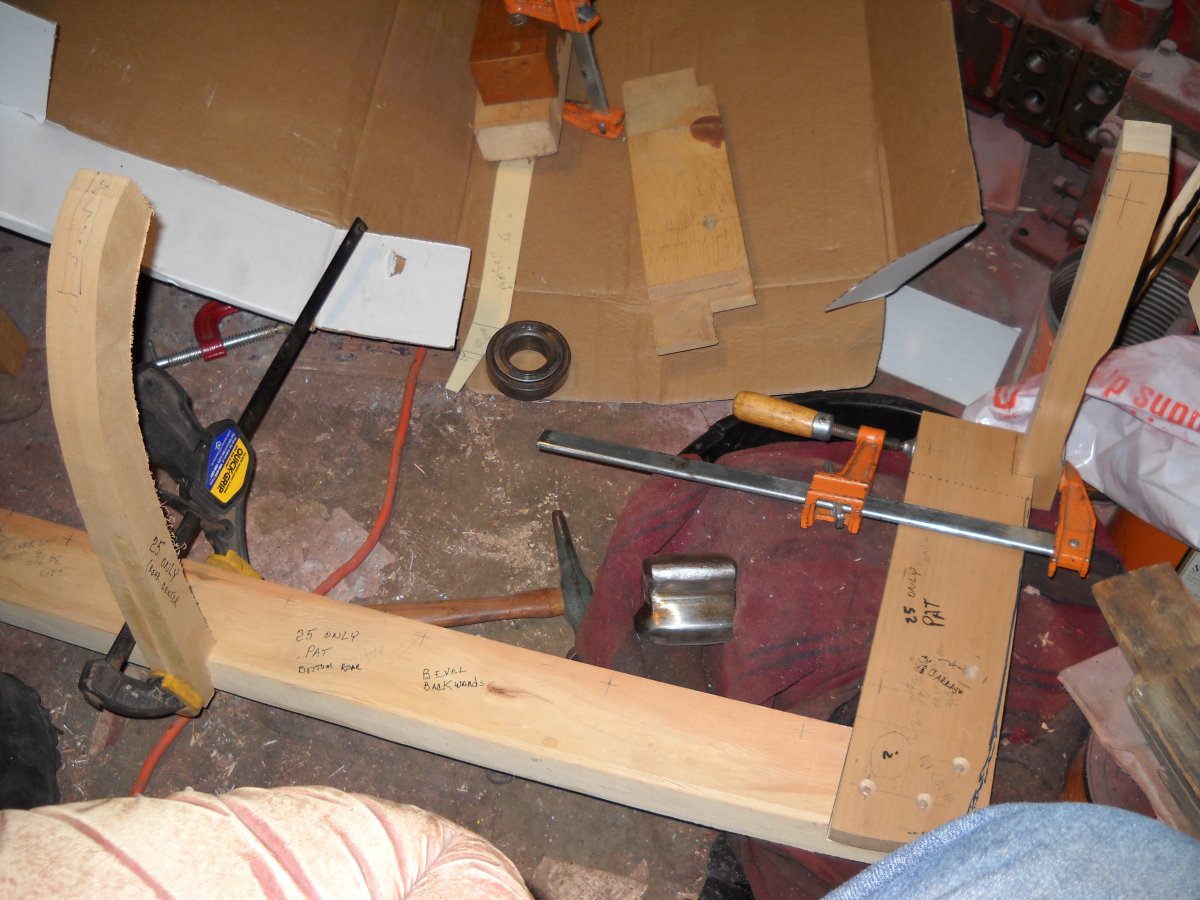

    grumpy gaby 2
    I tried to put together some of the seat structure on the sill, but could not get it to stay with my limited room. So I turned the seat upside down. So think of it as if you are on the floor under the transmition looking up and back at the seat. Disregard the sill.....some dummy just chucked it upside down on top of the car!!! In the first picture, where the little rectangular board on edge with two holes and the redish board on edge come together is the corner where the door lock pillar goes. The two screw holes can be seen in the second picture of the other side. In the last picture, I added the first floor board that is attached to the front of the front seat vertical support. (note that there are two boards there, only one fits here. I did not have both marked and did not want to sparate.) The front vertical seat support sets on top of the sill and is notched to drop down into the floor board relief creating a change in screw direction of 90 deg.

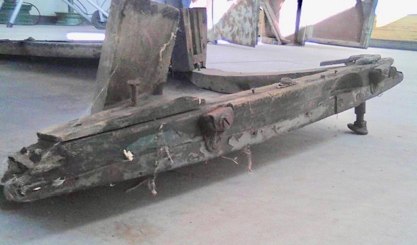

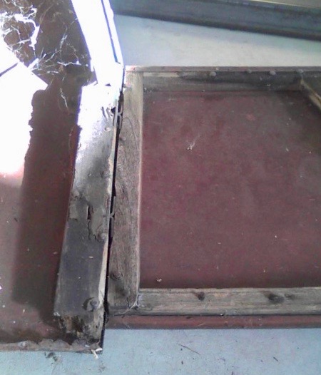

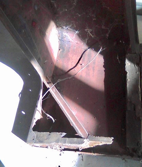

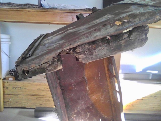

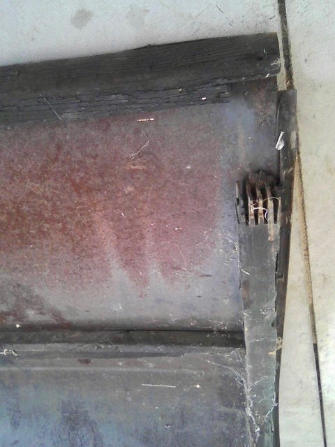

    For starters With Grumpy Gaby 2's help we figured out that my body is probably a late '26 and my frame is a molested '25. The back of the frame has been cut off, I knew that but now I know the body will stick 4 1/2"-5" beyond the end of the frame. Not a problem it'll allow me to build a new rear crossmember. The front crossmember has been removed. I have a '26 crossmember that will work but If I can find a '25 stamped one I can use a cool '25 cast moror mount that I have. I would also like to find a '25 rear perch for the right front spring. Touring20 are you listening here? You have seen some of GG2's pattern pictures. There are some more I'll move over. Here are a few of the shots I took today.
    Bottom of right side of cowl with the front of wooden sill still attached. The brace for the front kick panel is straight on both sides with only surface rust.
    Bottom of left side of cowl with rust that will need a patch and rotten wood but some is good enough to help making a pattern.
    Another of right side and straight floor board channeling wood for front of sill.
    Back of cowl right side A pillar and door front.

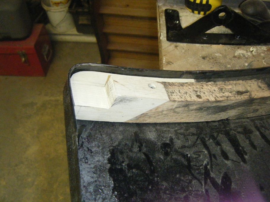

    I read somewhere that one of the early developers, not sure if it was one of the Chevrolet brothers or Billy Durant saw the logo design on some wallpaper in a hotel room and the Bowtie name was soon attached to it.

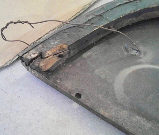

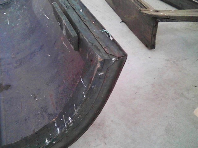

    Here are some more closeups from yesterday.
    The trunk lid:
    The front driver side corner with missing piece. There are finger joints in some of these long curved pieces.

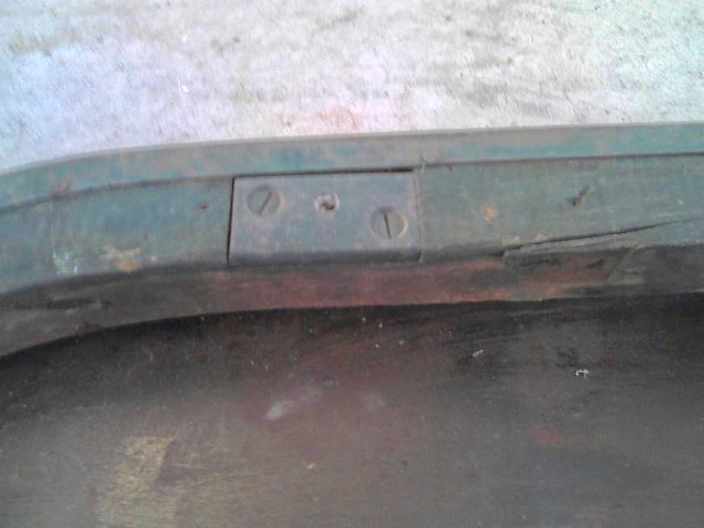

    : 200104_0010.jpg
    This is the same joint on the p***enger side.
    P***enger side again with part of the hinge looking across to the missing driver side piece.
    This is further down the p***enger side showing 1/2 of one of the trunk holder uppers. The cross brace at the bottom is about the middle of the lid.
    Here is the p***enger side lower corner. Part of the seat frame in the background.
    The trunk latch. It sits off center to the right. I think to miss the spare tire bracket that was centered below the trunk.
    The driver side lower corner.

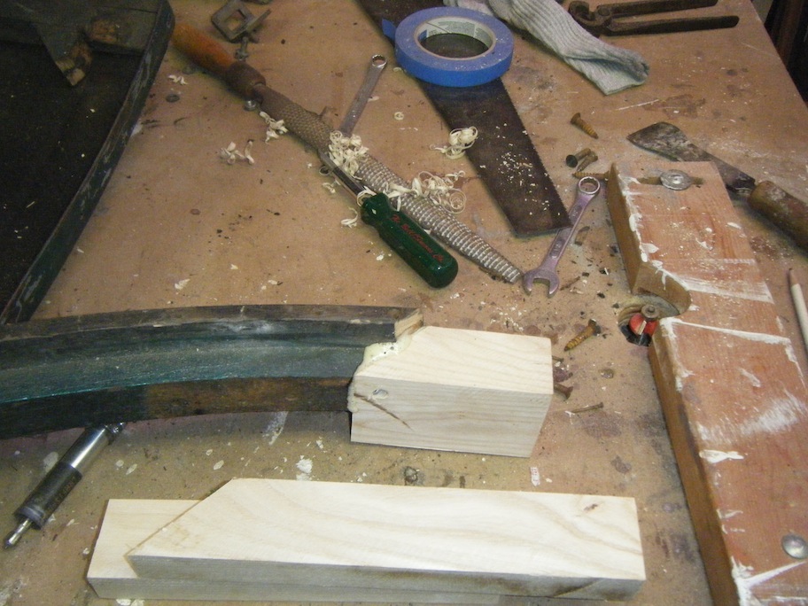

    The main difference I see between '25 and '26 is the trunk area. '25s had a smaller lid more like a '26-'27 T. The wood bracing had to be different. There could have been some regional difference as well because Chevrolets were built in plants all over the country. They may have used different woods and even different body manufacturers. I have read that the open car bodies were not Fisher bodies. That could be why there is so little surviving information. This car was built in Oakland California. It would be interesting to know how it got to Nevada, maybe I'll make something up. :rolleyes:
    Damn! These all look like touring cars.

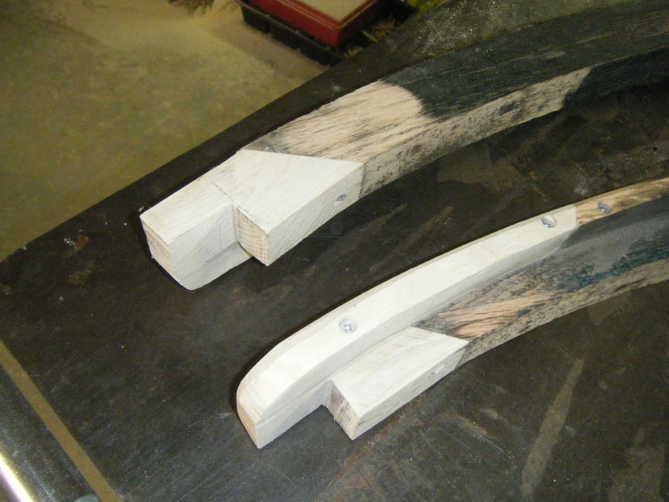

  26. Those scarfed in repairs on the wood pieces above are excellent! Great thread @Six Ball!

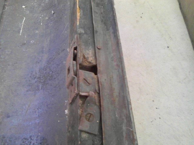

    Top of quarter front of trunk area and rear of p***enger compartment. The large block has a groove/notch that matches one on the other side. That piece ends there with an old cut. there is another two screw plate close to the sheet metal that runs across the notch. Could there have been a metal rod there that went across the back of the seat?
    Front of Quarter with B pillar/door latching and alignment hardware. The metal bracket goes through and is part of the mounting hardware for a top.
    Full B pillar with door alignment tabs and notch for latch. Top mount bracket sticking through. You can see the notch in the block in the back.
    Bottom front of quarter where B pillar fastens to sill.
