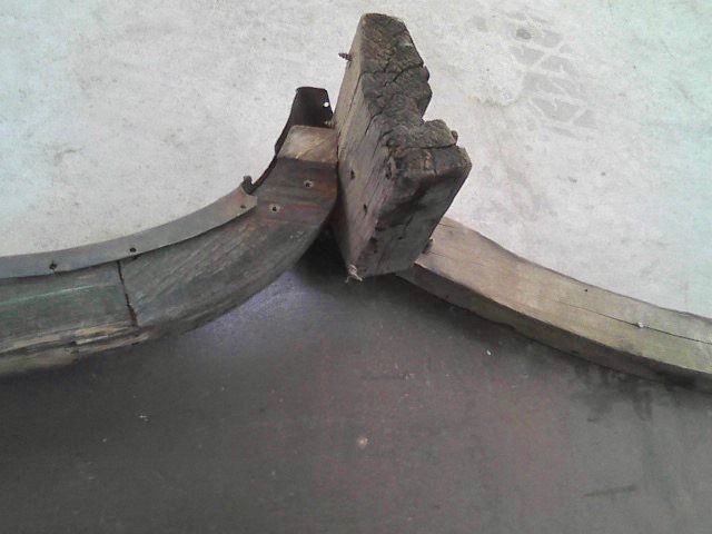

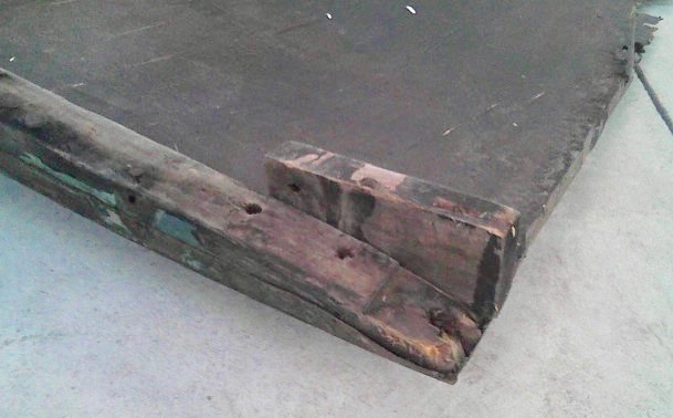

    [QUOTE="Six Ball,
    Well I messed that up!
    Top of quarter front of trunk area and rear of p***enger compartment. The large block has a grove/ notch that matches one on the other side. That piece ends there with an old cut. there is another two screw plate close to the sheet metal that runs across the notch. Could there have been a metal rod there that went across the back of the seat?
    Six Ball and Stogy like this.

    My reply does not show up on my last post, but I go in to edit, and it is there! ??? Anyway. The notch in the big block is where the top support shaft comes in from the outside. (used when the top is down) I am going to use a 1/2" coupling nut welded to a 1/8" flat bar, and slide that into the grove, using four screws. The shaft is 5/8" if I remember right.
    The cut on the end of your block is factory. (one of the things that confused me early on) The other short block (with the seat back half lapped in) mounts to the front of this block, the cross framing for the top of the trunk mounted to the rear of your block.

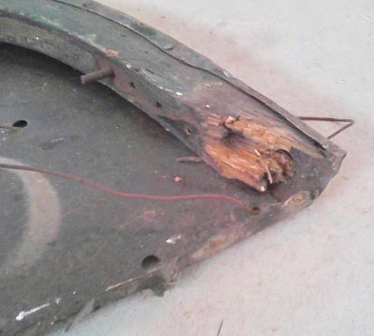

    One way to check is with the tip of your pocket knife, if it goes in say less than 1/16", the wood is probably usable. ( this is only a roll of the dice/ tounge in cheek estimate) In say the trunk, I am thinking that you are right. Besides, the trunk can come off anytime to replace another piece. Same with doors. 'Myself' I would replace the complete front part of the sill (long piece that have the hinge pillar and the lock pillar attached) plus possably all four of the pillars because these are high stress areas. There needs to be a good solid connection between the sill and pillars. Think of rolling into someplace in town like (Micky D's or whatever) the twist as the car goes from street to parking lot. The suspension will take up a lot of this, but most cars will still have some twist.
    The rest of it will be piece by piece.... Just remember that the pieces need to have enough strength to tie together well.
    More close ups of each piece and hopefully I can help with an informed 'second opinion'.
    After looking at your latest close ups, and by lightining up some of the others, I think that I am finding more '25 and '26 differences in the backend. I'll say more when I get it straight in my head......

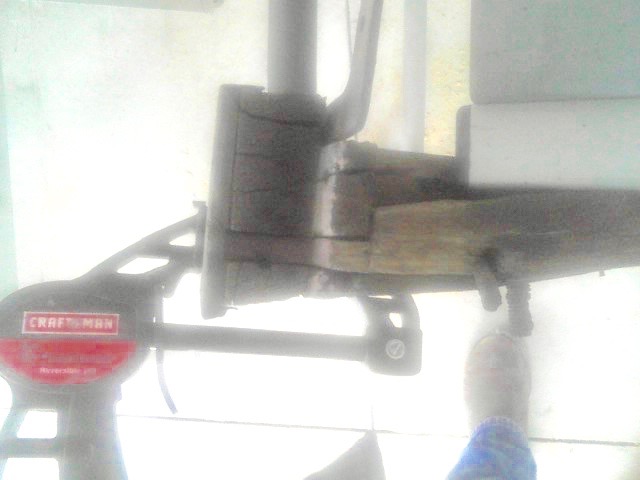

    P***enger side quarter:
    Rear lower where it meets the sill and lower cross piece.
    Same as metal plate as on the other quarter. I think now these are wear guards for where the trunk holder upper thing rides when the trunk is closed. They may have had a rubber bumper.
    Forward is to the left. Broken piece is part of notched block like the other side. I have the rest of it. Piece with hole is from top of B (latch) pillar to back of p***enger compartment. The hole is for the bracket that holds the top when down. Piece on the right is the long S piece from back of p***enger compartment to lower rear sill.
    Top front of quarter with B latch pillar.The 4 screw holes are for the metal bracket and top bolt that goes through like the other side. I have it. Fire damager seen on the right. We almost lost this one!
    Lower front where B pillar meets the sill
    B pillar lookin back

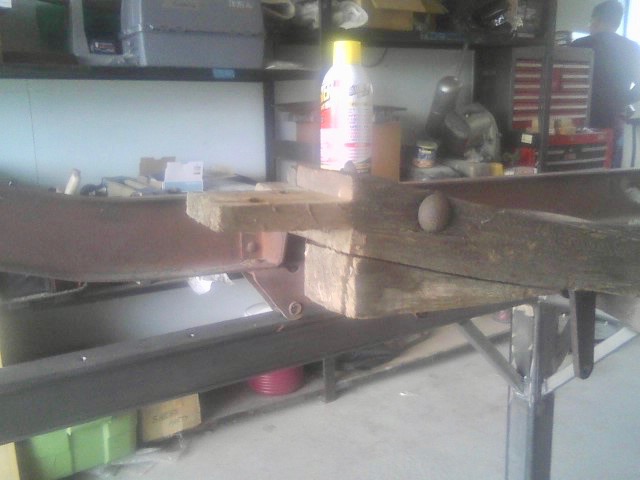

    This is the back end of the sills and the cross piece under the trunk.
    Left rear corner. The hole is the rear mount on frame. The driver side rear quarter fills the space between outside of sill and cross piece with sheet metal on it.
    Right rear corner, mount hole is behind L bracket. Bracket screws to cross piece and Quarter long S piece. It appears to be original and I think I have the other one.
    Side of rear sills showing kickup and how they are pieced with flat pieces. Rear mount bolt still in place. L bracket in place.
    One more right rear corner and length of p***enger side sill. There is the sheet metal piece that fits under the door. The quarter would go all the way to the floor and follow the contour of the sill through the kickup to the cross piece. The front of this sill is the broken piece still attached to the right front cowl bottom. The sills are made of stacked and angle cut flat pieces. There are notches in the sills for the A and B pillars.
    I have a few more small and broken pieces, and some that I don't know the location of. I'm sure there is a can of metal pieces out there somewhere. I need the sheet metal piece that goes under the driver door.

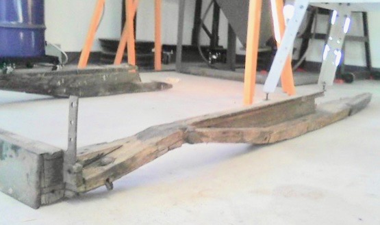

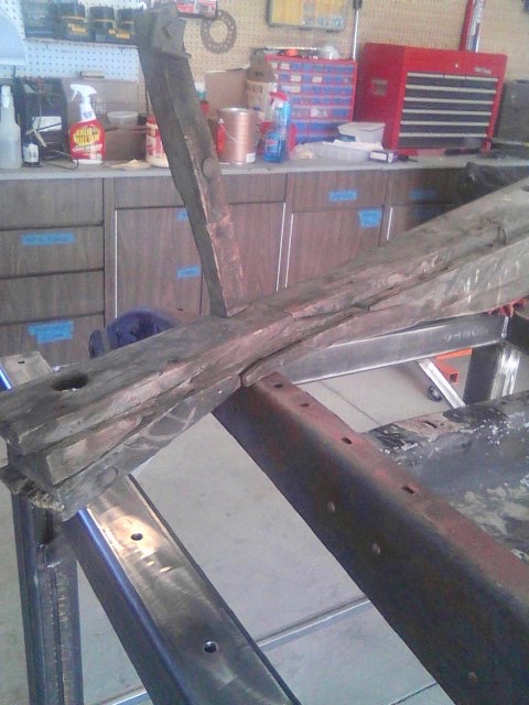

    Posting and labeling the pictures my seem like I'm talking to myself. Well I am. Handling the pieces and trying to figure them out, photographing them, posting, and writing descriptions has given me a place to start that I think will allow progress on the body and frame at the same time so I can keep my "crew" involved. This is kind of like running a small business. :confused: Idle hands are the Devil's workshop and these guys idle hands will lead to no good.:D
    The key seems to be the sills. They are the point where the frame and body meet. The body sheet metal wraps around the outer edge of the sill and is nailed to it. So the outside of the sill is the shape of the body.
    There are mount holes in the sill that locate the body on the frame. As built the frame is mostly narrower than the body. I want the frame and body contour to be the same from the front of the cowl all the way back. To do that the frame will take some cutting, bending, welding, and a bit of lengthening to make it come out right.
    That will change the relation between the mount holes in the sills and the frame
    Here's the present plan. I will use the old sills as patterns to make new sills and bolt them to the frame. Then I will make cross pieces to build what Ford guys might all a sub floor. Check it, measure it, make sure it is right and gives me the curve I want for the body frame contour. It will have to include building over the kickup all the way to the end of the body.
    Then we will shape the frame lengthen the existing cross members, build a rear crossmember and what ever else needs attention. When the frame is the right shape and length we can start on the suspension and mounts etc.
    When the frame is the right shape I can put the sub floor back on and see where the mounts line up and make any other needed changes. That done I can use the sills for patterns for real sills and begin the new wood body frame construction. This way the build can go on in two places either in one shop or two until we are ready to put the body on the frame.:)
    What do you think?

    I hope other people chime in, I don't want to be the only one to give an opinion. I do think that you have a good plan to keep going on both body and frame. The only reason to tie up your frame is to provide a structure for your body building, a good subfloor should do the same. (You do have to keep your crew busy!) Remember that the sills are narrower on the bottom than the top, body kind of tapers clear to the frame level. I will also be here har***ing!
    I have found that I have had some misconceptions of the '26 body. When you commented about having most of the floor wood, I thought to myself, ok, there are only 2 or 3 pieces. When you said that the rear cross wood had a grove in the top (rabbit) I'm going, what? But when you posted your last few pictures, it came all clear! The '25 has several sheet metal floor pieces and goes up and back down with the sills. The '26 has a level trunk floor and is wood floored!
    Makes since, You have a big opening now, so make a usable trunk..... I'll bet that this was used as a big selling point against the model T.
    Here are some pics I took this morning, The big piece of wood is the one for the back. This is something I put together 20 some years ago. I just could not figure how the tin floor was going to work. The old piece of wood was the only piece that I had of that area. I also could not figure out what that notch that the pencil is pointing at was for.
    With your last pictures, it becomes VERY clear. My back wood is only off from your dims like 1/8" one direction and 1/4" the other, and the length is right on at 39" between the S pieces of frame work.
    When you measured your rear piece, was it a true rectangle or was the bottom angled down like I have my square?

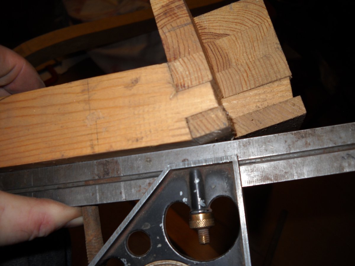

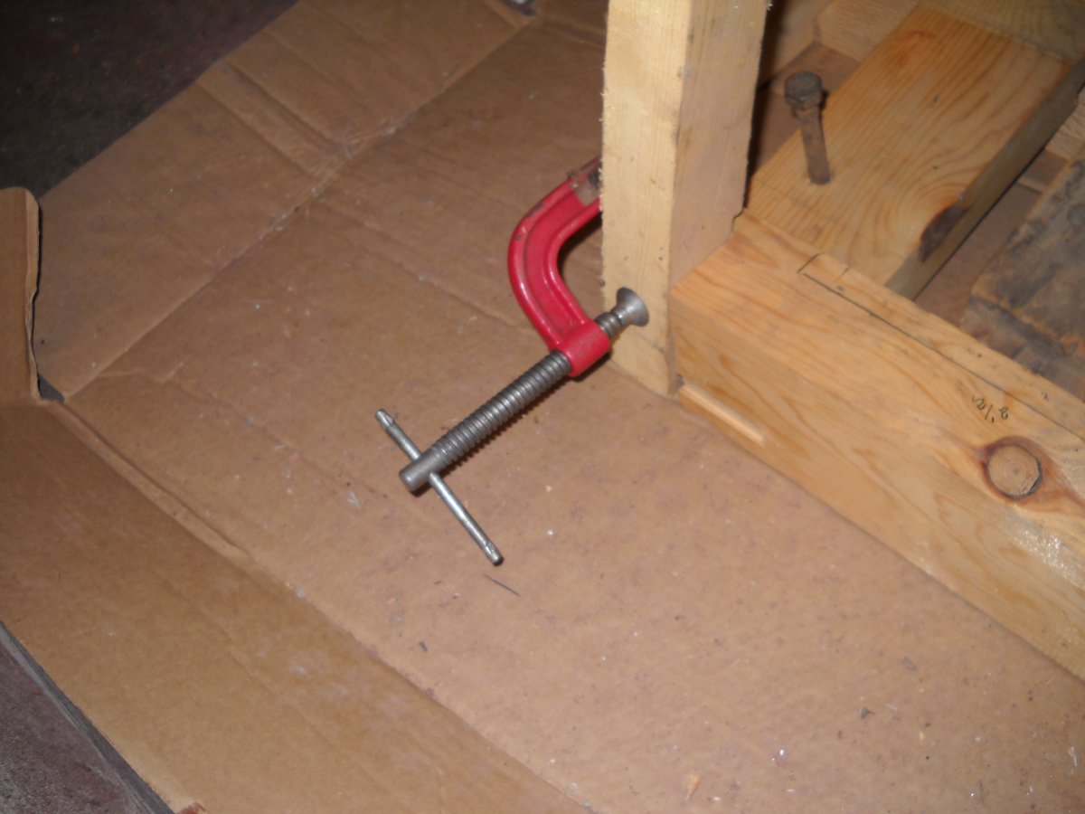

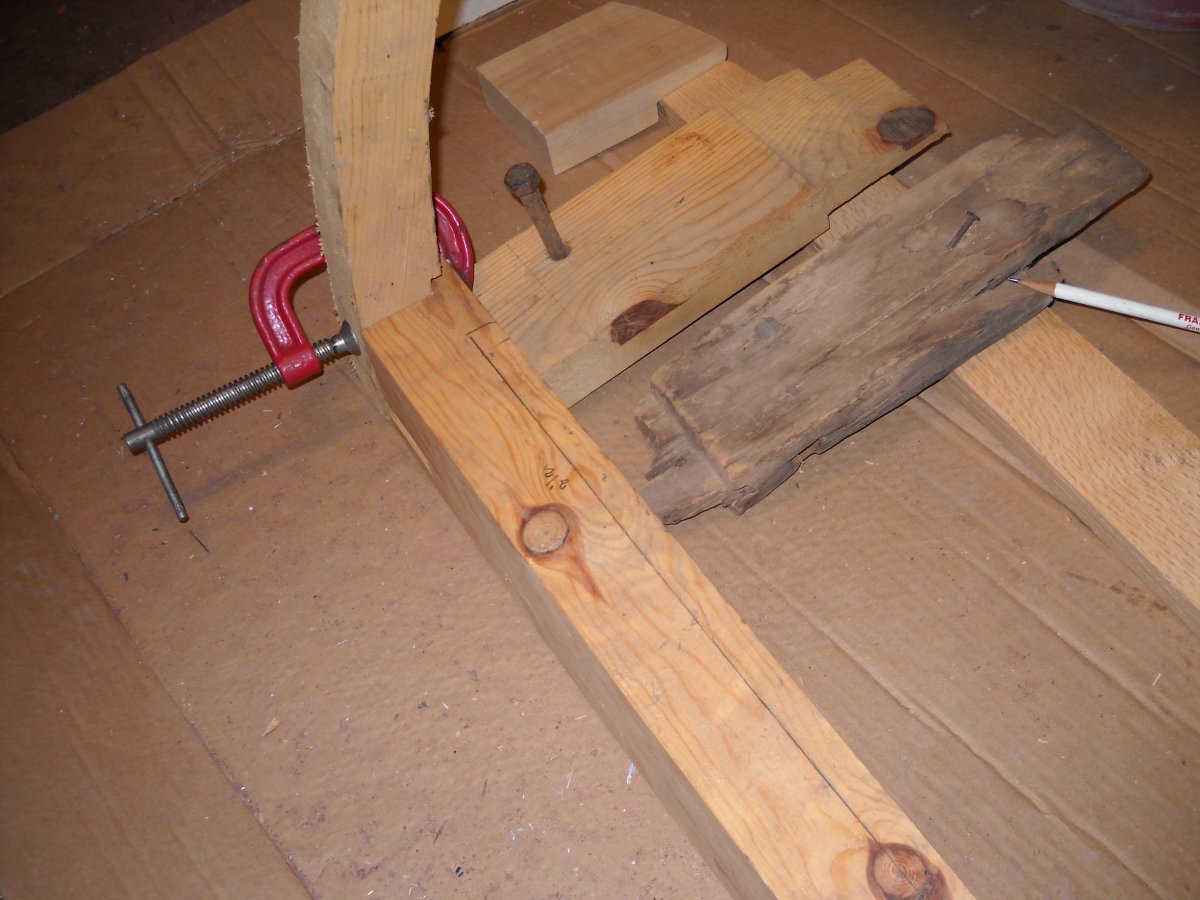

    For the patterns I started out with pine, I had some. (pine will shrink a little over time) Later I started using alder. I had bought a hole bunch of it to use in my '26 coach. Then I found out how fast that it rots. So now I have all kinds of pattern material. Unless you are an excellent wood worker, do not expect to get each pattern correct the first time. Start out with the right thickness of sills, I cannot say this enough. If the sills are off the whole rest of the body will be off. You will need a 12" portable planer. Beg, barrow, or steal one. Someone had a list ( might have been the rusty Bowtie) of what is needed for tools. They do not need to be fancy, but you will use all of them. I would also add an angle square. Granpa's wood handle, br*** lever, and rotating blade works great. (or two rulers bolted together with the short ends rounded works too).
    Once you get to going good, I have found that when you get a pattern correct, it's easiest to go ahead and make the other hand, and the final piece in the correct type wood. (leaving the connection points a little proud, on the final to use piece.) It is easier than trying to remember the setups for latter. Write down all kinds of stuff on your patterns. angles, distances, fastener sizes types locations.
    Check your old wood for type, I have found that the sills, pillars, and other high stress areas used a harder heavier wood than the other areas. This is another thing that I have written on my patterns.
    Before I forget, If you have posted all of your closeups, then you do not have enough. Also you need closer up close ups. With a digital it is easy now. I'm guessing about three times what you have. (I've learned this from past work, the picture or dimension you did not take is the one that you'll need. Sometimes you can surmise from several other angles that were taken.

    I have found that cardboard like cereal boxes, poster card or backup cardboard for large packages of paper (single layer) work well to take tracings off of the sills. Lay cardboard down, sill in normal posision, trace around the bottom. This gives you the smaller width. Lay another cardboard down, sill on top inverted, trace. Make sure to mark any cut outs, holes, etc. This gives the larger width, or top width. make sure that these two patters are marked so that they can be lined up lengthwise when transferring to the wood. Cut out the cardboards, one side up is for the right sill, turn both cardboards over and you have the left sill. I won't tell you how long it took trying to transfer board to board before I realized this! If there are some missing areas in one old sill make the cardboard for both sills and fill in the missing area.

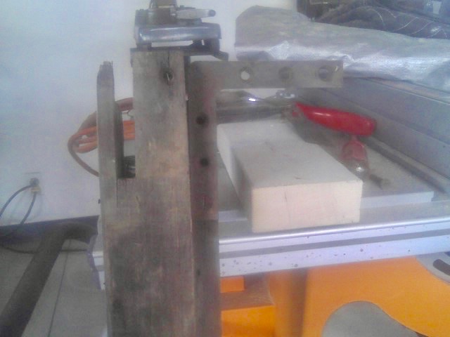

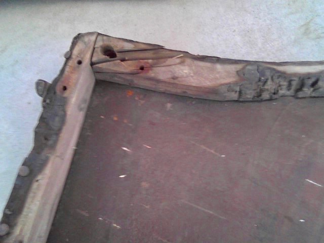

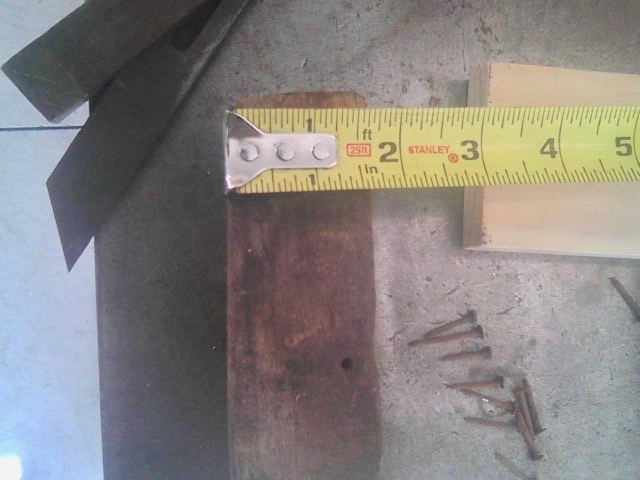

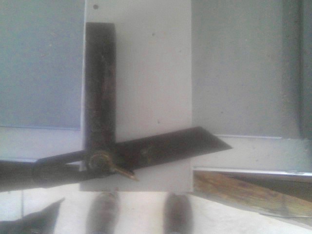

    I spent most of the day with the roadster. I removed the sheet metal from the back piece and then removed it from the sill. It is angled as GG2 said. I also clearly see that the sill is angled on the outside to fit the body angle. I was able to set the p***enger side quarter on the frame and confirm that it does match the frame kickup. I figured out how the wood and metal pieces that go between the top of the trunk lid and the p***enger area. Way different than I had thought. There are two rather thin pieces tacked together with two flat metal pieces. I think they straddle the blocks at the top of the quarters in the p***enger area upper back. The thickness of the sill front main piece is 1 3/4". There is apiece missing in the cowl foot but I can work around it. I set the p***enger sill on the frame. All mount holes line up. The notch for the B pillar lined up with a mark I made on the frame from the front of the Quarter.
    I took a lot of pictures but most of them didn't come out well. The shop door was open and there was too much back light. In some there looks like something was on the lens. So lucky for you there aren't pages of pictures. I'll have to retake those. My Idea of making a sub floor the shape the frame will work. I think that is the next major step.

    Looking Good! Is that one of your helpers that needs to be kept busy that is holding the quarter? Yep that is the angle square, handy as all get out! Checking fits, getting up close to your wood frame. ( I had an old spinster lady for a typing teacher in high school, who said, get up close and 'make love to that type righter!!!')
    As far as the seat top/top of trunk opening wood, You have that right about not going the way that you thought! The only reason that they did like they did, that I can think of, is trying to get the best strength per pound of wood used, and fast ***embly in the factory! You have it correct for location in your mind now!
    I'll recheck my sills again, but 1 3/4" thick seems 'to standard'! Is this the right hand sill? Before cutting a pattern, recheck thickness with another tool, like an adjustable depth square (like the one I showed in my last pic. or a thickness gauge. I've got a real cheap one for the planner check)
    What board are you checking in the last picture that I read just under 1 5/8"?

    Another tidbit. The notches in the sills for the A and B pillars are not vertical on the back side. So Make sure that you mark the back side of the notch on your cardboard for both top and bottom. (this would be another area to use gramp's angle square to 'second check' the backs by angle. Check, trace the angle on something to come back to, or convert it to degrees and right down.)
    Another thing, You probably already doing this, but put the center line not only on your frame, but also the sub floor, body parts as you go. (I'll shut up now!)

    The last picture with the tape is the sill but the angle doesn't give the right reading. I will recheck it all before starting. A good spot to measure is where the wood is like new under the sheet metal piece under the door. It is the right sill
    If 1 3/4" is right I may go with demential lumber for the subfloor or even plywood. It is for use in the short term and I mostly for shaping the frame to match the bottom outside of the body contour and then relocating the body mount holes to the new real sills. It deals only with the bottom dimensions of the sills and back piece It will likely need to be lifted on and off many times. It will have it's own set of issues but will allow the build to continue on both major components and not rush either at the expense of the other.

    I got to thinking as I was driving today. I know bad thing! I had a brain fart just now and had to erase three lines of worthless ideas!!!!!
    EDIT: My bad idea was why not turn the subfloor over to use for the body...doesn't work, kick up becomes kick down!!! Then I got to wondering how to keep the holes, curves, kick up in the same place with the subfloor. Simple comparison... If you have ever put the silverware in the drawer, notice that the s****s do not stack straight up. with the thickness of each s****, the top of the pile moves endwise. That is what is going to happen with anything with thickness if you try to use both sides.
    If you consider the body as a + and then the frame as a -, the subfloor built to match the body will be a + (for modifying the frame). The subfloor to fit the body will have to be a - because it is mimicking the frame. You will need two subfloors. Fastest way I know how to do this would be build the + subframe, then turn it over and build the - subframe on top of it. Turn both back over and you have it. One for frame one for body. Or can you borrow a '26 frame for a few months!?
    Anyone else willing to chime in? I know that my ideas are not the best.

    I try not to think when I drive, I'm the guy in the next lane singing. :D My sub floor was to get the body line to the frame and see where the mount holes in the frame end up. They won't be a lot different. I may need to put new holes in the subfloor(sill) or new holes in the frame. Then toss the subfloor and build the body.
    The cabinetmaker suggested making the sills from a new type of plywood. He could make a glue-lam beam and cut the whole sill out of it on the CNC machine. Ups, downs. tapers, angles, notches, holes, etc all in one swell poop! That would probably work and then use real wood for the rest. But would it be right?
