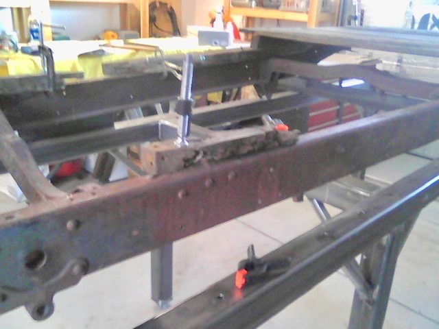

    The bent frame horn got straightened today, the new spring bushings and bolts came, and I think I found the one missing piece of sheet metal. I'm following up on it now.

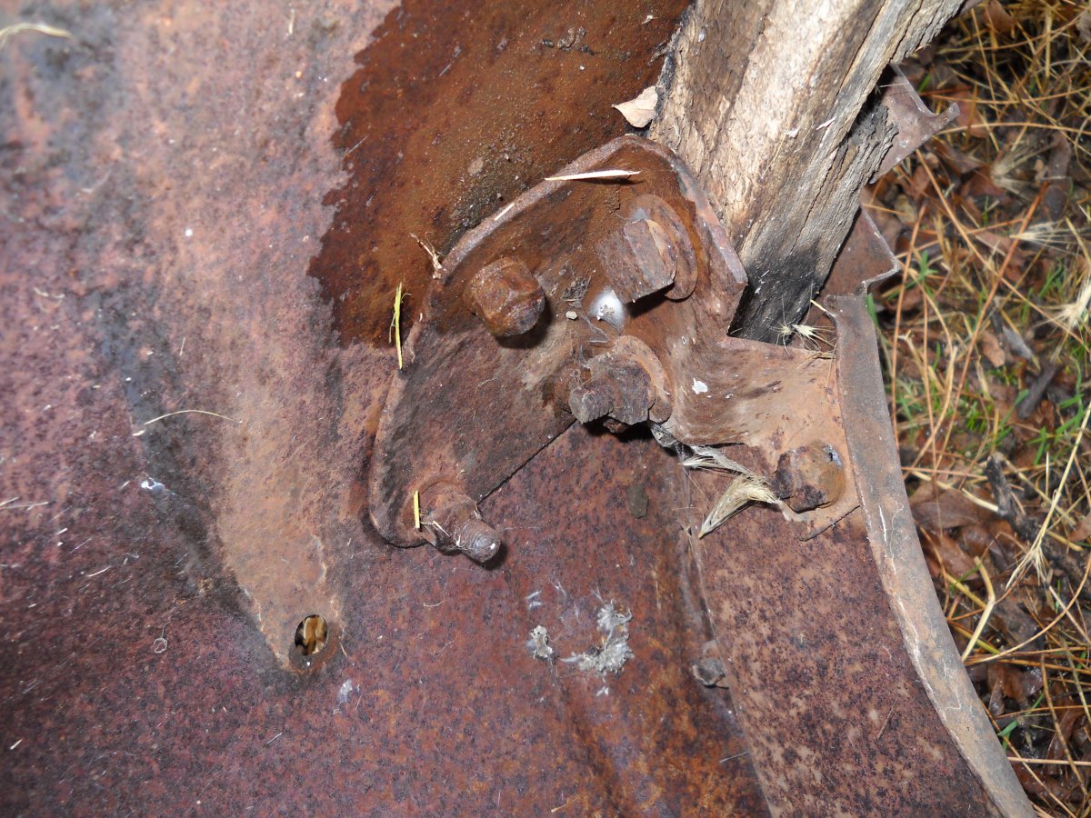

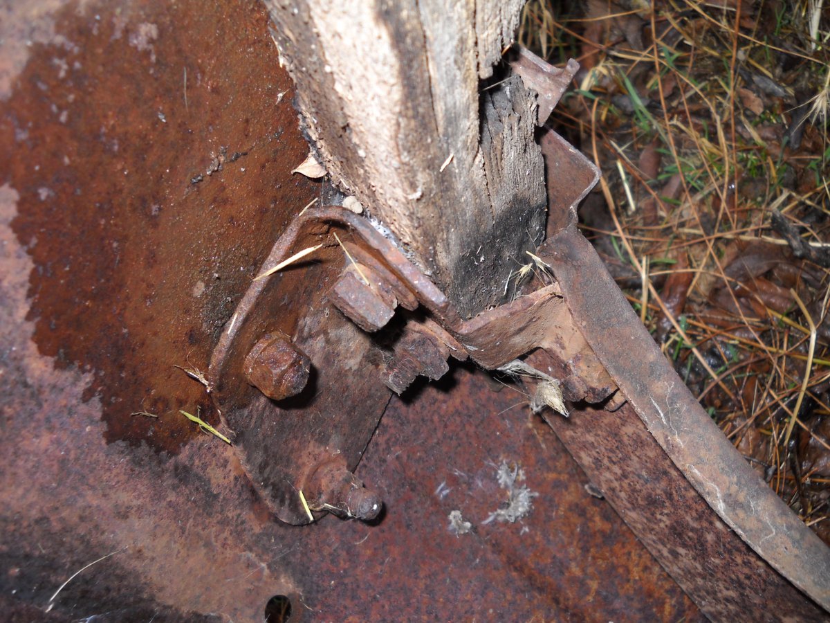

    I went out and got a couple of pics. These are with the cowl upside down. Three bolt for the windshield, two for the pillar, and one for the dash.
  11. Six Ball
    Joined: Oct 8, 2007
    Posts: 6,956
    Six Ball
    from Nevada
    That looks familiar. It also looks like job for a cutoff wheel.

    This morning I tried to take more of the front axle apart. I wanted to get the tie rod off. That didn't happen. I went down to the other shop and sorted wood for a couple of hours. I found places for most of what I have but found that I don't have as much as I thought. The right sill is missing 6 - 8 inches at the back of the cowl. The left side is missing a little more than 1/2 of the sill. I was able to set the back together on the frame. A lot of the wood I have is the boards for the floor of the trunk. I've seen flatbed trucks with less wood. I have some of the seat but am missing what ever ties the seat and body together. Much was crumbling in my hands as I tried to fit things together. At this point I really can't see me fixing it.
    On the bright side the bent frame horn is straight and the front crossmember is held in with a couple of bolts. Don't seem to be able to post pictures.

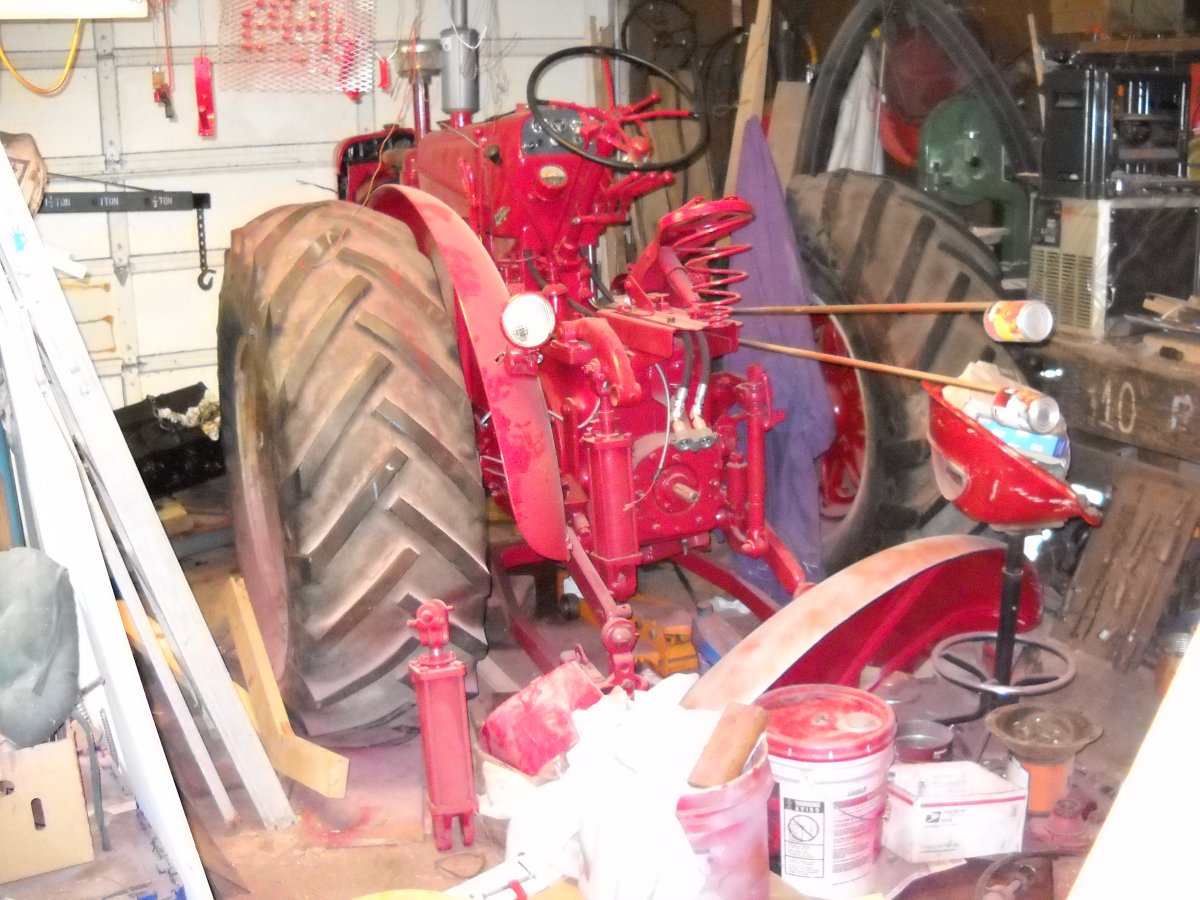

    A couple of years ago, I was rebuilding a tractor engine. I had a replacement hydraulic pump that I wanted to use, could I find it......No! I had to clean up the one that came off to put in place to hold the timing gears correct. A while later, I found the correct pump within 6" of where I had been looking. But it was 6" different verticaly! Two layers down!

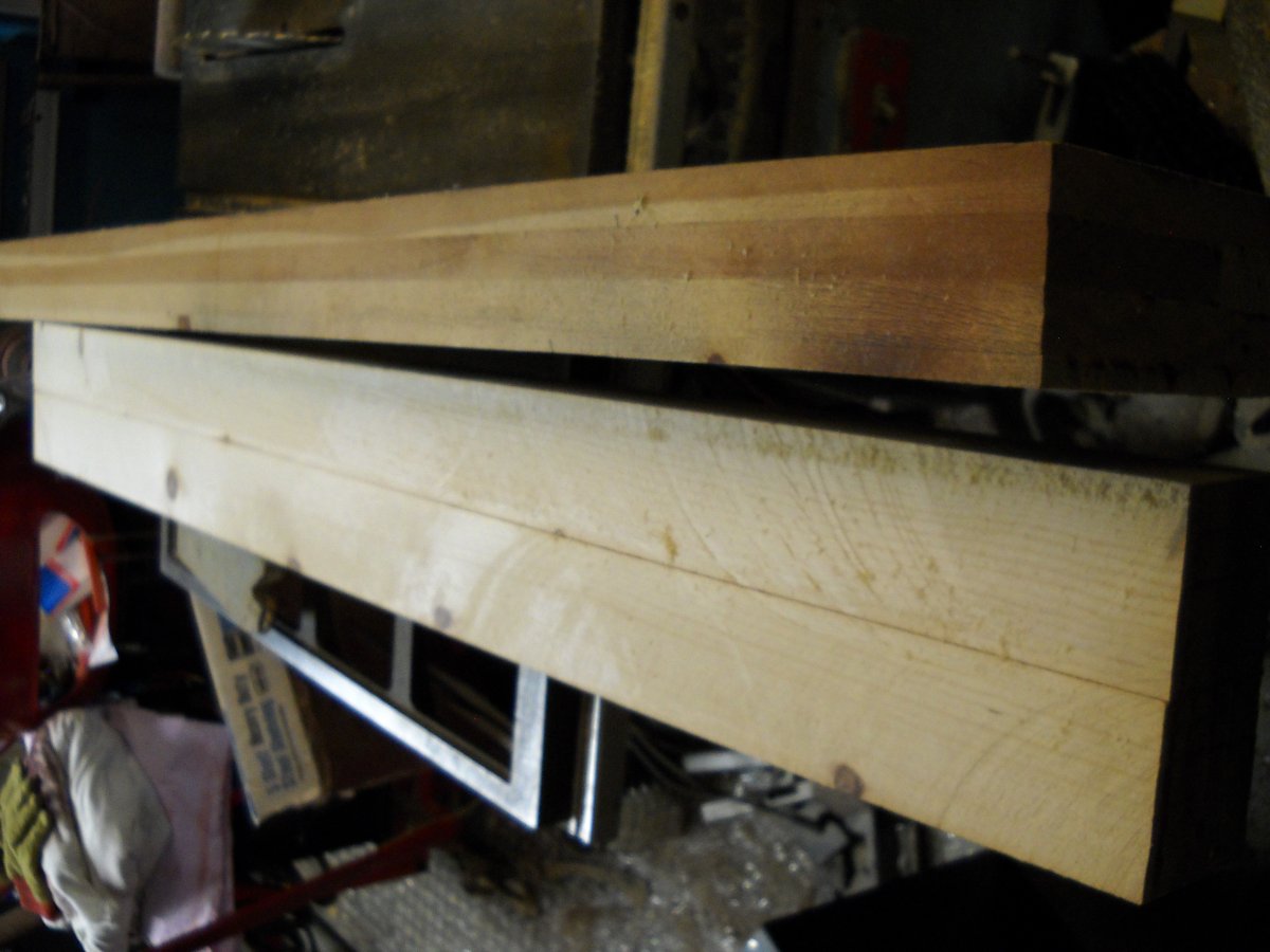

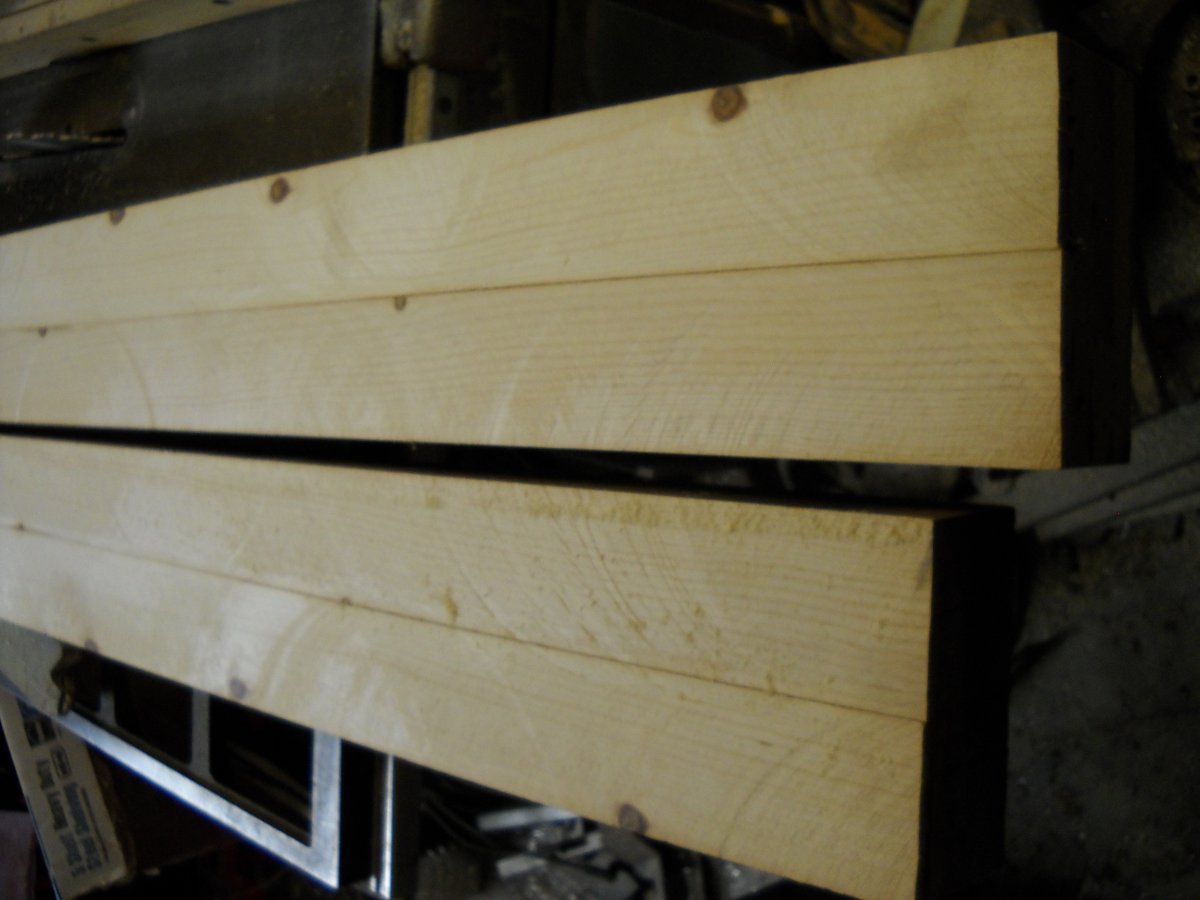

    Yesterday I got to the table saw and blocked out some pieces (that I had glued up way back when) that will be the patterns for the piece of sill over the top of the kick up. I also found that I do have a couple boards of Northern Ash. (must have picked these up just before putting everything away 20 some years ago.)

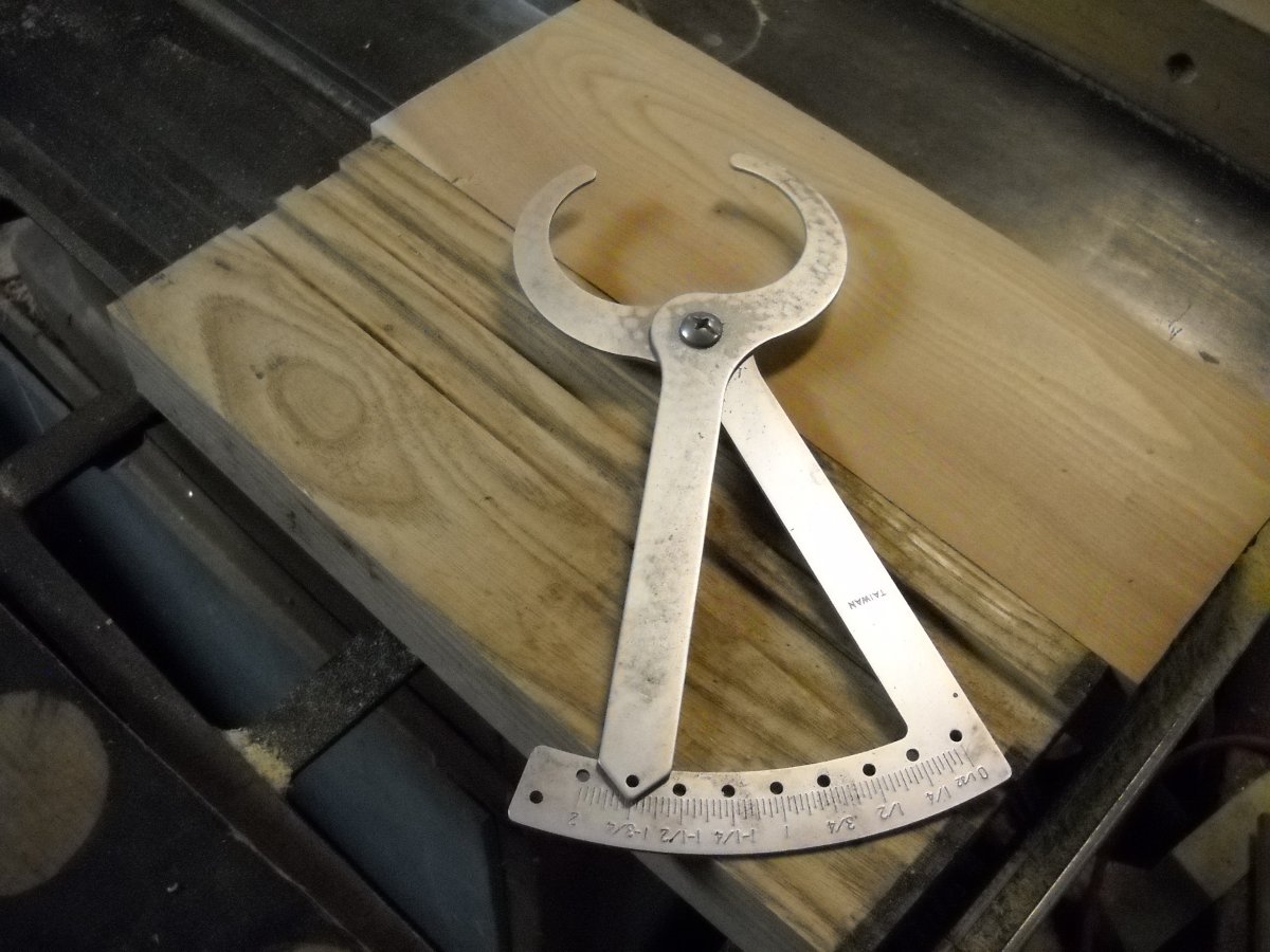

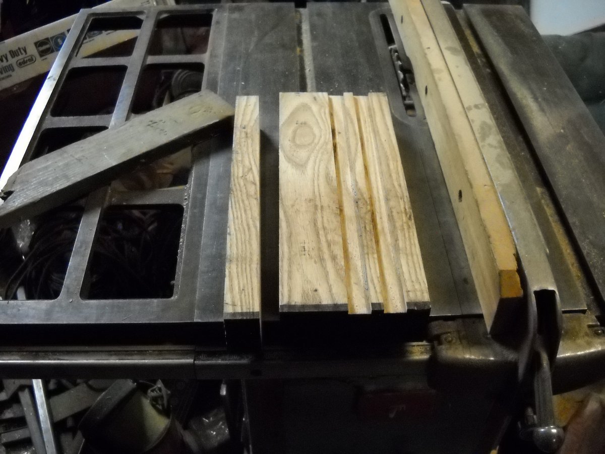

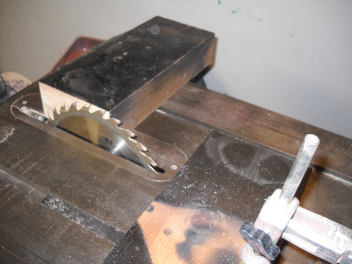

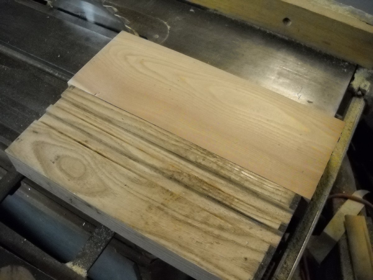

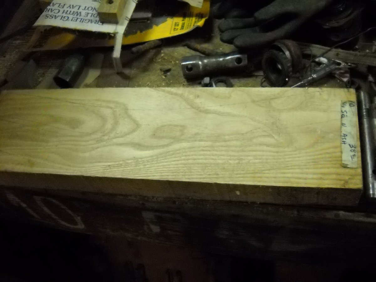

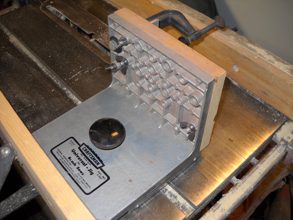

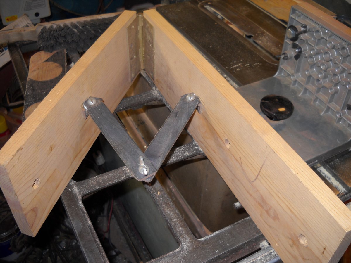

    I got back out to the shop yesterday and blocked out some more wood for patterns. Found some more wood that I had glued up years ago,(5" x 5" x 48" pine) so started cutting it up. One half of it got a new tail end piece blocked out of it. I started bringing the piece for the big blocks behind the seat down to size, but realized that I was going from dimensions on cardboard directly to the N Ash. (bo-bo waiting to happen) So I also blocked out a piece of pine for that pattern. Both of these pieces are long enough to make two blocks each. I will cut as many notches and angles as I can before cutting in half. Found another Ash chunk that when I turned it over, the pieces from the B pillar to the big block were marked out on it. (tried to get a pic, but didn't show up) Here again, I have the cardboard 2D patterns, but have not found 3D wood patterns, so will be blocking out some more of that 5 x 5 pine. I have not worked in wood so long, that I do not trust myself to go directly to the GOOD wood!
    I took some pics, One shows why I have no room in the shop, you can see my bandsaw and planer. It is so close between the tire and bandsaw that I catch my coat on the bandsaw table as I go by. (I know, take the coat off and also lose a little weight!) Also the are several Items that come in handy. The 1 x 4;s with the hinge is for putting the long scarfs on the sills. The universal jig works great for putting tenons on the ends of boards (just make sure that the board is vertical and held tight.) The 'nose ring' is the cheep thickness gauge (very accurate)
