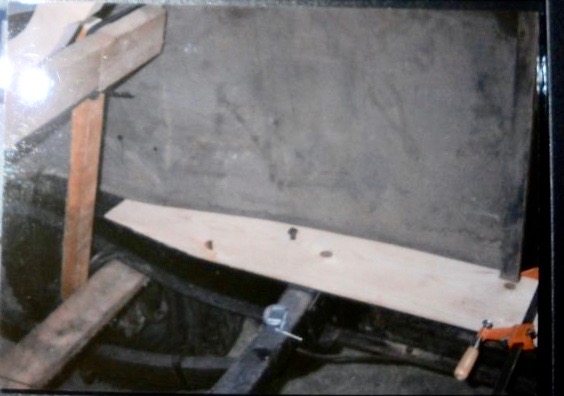

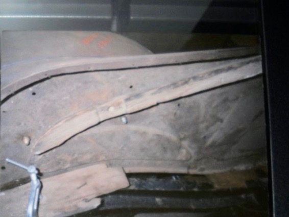

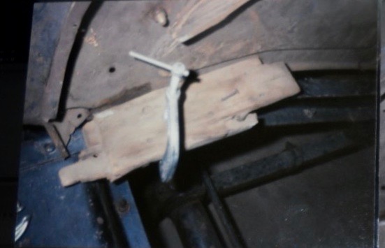

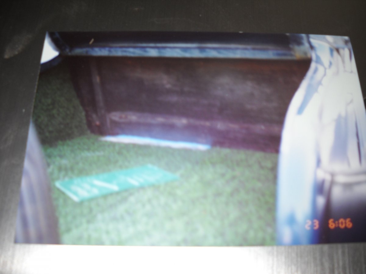

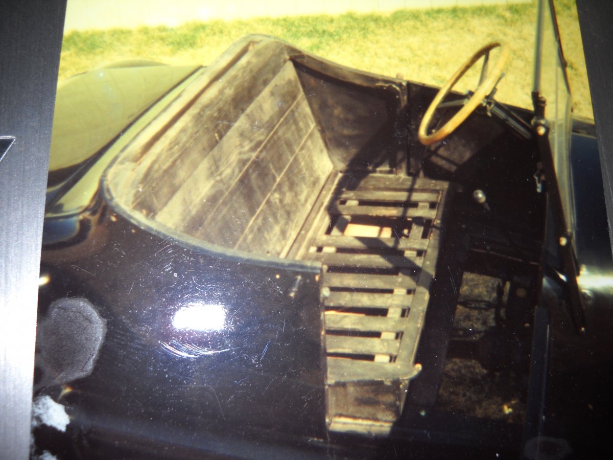

    Here are some pictures that GG2 put on a conversation we were having when he first started offering his help. There are some others there that should be here as well. If we get smothered in an over abundance of old Chevy roadster pictures so be it. Lots of information is a good thing.

    Six Ball I just put these up on another site and they came out to blury so will try here.
    The first three are of a 25. The second two are of a 26. Note that there are only two vertical boards holding up the seat back.

    Yes, They behave better here. I think I have one of the seat vertical pieces but not much of the seat back. I forgot to take seat pictures last time. I have some of the bottom frame and the small metal band that goes across the front and sides. I ordered a couple of wood measuring tools today.

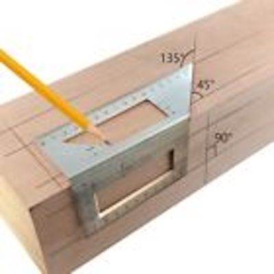

    Here are the tools I ordered. I think they will help.

    All tools are good. The last, or best vote is after using them!

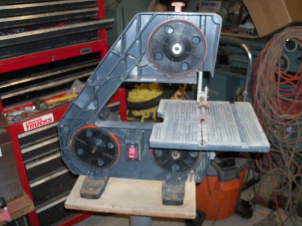

    There is some indirect progress being made. The band saw is in the shop and I have new tires for the blade wheels to install. There are new blades on order. The motor on the table saw is toast. The same one is on sale at Harbor freight for $115. I'll get one when I'm in town. Some wood clamps are on the way and a couple of tools came today.

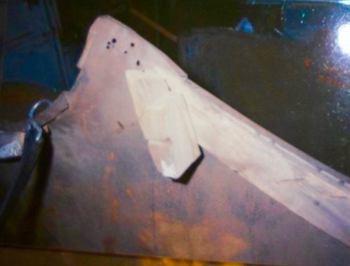

    This is where the floor rabbit begins in the foot of the cowl. The two small holes are where the metal brace for the front floor angle brace screws it the sill.
