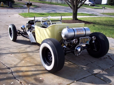

  1. Im really happy with the way the car turned out. I got it on the road in June and got it tuned about a month ago and have been using it as a daily driver ever since. I want to give a big thanks to ProEnfo for all his help on this car.

    very cool! great look and stance, you nailed it. I like the grill too :D
  6. skumbag
    Joined: Feb 16, 2005
    Posts: 688
    skumbag
    looks good, congrats.
    is the grill shell upside down?

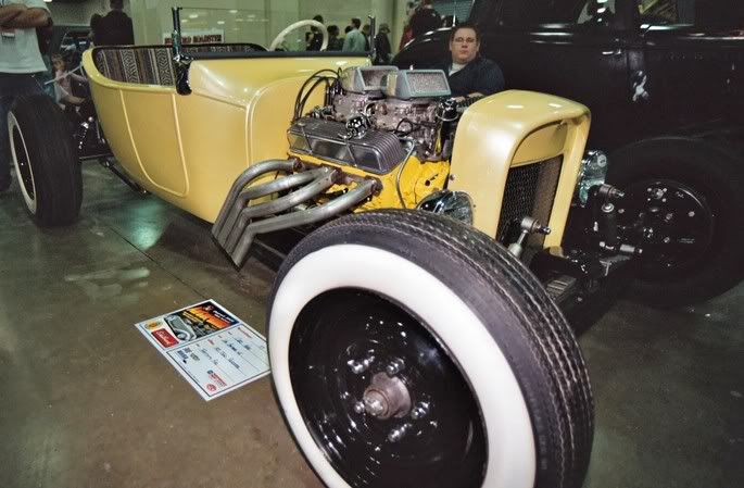

  10. Thanks guys. yes the grill shell is a 32 upside down with a sears bbq grill screen i cut for and insert.

  15. Its been about 35 - 45 degrees around here the last few weeks and i know ive put at least 300 miles on it. Frank, im workin on another project for cobo this year. stay tuned for updates. although i may drive the t down and park it on cobo roof.

    that's sweet. you're all over it. love the rear radius bar angle. can't beat the look. i do have a sweet-spot for T's.... I got one too.
    Question. can't make out the steering set-up. you mind giving the low down on it ?
    congrats on the style.
  17. Hey Chris ! I don't know if you saw Rod and Kulture # 6 but there is a shot I took of your T bucket from the Detroit Autorama in it.
  18. The steering is a reversed corvair box that is notched into the frame. I cut a piece of round tube and threaded each end and put a heim in each end and connected it to a speedway steering arm. that probably took me the longest to figure out over anything else on the car. Thanks Mongo. i really appreciate that.
