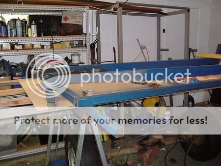

    Here are some progress pics of my rod - I ditched the flathead in favour of something cheaper to buy parts for.
    Steve
    Its sitting pretty high at present with the stock axle but I'll take out 3 leaves from the spring and it should go down a coupla inches
    Thanks heaps to the HAMBers whove offered help and advice on the build so far
    Steve

    more pictures! more detail! how are you connecting the front wishbone?
  3. Right on it...oops flat batteries - I'll get a shot of the bracket ASAP- here in Aus we're not allowed to space the radius rods more than 300mm apart.

  5. Heres some more detail [​IMG]

    good lookin frame there steve,
    does the driveshaft run under that x-member?looks that way in the shots. Im going to have to do a similar thing with my split bones at the front, they are currently on the rails,where they should be,but cant be. [​IMG]
