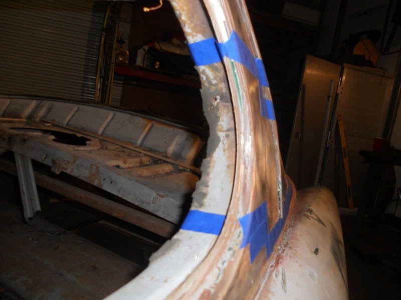

    Ok guys I haven't started a build thread yet but I would like to get your opinions on my chop progress, and some tips or tricks on back window placement. So here goes nothing.(More pics on page 3)
    started by taping out cut lines(guy in the pic is 1959ford on here aka erik)
    then bracing
    then we cut the back window out, and this was the point i got nervous
    post more in a min.

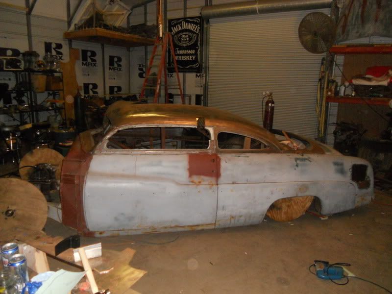

    Then it was on
    roof off
    door tops
    cut the post off
    and got the front posts tacked back together
    then started taping and and cut to move the back quarter windows back to keep the longer windows
    and more to come...

    That does look like a serious chop (like 5 or 5 1/2 inches).It does take alot of guts to chop a slanted windshield car .I chopped my 54 Chevy years ago and it came out nice ,but 49-51 Mercs are a bit harder to come by.Good luck on it and post pics please as it goes along.BTW ,not sure if you plan to or not ,but i noticed the rear window opening is not braced in the pic.You may want to do that to keep it from moving around during the welding ...

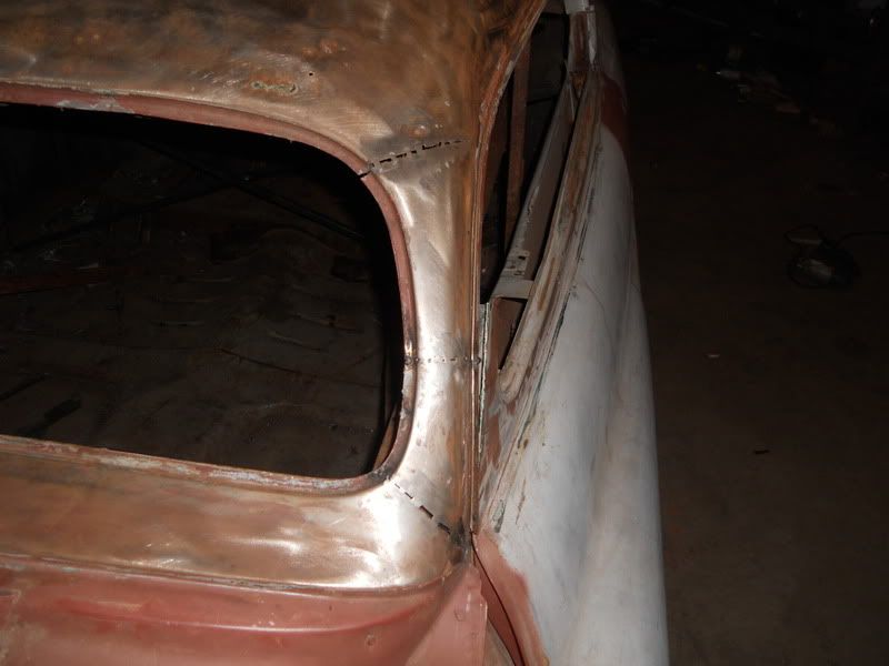

    now to fill in the hole
    and tacking the back
    taped out the cut on the roof to make the back window fit

    Thats where i am now, Its a 5'' chop(5'' vertical in back and 5'' up the front post so it ends up being something like a 4 1/2'' in the front and 5'' in back). I also have a 50 back window to put in it.

    I was pretty close on the 5 inch chop estimate.Looks very good ,especially for your first one :).Im impressed and cant wait to see it with the 50 window in it .Glad you sliced the roof and kicked the posts in instead of cutting the roof into pieces to make the posts line up (like most first timers do)..You obviously did sum homework before you started cutting ...

    yes sir i have, I have asked a few ?s on here and i also have a 4 hour chop dvd from some guy in TN. that i have watched about 10 times and it is playing while i am doing it.
