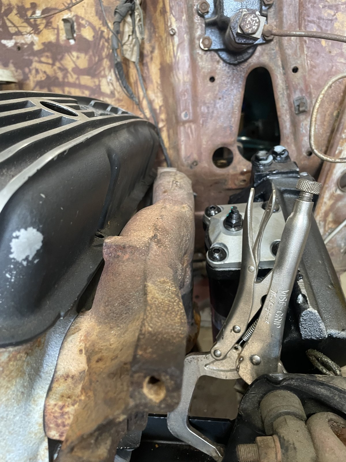

    What if you place the window to the back?

    56’s didn’t use rams horn manifolds, 57 was the first year for them. Remember the front dump manifold you put on your mercury? That is a 55-56 manifold
    However see where things are before doing.

  5. Yep.
    Thought about those.
    The merc is gonna cruise a 283.
    The wagon might get something larger like a 327 or 350(gasp) the double hump heads on this mock up are fresh. New guides, valves, springs and exhaust seats. Just been sitting on a shelf for a few years. Would make better sense to use em.
    I’d like to run the vette style manifolds.
    Don’t think it’d be a problem. Got more room now than the merc had. Scooting over 1/4-3/8 wouldn’t take much

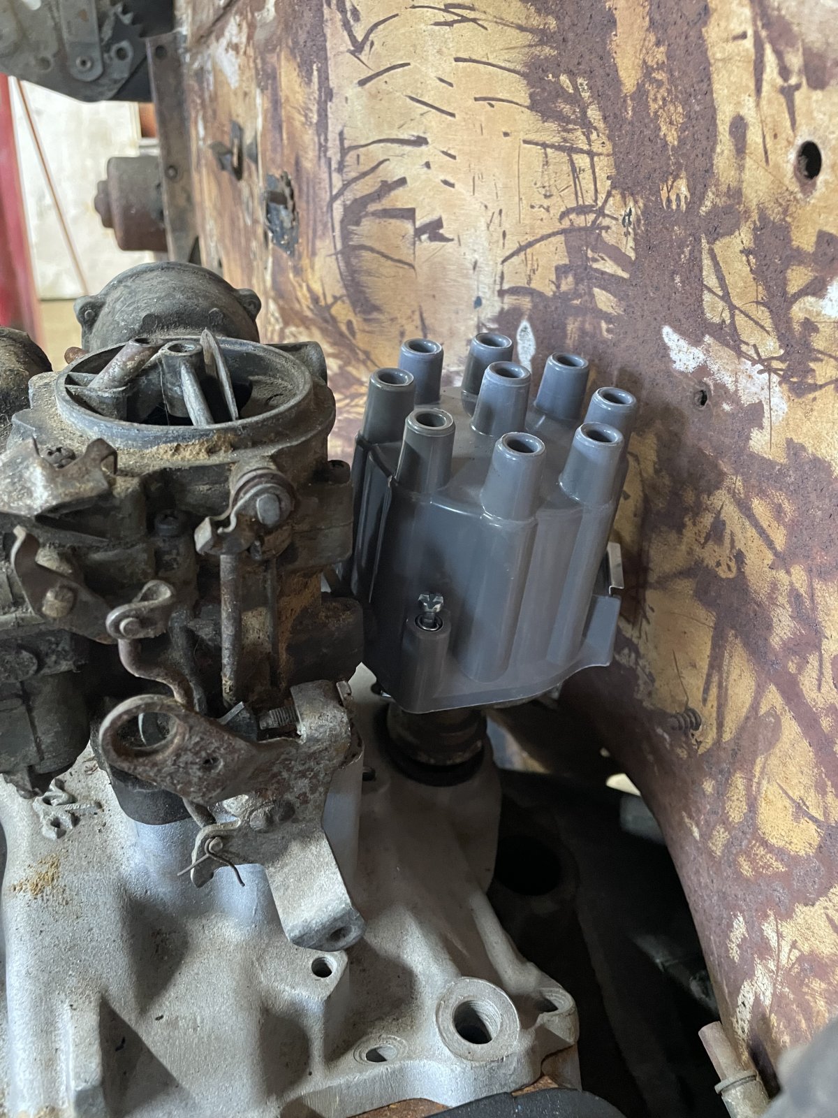

  6. I getcha
    not running this in the 56
    But if I round up couple more 2jets, I might run this in my merc. I was wondering what distributor/cap was used to clear the intake and carb.

    55 56 distributor, no window, no hold down screws, or a flat cap vintage mallory dual point distributor265.jpg
  8. Yep. Tight.
    Even when you plug the vacuum
    I’ve got a small cap MSD I was planning to use with the merc. Doesn’t have the window in the cap. Does have the screws

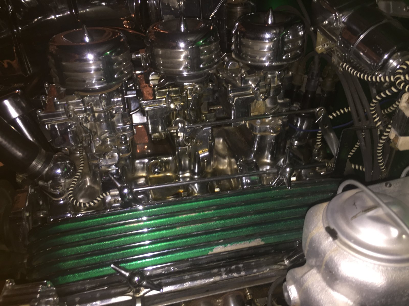

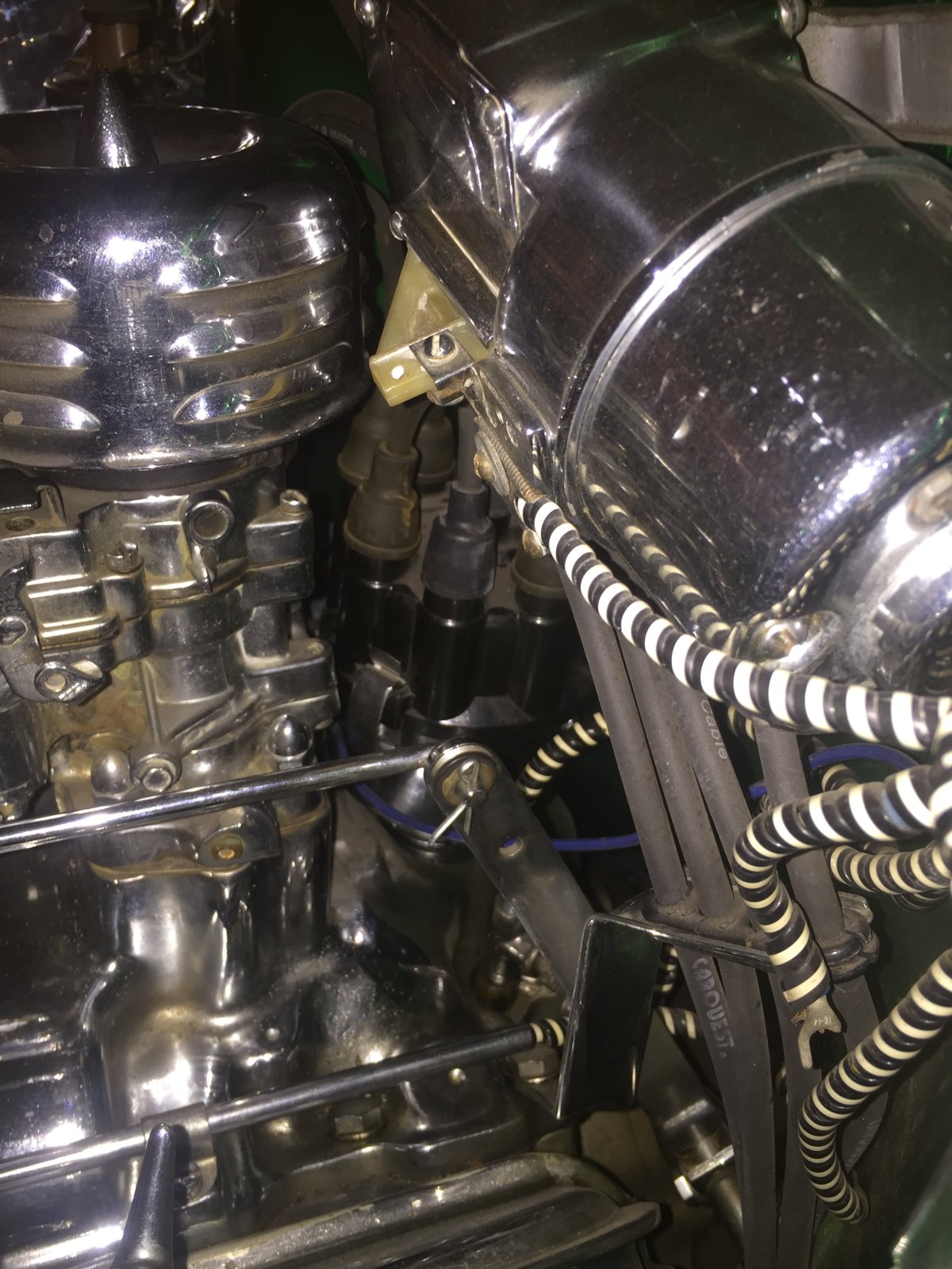

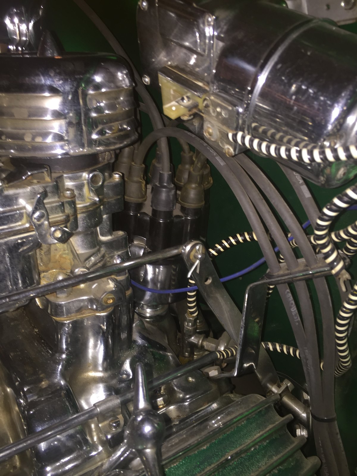

    MSD ? Yuk. Here’s some pictures of the Astorian. It has 3 twos and a 57 corvette dual point distributor with no window. I can’t get my finger between the carb and the distributor,

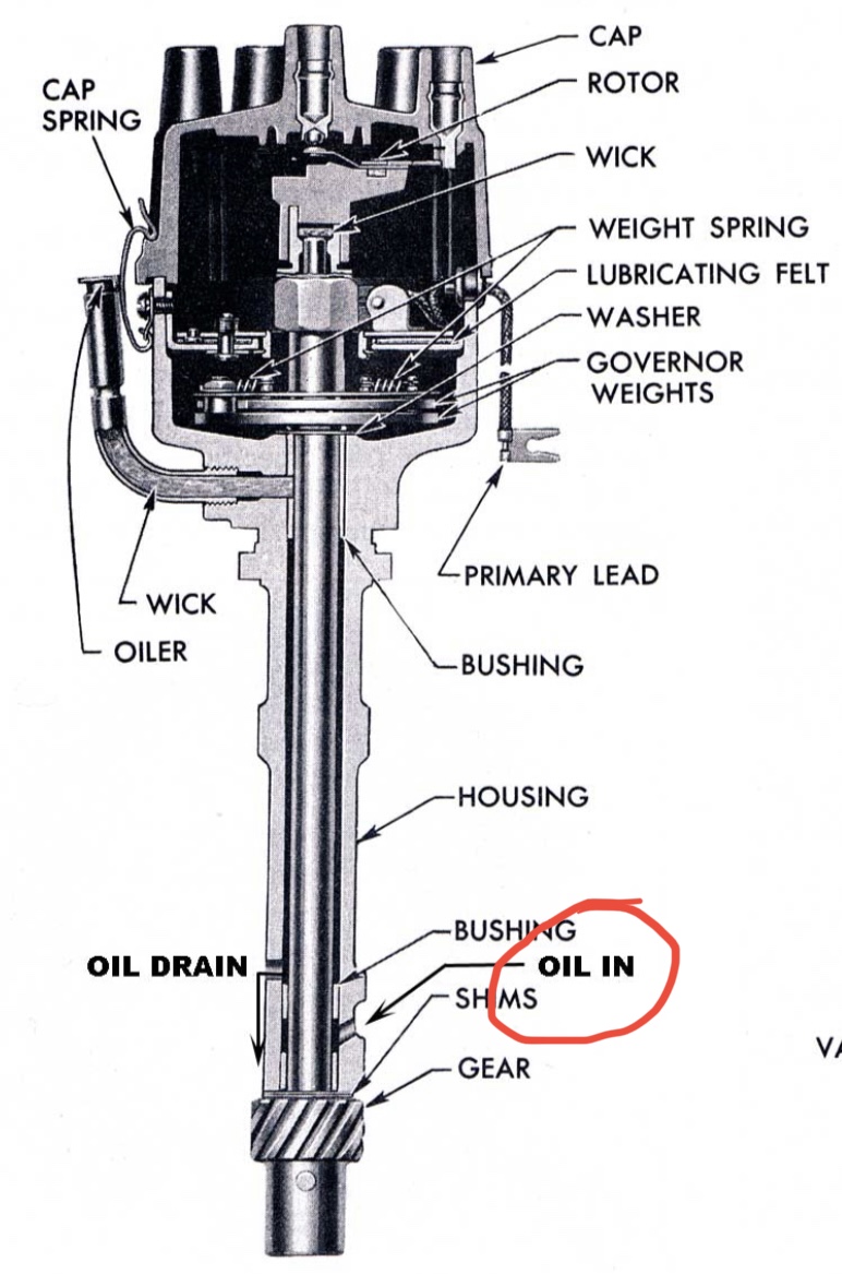

    I know that the 265 distributors have a flat spot on the rings in the casting to allow oil to get to the valve train. I know the 265's need this but what I don't know is if that flat spot causes any problems with oiling if they are used in a 283 or 327. anyone know????

    No it won’t. Just need to clock distributor shaft correctly so oil will make the crossing. 265’s suffered the same fate if not done correctly.
    Just be sure flat spot is as parallel to the passenger bank of the block as possible after timing is set.

    But this oiling hole is of concern. Plug it, later blocks had full time oiling to the lifters where 265’s did not. Leaving it open will flood housing then keep points lobe well lubed and beyond. D6B78C44-52EC-4030-9D9C-E1862B605A74.jpeg
